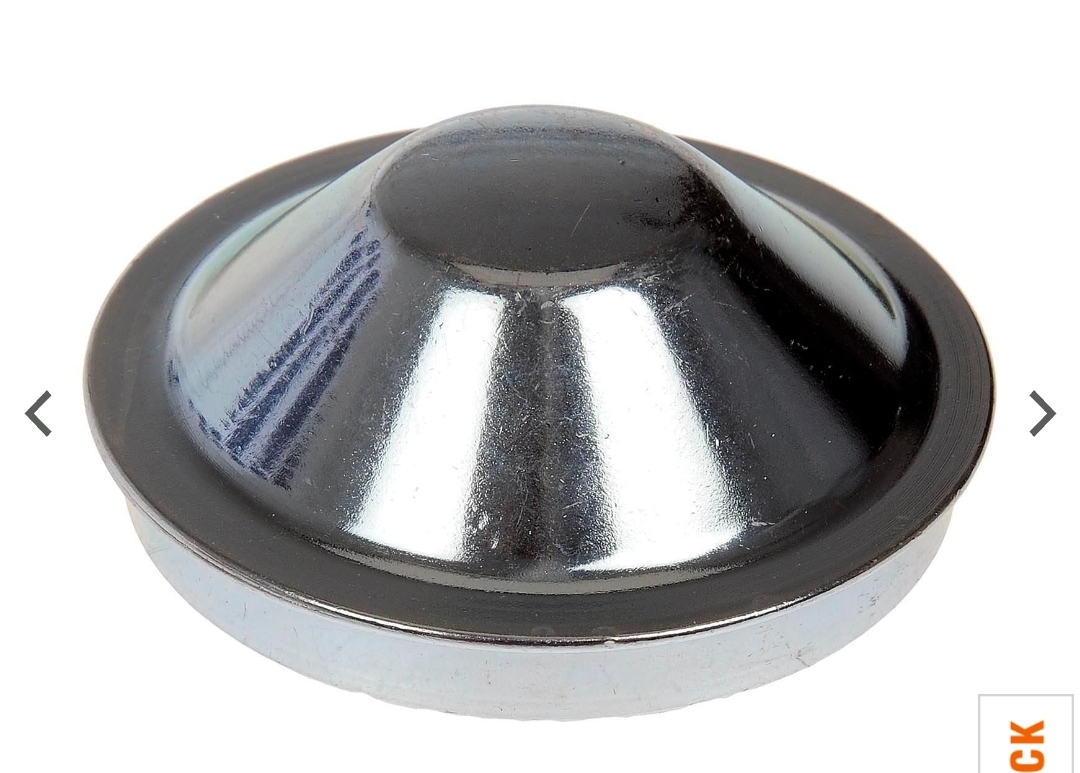

Isn't torque spec like 180 ft lb
Plus with no caps those threads get rusty. Kroil or PB Blaster beforehand is your friend

Wasn't talking about wheel center caps, but the caps that cover the axle/nut
When I replaced the hubs on my 2011 I bought caps and installed them to help protect that area. Then the damn thing was totalled a month later, lol
