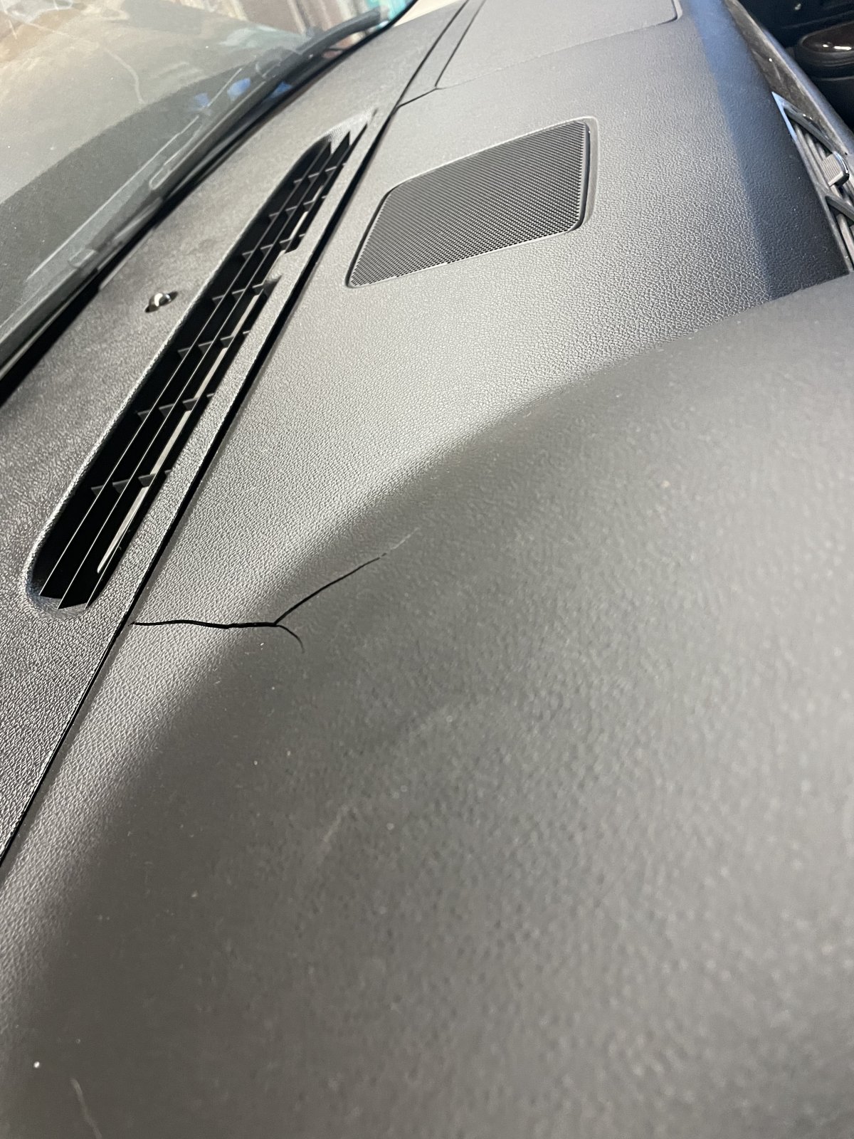

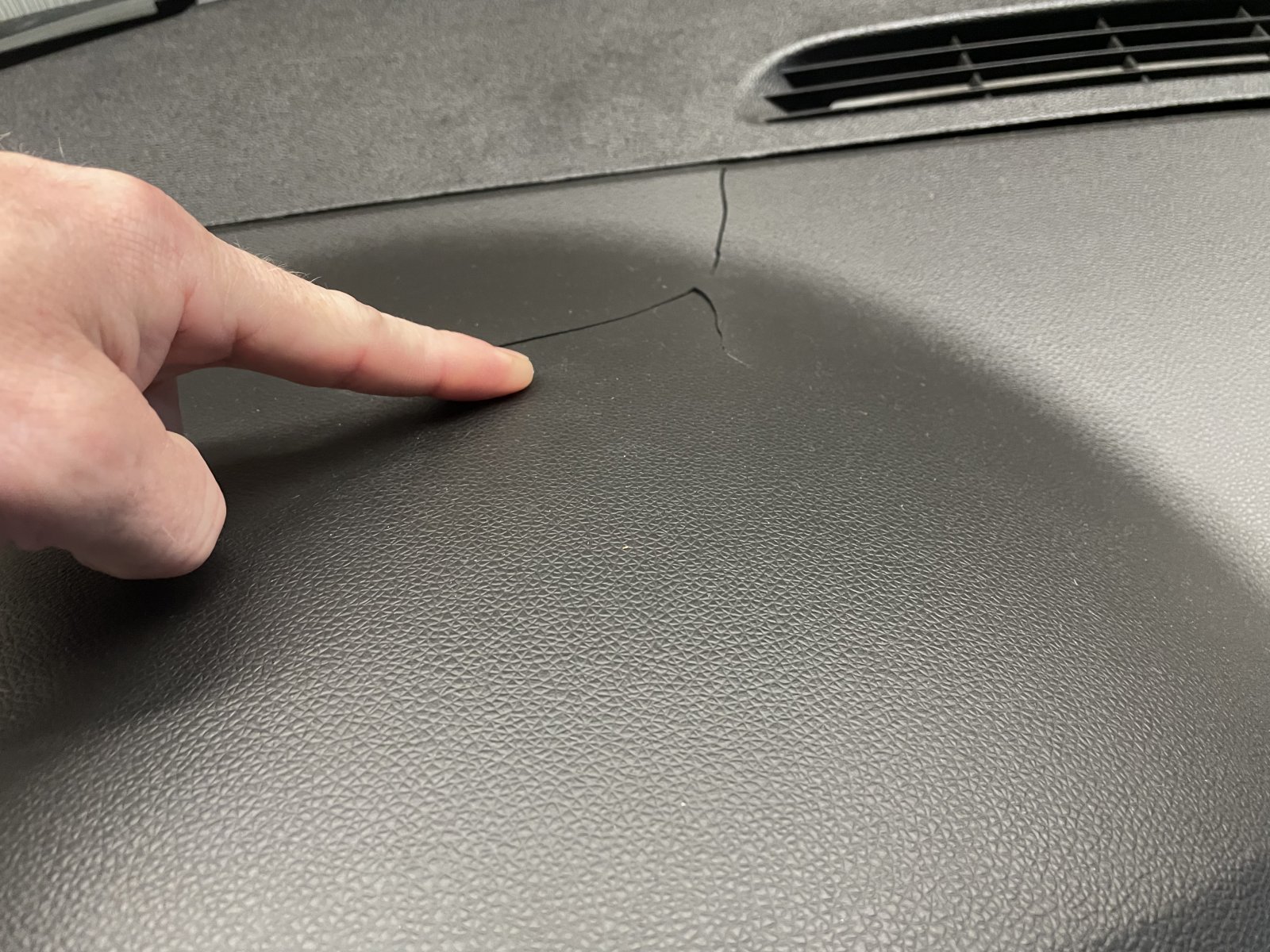

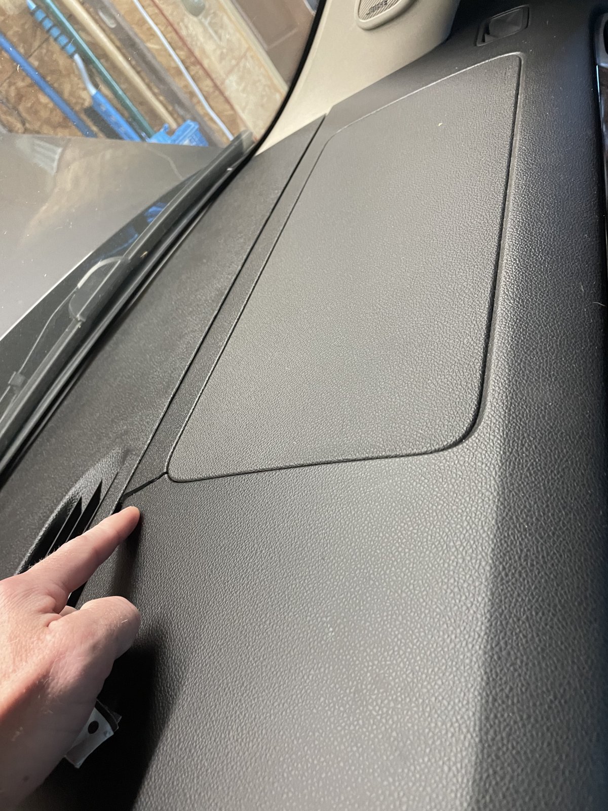

I have never seen any cracks above the stereo area- do you have any pictures of where that might be? And no other plans, all I've seen the cracks are the areas I added epoxy to.
In front of the speaker is correct. It hasn’t cracked on mine yet, but the clip that holds the front cover in place is a very weak point. I found out it was actually the cause of my crack above the instrument cluster. Once it went things started vibrating and the rest is history at that point.

Ah. Yeah I don’t have the center speaker so that area is different on mine and not an issue. The other 2 areas where yours is cracked are where the reinforcements are on the new dash and I added the epoxy as well.

I and I believe @Doubeleive put a block of foam under that speaker to help support that area. The grill cover pops off and the speaker is ******* down in the corners and lifts out from the top.
That tab we're talking about that's towards the window actually helps support the center of the dash. The piece along the windshield with the defrosters is a more rigid plastic and it has a trim clip that pops into the tab and actually helps hold it up and keep from bouncing. That tab breaks and the clip has noting to hang on to.
Exactly! And like you guys I had some foam under mine in both locations and it still managed to crack the dash above of the cluster.
Despite using the foam support, some guys have issues with the sun warping or cracking the dash, but that’s not an issue for me. I park in a garage, have tinted windows and use a sun visor whenever I’m parked outside. I think mine was just on its last leg by the time I realized there was a problem.

the dash cracking is not from the sun, it's just bad plastic period, age and vibration is what does it. I have put epoxy around the center speaker clip mounts in addition to a bottom support to try and prevent more cracking but eventually I will just have to replace it. These dash are not like the old style that would curl and peel from the sun.
