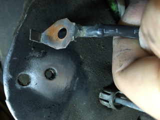

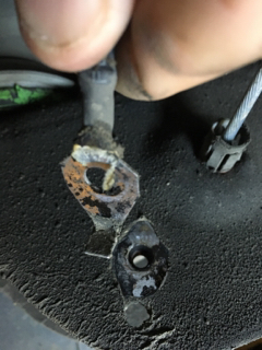

So I have had a random "Service Brakes Soon" like coming on in the DIC for a while now, took it to the dealership a year ago and they helped be throw $55 away on a new check valve/sensor that didn't solve the problem. It comes on randomly, like I mentioned, but seems to do it more often when it's wet and/or rainy outside. I just came across this video (
) so I went out to check the ground (keep a pretty good eye on the fluid) and found this:
So I cleaned it up to this, reattached, and painted over it:
(Orange is not rust, just where I scuffed it up a little too far on the connector)
I'll keep you guys posted...
