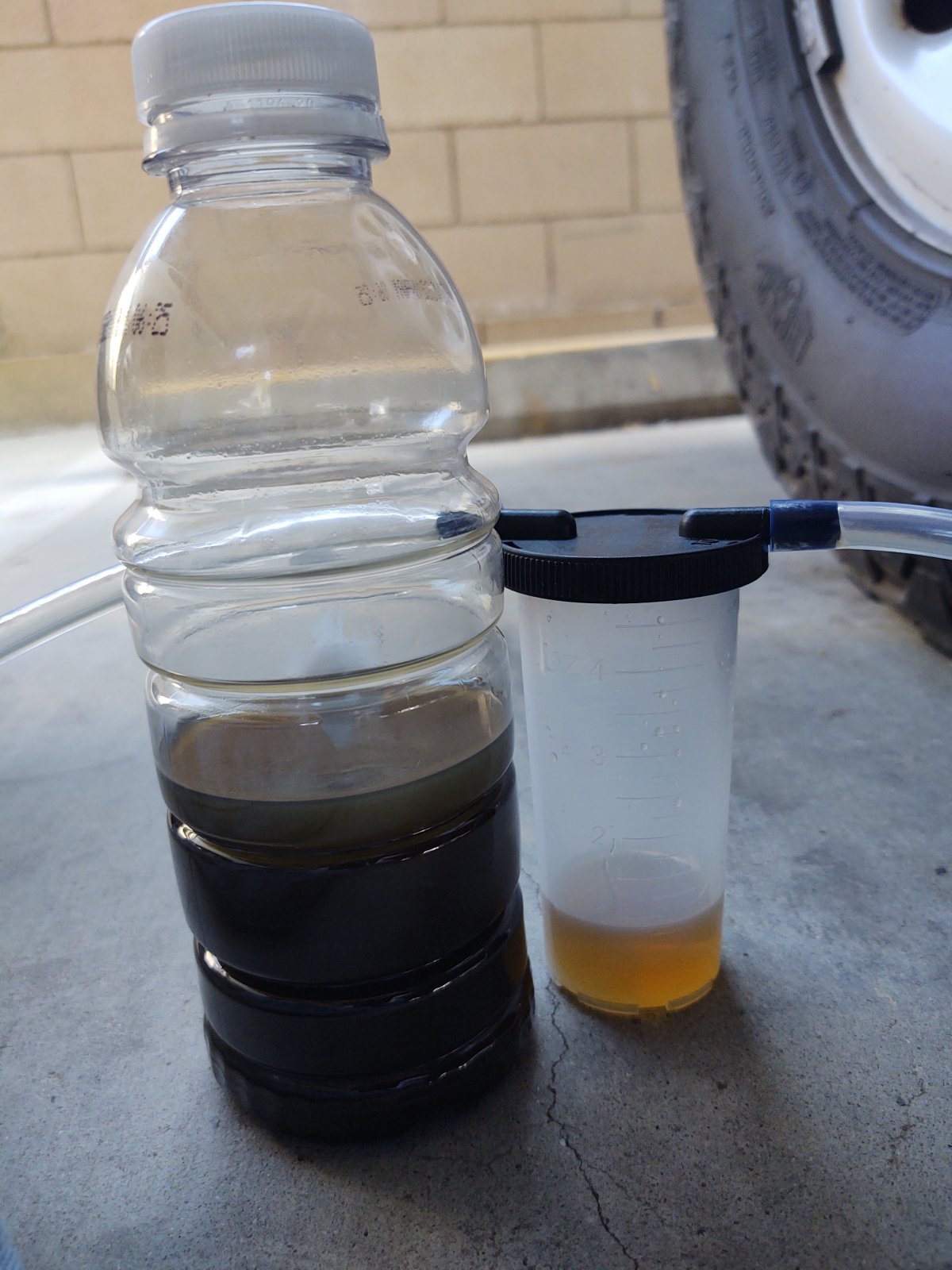

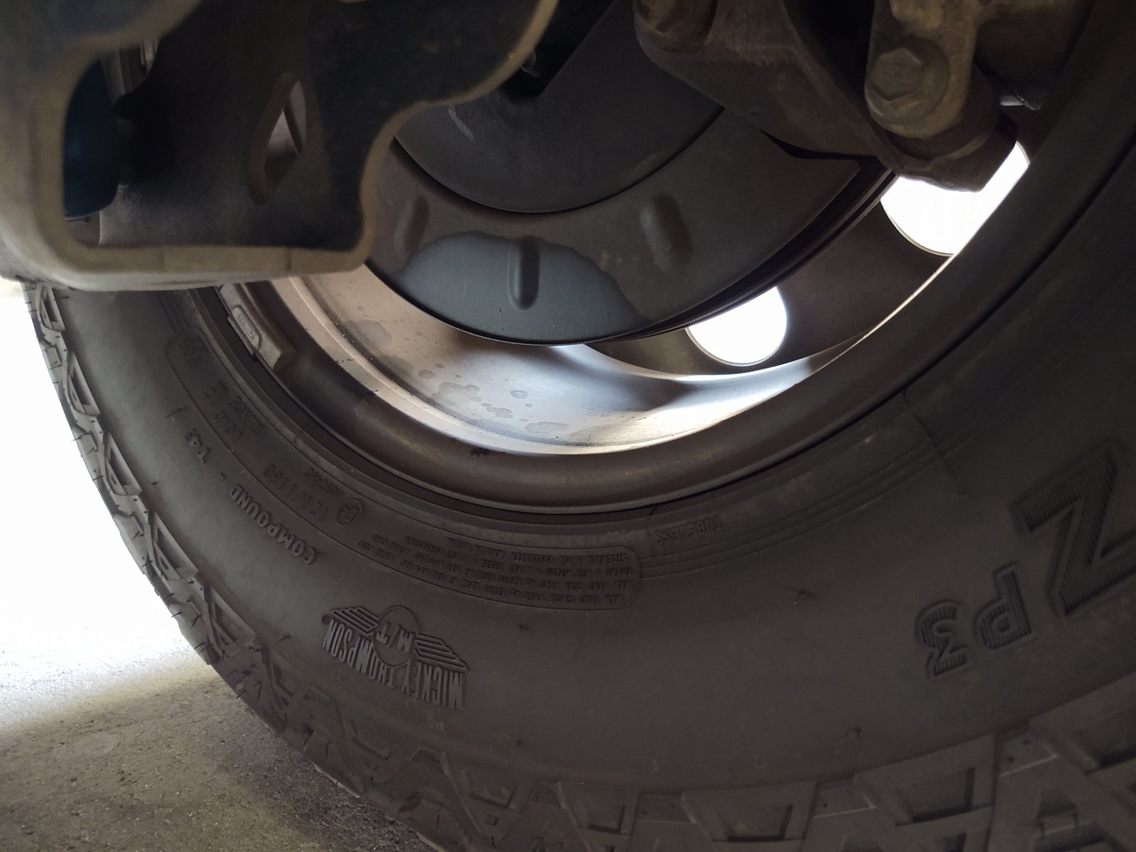

Change the brake fluid for the first time since I bought it(3years)... Never felt like I had an issue, but that fluid might have never been changed in the 4 years that the sheriffs owned it.
So it was way overdue.
And in typical fashion, while I was crawling around underneath it fixing one thing, I found a leaking axle seal from the looks of things.

Why DOT 4? Did all your bleeders work? Did you vacuum, gravity, or pressure bleed it?

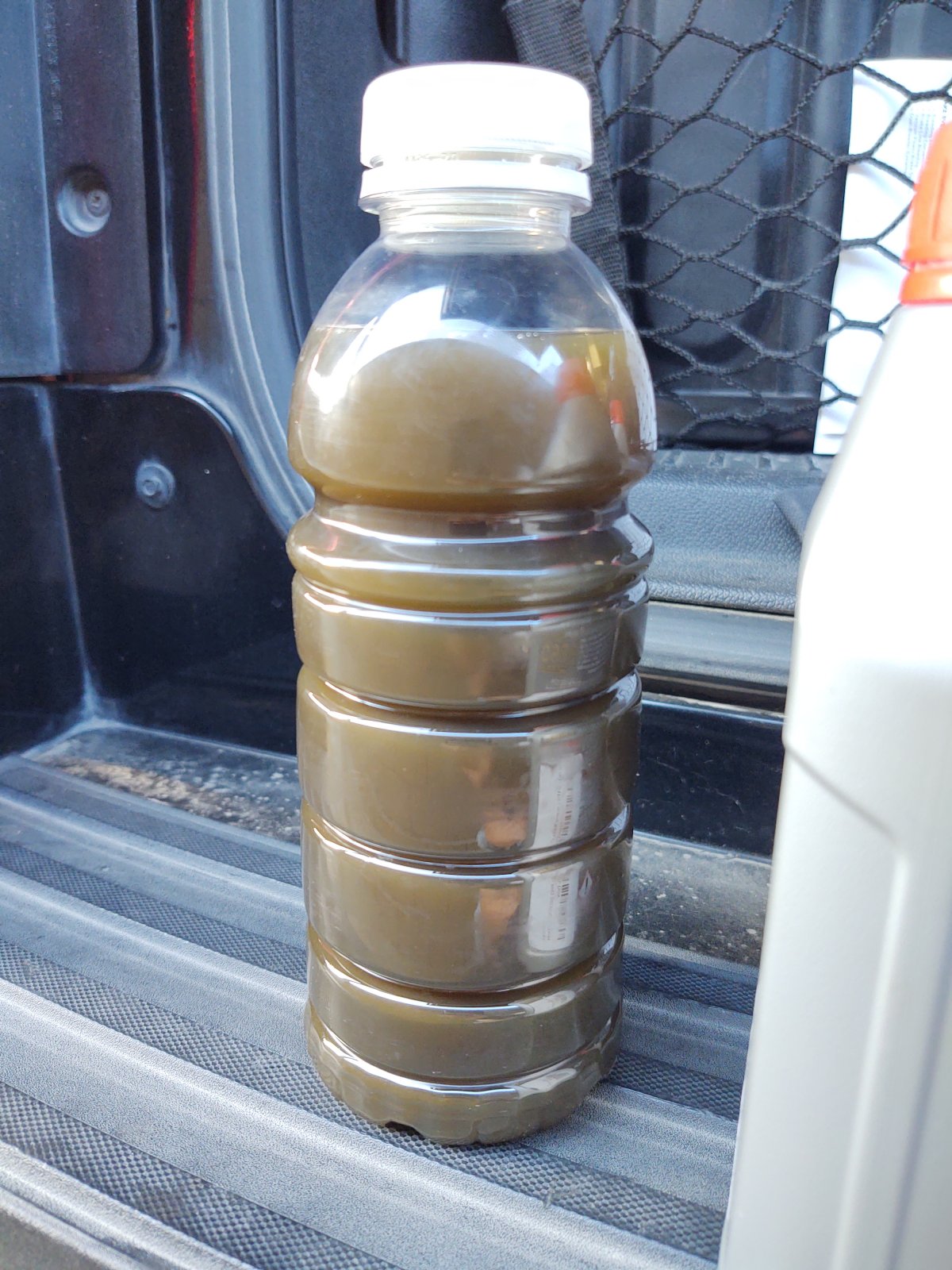

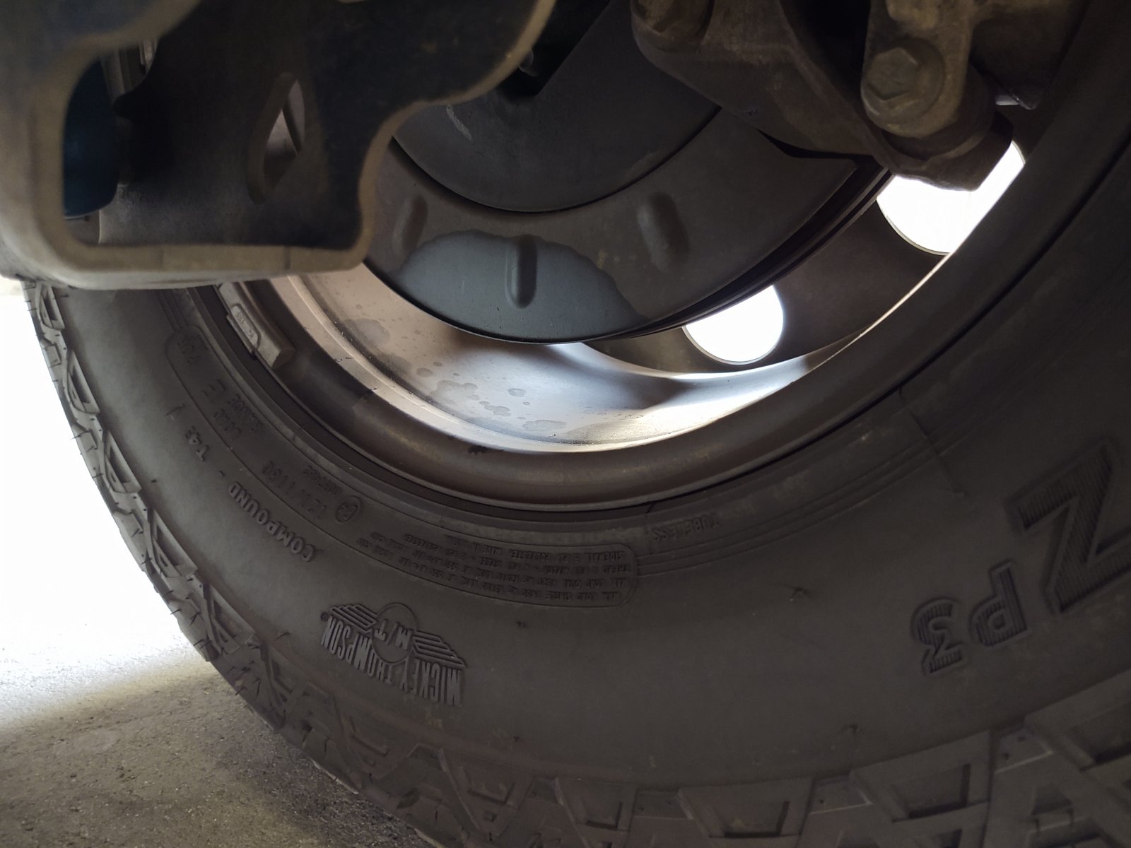

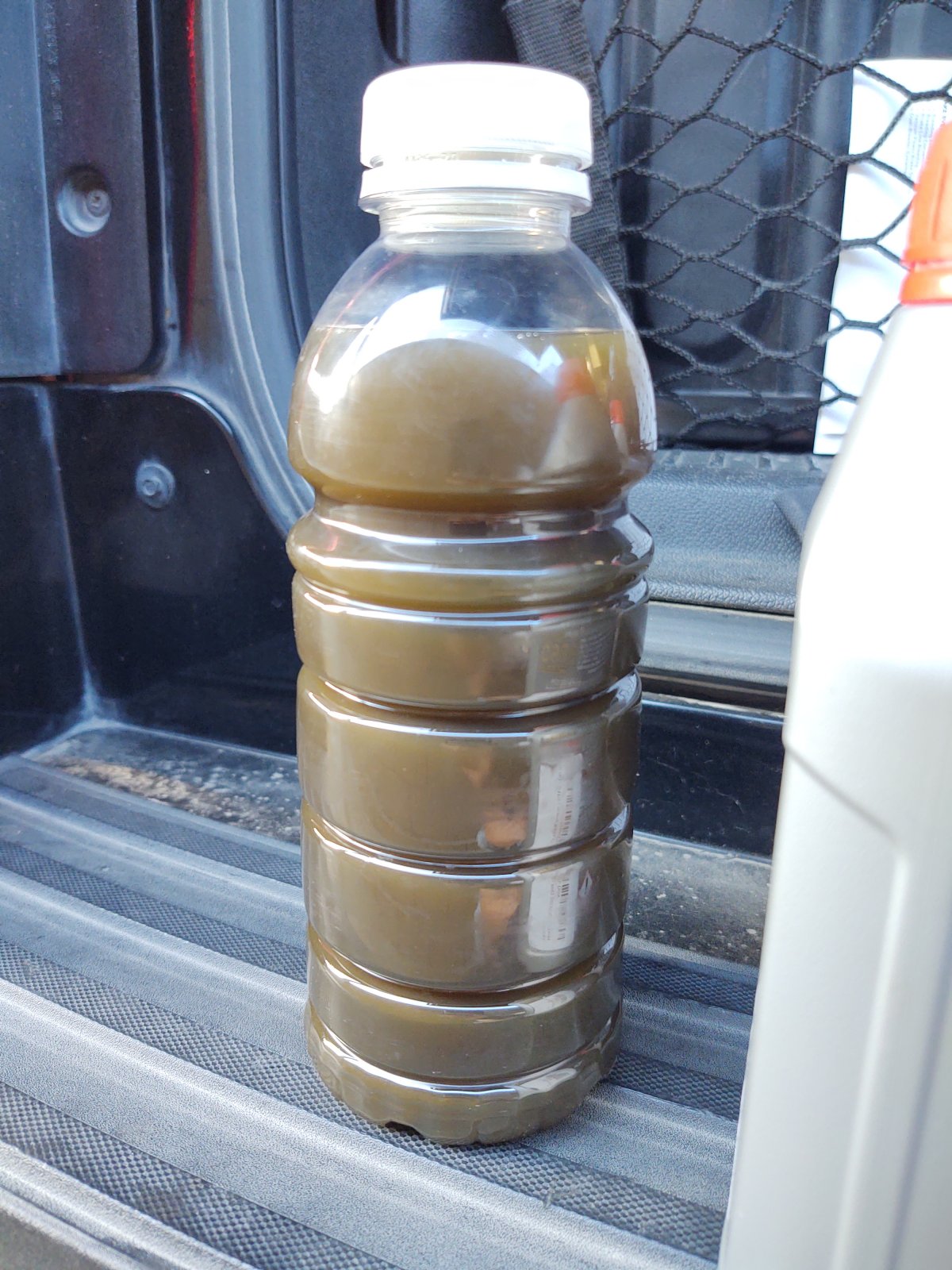

View attachment 345744View attachment 345745View attachment 345746
Looks like that fluid was definitely overdue.

Curious, how many quarts did you use and did you bleed the ABS as well? I went through 6 quarts when we did ours, bled the ABS pump with the Tech-2 and the traditional way to complete.
No I didn't touch the ABS pump. I think I need to replace the front right caliper in the not too distant future and possibly put on some stainless braided lines if I can figure that out so I'll end up changing the fluid again and be a lot more thorough if I end up replacing those parts.
I could tell a huge difference in the color of the fluid when I got to the more fresh stuff I put in compared to the mud that I was getting out of it at first.
But I could tell it was still a bit darker than the fresh fluid that was coming out of the bottle so it's still not perfect, but a heck of a lot better than what was there.
I used just under 1L
Gadzooks! That’s some muddy looking chocolate milk. Like James mentioned and you followed up with, the ABS bleed will be a saving grace for your system. Any crap left in there will get flushed out of there. Sometimes the Tech2 can be funny about the bleed and I’ve seen guys have to use a different vehicle year/model selection in order for it to work.
Are you thinking new braided brake lines for the whole system?

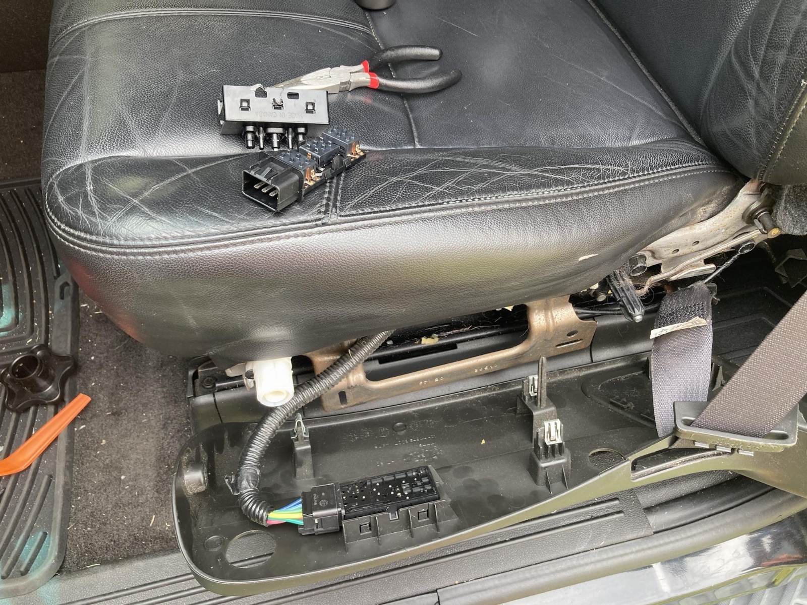

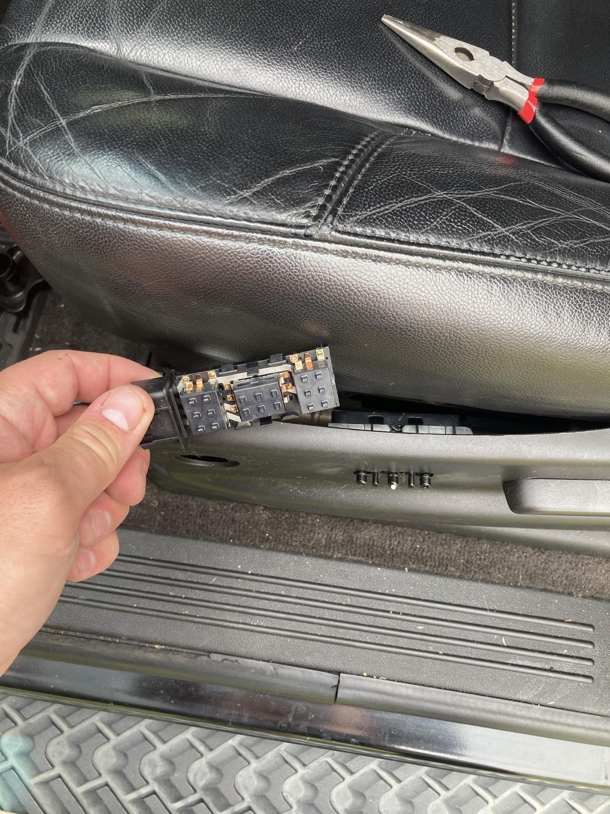

Finally got around to changing out the power seat switch for my drivers seat. The seat hasn't been able to move forward for awhile, but all other directions worked. Overall it was a pretty simple repair.
Originally I tried to leave the seat back adjustment handle attached and not pull the plastic cover all the way off, but I ended up just splitting the old switch apart.
Pulled the whole cover off to do it correctly. New switch installed:

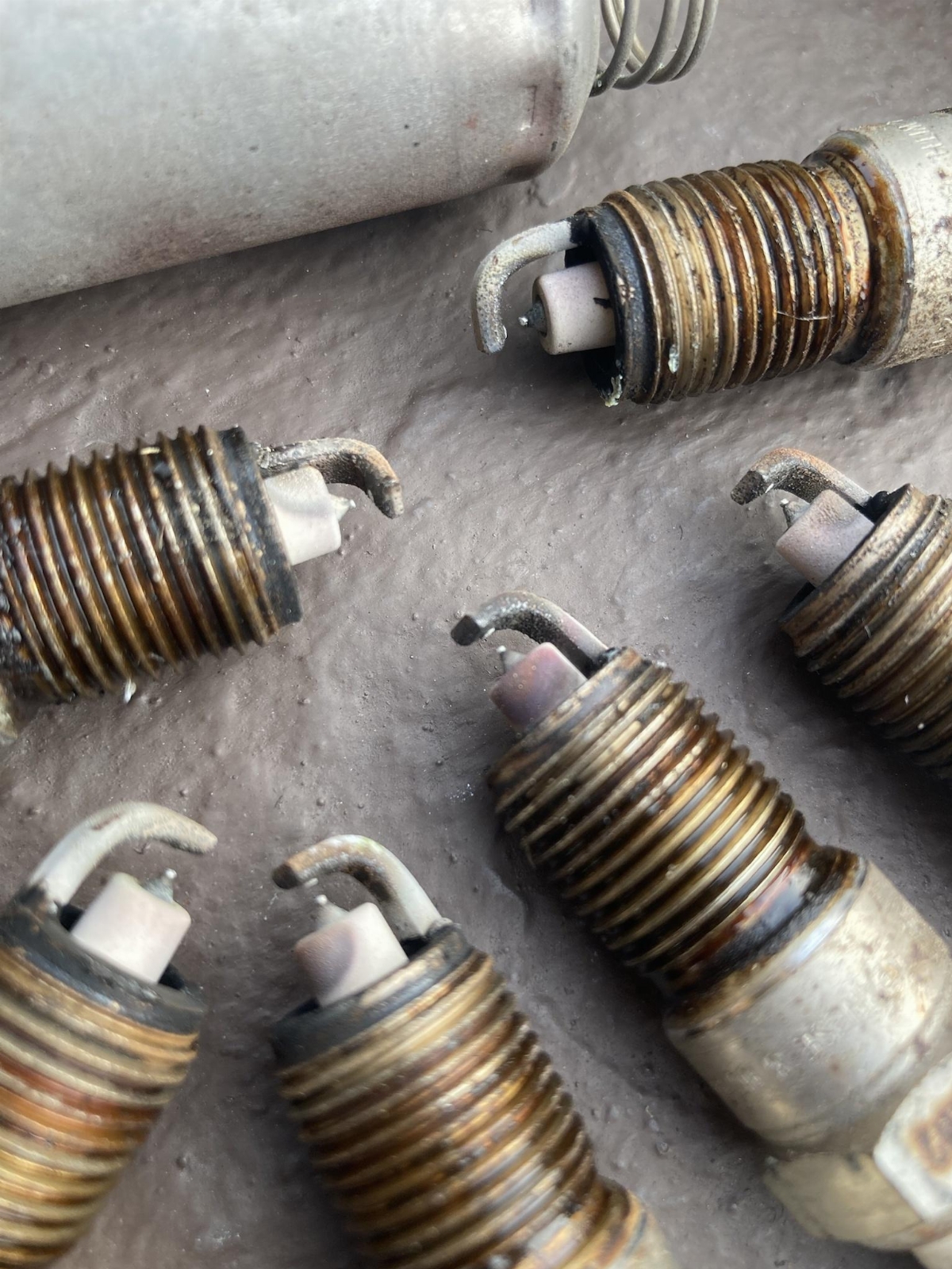

I'm about to hit 100k miles, so I also switched out the spark plugs and wires (except for the #8 plug which is impossible to reach) and cleaned off the MAF sensor. Old plugs were looking a little rough:

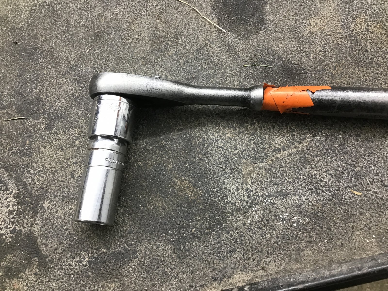

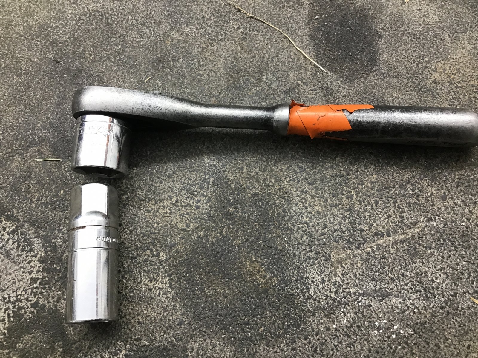

#8 isn’t too hard if you use the right tools to loosen it. Use a regular 5/8” magnetic plug socket but instead of an extension on it, put a regular depth 3/4” socket on your ratchet and use that on the hex end that is on every plug socket. It’s the perfect length. If you’re still having problems, pull the wheel and inner fender liner and go in from underneath.

Please tell me more about this switch. The driver seat in thecopcar is spotty at best moving forward. The other directiones still work.
