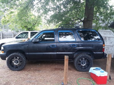

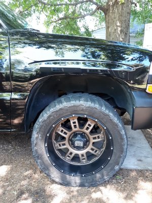

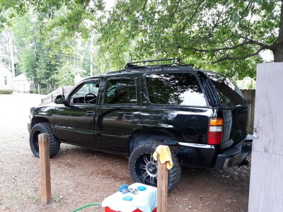

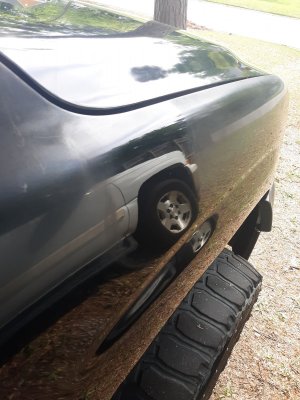

Still have to hood and lift gate to do, but finished the sides today FINALLY *added a before pic*
View attachment 245561 View attachment 245562
Nice work, these trucks are beasts to detail.
Sounds crazy but it’s good to throw wax/polish on the trim around the windows instead of taping off. Gives them a semi gloss look and prevents cracking and fading. Obviously the rubber can still be taped off.
Thanks for the advice. I will definitely keep that in mind. My previous experience with the Meguires ultimate compound is what made me tape them up. I used the ultimate compound and polish then finished with black wax. Has anyone used the ceramic stuff yet?
