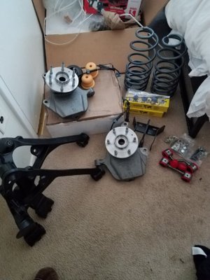

I got everything minus the shocks.... (the 1 item I really need lol)
Install was going to be tomorrow but looks like it'l have to be pushed back a couple weeks or to Thursday if the shocks come in tomorrow
Edit. Can someone tell me if the springs are the right way in the pic or are they upside down? Lol

They’re upside down. The tighter spaced coils go up

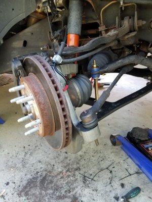

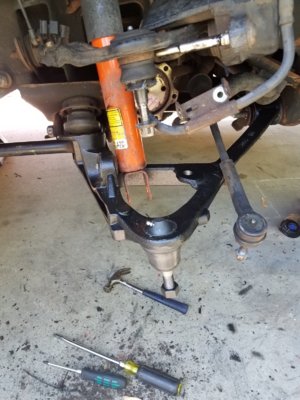

LCA is kicking my ass. Lol. I have it installed but the torsion key isn' touching the bolt. It' all the way up. I guess I have to take it off and turn the Tbar till it touches the bolt then install it again?
Disssembly Was cake. I got the Milwaulkee M18 mid torque impact and that thing zapped everything off. Putting it back together.... we'll see

That' the LCA all the way up and the key is all the way up. Which is wrong because I would have no adjustment down so I need to take it off and put it back on with the key touching the bolt

@Bombsquad85 did you preload the torsion bar for reassembly? And remember don’t torque down your control arm bolts completely until everything is installed and the vehicle is sitting on its own weight.
View attachment 198932 View attachment 198933
Which lcas are those? Stock type or for lowered trucks? I guess this is what I have to look forward to.
They are the moog problem solver LcAs and the passenger side is in.
@M1Gunner so should the bolts be loose or just snug? Right now I have them zapped on with my impact but not torqued. And do you know the torque specs for them?

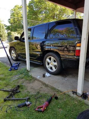

Well I'm done for the day. Sway bar is banging against something (probably why It needs to be moved over 2 inches)
No free travel mod because cheap harbor freight cutoff and sawsall
