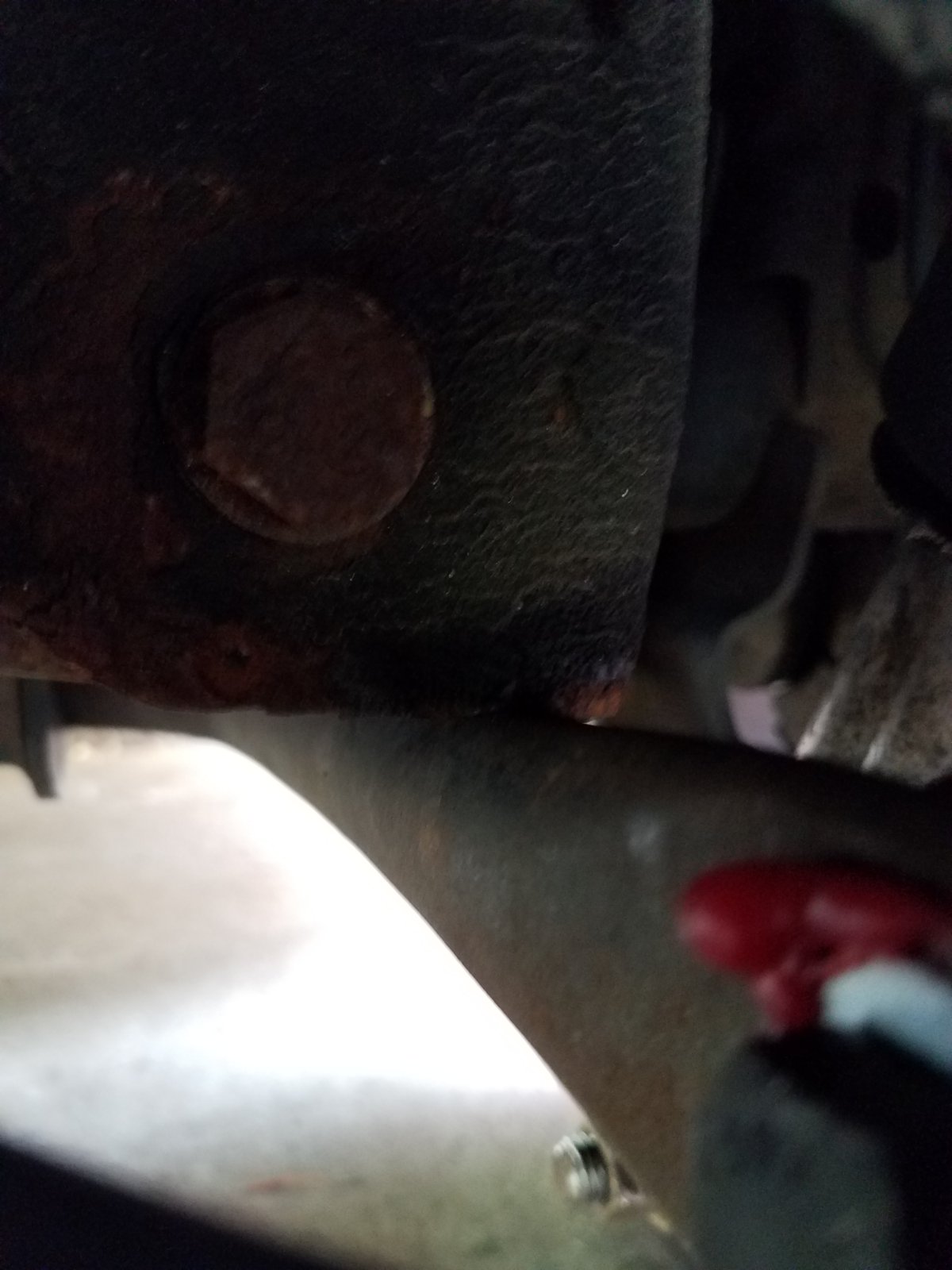

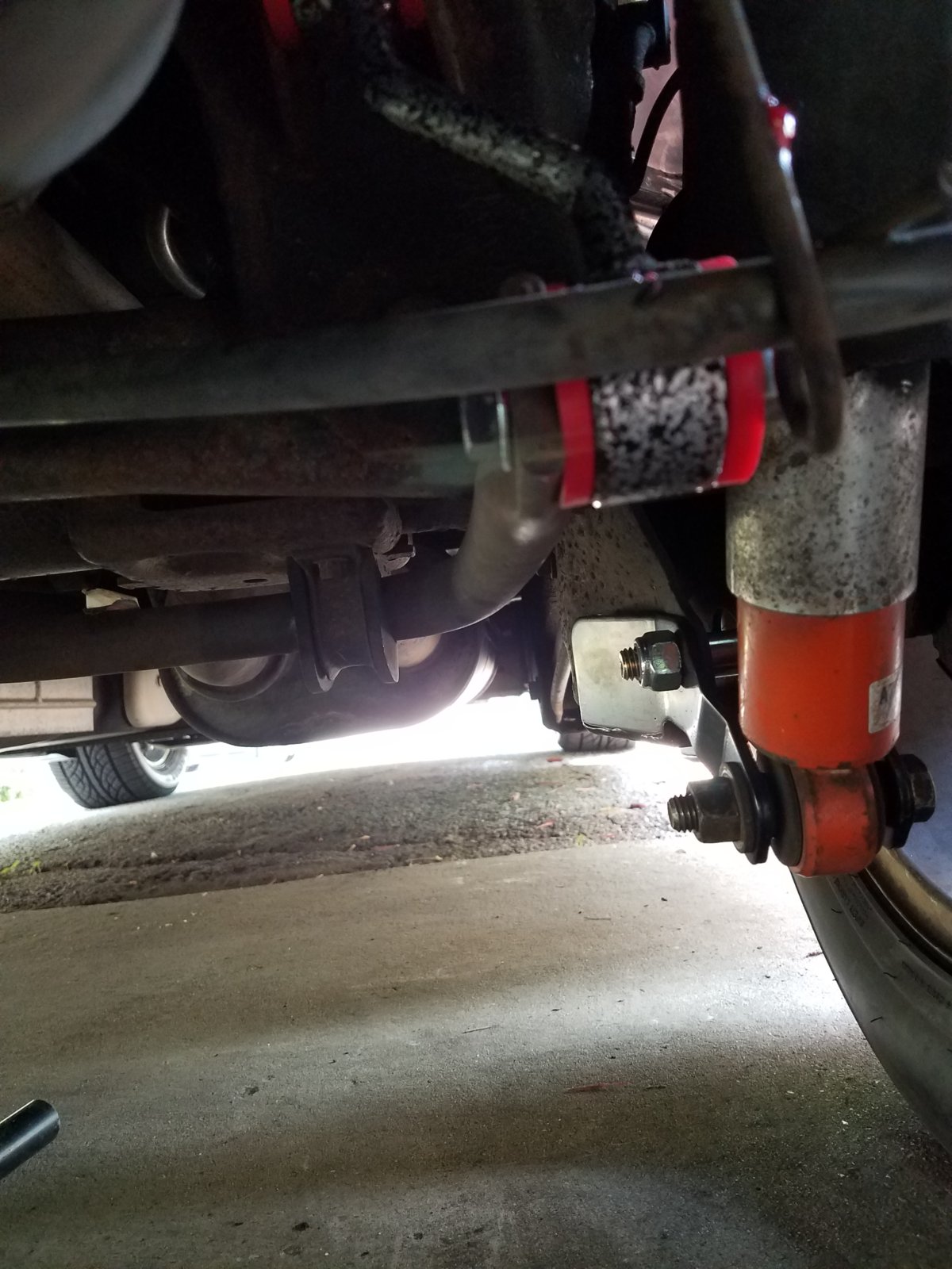

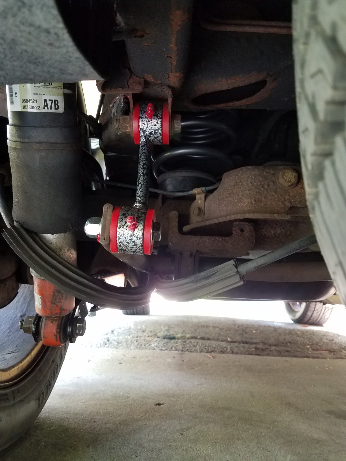

Driverside is clear of everything. However I see where the passengerside hits. It' the panhard mount not the axle.
When I am pushing the sway bar over am I doing so under max compression or do I let it hang all the way?

Yep, the ends of the bar (when you do the relocation) need to be on the other side of both mounts. I just made sure the bar was pretty close to level/axle was near ride height when I did mine

@04Huck is right. The bar needs to be on the right side of the endlinks. So it just needs slid to the passenger side and then reconnect.

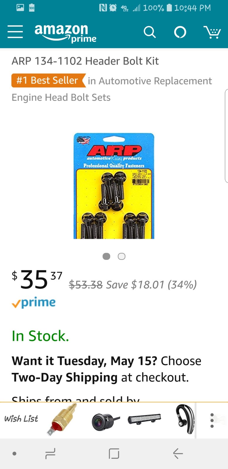

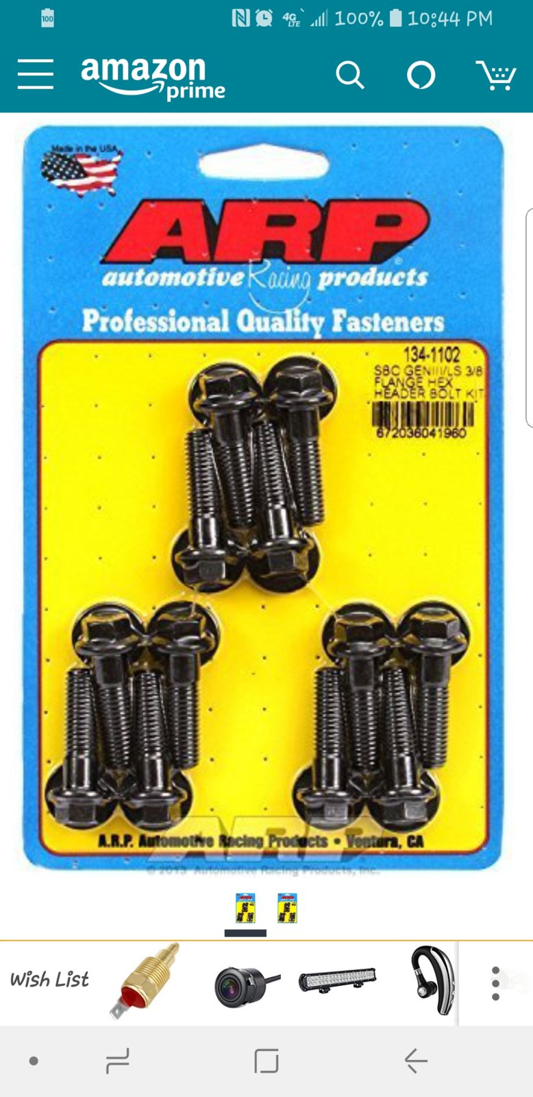

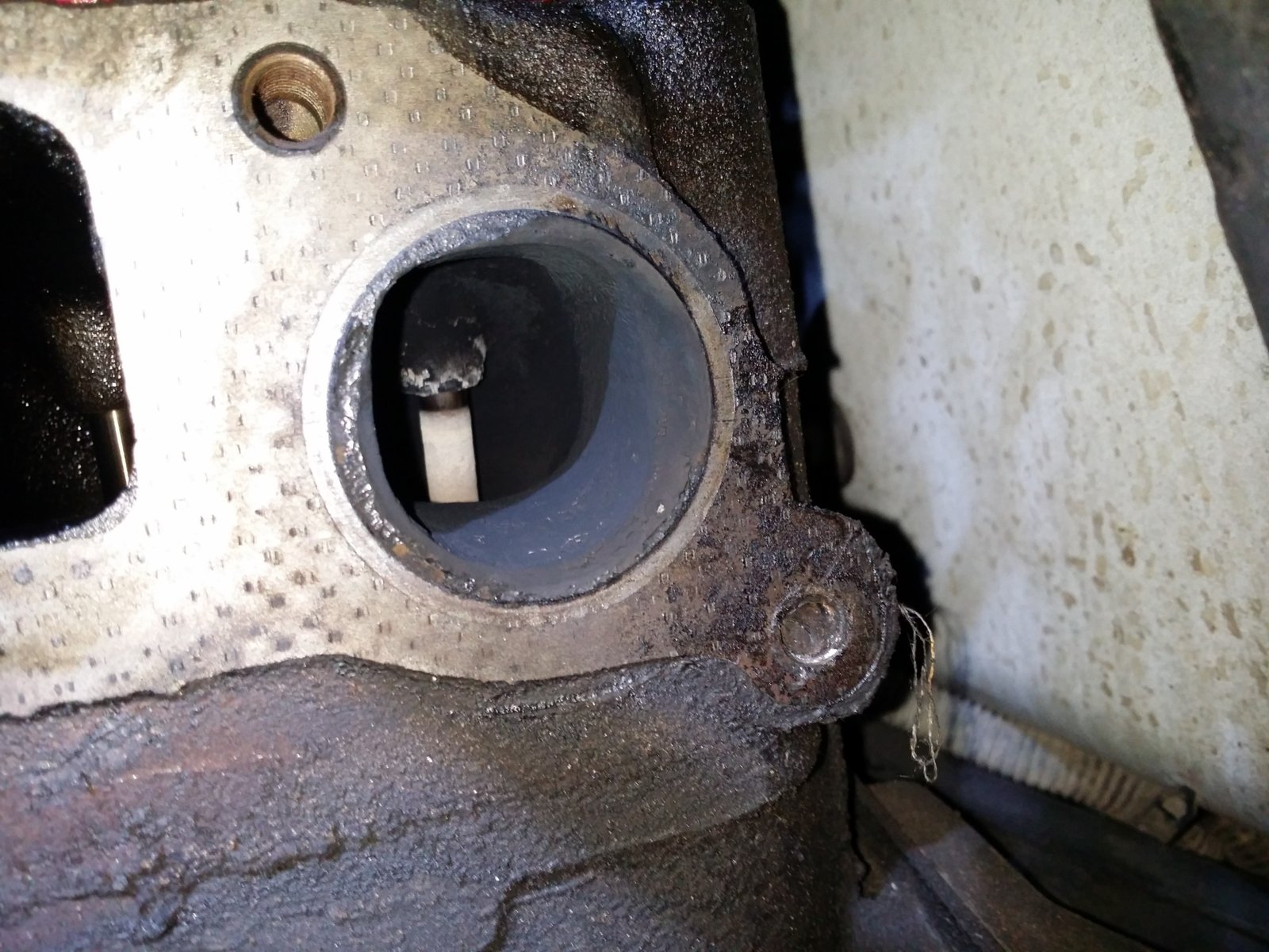

Unfortuneately I'm on a serious budget, those studs were expensive.

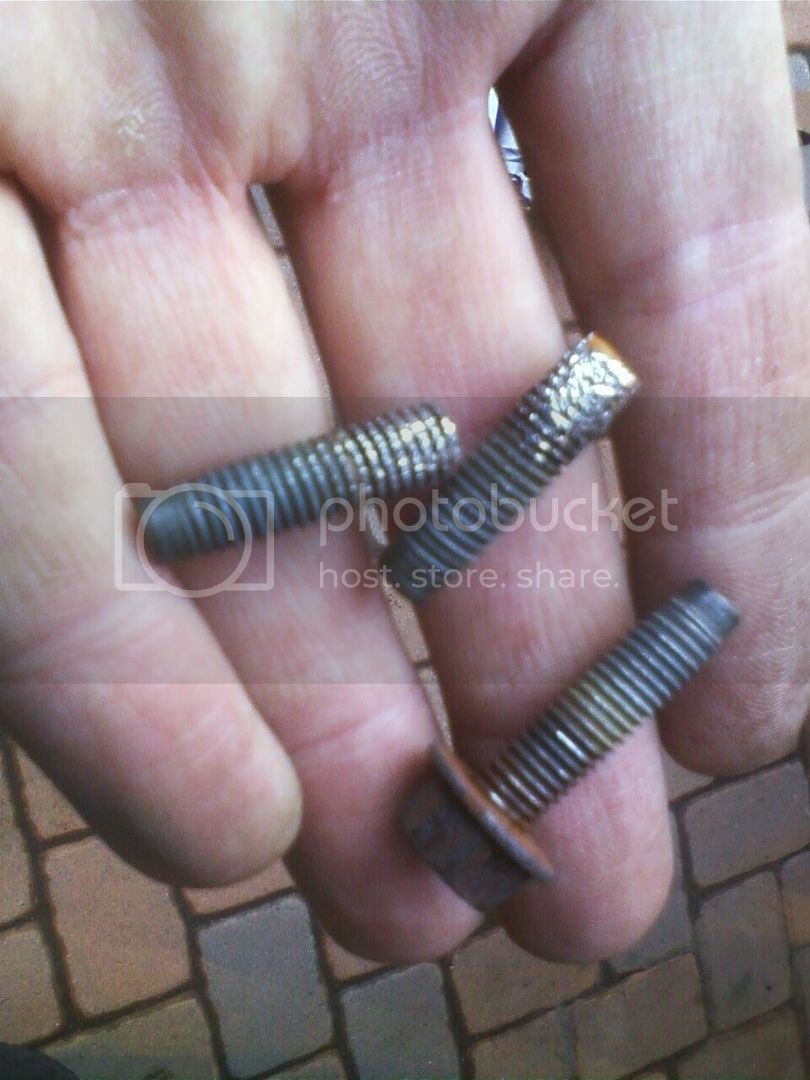

i got a set for like 12 bucks at napa a few years back when i did them on the work truck. it had 3 busted off bolt heads, it was time to pull that manifold off.

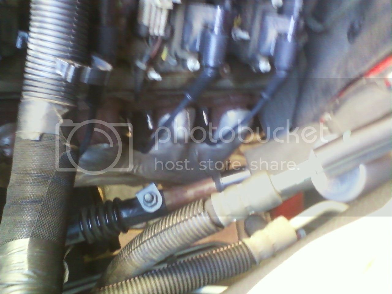

Ok, thought this was an exhaust leak because header bolts were loose. Tightened them but noise is still there. I can't tell if it's exhaust or under the valve cover. Def noise from the top end somewhere. Opinions or suggestions?
Hood closed.
I'm not a huge advocate of SeaFoam... but there's 2 things I've found it works really well for. Small engines and identifying exhaust leaks. Pull the vacuum line off the brake booster, let it suck up about 3 oz of it, then put the vacuum line back on.
That nice white smoke will billow out of whatever exhaust leak you have... if it's a small leak, the liquid will run out of the crack.
Like I said, not a fan of SeaFoam, but that's one thing it does quite well.
i would really recommend you use studs. they clamp tight and hold and dont break off.
Ye---wellll....... everything but the "don't break off" part.

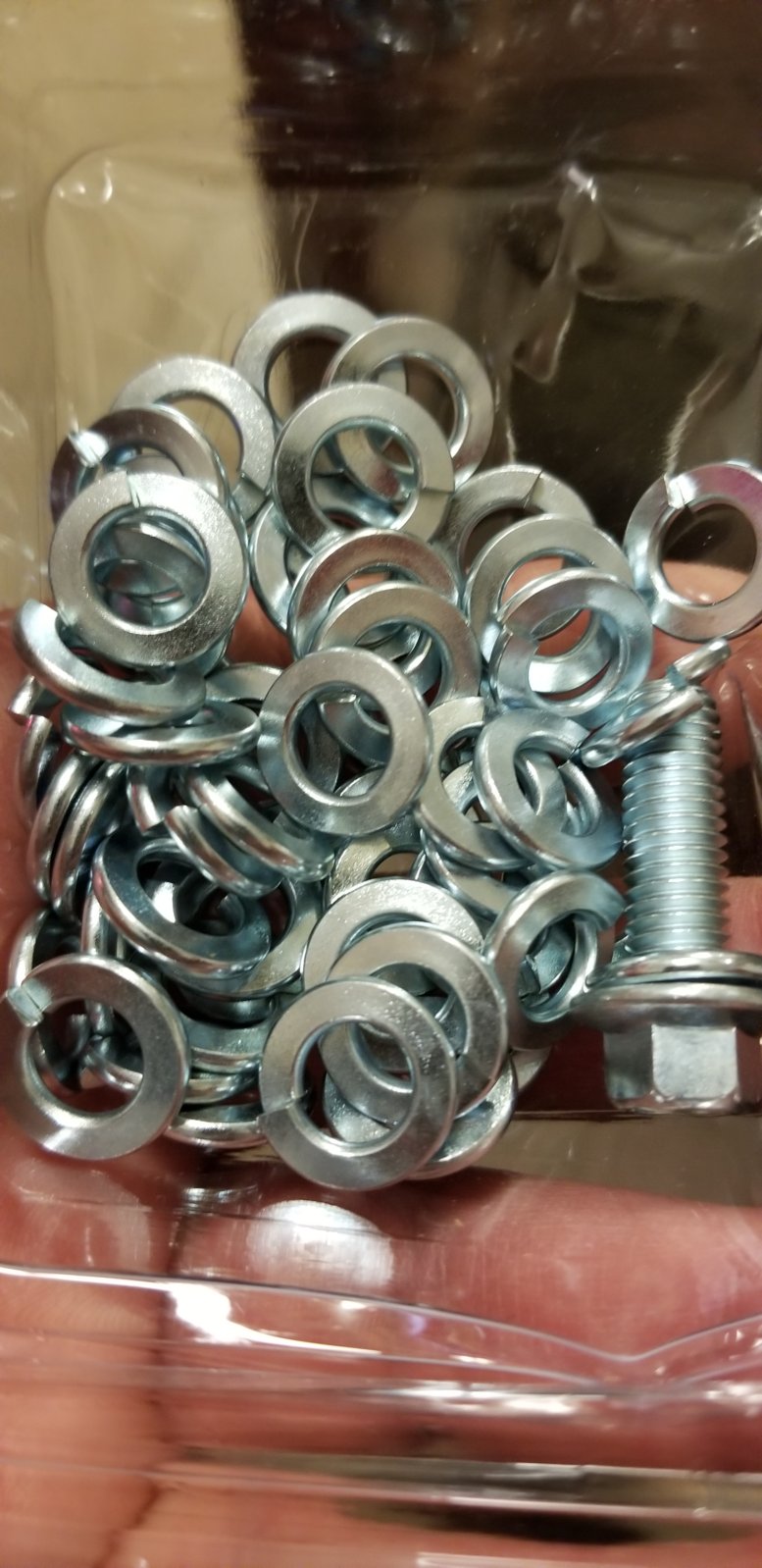

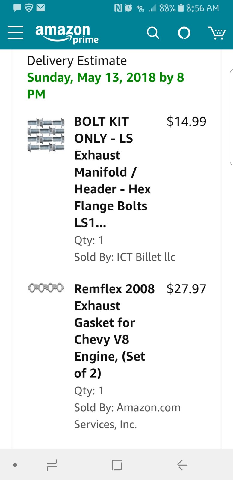

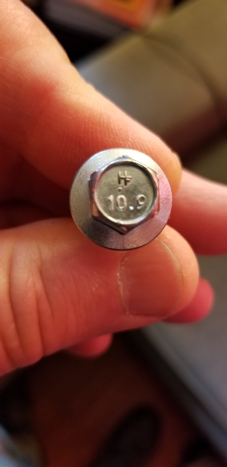

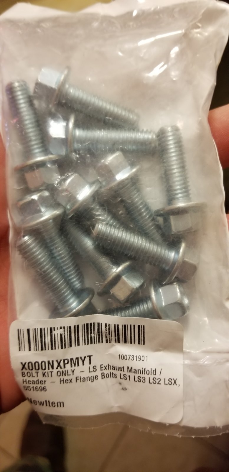

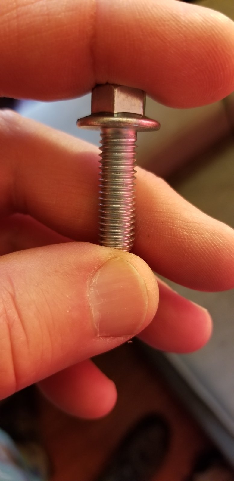

Got my header bolts today, still waiting on the gaskets.
I also grabbed some lock washers.
Nothing happening this weekend tho, rain on/off all weekend, and no garage.
