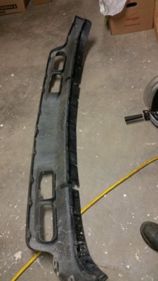

Up here to the right
Yeah, on 2 ends are those clips with screws and along bottom of plastic is a lip and every foot or so it snaps into the plastic lip. My 01 didnt have the slots so i just drilled holes near the air deflector slots and ty-wrapped it on. I trimmed mine for my plow. If you zoom in you’ll see where factory clips molded into plastic top bumper piece should be. @BADRIDES

I gotta get that air dam. Looks good.
It changes the look of the front in a good way. I'd say watch for curbs being lowered. I bolted mine up on both ends with a bolt and nut and used some self taping screws from Oreillys for the rest. It's on nice and solid.
