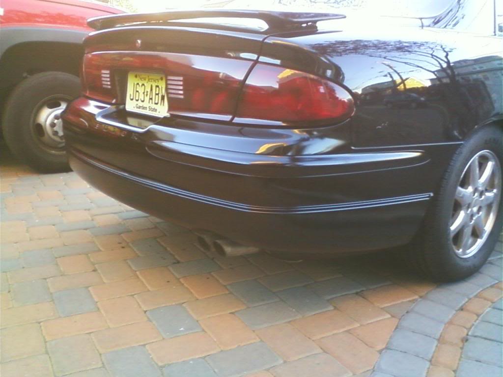

i got a HF dual action buffer. things worth its weight in gold.
i say grab some hd compound and a real buffer and get after that hood. if theres clear left it will shine.
when i first got my regal the paint was dead, it all came back.

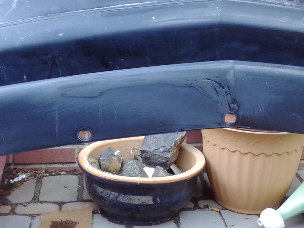

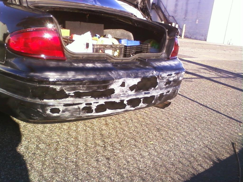

thats fixable all DIY style. you can lightly sand that area with some 2500 wet sand paper, then shoot it with clear, (most parts stores have clear in stock) then wet sand it again, then buff the scratches out.
i also went and repainted both bumpers off my regal, they suffered the old gm missing paint syndrome, i used rattle can duplicolor black semi metallic and you cant really tell i did it, not a pro.
bumper when i bought it, came from newark NJ, parking they were not good at.

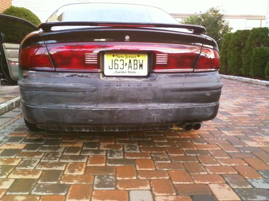

cut off al the nicks, sanded, filled.
last sanding.

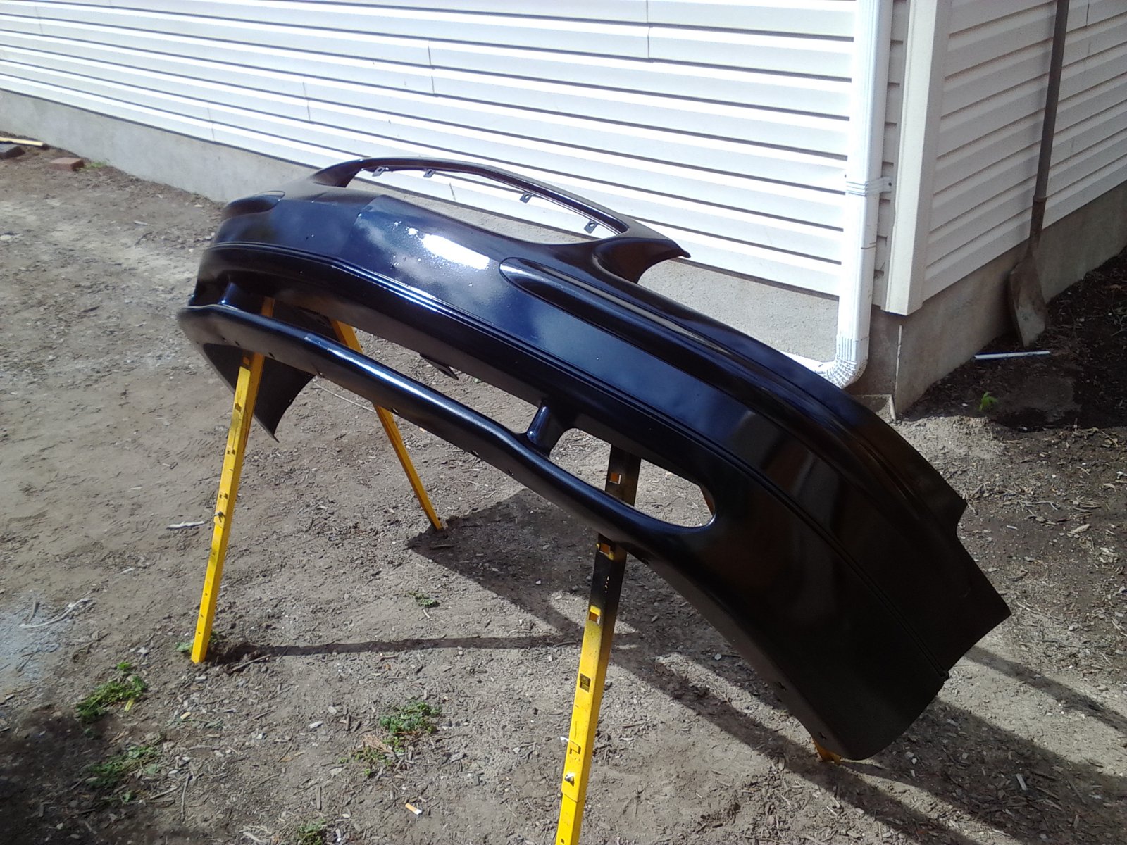

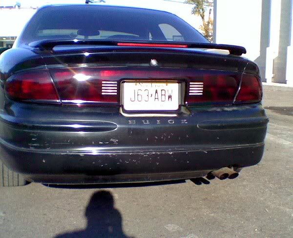

took it off, wet sanded the edges, final cleaning, then primed and painted, cleared and reinstalled it.
then wet sanded it and buffed.
this was my first shot at a large scale painting job, like they all say, its all prep, thats the work. painting part is easy.

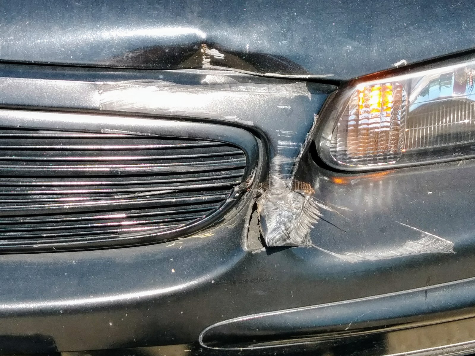

then just a few months back some dirt bag decided i needed my bumper and hood modified. my personal csi work tells me it was a pick up truck it bumper went past the edge into the grill area, then when he drove off his bumper caught and ripped my bumper.
i was pretty mad for a week or two. then just quit caring so much.

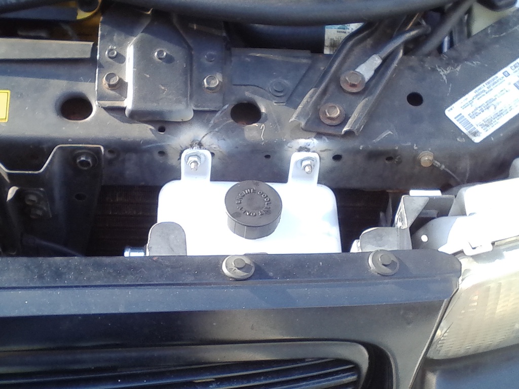

lucky they just missed my month old new head lights, but cracked my IC res tank that lives right in the crush zone there.
