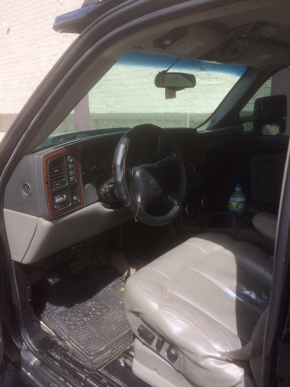

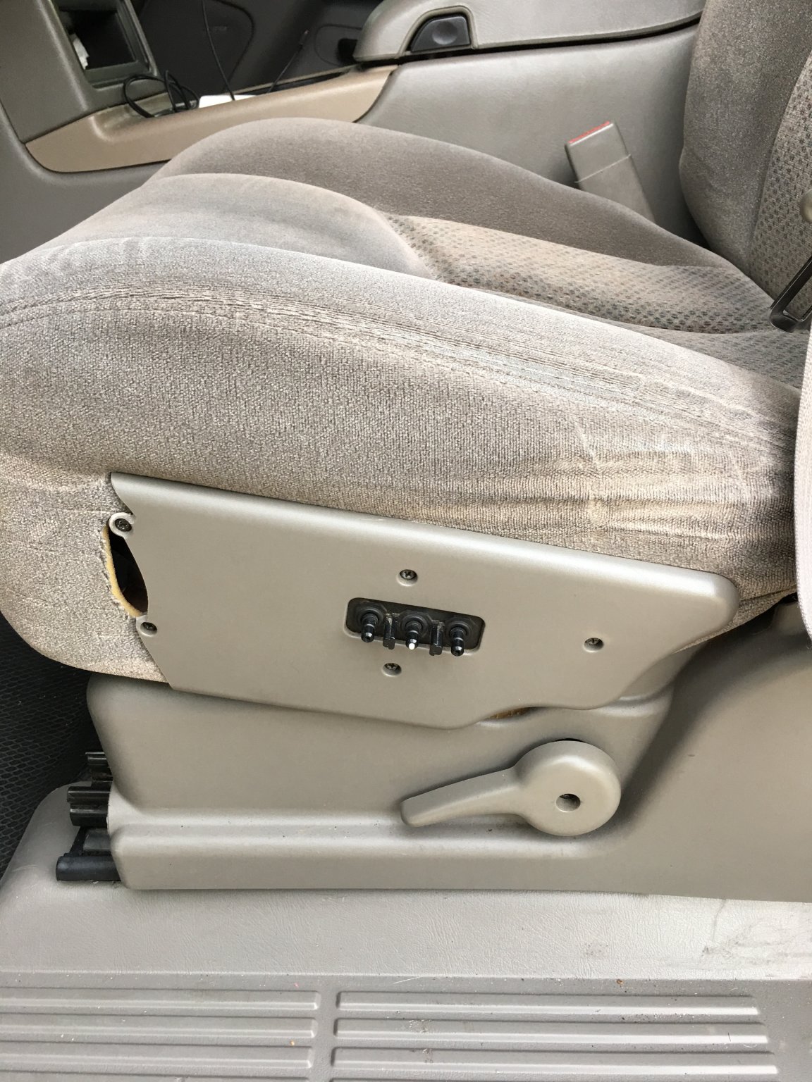

I finally picked up my interior trim for the driver seat. Brand new GM for $18.
33,199
51,441
GM dealer. How broken is your mom's? Is it the same style as mine? I'm guessing it is since it's a former fire vehicle.
33,199
51,441
Not too terrible. And I have the new switches too, just need to put them on.
My old one isn't terrible. Has a scratch and one of the inner tubes, the bolt holes, where a long screw goes through, broke off. That's why I bought a new one. If you want my old one, just pay for the shipping, or go to your local dealer, they'll probably still be able to get it for you. Let me know if you want it.

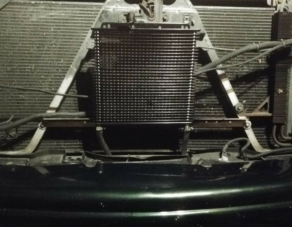

Added a larger Hayden trans cooler. Oem was half the size as y'all know. Only had to modify the top right corner for the grille to bolt back in. Question? Is the top connection at the radiator supposed to leak a few drops on startup after such an install? Leaked quite a bit until I had it warmed up, jiggled it around a bit and finally got it to one drop but that's at start up. Didn't drip on shroud or below after a 30 minute test drive. Was spotless before the install.
@TheAutumnWind is this the one you originally used? The Hayden 679 I believe? I saw some of your old posts and thought you had a significant increase in cooling. I don't tow anything and probably never will. I picked it up at Advance Auto with a $20 off deal so it was like $43

Either I damaged the o ring or I just needed to make sure it wasn't cockeyed as I know that causes leaks
There should be no drops. You might want to fix that before it leaks a lot when you're least expecting it.

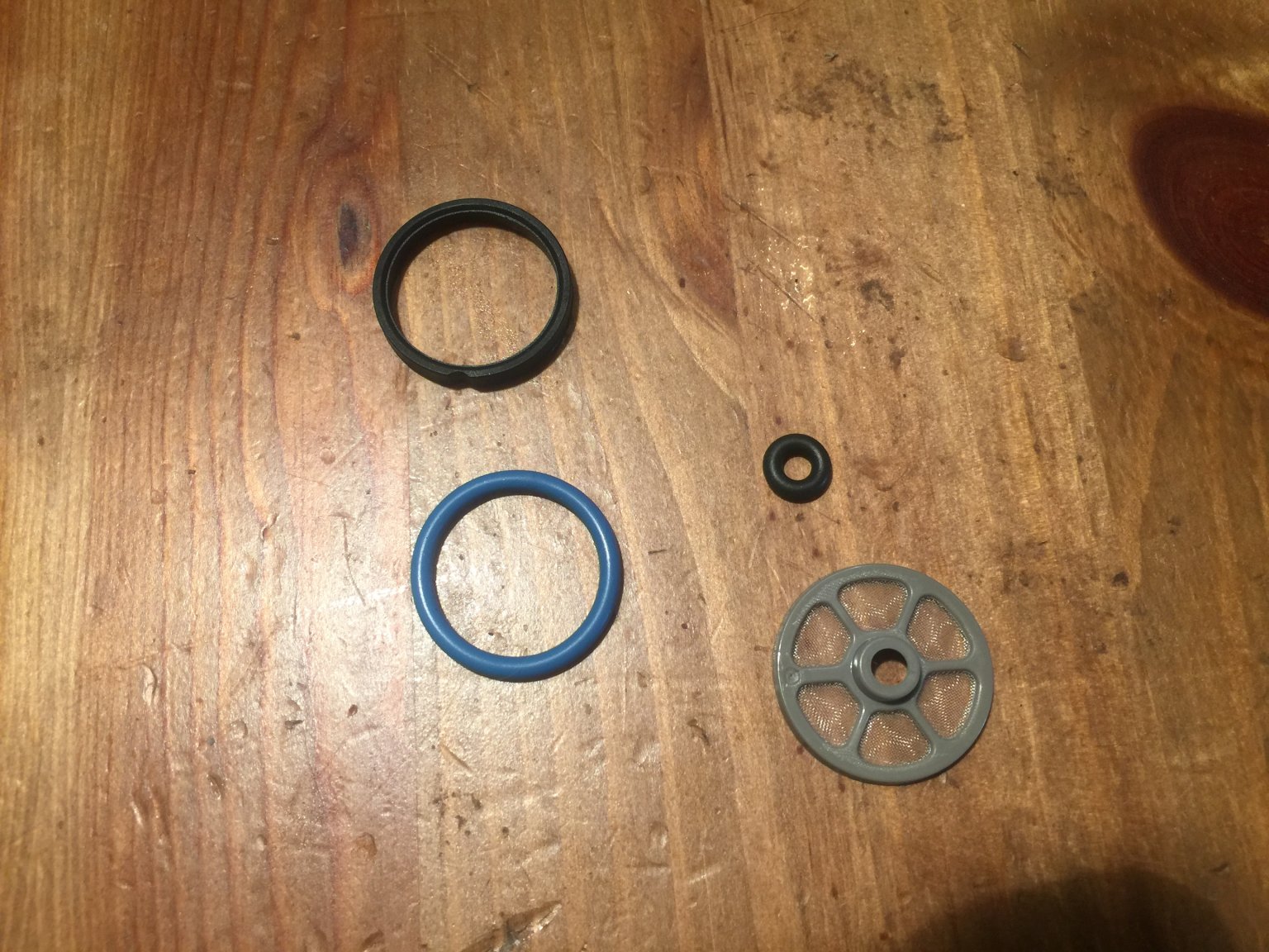

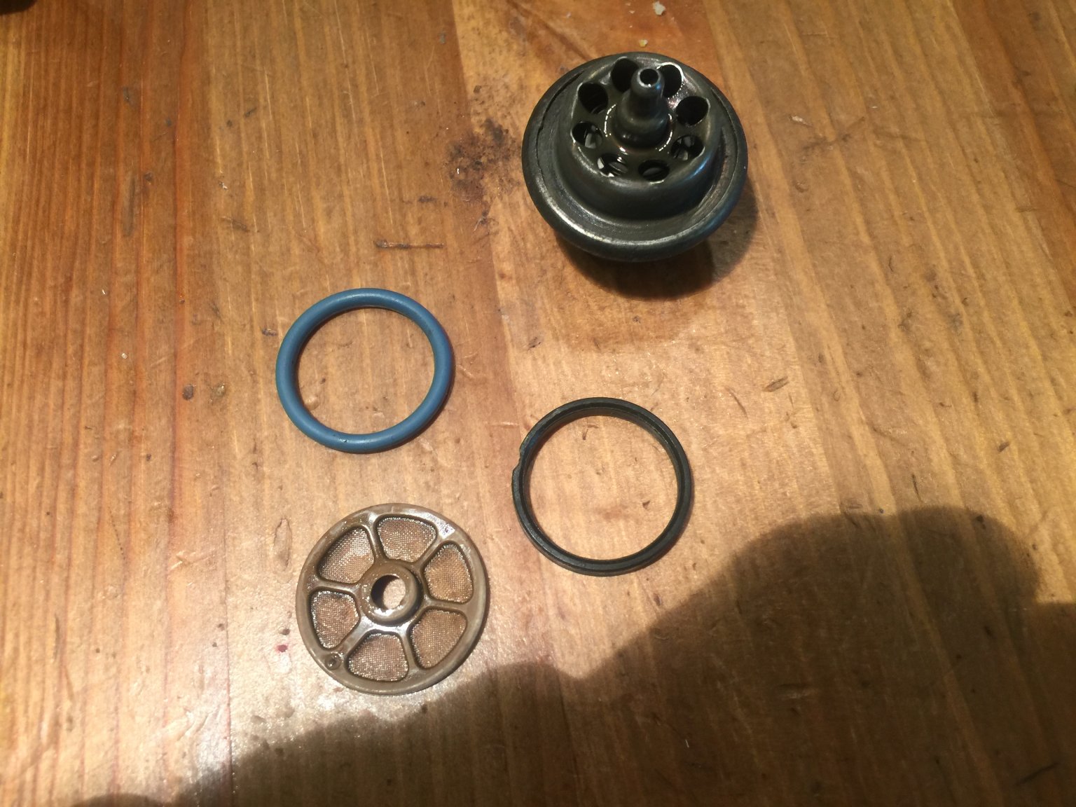

I removed my fuel pressure regulator and installed a service kit I just received. Seems that when I moved it from the old intake manifold to the Whipple fuel rail I left a tiny o-ring behind. Hopefully this fixes my fuel pressure leak-down issue that's causing a delayed startup.
When you installed the line, did you install the clip first and then push the line into the fitting until it clicked into place?
