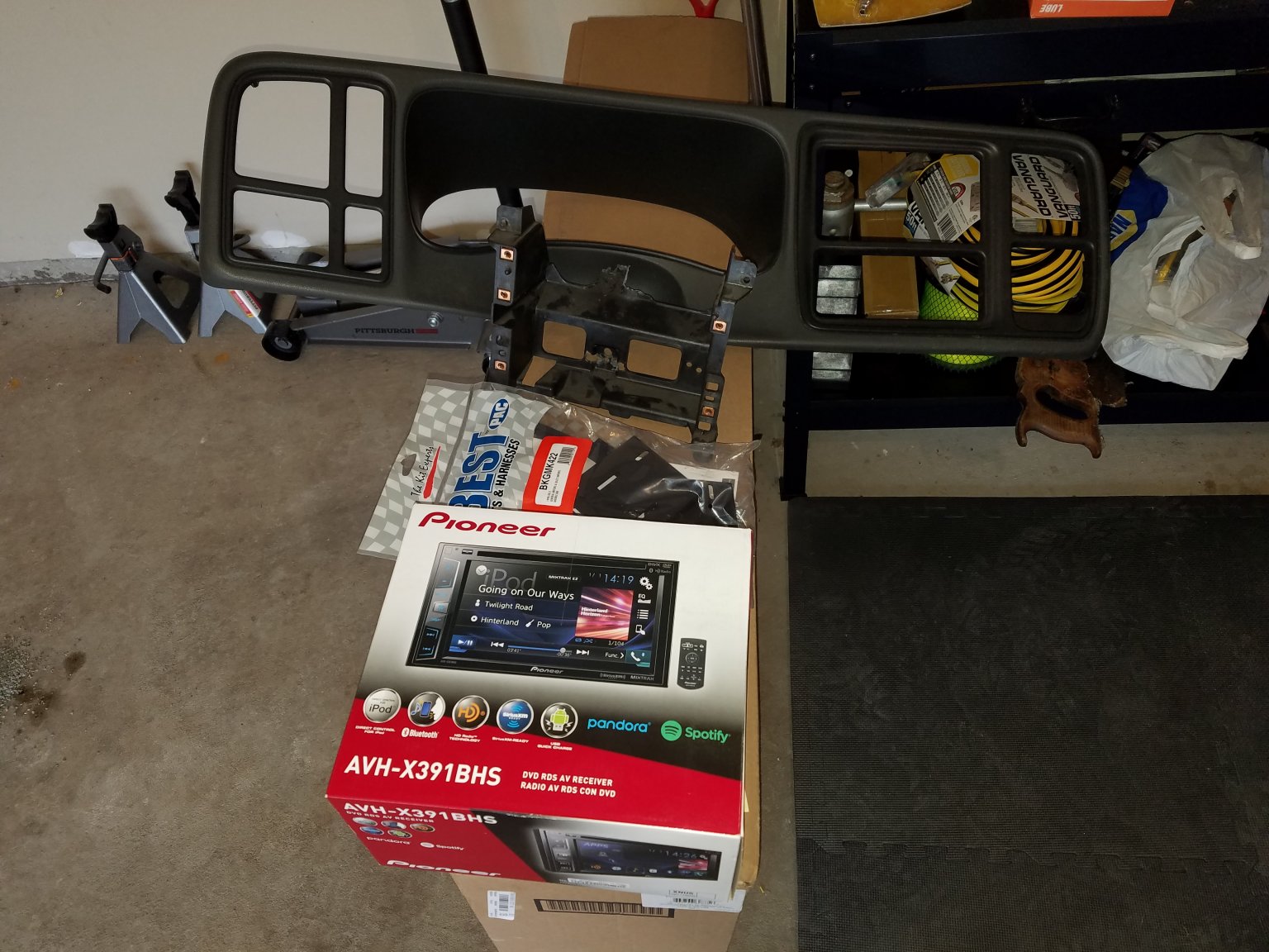

Well, I didn't do it to my NBS, but I did it to a NBS in the junk yard:
Pulled the radio tub, and the trim piece to retrofit my 2000 Yukon XL with a DD radio:
I have some dremeling in my future...

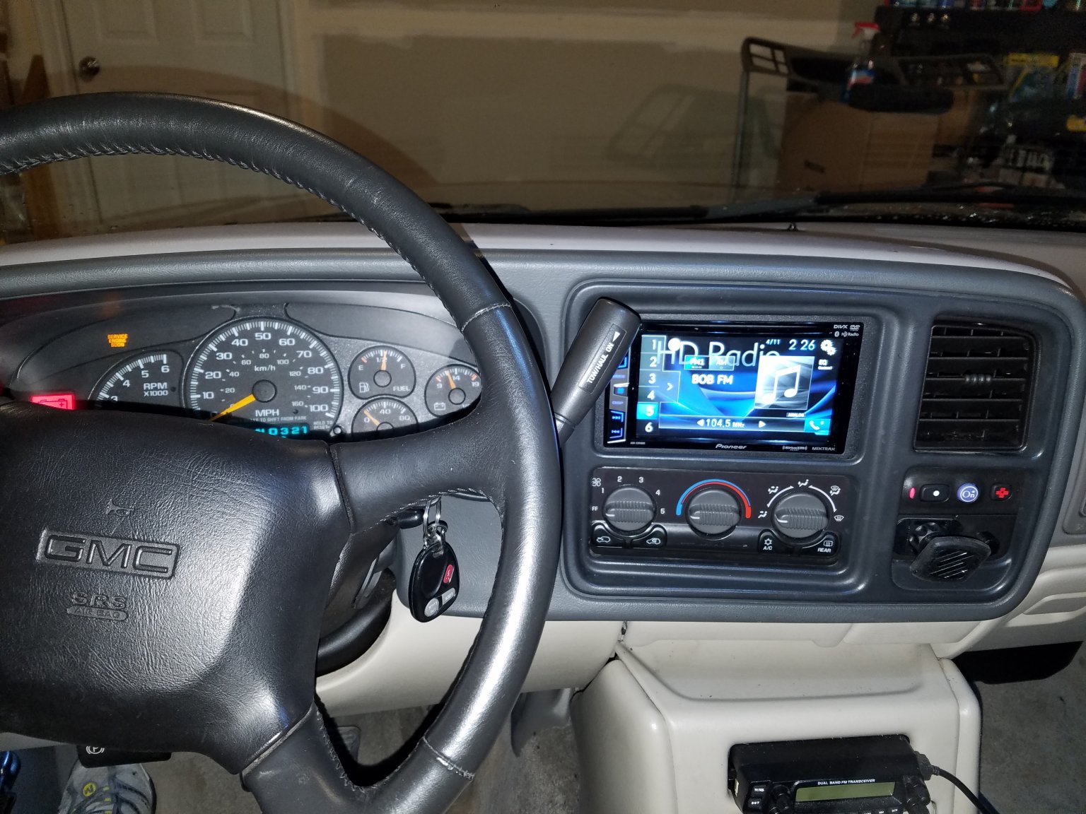

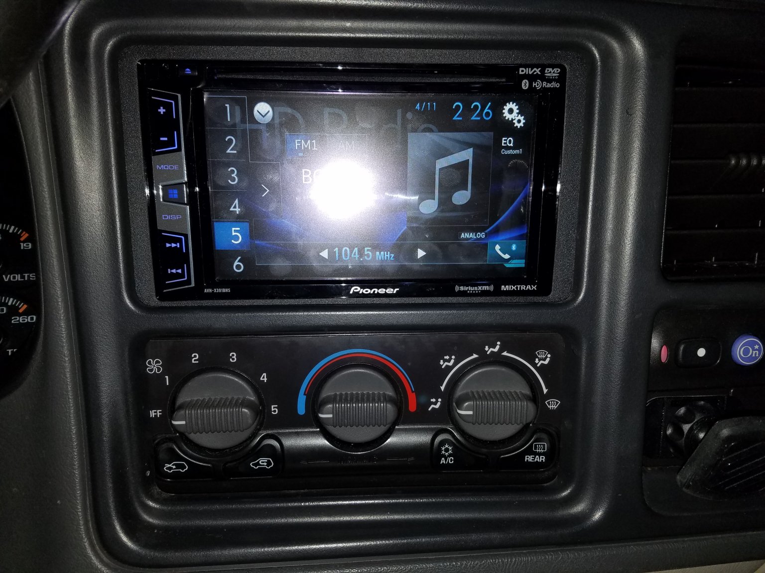

So I didn't wait to install the new radio until tomorrow.
After some trial and error, and much dremeling, I got the '05 tahoe radio tub and dash trim installed:

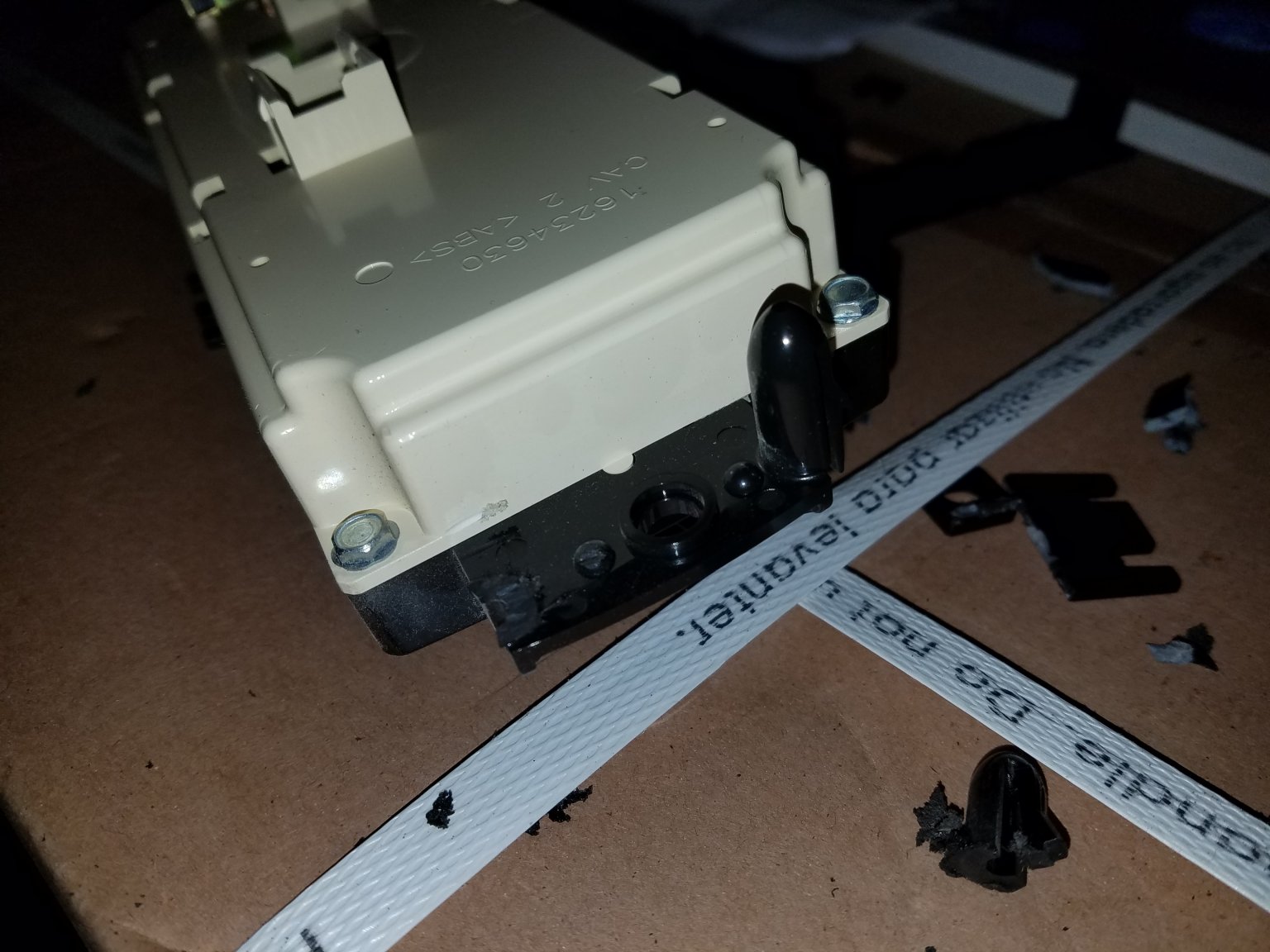

Had to cut the 4 peg/clips on the heater control:
As you can see, the heater controls aren't a perfect fit (and I had to use some foam behind the brackets to hold the control against the trim. Later I will have to get something a bit more solid.

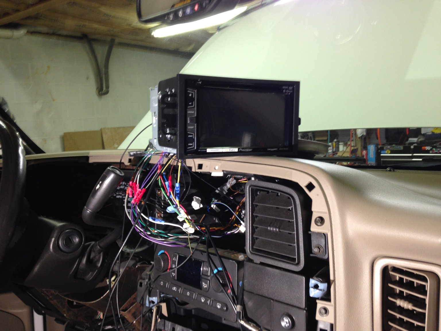

Part 2 :
Put the onstar mic inside the control box, and routed the new mic out in the same place :
Here you can see the crimp connectors a bit better, also, I've done this kind of thing enough to know that you test EVERYTHING before you button it all up.
I think we got the same radio, and I did the same thing with the onstar and pioneer mics.
