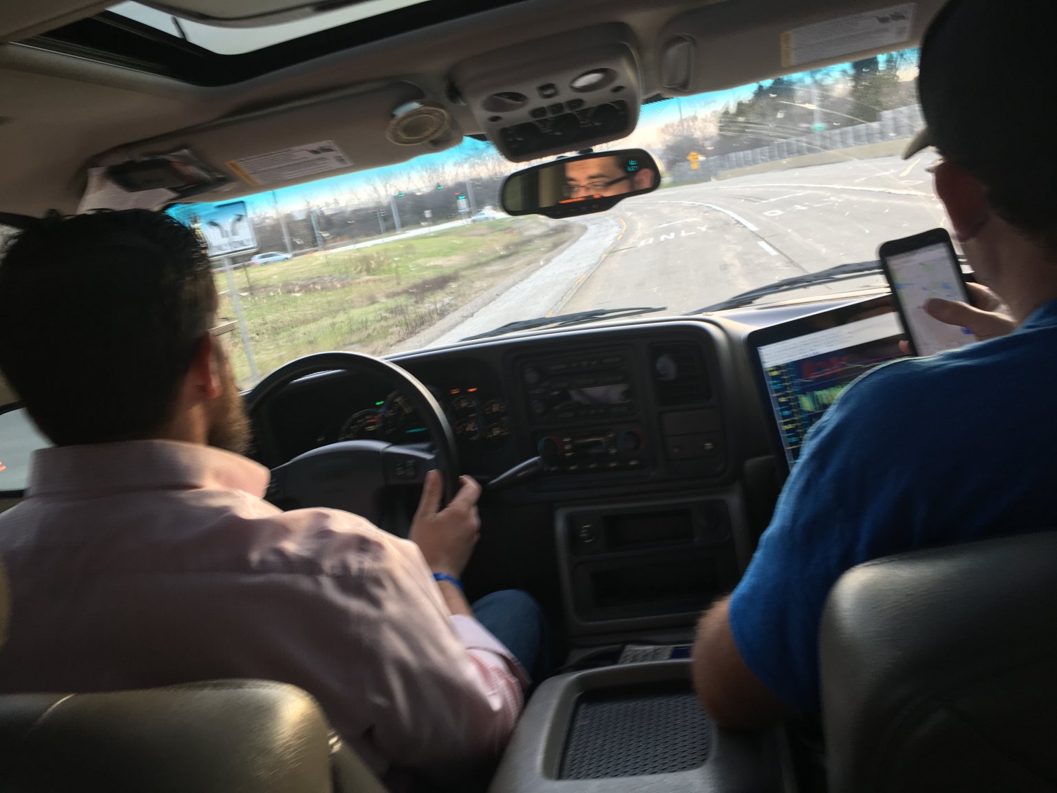

Swapped out the oil pressure sensor and then Met @Justin with Black Bear and got the Yukon tuned! Absolutely love the drivability now, So much smoother all around. Now I see what all the hype was about, well worth the money and 3 hour drive to get to him today. Wife took this picture from the back seat while Justin did his thing.

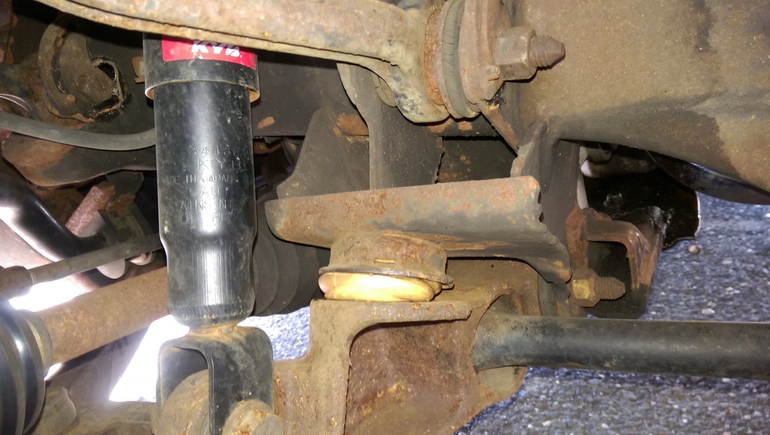

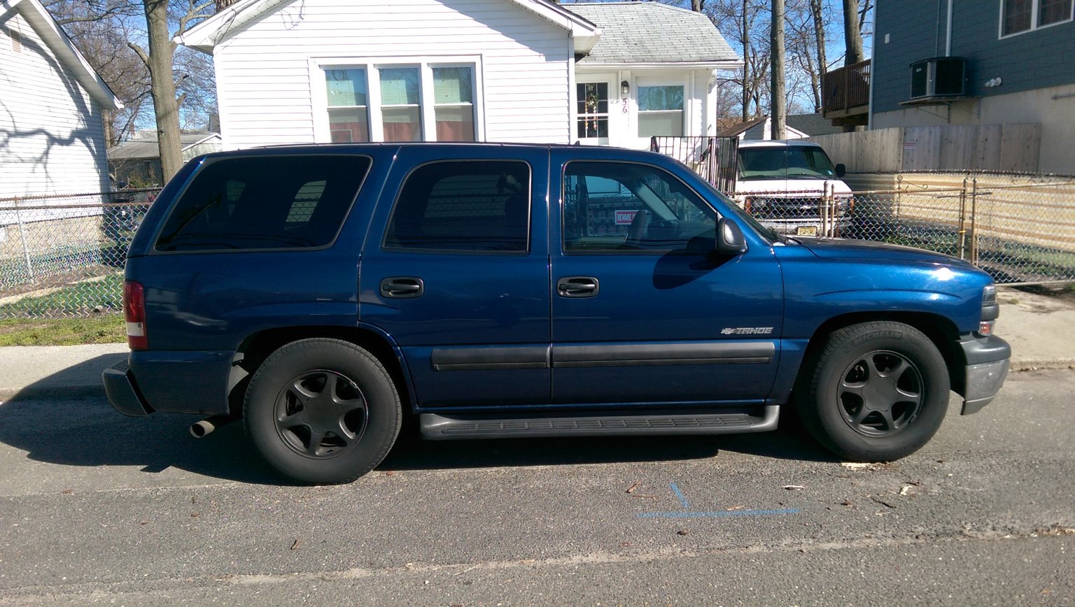

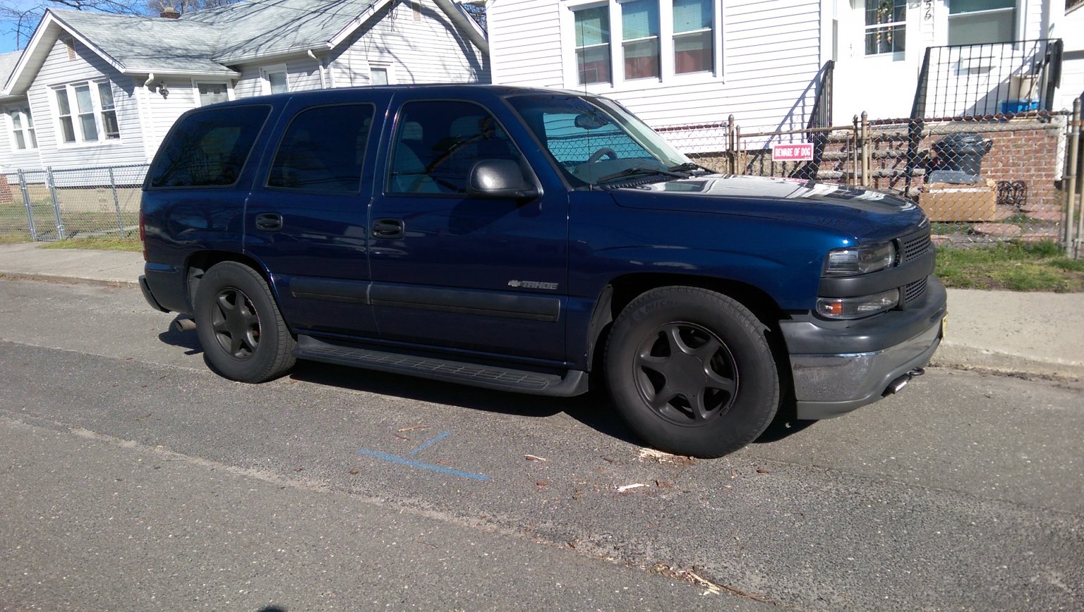

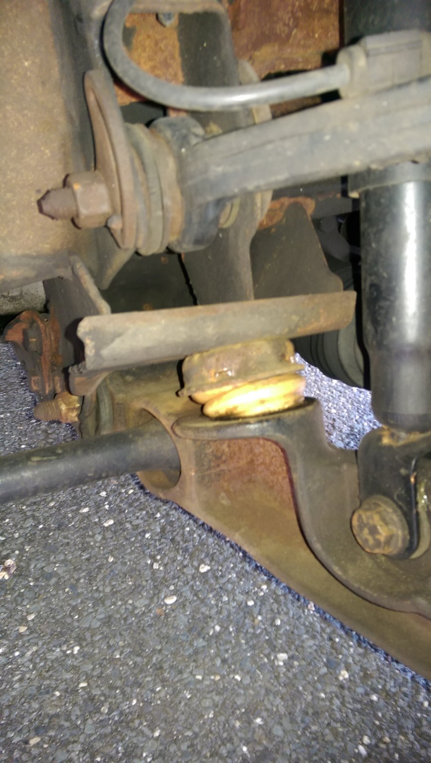

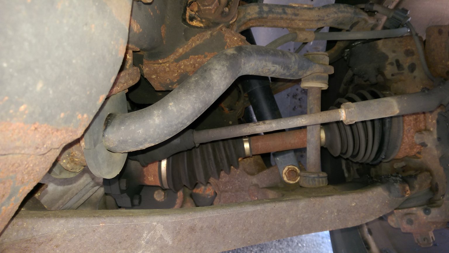

Cranked the keys. Six turns each side. Got me 1/2", front sits at 32 1/2" each side, but those damn bump stops are still squashed.
33,200
51,441

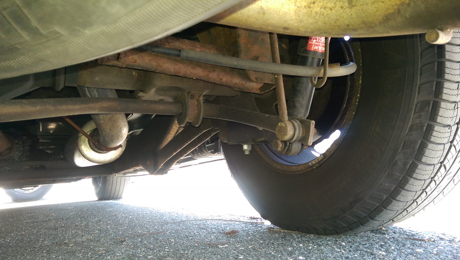

Just trying to get opinions : how do the sway bats look? Ends are too high?
Yes, I know I need to do the end links. Think they need to come down some? Took the pics after finishing the cranking of the keys.

You need to keep cranking the keys up. It doesn't look like you got anything close to 1/2" (it probably settled back down) and you seriously need to get some of the pressure off those jounce stops. I doubt your torsion bars are doing much, looks like the jounce stops are doing it all and that's got to be a bad ride. I wouldn't fix the swaybar end links until you get it riding right so you can get the ride height set first then measure for the end links. Still rides like crap I bet, doesn't it?

I jacked it up, used Jack stands, let it rest on the stands then cranked rack adjusting but the same amount of time on each side, let it down, took it for a ride around the block, then measured it again. I did that three separate times. Doing all that got me 1/2" out of it. I'm sure it still rides like crap. I didn't want to crank it up too much, I like a little bit of rake to it.

You need spindles man.
