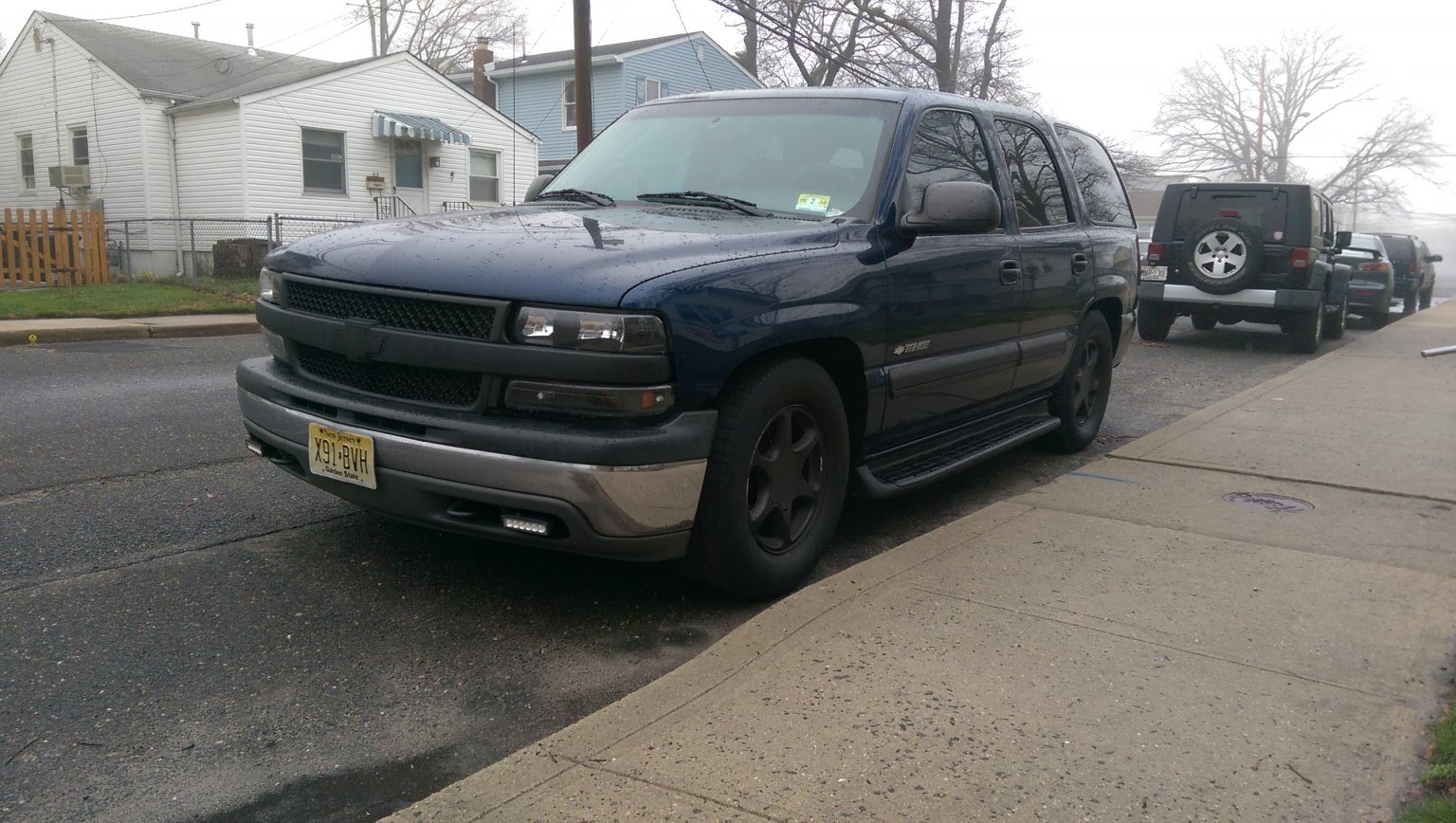

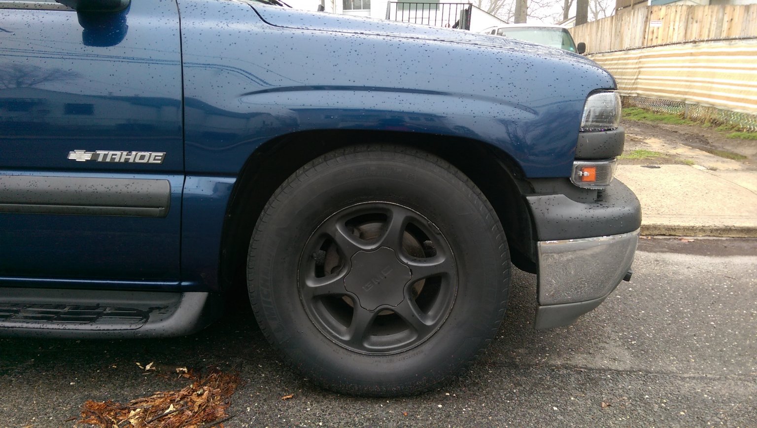

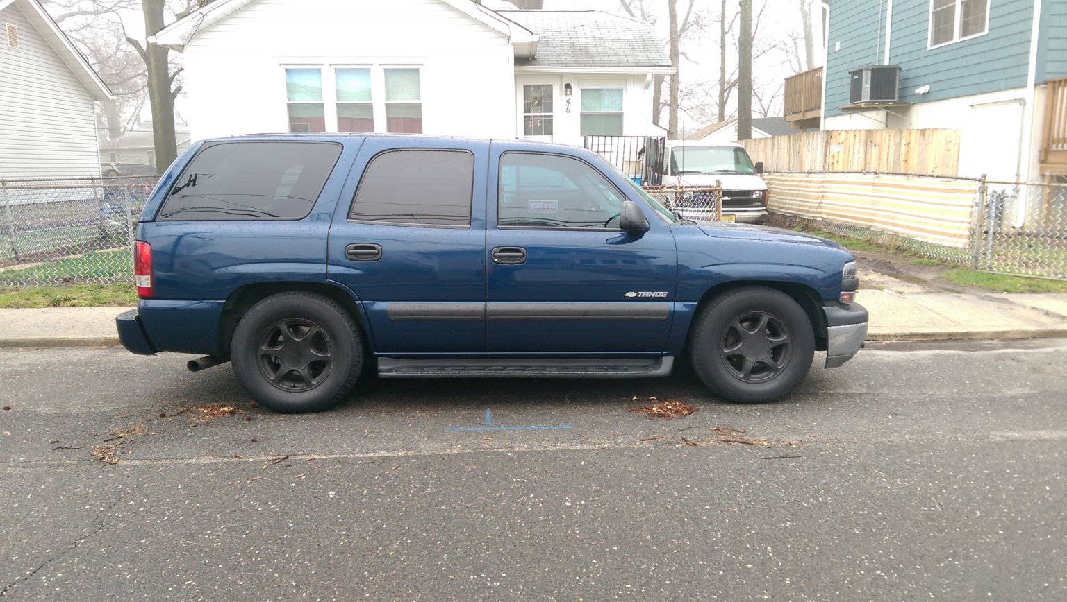

I'm lowered 2 inches in the front with Belltech drop spindles and I need new jounce stops. I DO NOT want my front end raised up cause mine finally sits like I like it. The factory stops are 2 7/8 and those in your pics are 2. So what to do?
Have you adjusted the torsion bars at all? If not use stock ones. Worst case scenario you trim 1/2 or something.these things are foam rubber you could trim them with a dull steakknife.
Torsion bars have not been touched. I like the look of the 2 inch ones but dont want to be too short but the stock ones seem to be a tad too long and then you have to trim those depending on if it raises you up or not which I dont mind doing.

Looks like you can raise it up 1/2" and it will be level. That should make it ride better, get the jounce stops a little relief, and you won't need an alignment. That's what I would do anyway.
Ok, guess that's the plan then. I don't need that special tool do I? I can just use a regular ratchet?
