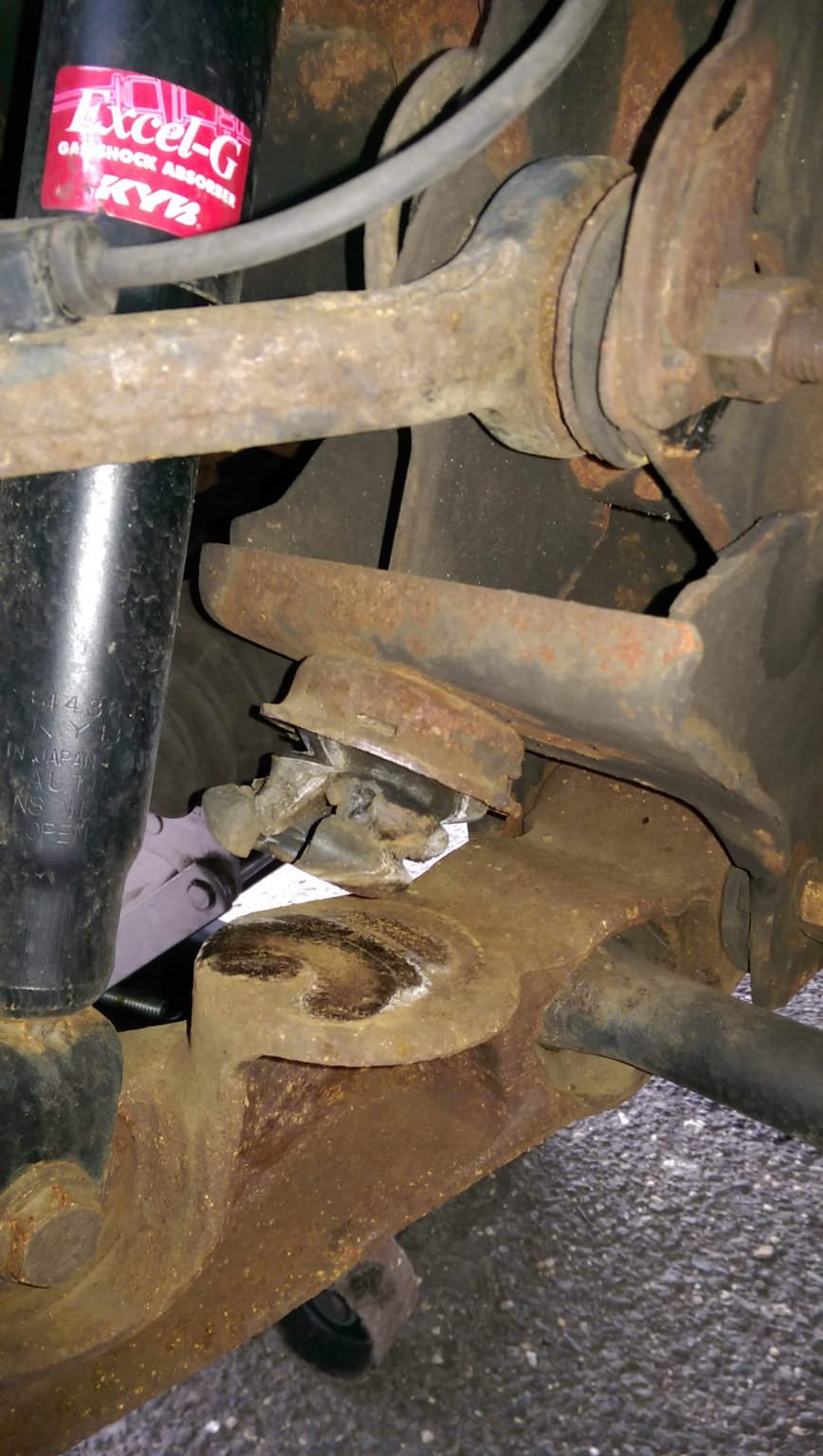

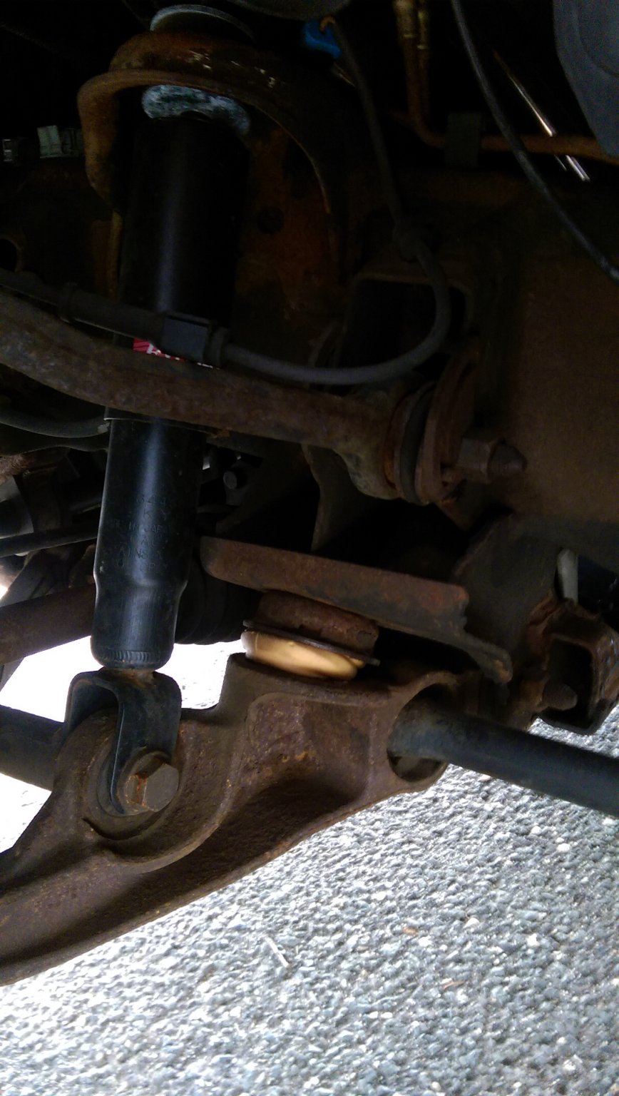

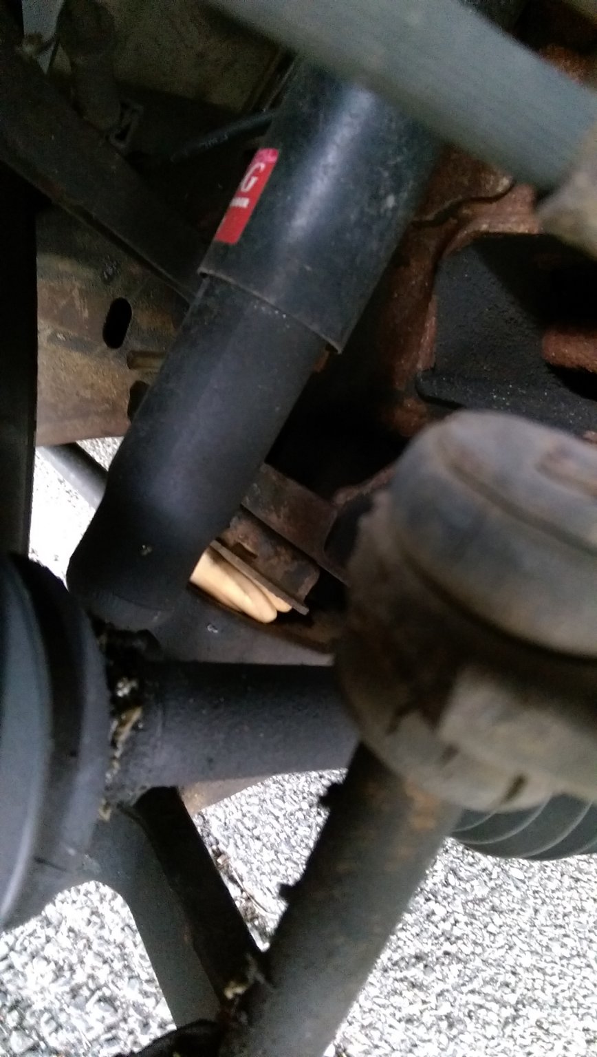

Hey @Red Rocket, @Fosscore I finally got the other bump stop today. Took me like 10 mind. Took it around the block, which was great, but I can't wait to see how it'll feel on the highway. Big improvement around the block. View attachment 78485Driver side.
Passenger side.
View attachment 78488 Driver side.
Passenger side.
Raised the front up a little bit too. Maybe 1/4 or so.
whoa you are seriously decranked. Should just barely be touching those @ stock ride height.
no wonder your ride is bad.
Passenger side.
Passenger side.
Whoa I see why your truck rides like shit. You're gonna wear those new jounce stops out in no time with your keys backed out that far. That's waayyyy too much pressure on them. Seriously need drop spindles if you want to go down that far. You'll never be happy with how it rides sitting like that.

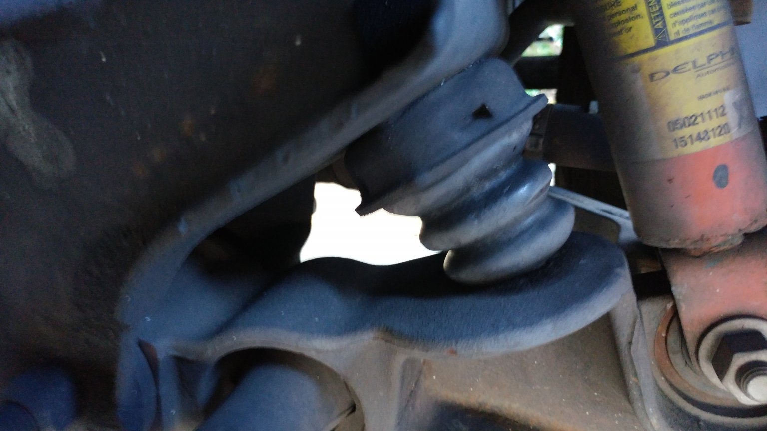

imag1990-jpg.78486
You can see the mark where the metal cup that holds the jounce stop is hitting... you're getting metal on metal contact. Some better shocks might help the ride too.

Yup, I def wasted my money on those shocks! Think I should crank those keys up a hair?
TheAutumnWind
Jan 8, 2015
3,254
1,996
Well it currently doesnt matter what shocks you have when you are decranked that low. There is almost zero uptravel, probably taking any normal shock completely out of its intended travel and bottoming them out. Atleast you arent wrecking expensive shocks!
I'd definitely crank it up as much as you are willing to until you get spindles or something. How low are you in the back? I forget the stance of your hoe.
33,199
51,441
Rear is 33 1/4 now, was around 35 1/4 before. Front is 33 1/8, before was 35 1/8.

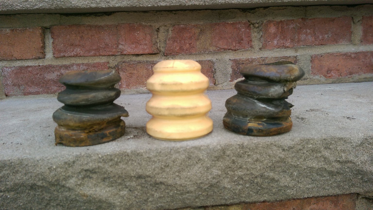

Passenger side.
Passenger side.
Are they supposed to be compressed that much?
52,949
This is why it's advised to only drop 1" or so on keys alone. Maybe a bit more but not much.

52,949
I'm lowered 2 inches in the front with Belltech drop spindles and I need new jounce stops. I DO NOT want my front end raised up cause mine finally sits like I like it. The factory stops are 2 7/8 and those in your pics are 2. So what to do?
I bought stock ones and trimmed them because they raised me up a bit. Not hard to do.
