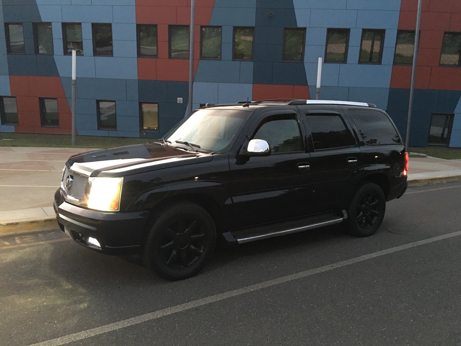

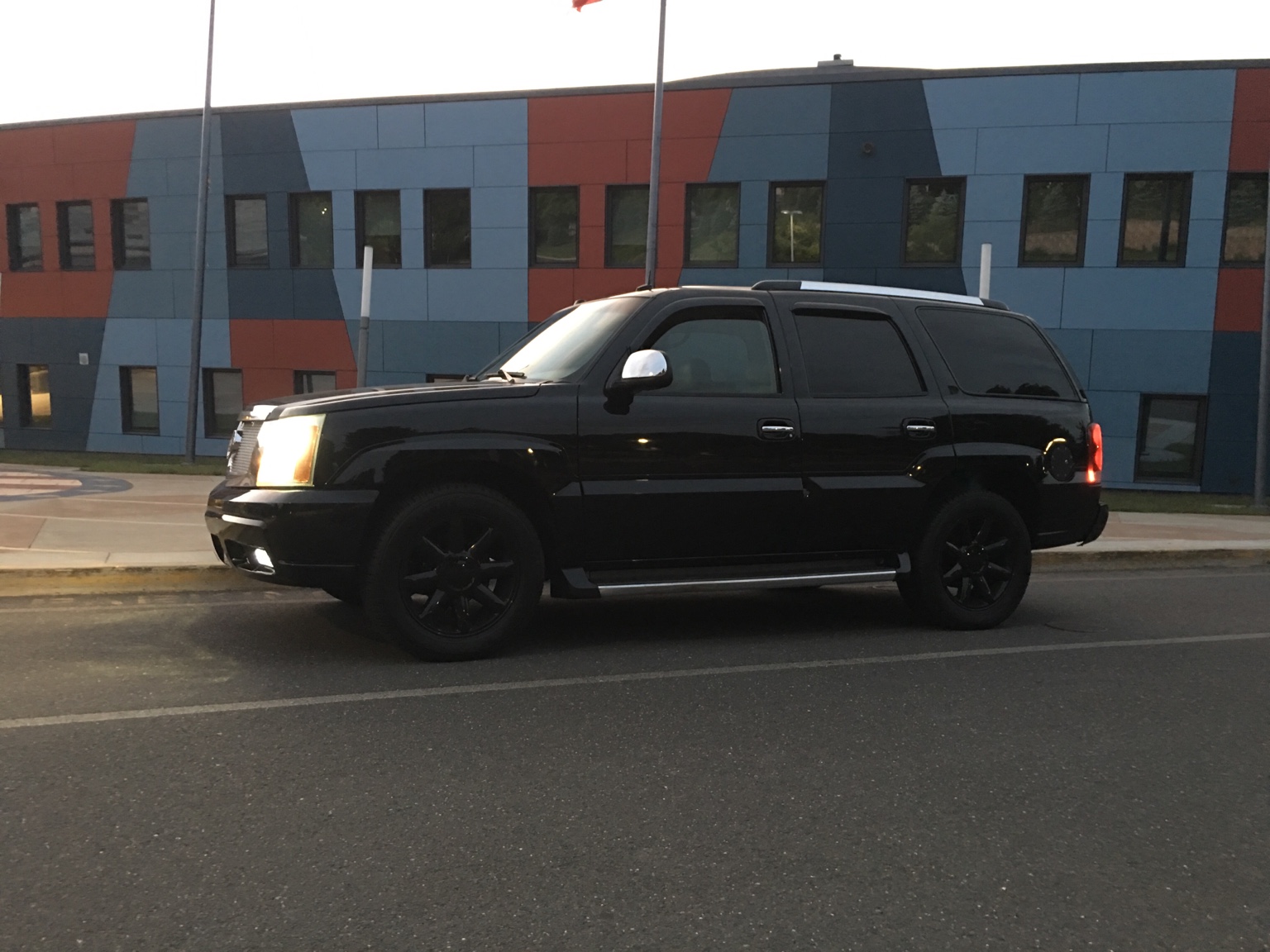

Debadged the Escalade, ditching the chrome mirrors & gas door next

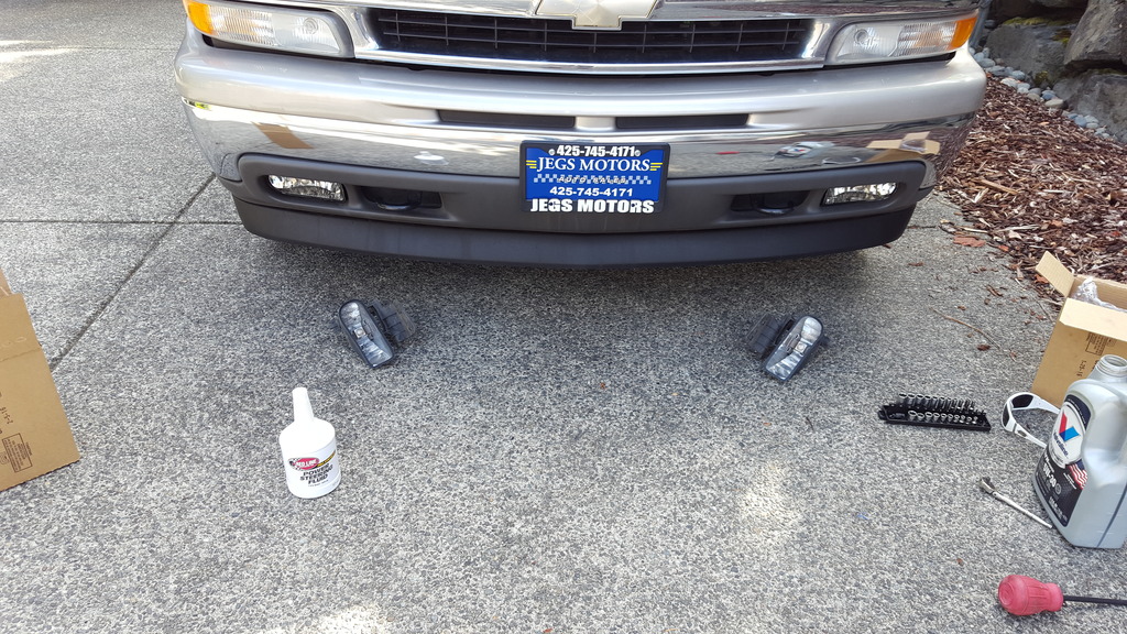

Replaced the fog lamps and changed out the p/s fluid in the reservoir. I don't feel like disconnecting lines and whatnot so I'll be using this method, repeating daily until clean. I'll probably continue doing it every other oil change after

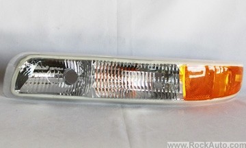

It's 11:20 PM here... I just went back form the garage. I've replaced my old faded parking assembly by new ones from Rockauto. I took the cheapest ones. They are made in Taiwan, are written export on it, and the shape for the bulb socket doesn't fit with mine although it's still easy to put them in place.
I've then put some LED bulb inside and at the rear. I used 3156-CW18-T cool white for the rear backup light. Would fit also in the turn signal but only have 2. Next time may be.
I've got a question.
When i look at the parking light assembly, I see three spots. The orange on the right, the middle one and the center one. (the picture below shows the driver side assembly.
On the right i see the side marker case in orange.
The middle housing is for the front turn signal right ?
The center housing is for the parking lamps.
The fact is I have a three wires socket that goes into the center housing. The bulb that is in it is a 3157. I though it was a mistake since this housing only has one feature. I placed in the socket a 3156 bulb. It doesn't work. It doesn't lit up. This mean I use a dual bulb for only one feature.
Does this has a dual feature in your country ?

The inner lights are daytime running lights from factory. Only light up when daylight and in any gear but park.

Thanks.
DRL were illegal back then. That's why it has been deactivated when imported in Belgium. The parking lamp feature works only. I'd like to re activate the DRL feature. Is there a fuse dedicated to the DRL?

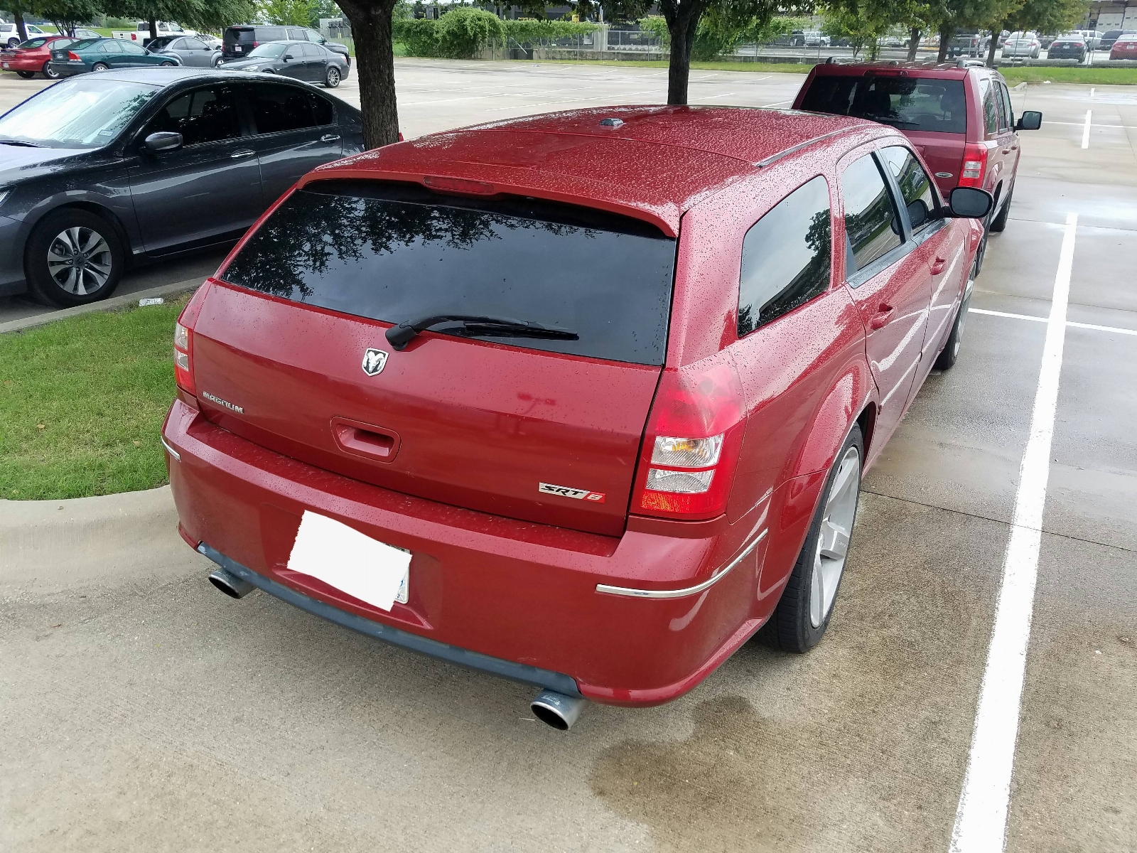

I removed my rear wiper and filled the holes with plastic plugs. I'm going to look for someone who can weld an aluminum backing plate inside the door so my bodyshop can fill and paint it. I was so tired of looking at that wiper that I never have used.

Mind sharing what plugs you bought? Thinking about doing this to mine as well @Red Rocket
Hahaha well... I bought about 30 different ones at my local Ace Hardware. The hole sizes we are left with after removing the hardware is one @ 1 1/8", one @ 3/8", and three @ 1/4". I couldn't find one at 1 1/8" so I bought a filler-ring thing that reduced the hole to 1" and used my angle grinder to modify it and make it work, then used a 1" hole plug. The others were just panel clips for the appropriate size holes I think. I just bought everything I thought would work.
