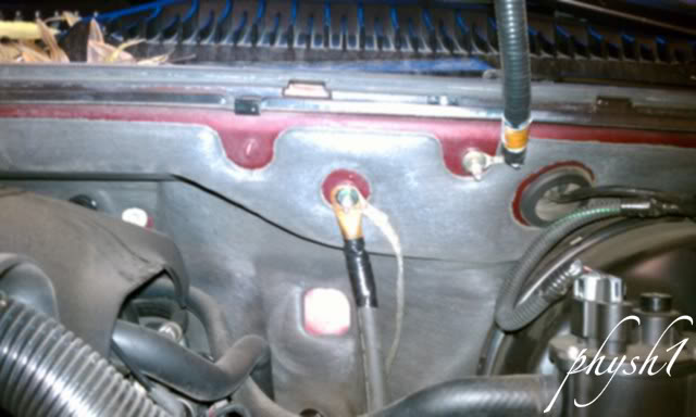

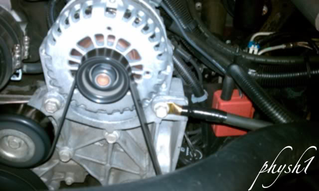

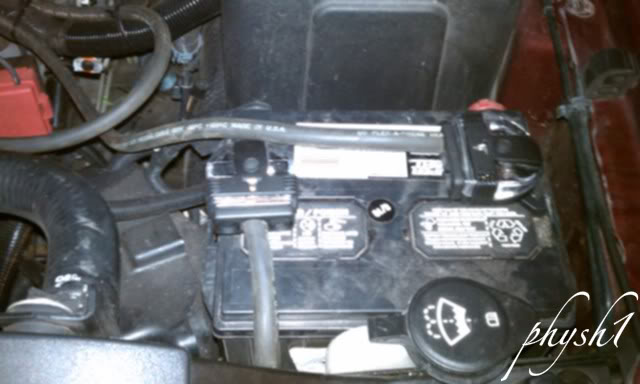

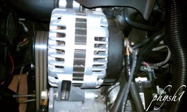

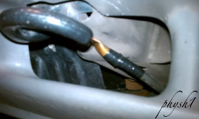

I did the "big 3" upgrade. Stuff has been sitting here for weeks & finally just got around to it. Didn't take long...about an hour...
I used JL audio top posts, 1/0 welding wire, & soldered on cable lugs.

Big 3 the cheapest/easiest electrical upgrade you can do.
What is this mod, and whats point of it
