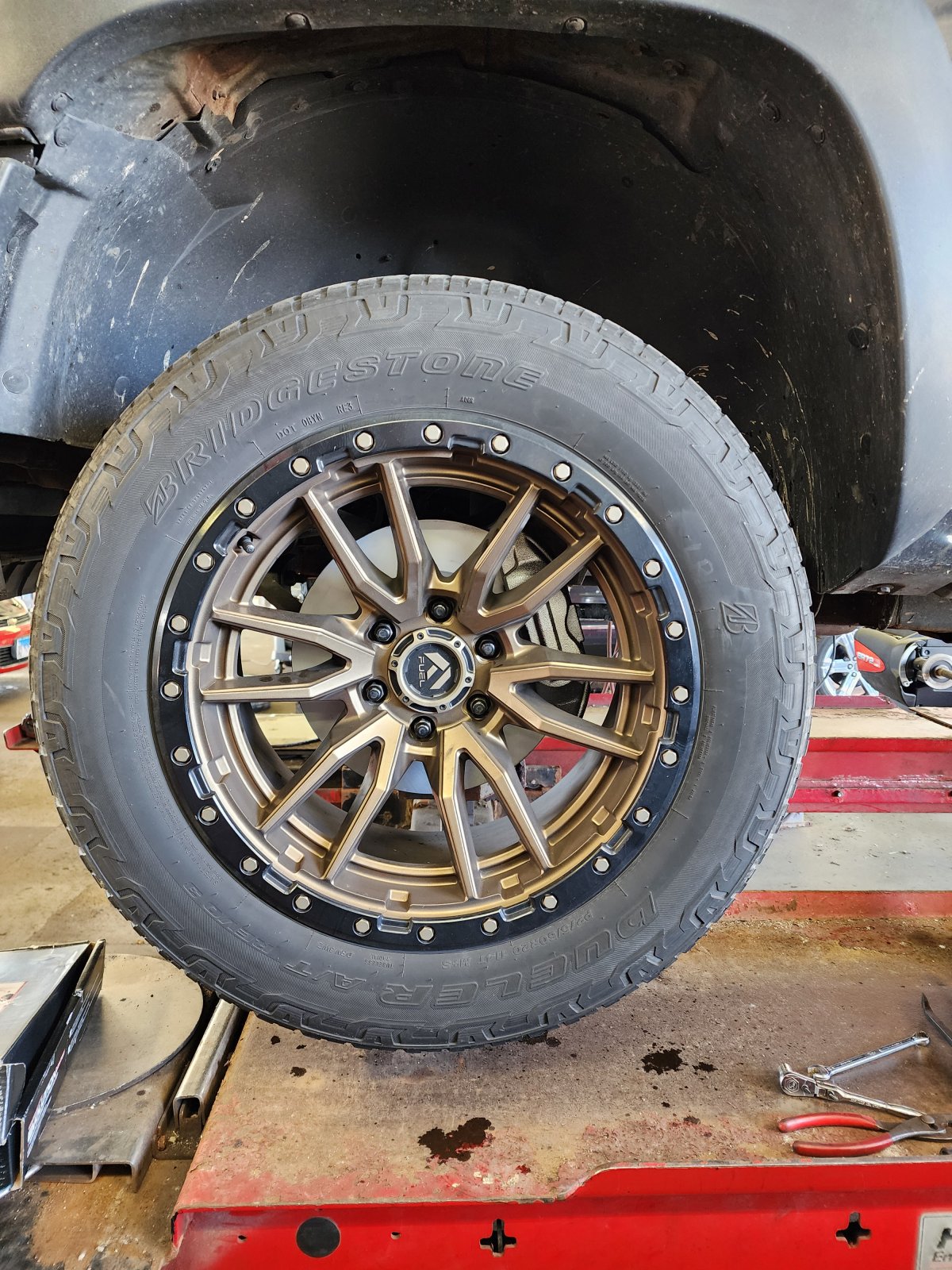

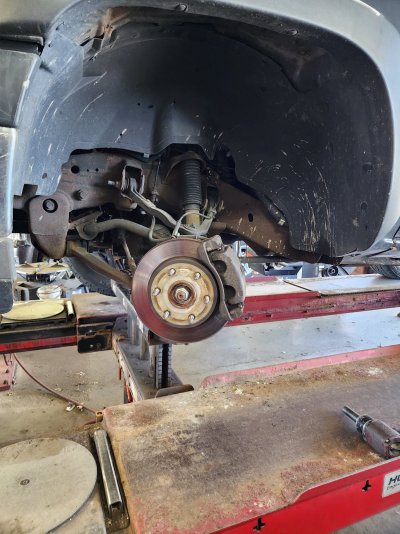

Got the brake kit installed today! Fit like it was meant to be there!
GM Brake Calipers 13545382/13525383
Powerstop Brake Pads 17-2173
Powerstop Brake Rotors AR84103EVC
Brake Caliper Bolts 84504 (Napa)
2 grade 8 washers per bolt to center caliper and rotor assembly
The wheel specs are 20x10 -18 offset Fuel Rebel for fitment concerns, there is a lot of space between the wheel and the caliper

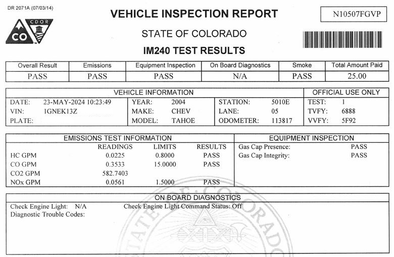

Took her through the semi-annual emissions test today; sometimes they do just an OBD read, but this time they worked her on the treadmill so we got actual numbers. All readings less than 4% of the limits. E85 (E70 is actual) FTW.
