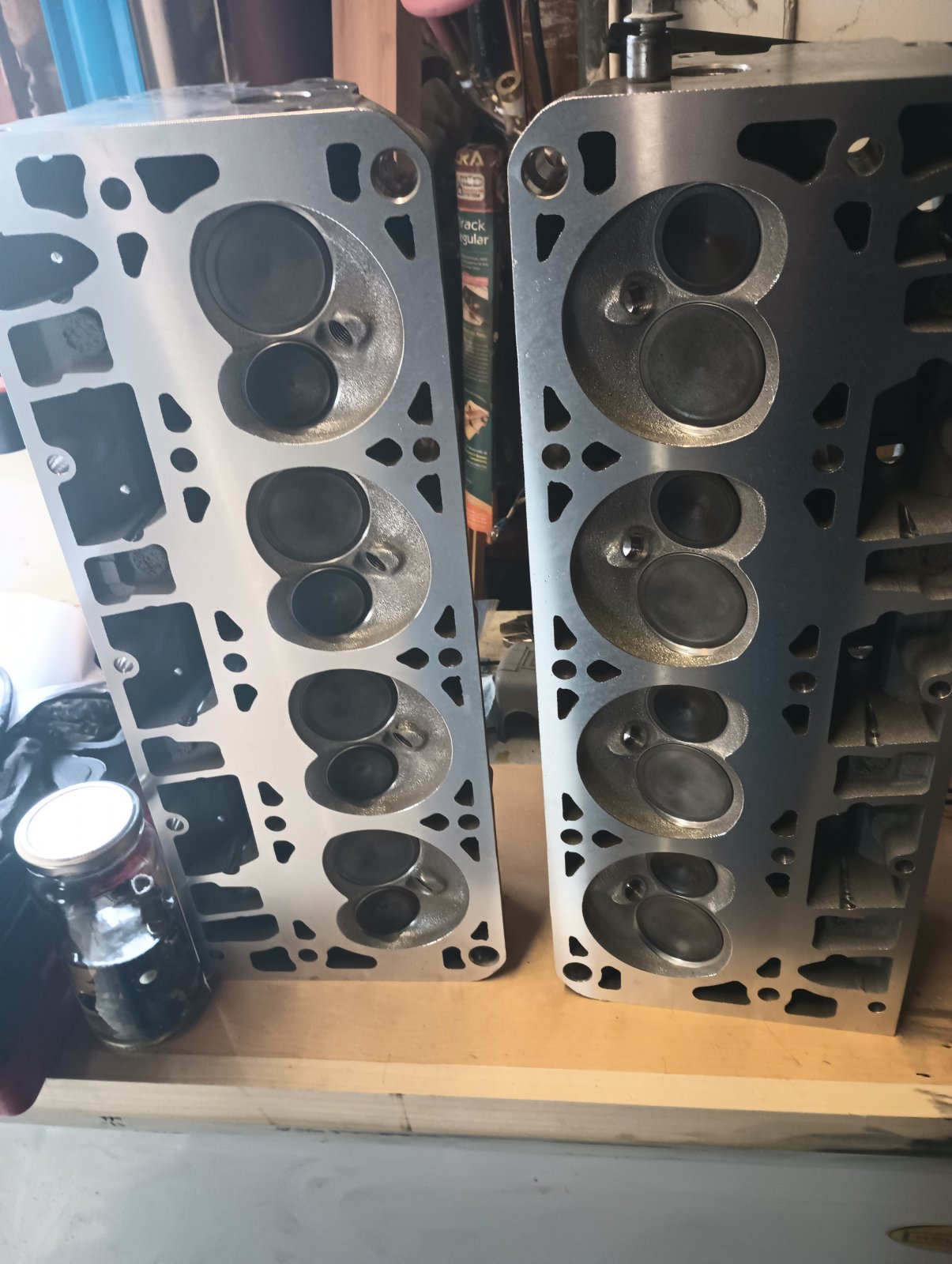

And by chance, I went to pick up some grimey 317 heads for the engine I'm building. And of course, it had broken bolts, 2 with threads sticking out and 3 broken flush. A little patience and some electron arcs, and everything was removed. Will drop off the heads at the machine shop for cleanup, inspection, whatever else they need.
Got the crusty heads back from the machine shop. They cleaned them, did a valve job, milled them, and replaced the valve stem seals: $350. Not bad.
