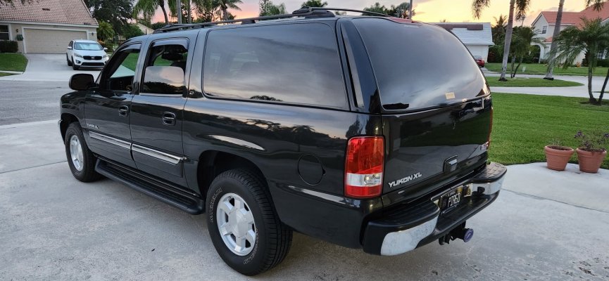

I bought all 4 bump stops.... ( One rear fell out).... I want to use my mechanic's lift to clean/ install them, sometime soon..... But until then, yesterday, I watched the INDY car race, in my garage, and, since the weather temperature is 'livable' now, in south Florida, I did my semi-annual exterior detail to my '05. Then put it to bed..... What an amazing truck.... 171,000 miles and still like new !!
Beautiful indeed! Looks brand new!

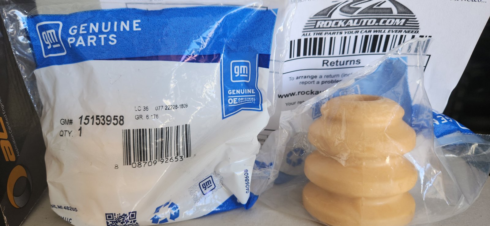

Do you have a part number for the rear bump stops? One fell out from my 06 Suburban, but I'm not certain what those bump stops are called (jounce stop?) Surprisingly, my fronts look really good, almost new!
mountie
May 9, 2018
5,448
10,314
From Rock Auto.... Rears are Dorman ' premium' ( # AB90660PR ). Fronts are ' Genuine GM' ( # 15153958 ). I am replacing the fronts, even though they look good, I consider the age of the weird material. ( All from Rock Auto )
