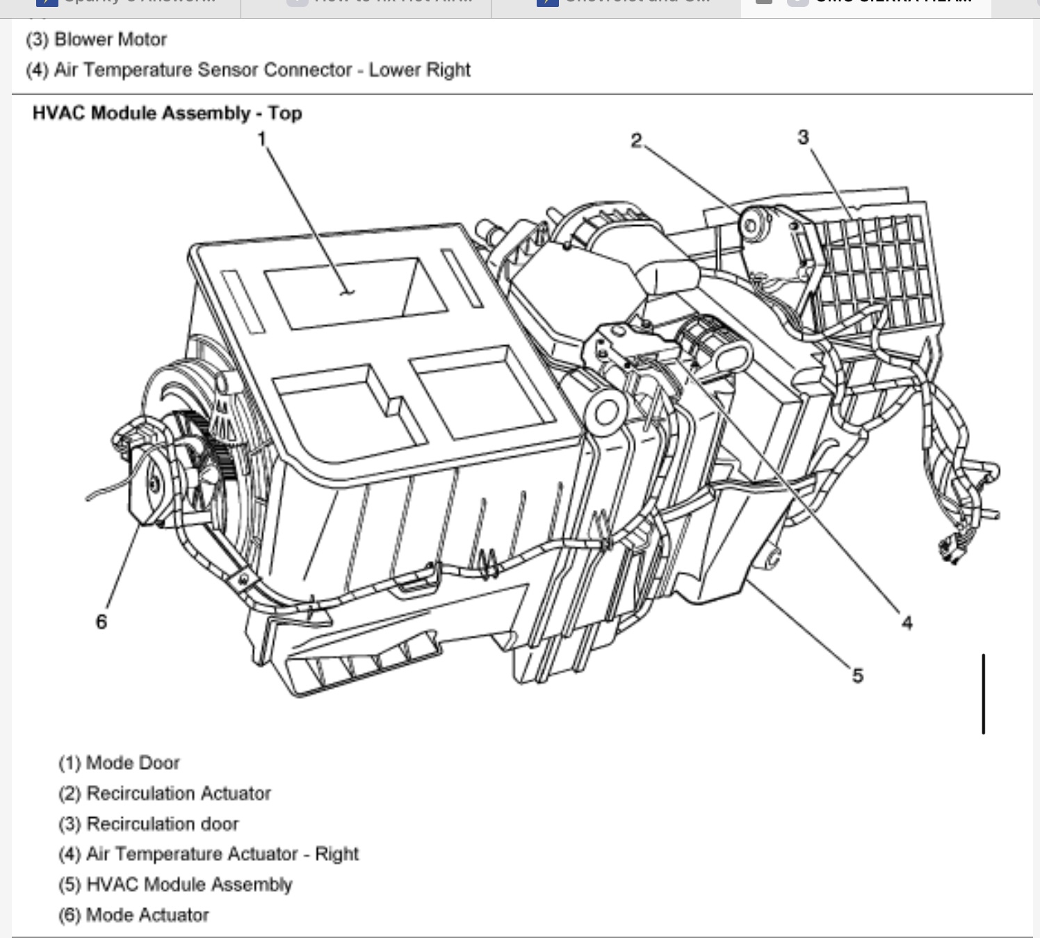

What was the issue you were having? Was that under "Special Functions"?
My recirc. door doesn't move at all and Tech2 gives DTC B0229 - Recirc. position feedback circuit range/performance. I'll have to double check, but you go under BCM/HVAC and can look at DTC's and perform Door position tests. Everything looks good, except the recirc. door doesn't move. Hoping it's just the actuator and not the door broke or a short in a wire. When I press the Recirc. button on the control head it stays lit up, but the door doesn't move. No clicking sound or anything.
mwilson62000
Jan 20, 2015
428
1,404
27,741
42,164
26,371
51,826
Recirc door actuator is behind the airbag on the passenger side.
That ones hard. I did mine by partially removing the dash ( the actual dash, not just the cover) and prying it up with a piece of wood to give me just enough room to unscrew it. Service manual calls for complete dash removal, about 6 hrs or more to R&R. Good luck. ;)
