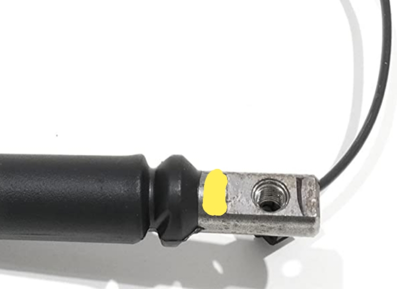

No need to cut it, all you have to do is grind the section clouded on the picture below. Then bend it up slowly until you get it to your liking. It takes several times installing it and taking it off until you get it where you want it. Once you get it to you liking you need to tap the threads of the handle to get the bolt to bolt up to the column. Not hard at all. Do not put any heat on it.

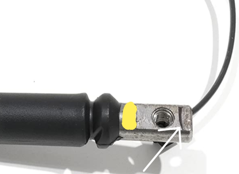

Almost forgot, you also need to grind the end where the arrow is shown on the picture below.
Ok. So you just grind it down enough to bend .? I’m not following the additional grinding on the end, or re-tapping it. Sorry, I guess I’m slow.
Wait... ok, when you say grind on it, you’re talking about grinding so it’s flat like the tapped section, then re-tapping it up higher on the stalk.. I think I got it.

Ok. So you just grind it down enough to bend .?.
You are correct and yes it needs to be flat like the rest of that section.
Ok. I’m not following the additional grinding on the end, or re-tapping it. Sorry,
When you bend the shifter, the bolt opening becomes a weak spot and closes a bit. That's why you have to retap it. When the bolt opening closes the bolt hole no longer lines up with the column hole. To get it to line up you have to grind the end. I hope this clears up your questions. Hit me up when you start the process and I will guide you thru the entire dyi. I should have taken pictures but didn't.
