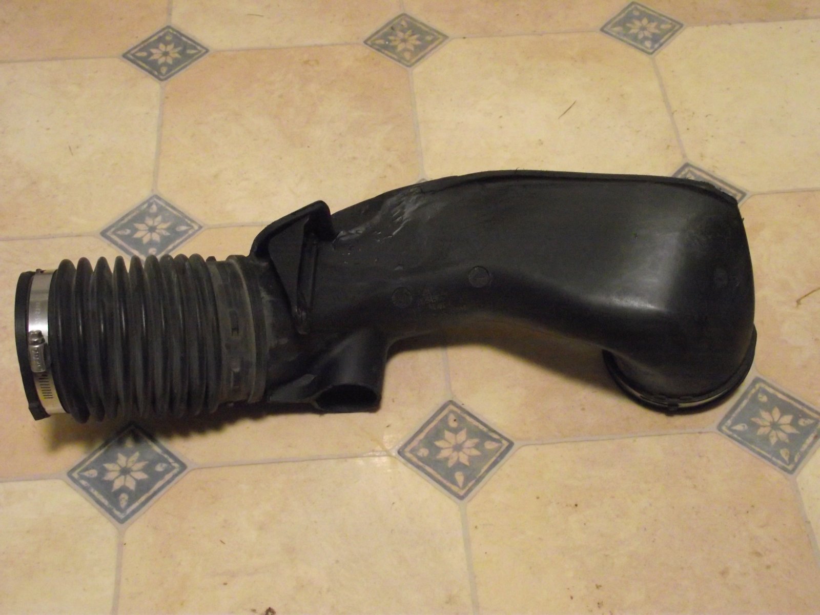

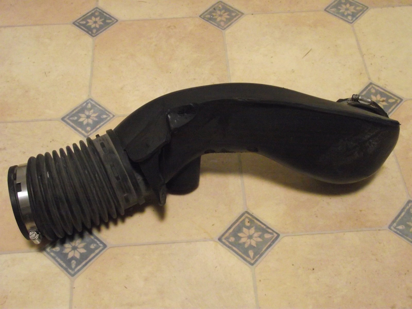

I did some cutting and patching of a cold air intake elbow I got at the junkyard. It won't win any beauty contests, but it sure beats the octopus that it will replace.

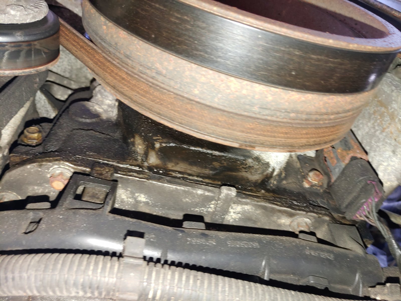

I'm in the middle of replacing my power steering pressure and return hoses I noticed some oil around the pan in the front.
You guys think that this is just weeping and maybe pan bolts weren't tght or potentially oil pump? Or something else?
Picture was taken from ground looking up at front of engine.

Looks like it's coming from the front seal but don't think it's enough to worry about, not until it starts making a mess on the driveway.

yeah that's what I was thinking too, no way I would have noticed this unless I took the plastic guard off the bottom of the engine bay.
In other words, power steering lines has been replaced with new AC Delco.
I had an 8 mmbolt which held the two lines into the rack and then a 16 mm wrench was needed to take off the pressure line at the reservoir. Both lines including shipping from RockAuto or $69 with the 5% off.

clean that up real good, and keep an eye on it for the next week. its real easy to see a new trail of oil when its all clean.
id think its the crank seal for the balancer myself.
