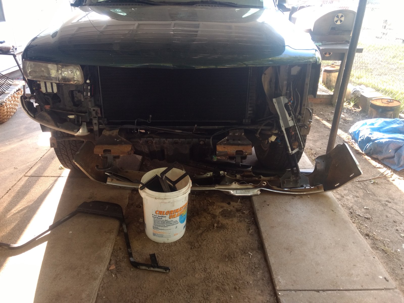

Worked on it a little more this afternoon when I got home. Finished getting the rest of the mangled parts of the front, and I repainted the AC condenser. Still gathering parts too, need to getga hood and drivets side fender, but I have a HD hood lined up. Thank God the AC condenser wasn't damaged in the collision, that would be a PITA to replace that and recharge the system. Going to Home Depot now to get some aluminum straps to make some brackets to fit this new big ass transmission cooler on here. It's no Tru-cool, but it's more than three times the size of the tiny OEM cooler. Its a Hayden 679, and it was actually CHEAPER than a replacement factory sized trans cooler.

Worked on it a little more this afternoon when I got home. Finished getting the rest of the mangled parts of the front, and I repainted the AC condenser. Still gathering parts too, need to getga hood and drivets side fender, but I have a HD hood lined up. Thank God the AC condenser wasn't damaged in the collision, that would be a PITA to replace that and recharge the system. Going to Home Depot now to get some aluminum straps to make some brackets to fit this new big ass transmission cooler on here. It's no Tru-cool, but it's more than three times the size of the tiny OEM cooler. Its a Hayden 679, and it was actually CHEAPER than a replacement factory sized trans cooler. View attachment 207748 View attachment 207749
Could you do a write up on the install of the cooler? I wouldn't mind upgrading mine in the future.
