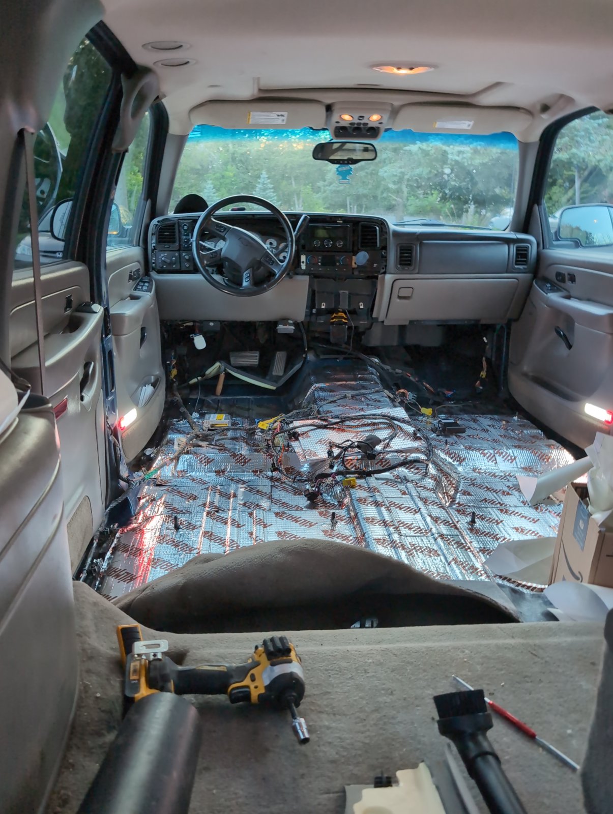

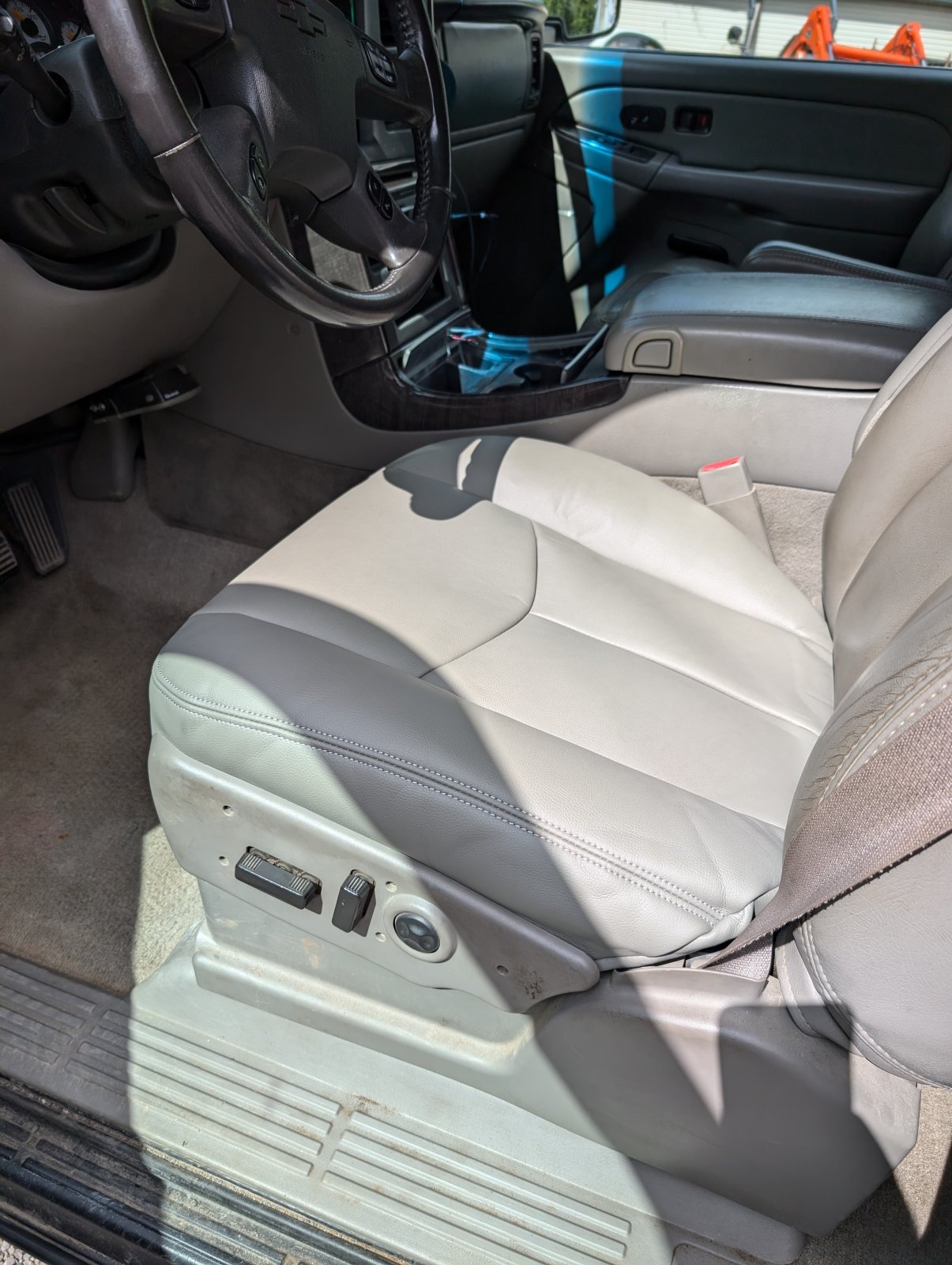

I finished my interior upgrade
Added Denali Wood grain dash bezel and console (after painting the beat up gray).
New Seat Bottom cover.
Remove carpet and cleaned it.
Put down Kilmat sound deadener on the floor.

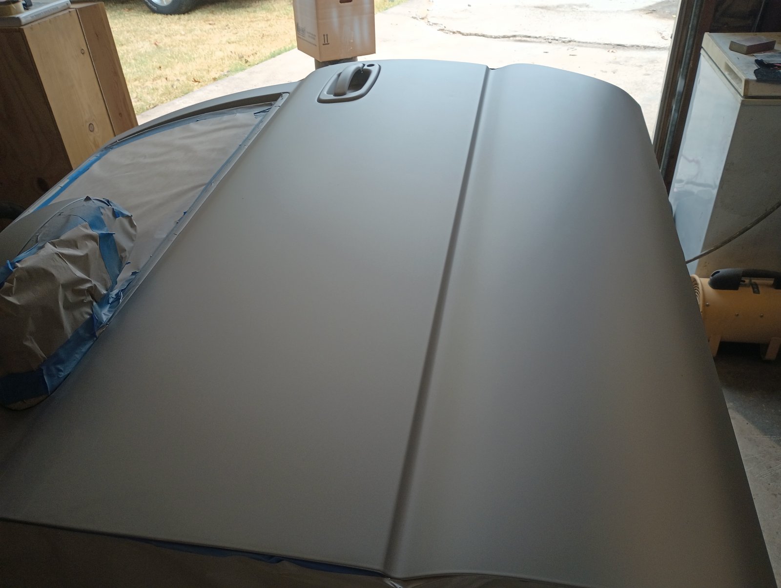

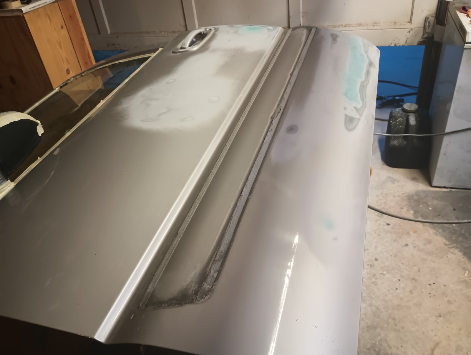

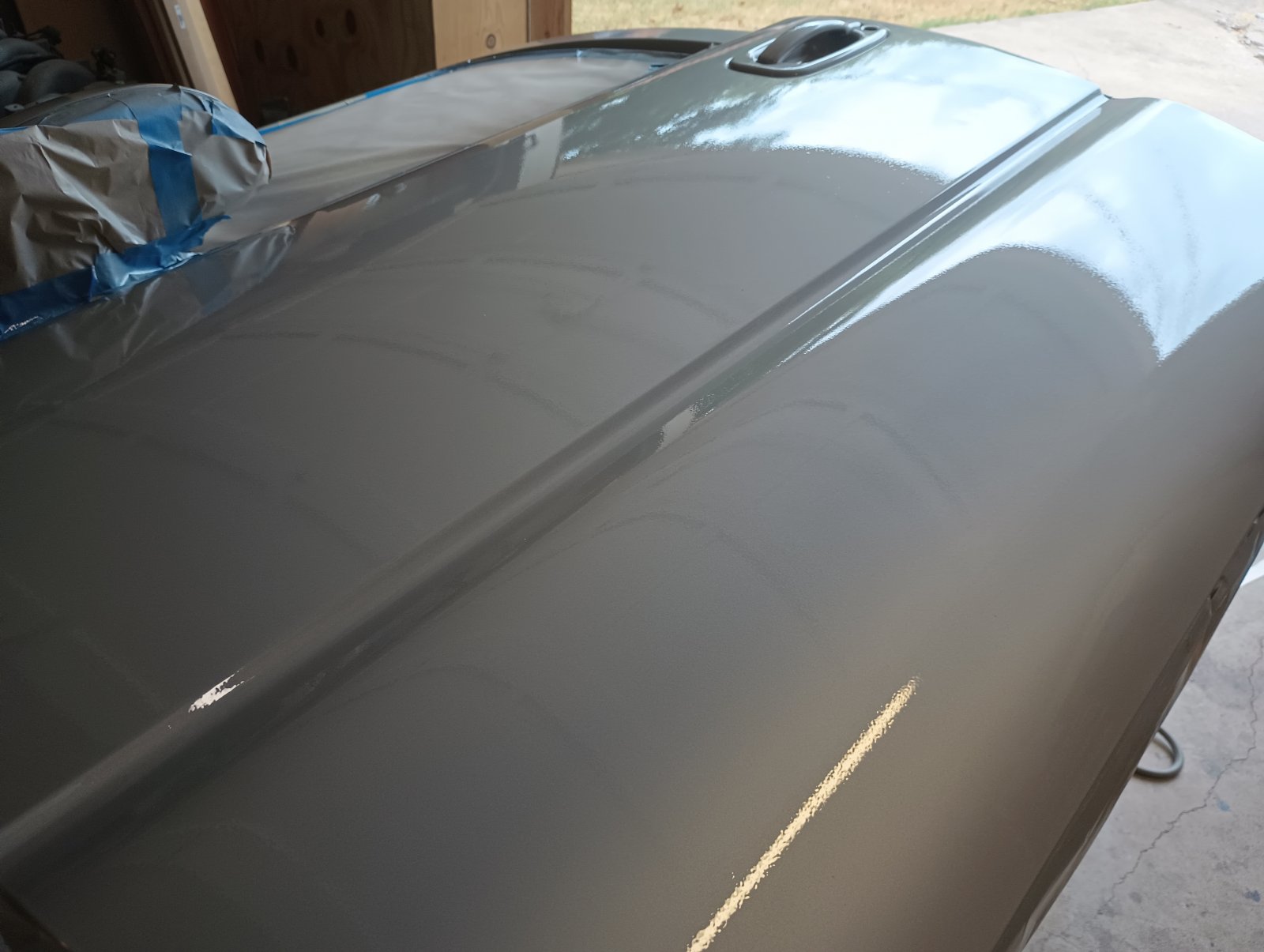

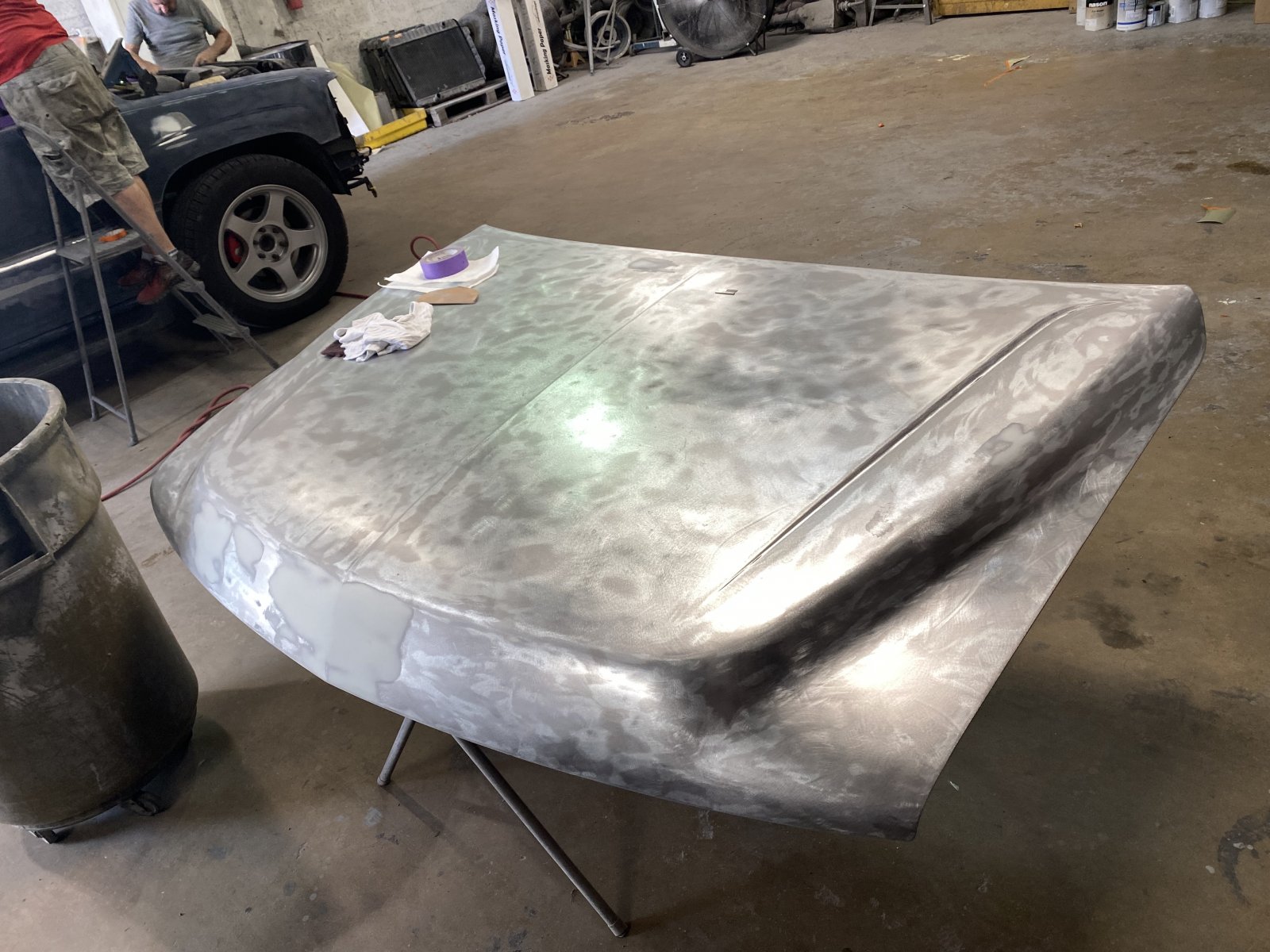

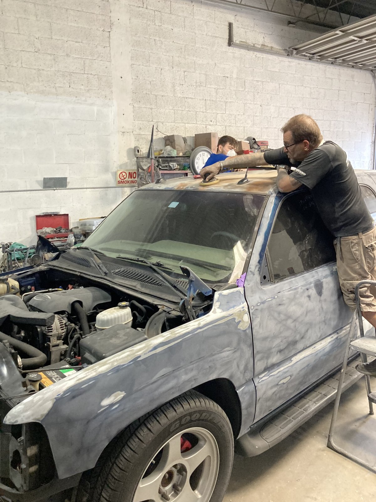

I tried my luck on body work last weekend. I had these horrible deep scratches at the bottom of my 06 Suburban door and a nasty dent near the handle. I took off the door, did body filler, primer, base and clear.
I had to go buy one of those 3M wheels to remove the adhesive from the door trim.
It came out a little orange-peel on the clear, but decent. I used the mid-grade HVLP HF gun for everything. I was supposed to use my other HTE gun I have for the clear only as it atomizes better, but didn't feel like getting another gun dirty. It's certainly better than before...

Looks good. Just wet sand it a little.

Yup cut and buff it will look like a mirror and put the rest of the truck to shame. Then you'll have to paint it all :p
