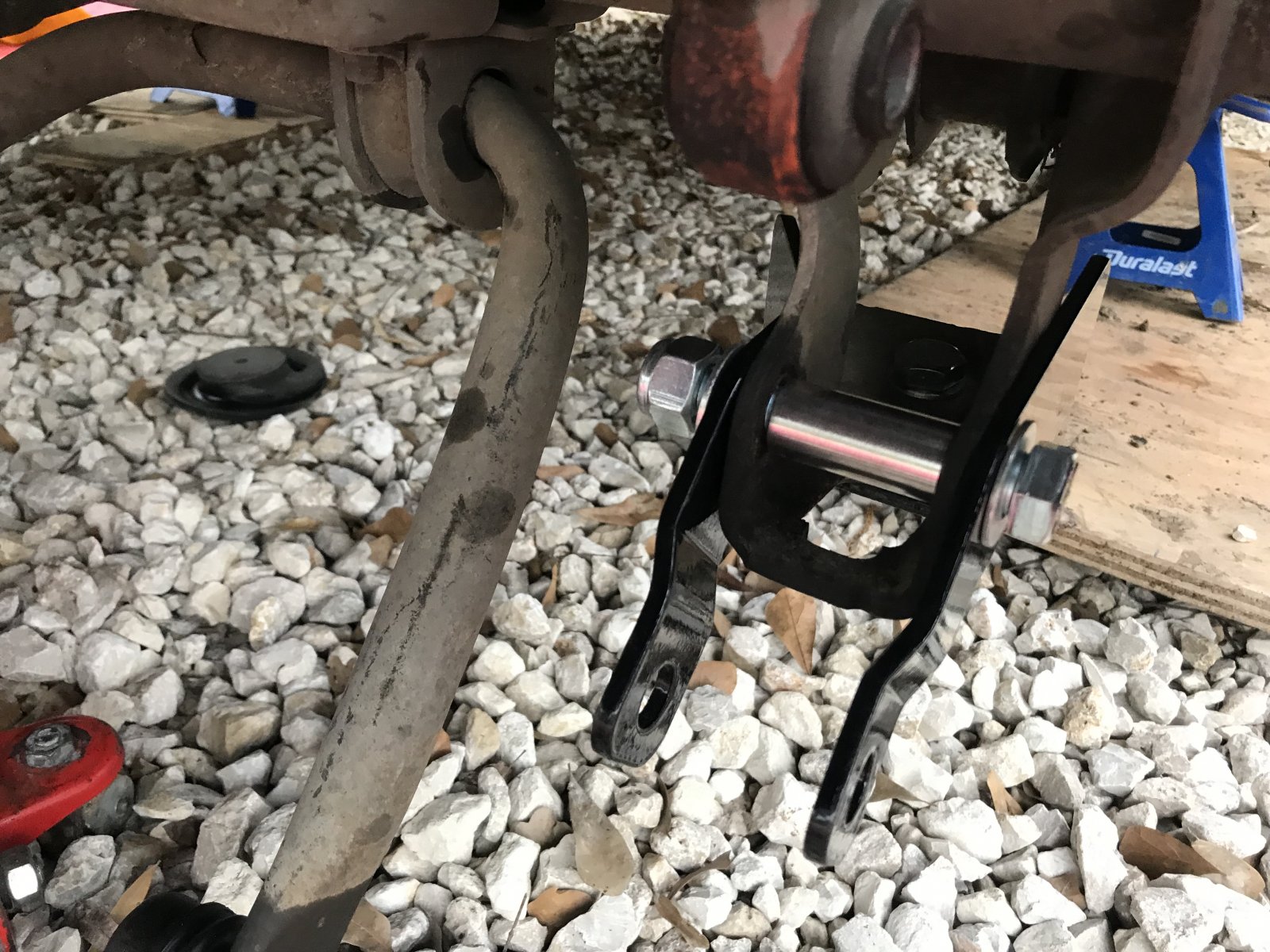

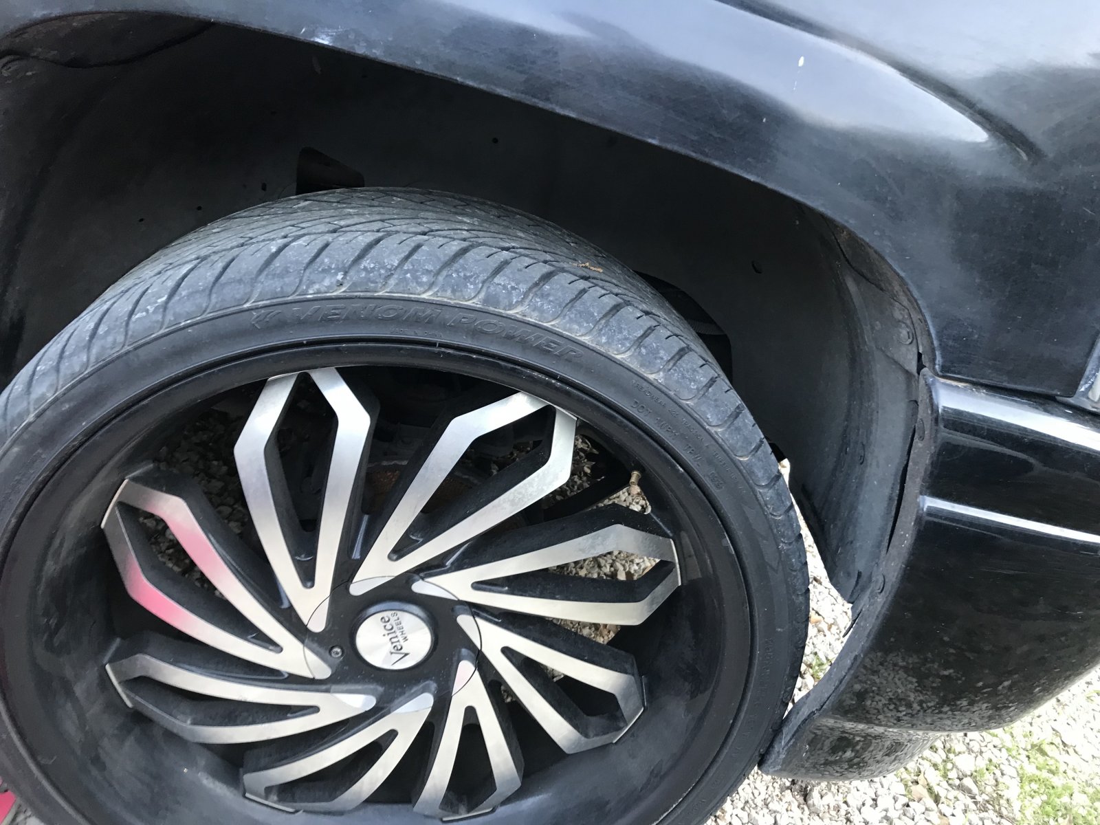

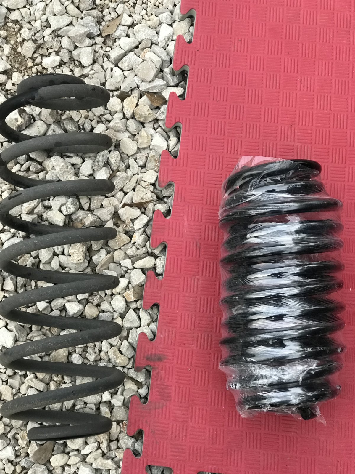

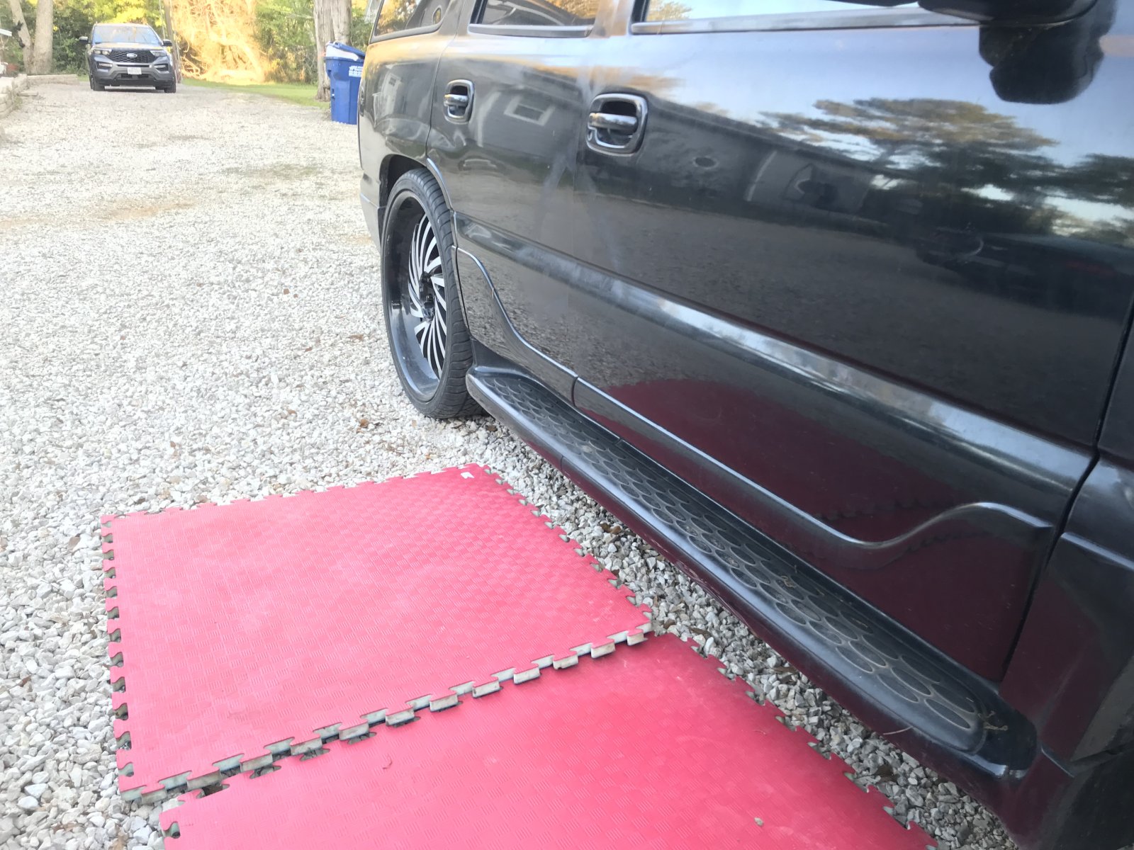

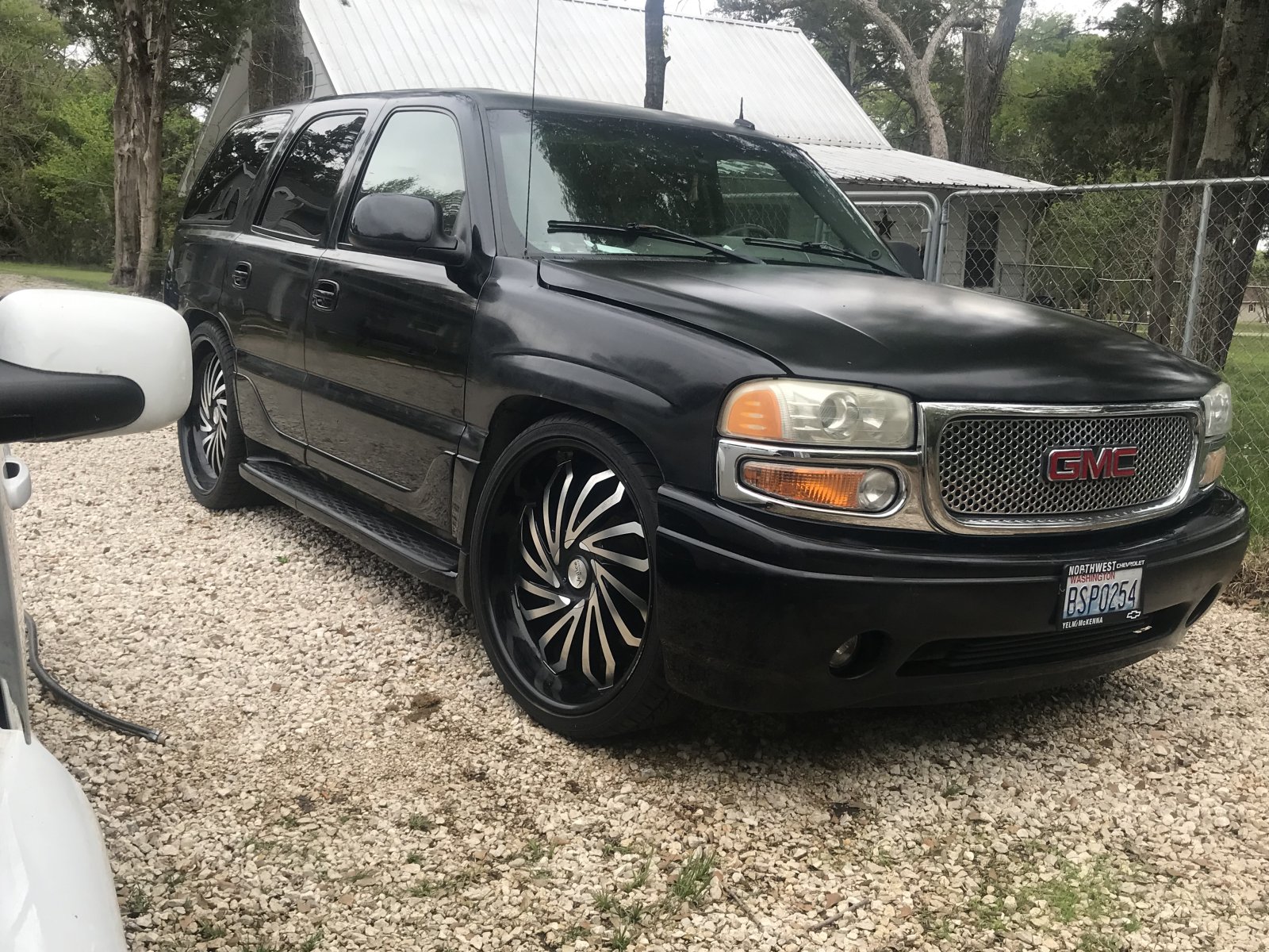

I lowered my 2002 GMC Yukon Denali, I got a lowering kit off eBay , springs , torsion keys and shock extenders(no instructions) Didn’t know what to expect with getting the rear springs out , my dad had said they are compressed and to be careful they can fly out and fk me up . So it took me longer than it should have being way to cautious. Jacked up the rear axle . I unbolted the bottom shock mounts the upper sway bar bolts . Let down the axle and the springs came right out . Jacked the axle up to the new springs for let it down . The only thing is the emergency brake cable is up against the shock . I’m sure there’s a way to extend it or shorten it to go in front of the shock I havnt seen anything yet .the torsion bar keys I found a 3 jaw gear puller and got it to grab ahold and pull the torsion keys up front . I enjoy my suv that gets 9 mpg a lot and plan on keeping it a long time . It’s been sitting in the same place for 2 months now . My grandmother had gotten a diagnosis she was going home really quick . I sat with her everyday for a few weeks and helped her go home with what ever I could do to make it better. I miss her a lot and I would put her in her wheel chair every 5 min to smoke a piece of a cigarette for yeaRs if I could . Well I didn’t drive for almost 2 months .I lost the damn keys for it so it’s been parked . I can get a key cut at the dealership but I keep getting ck blocked with every little thing . I tried looking up how to hot wire but I guess they don’t post how to steal shit . I just need to move over a lil bit til I get the paperwork in the mail .I appreciate the info and the support on this site .y’all have a good one

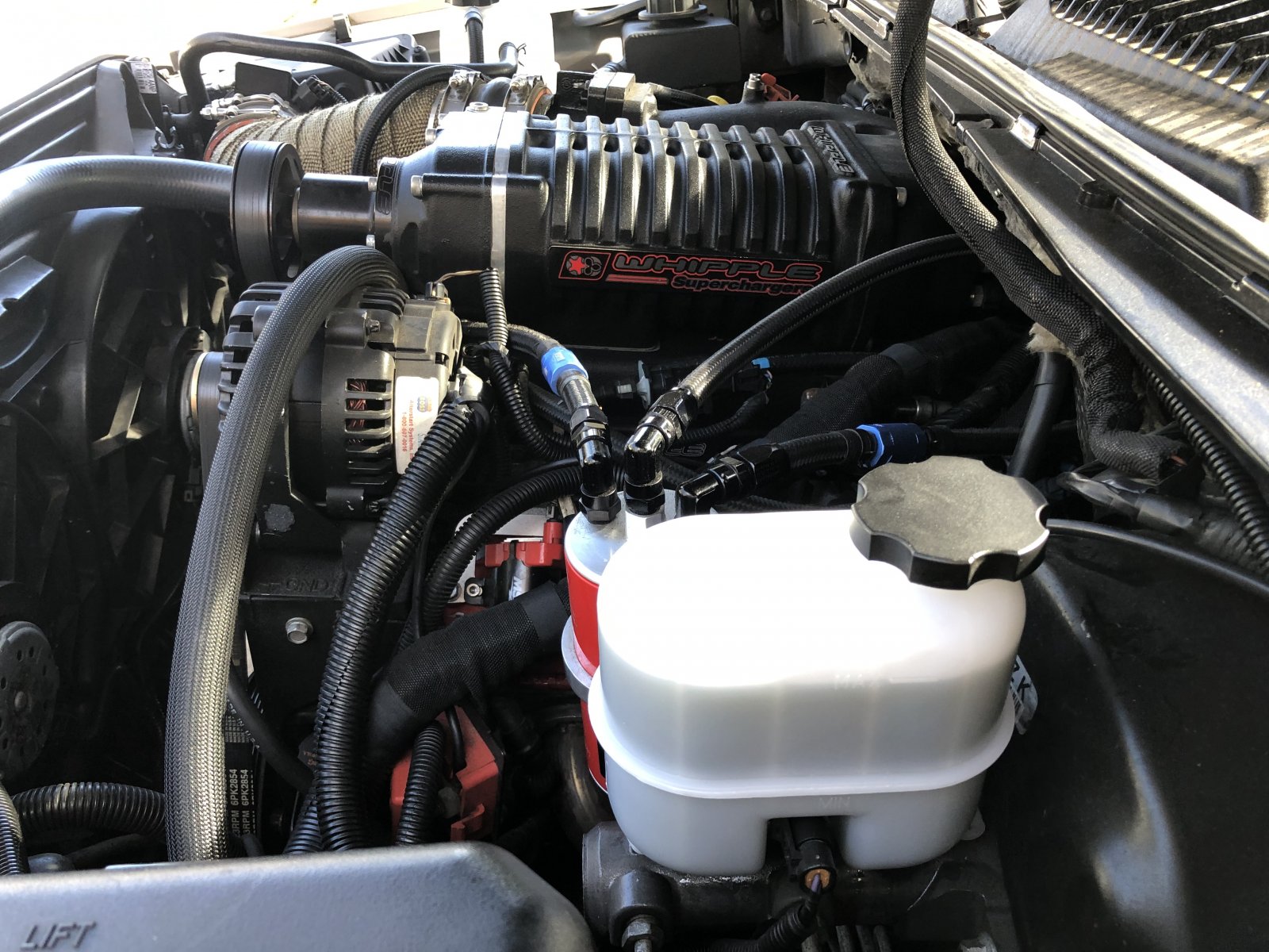

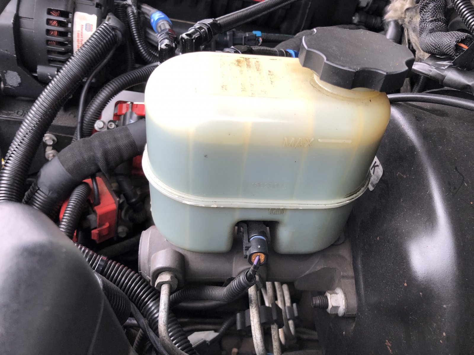

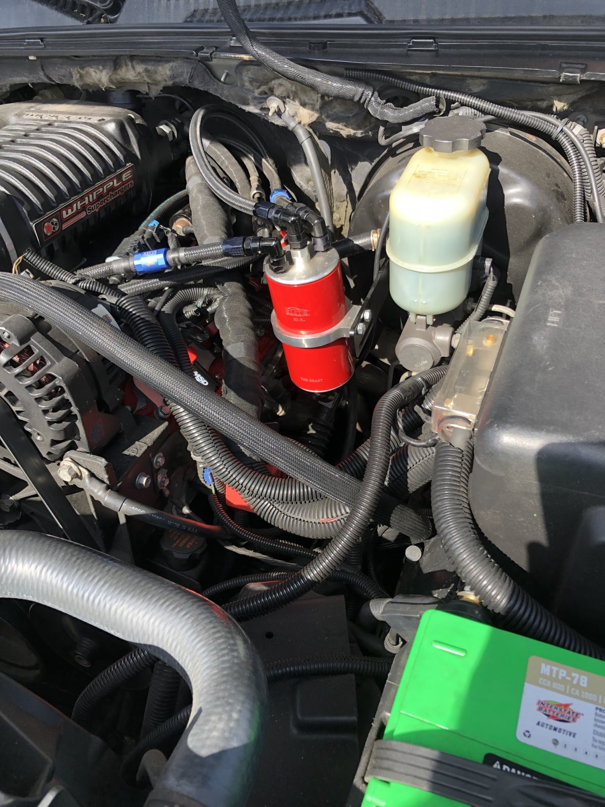

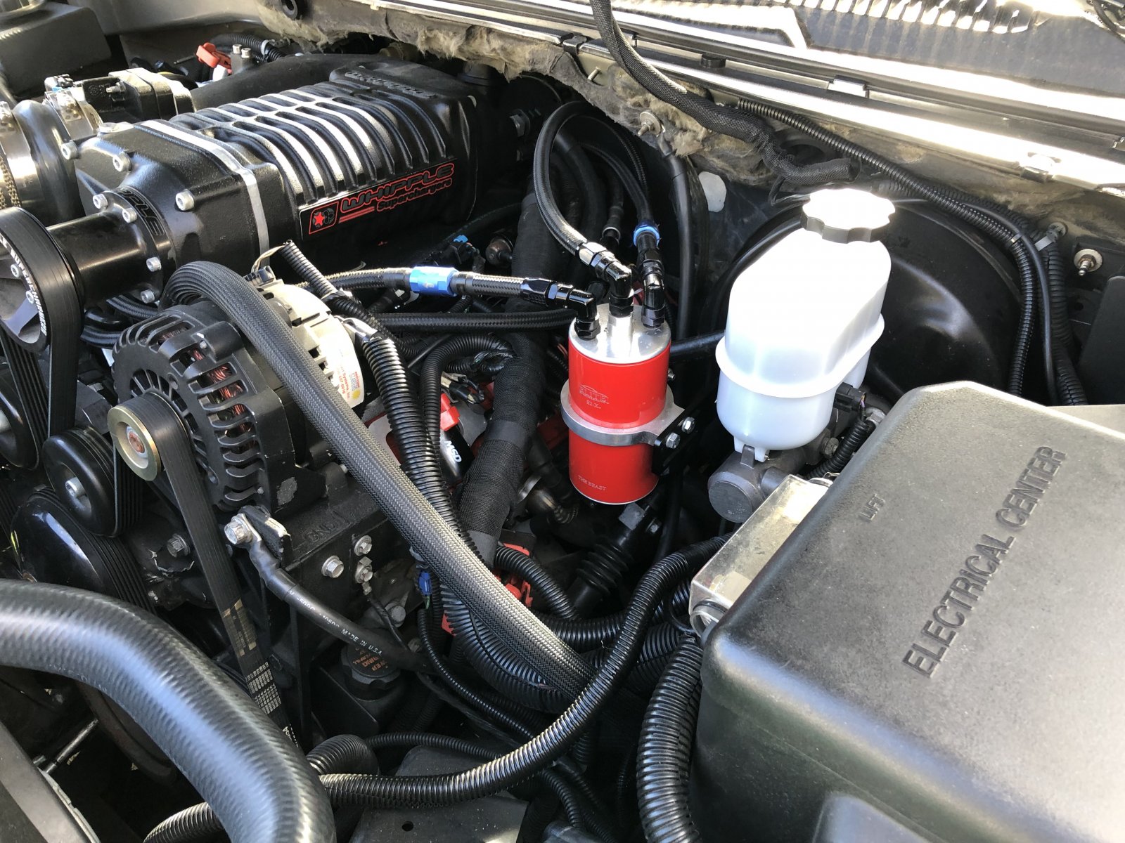

I swapped out my brake MC reservoir today. It wasn’t too bad, didn’t have to bleed my brakes. Before and after. I did a detailed write up in my build thread if anyone wants to see. Link here https://www.tahoeyukonforum.com/thr...ali-build-thread-aka-the-beast.83457/page-416
Nice! Thanks for writing that up for others to see the how-to...
I can't see the aging reservoir with the hood closed! So, I'll hold off on rushing into this project on my Tahoe a while longer.
