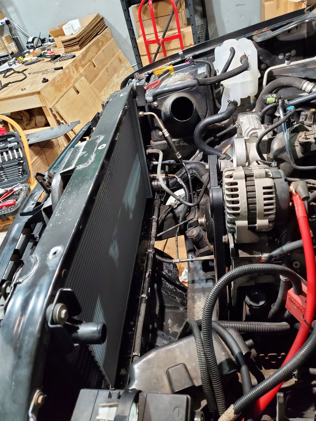

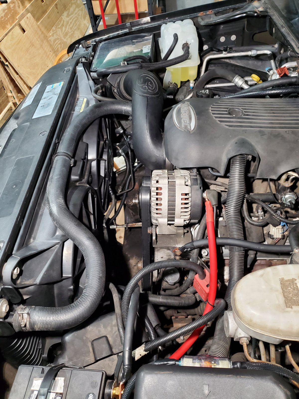

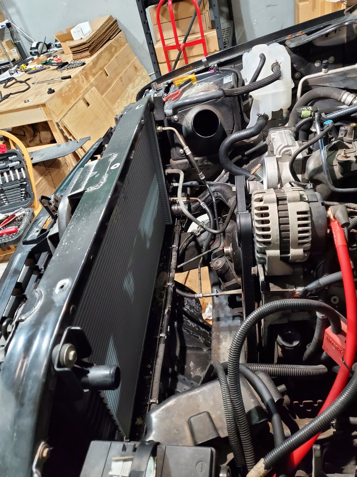

Replaced heater hoses and tees yesterday, they were the original to the truck I figured it was a good investment. Vice grips with a sawzall blade became my friend to get the old ones out. Also replaced coolant temp sensor, steam pipe gaskets up front, radiator, expansion tank. Then did the efan conversion, replaced the electrical box cover, got the new harness to fit in the OEM location but had to do some moving around there was a harness right there in that spot already.
33,161
51,349
Replaced heater hoses and tees yesterday, they were the original to the truck I figured it was a good investment. Vice grips with a sawzall blade became my friend to get the old ones out. Also replaced coolant temp sensor, steam pipe gaskets up front, radiator, expansion tank. Then did the efan conversion, replaced the electrical box cover, got the new harness to fit in the OEM location but had to do some moving around there was a harness right there in that spot already.View attachment 395058View attachment 395059
How will you activate your fans?

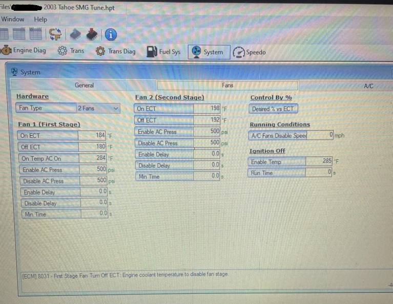

I had my truck tuned already and he turned the fans on when he did that, which motivated me to do the conversion.
My only regret is not knowing enough ahead of time about the settings, my ac system settings are maxed out so the fans only respond to coolant temp. I don't get cold AC until my truck warms up to 184 and they kick on.
So the fan turn-on AC pressures were not changed, only ECT temps set?

Also - with the temp settings where they are and the disable speed at 0, they might be running all the time when warmed up. (You might want that specifically)
Thanks for the info guys, looks like I am going to want these settings changed.
My tuner was all about running my truck cold and more power.

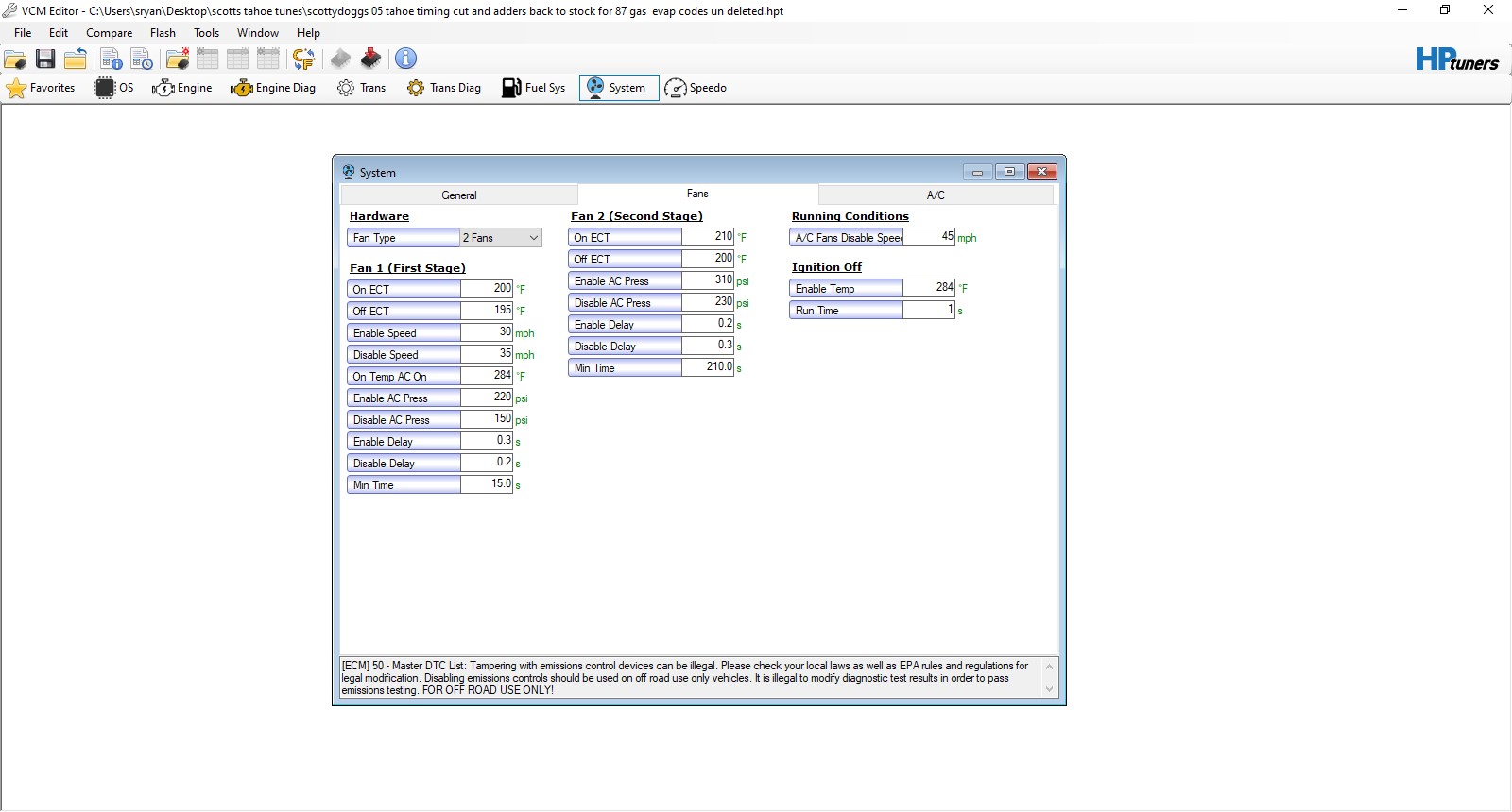

Does anyone have a screenshot of their e-fan settings so I can compare mine. I am thinking adjusting ac pressures, and disable speed of 65mph. Not sure if I should change delays/min run time.
05 tahoe fan settings. all stock, dont think i messed with em. i turn on my ac and the fans just come on.

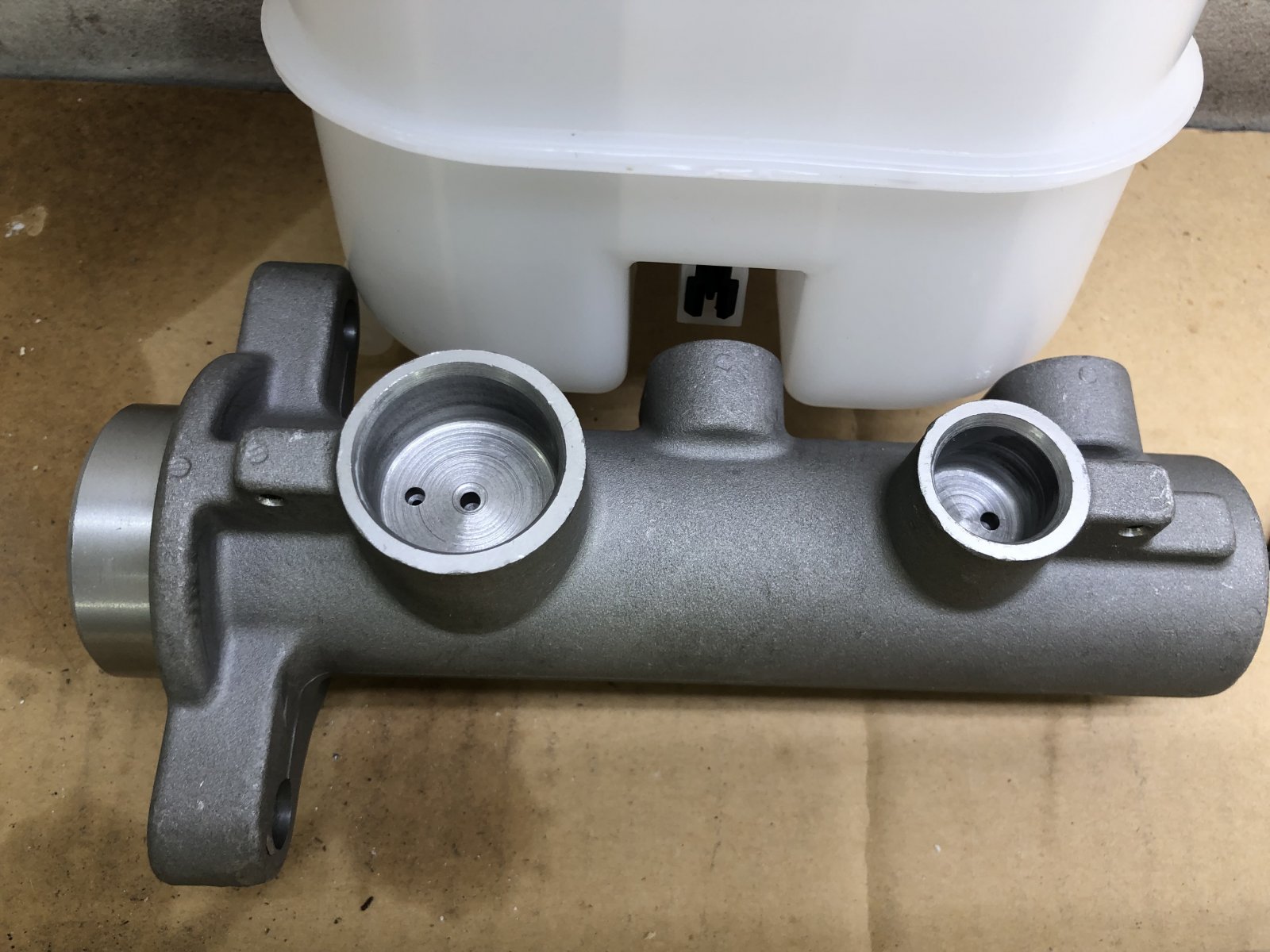

I’ve been waiting on a Cardone MC reservoir for 6 months, they’re backordered. I just want to replace my old stained one. So I found a cheap MC complete with the reservoir and plan on swapping the reservoir onto my MC without removing it and hopefully not need a flush. I have heard of someone else doing this with no bleed necessary. I’m thinking as long as there is a bit of fluid in the bottom of the MC I’ll be gtg. Anybody done this?
AC pressures look stock but the ECT parameters are lower than factory. I am slightly higher than you but not as high as factory.
@ncalvo i think the general feeling these days is LS motors don’t need to run super cool. When they first landed in the f-bodies back in 1998, we did everything we could to prevent heat from being a possible problem. TB bypasses, resistors in the IAT sensor, fans on all the time, 160* thermostats. None of it made a difference and heat soak wasn’t an issue with composite intakes and aluminum heads/block. Granted if you hotlapped it at the track you might see a small ET penalty. And our 5.3 blocks are iron, but too cool can be detrimental.
Ha Ha. So you did decided to change the brake reservoir after changing the coolant reservoir. I was going to do that but thought it would be to much work. Let us know your step by step process. I might follow your lead.
