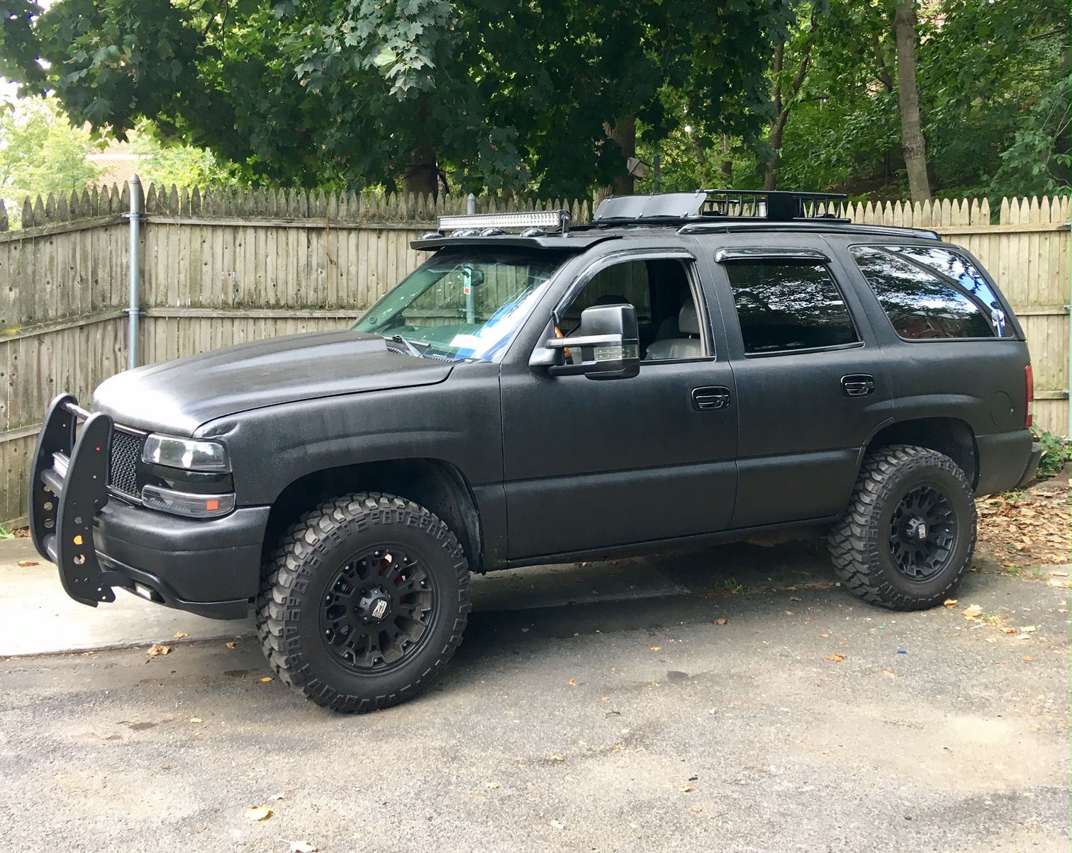

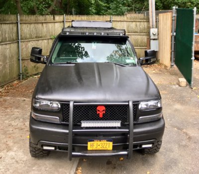

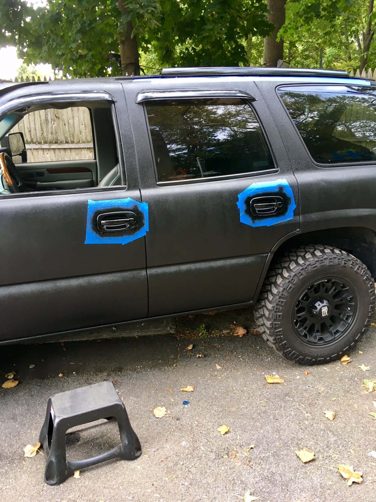

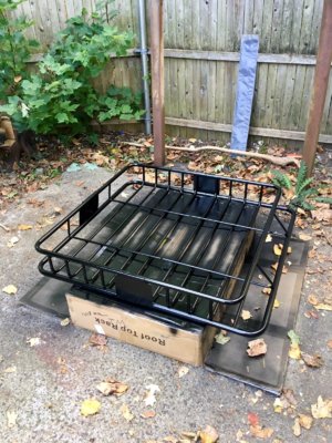

Installed a new roof rack and repainted a few parts gloss black for some contrast after painting the Hoe with herculiner

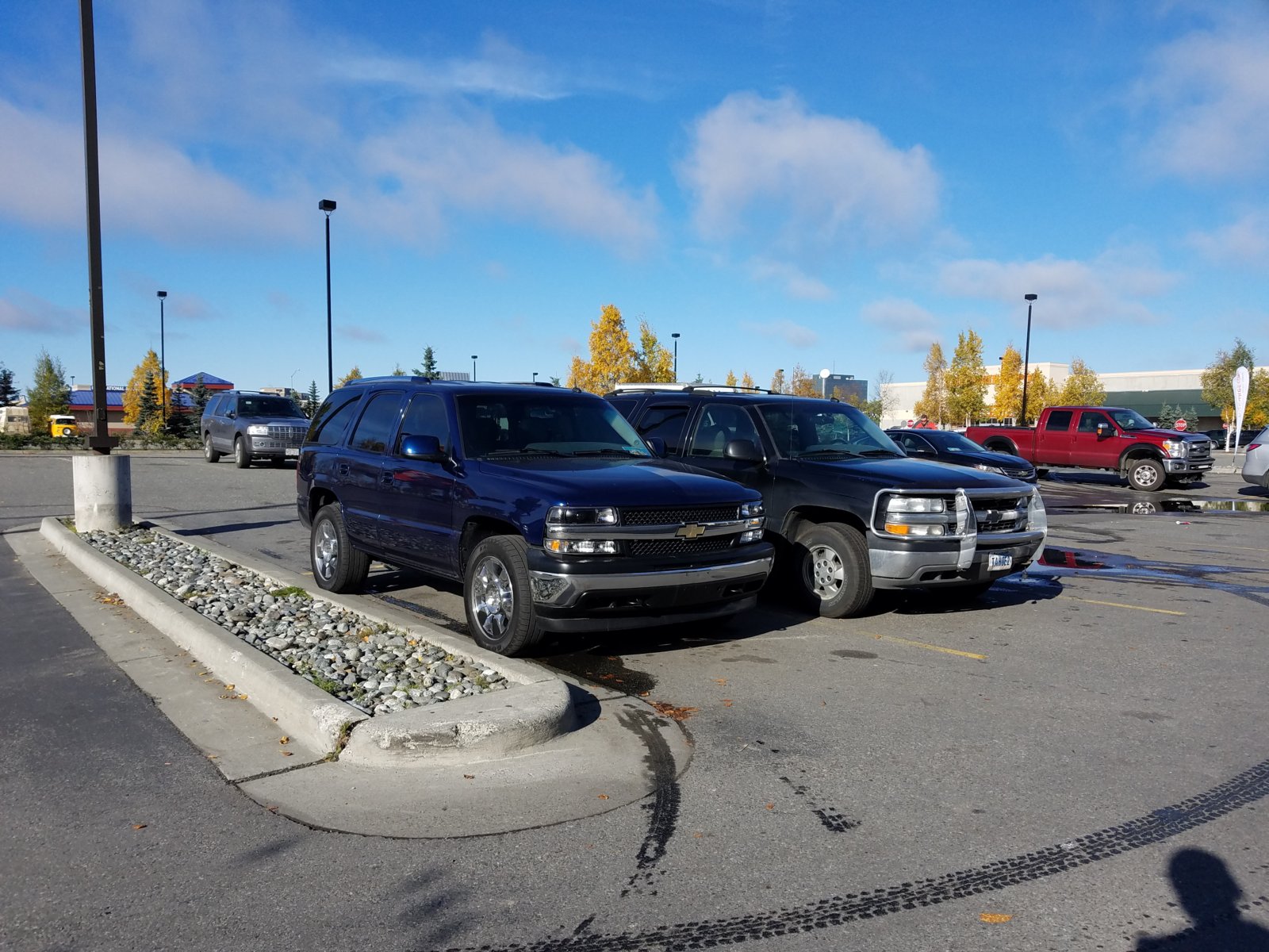

Had that feeling the other day. Sometimes it takes a plain jane to park next to you to really get a perspective of how much work you've done. After I left here I went to AutoZone where an old timer complimented on how (his exact words) "extremely clean" my truck was and then proceeded to say "i can tell you've put a lot of time and work into it" , that made me smile. Not a show truck but I try and make even a 14yr old truck look brand new and it's nice when someone acknowledges that.View attachment 183973
Well said. I agree completely.
Not a show truck but extremely clean. That's what I went for. Hard to build a driver/show truck in the salt and snow belt. So this is the best compromise
