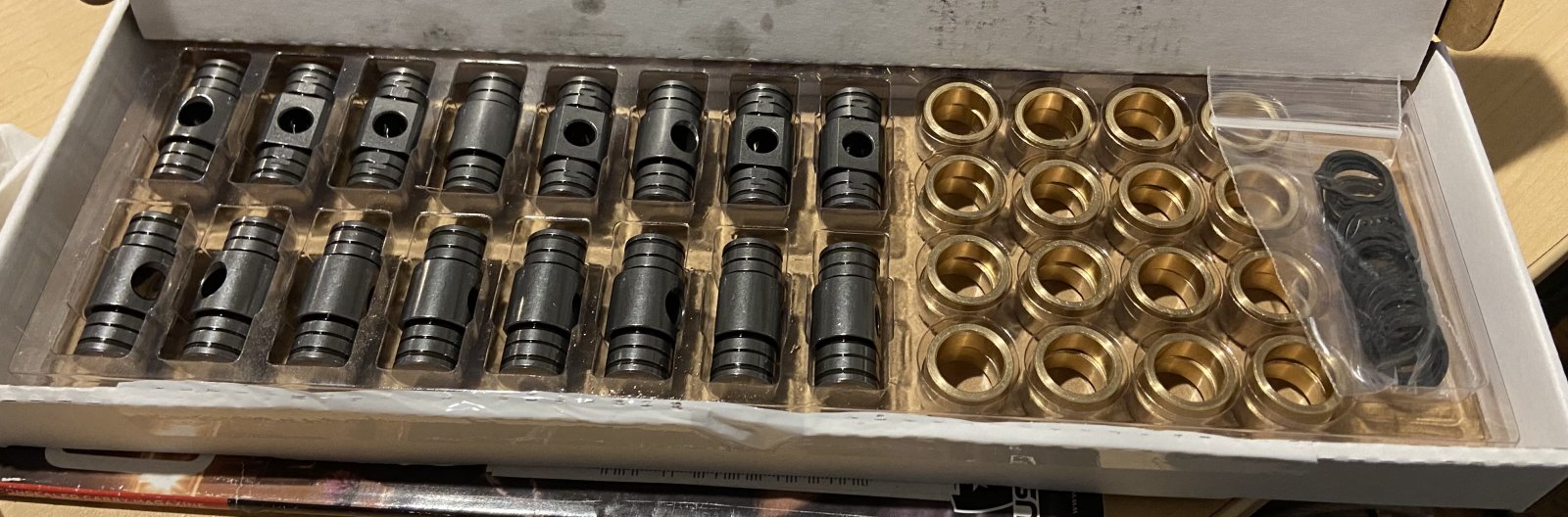

Trunnion upgrade arrived today, but does not have the install kit. Should be able to make do without that.

Pic for attention:

Pic for attention:
So much fun stuff.
Edit: you’re gonna love how that Performabuilt shifts.:)

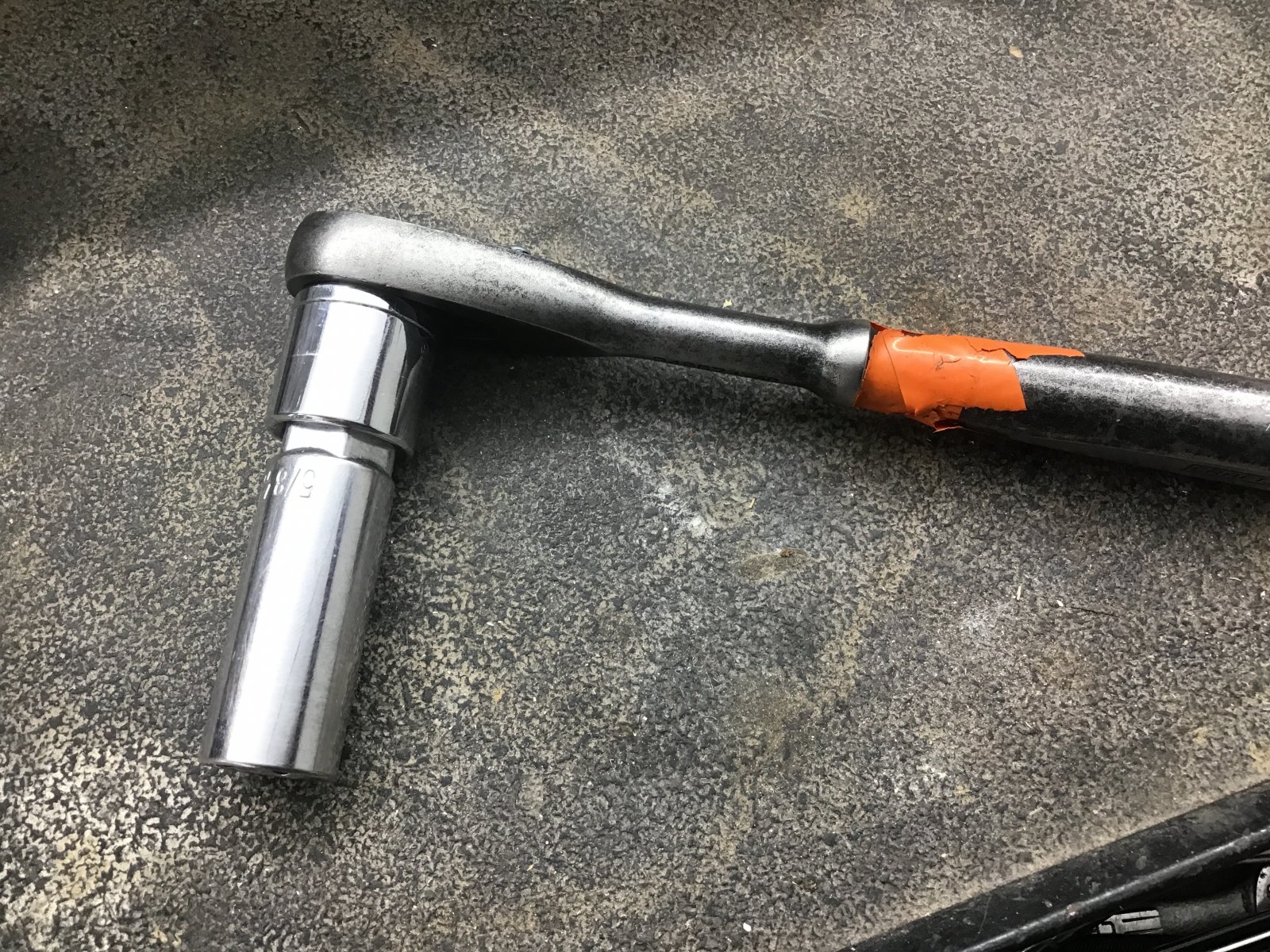

today i was blessed with a rain day and some 45 degree weather, so i decided last night at some point today im doing a tune up. had the truck for 4 years now bought plugs and wires right after i bought it, it ran ok so i blew it off for years. with gas prices going up i figured no better time then now, who knows maybe it will do better.
got to say ive seen posts of ppl raggin on plug 8. my last two trucks i had no issues getting any of the plugs out, but 8 on a tahoe, wtf man. wish i owned a 1 inch extension, had to do the old wrench on the socket deal, same deal for plug 5, damn steering shaft was in the way. needless to say, plug 8 and 5 went back in first lol
lucky for me ive got one of them battery powered ratchets, broke 8 free with a wrench, stuck the power ratchet down there and backed it out in like 2 seconds. also got my hand torn up when it came back up. 5 cuts, that ac pan there sucks for sure.

If you put a regular depth socket on the plug socket instead of a wrench it’s the perfect length for a ratchet.
