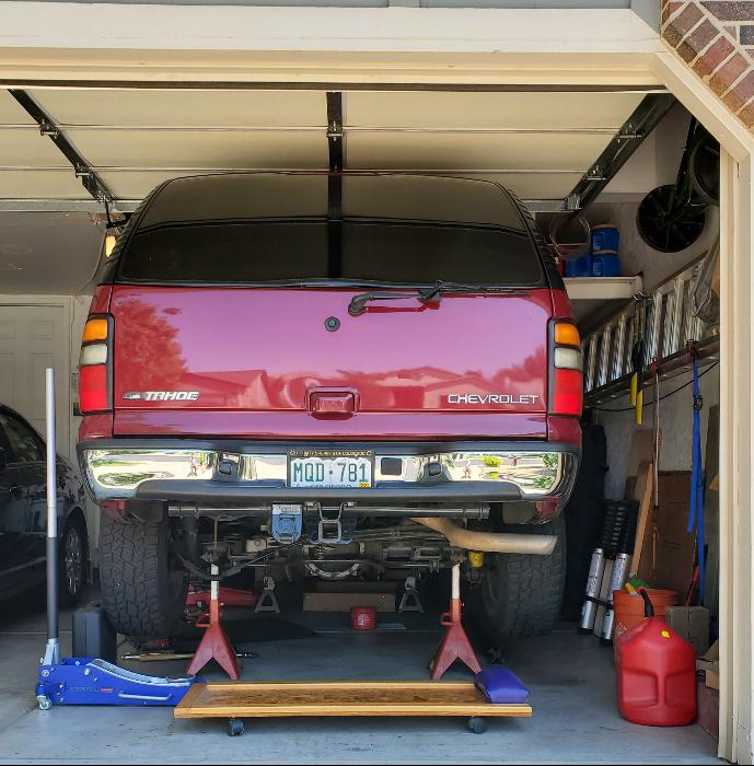

Yesterday, I put her up in the air, relieved the fuel pressure, and pulled the driveshaft, evap canister, and the evap connections. Schedule permitting, tomorrow morning after church my son (Nate) and I will drop the tank so we can install a new fuel pump gasket to fix the evap leak. Hopefully we'll be able to tell what went wrong with the new gasket we installed two years ago with the new fuel pump (all AC Delco Gold/Pro). Note vintage homemade creeper in the foreground.

Yesterday, I put her up in the air, relieved the fuel pressure, and pulled the driveshaft, evap canister, and the evap connections. Schedule permitting, tomorrow morning after church my son (Nate) and I will drop the tank so we can install a new fuel pump gasket to fix the evap leak. Hopefully we'll be able to tell what went wrong with the new gasket we installed two years ago with the new fuel pump (all AC Delco Gold/Pro). Note old homemade creeper in the foreground.
Nice creeper i would cut piece of memory foam and glue it to that and might fall asleep on it when under their.
