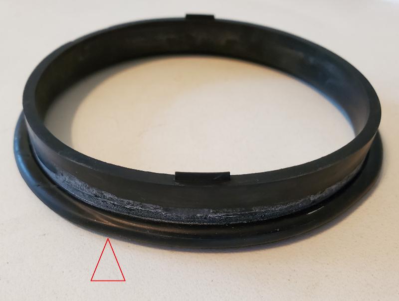

The gasket seems to have rolled a bit, or was malformed. You can see in the pic where it was leaking, all along the part with the light residue. The red triangle points to the start of the defective part, and it goes to the right several inches:

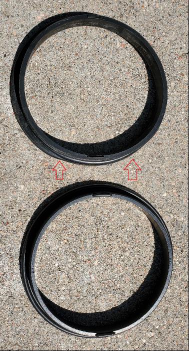

Here's a comparison of the old (upper pic) and the new (lower) gaskets. The new one (also AC Delco) is a less pliable material and looks like it will hold form better.

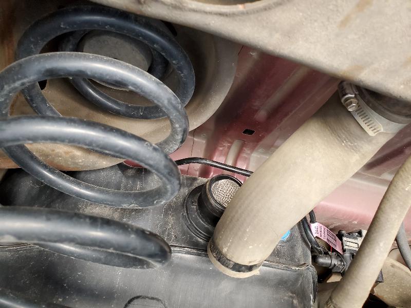

There is a strainer that slips into the tank filler stub, maybe to prevent siphoning? It just slips in and out but is the exact size for the inlet.

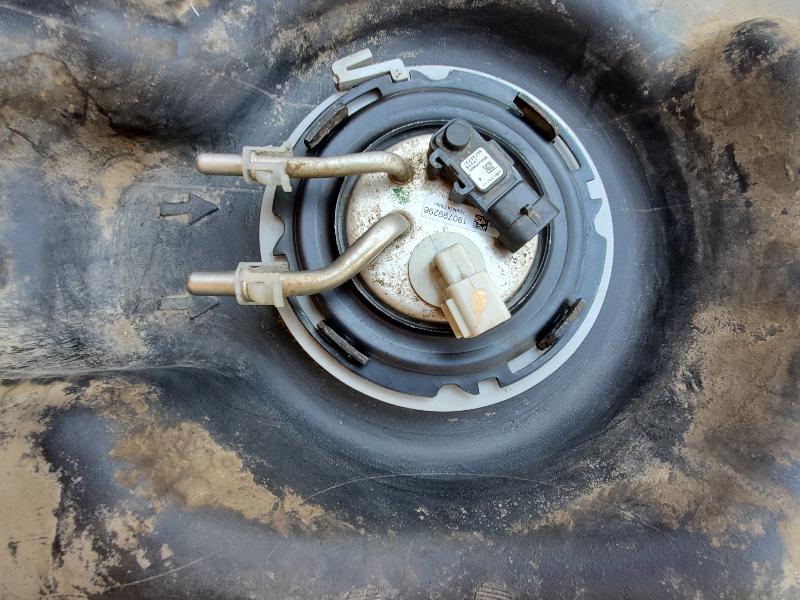

And, lastly, the pump and new lock ring as installed. To remove the old ring and install the new one we used channel lock pliers to put pressure between the ears on the tank and the notches in the ring. We did this on opposing ears with two pliers and so no hammer or punch needed.
