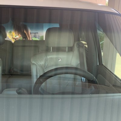

I’ve had my Tahoe in Arizona for 5 days now and just got this nice rock chip today. Right where I look out the windshield. Ugh! Lol. 20 year old Tahoe, 210,000 miles, factory glass. And they don’t make factory glass for the Tahoe anymore.
For those of you that don’t know, Arizona has a lot of rocks on the freeways and such. Most Arizona car insurance policies give you free rock chip repair and one free windshield replacement a year because you go through a lot of glass here. Also you go through car batteries every 2-3 years because they don’t last in the 120 degree summers.

That's a big chip, almost a hole. How does the rock always manage to make a chip exactly in your line of vision?? A sniper isn't even that good.

Debating getting the chip filled for $70 or a whole new windshield (not factory glass because it’s not made anymore) for $295 installed. Your thoughts?

$295? Around me it's $150. How good do you think it would look if it was repaired? From the pic it looks pretty deep.

For me, a new windshield without a doubt. You’ll get rid of all the pitting that’s undoubtedly there after 20 years and 210,000 miles. You’ll be amazed how much better you’ll be able to see especially at night or in the rain, if you ever get any.

Places here won't fix it if it's in the line of sight, which is basically a license-plate-sized rectangle directly in front of the driver's head. Might be a state law. There's a great chance of vision distortion with the repair right in front of you, and that will be most noticeable at night. Recommend getting a name brand windshield; I don't think you can go wrong with Safelite. I had glass insurance on mine when I had it replaced.
