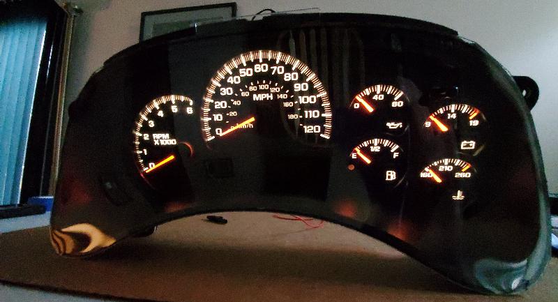

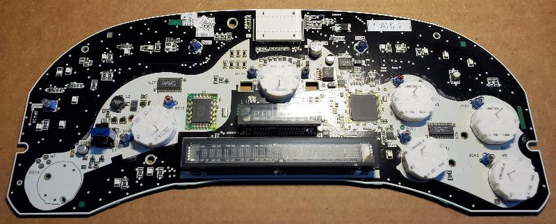

Nuttin' to mine today, but yesterday I pulled the cluster out of my neighbor's Hoe. Started the cluster re-work today. I'll fix dead bulbs and replace the stepper motors. Here's a pic of the board with the old steppers and the two dead backlights marked with red:

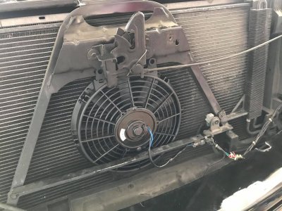

AUX fan. I am in the tropics, this helps a lot when just idling with the A/C on.
i know its not a huge fan, but you got a relay wired in? they put far less of a strain on the battery when you use one. i did twin 16 inch fans, and removed my clutch fan years ago. i put them on a switch and a relay for each fan.

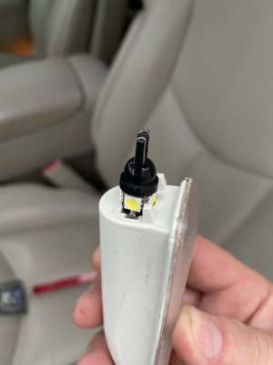

I bought an 05 Escalade esv a little over a month ago
82k miles on it
Had the cluster redone
Had a deck put in it for Bluetooth/ CarPlay
In the process of changing all the bulbs to led and I ran into an issue with the door light
Bulb is too big
Light casing seems to be glued together
Any advice on this one?
Thanks!

Dremel.... this what I did

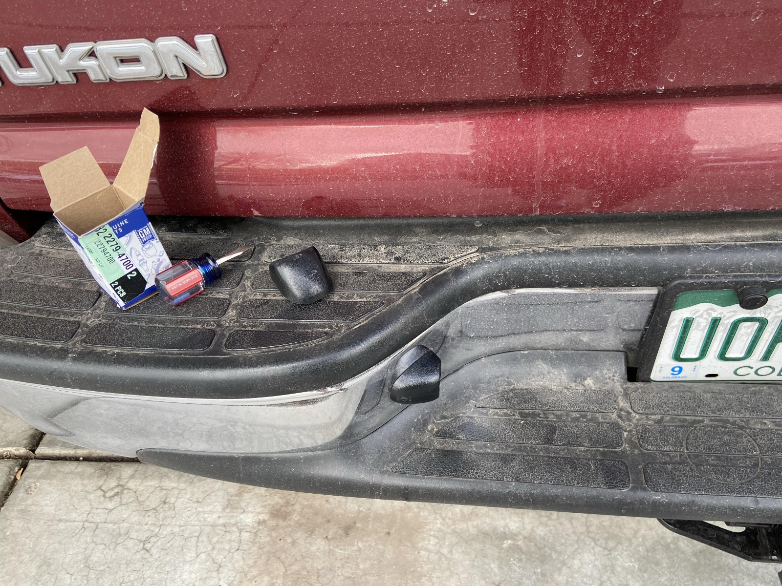

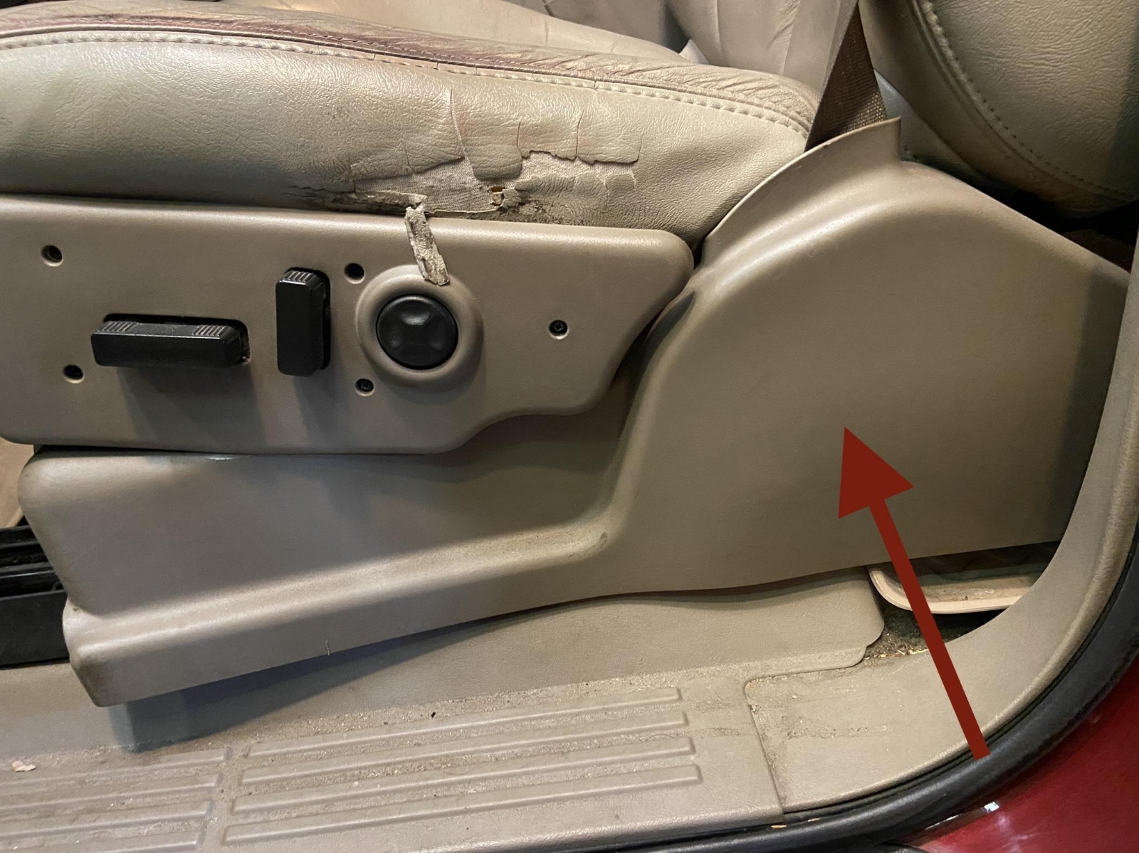

The other day, I found one of my tag lights had a broken tab, so was loose and rattling around... replaced both with OEM parts. Damn snow got us again.. another 6” or so on the ground here, and hardly anywhere else got much at all. So dirty truck.. Tough install. [emoji23]

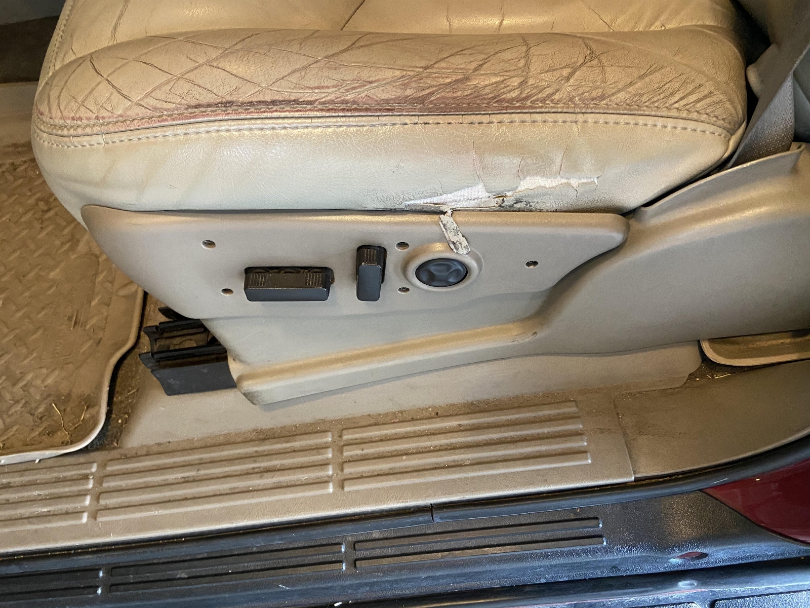

And, recently, I posted, looking for the seat frame plastic cover part number, since mine is warped.
As @Fless suspected, the last tab was not properly secured.. all I needed to do, was shine a light in there to see the bent plastic tab, and the metal clip not attached:
Popped those into their correct locations, and it’s made a significant difference. Unfortunately, the piece is still warped, from being that way for some time, but much better than it was.. I’d still like to replace it if I can locate a better piece:
I'll keep watching at the UPulls.... in the meantime how about a little light heat gun work? ;)

Not on this one. It's the neighbors' Hoe that needs a tranny they can't afford so they're not driving it. They're not sure what they'll do with it, they owe a pile of money on it and I offered to clean up the cluster. It's good practice for me and I'm doing it for free just to see what it takes.

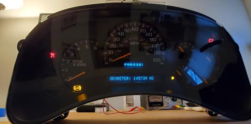

Some crummy pics of the aftermath, stepper motors, backlighting, PRND321 was barely lit. I couldn't power it all up at once since the connector pins are too close together. Everything seems to work okay and I'll get with the neighbor and reinstall this weekend.
That might work, just make sure not to heat it too much. Plastic tends to have a “memory” and the right amount of heat can make it regain its original shape.
Yup, I was thinking the same.. don’t want to do too much, but I’ll give it a little heat, and see if I can get it to flatten a little more. It’s already much better.
Yes, there's a dedicated relay for it. I'd like to do the electric fans too sometime in the future. =)
