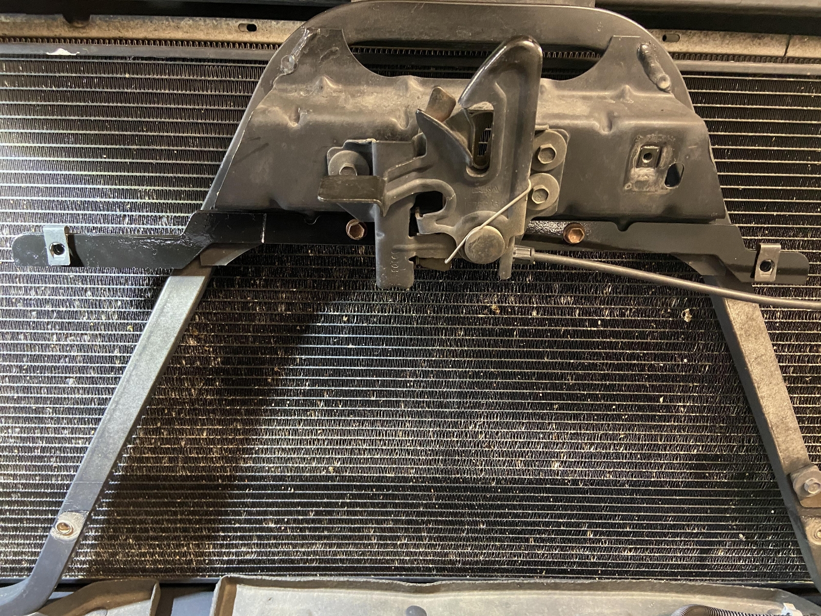

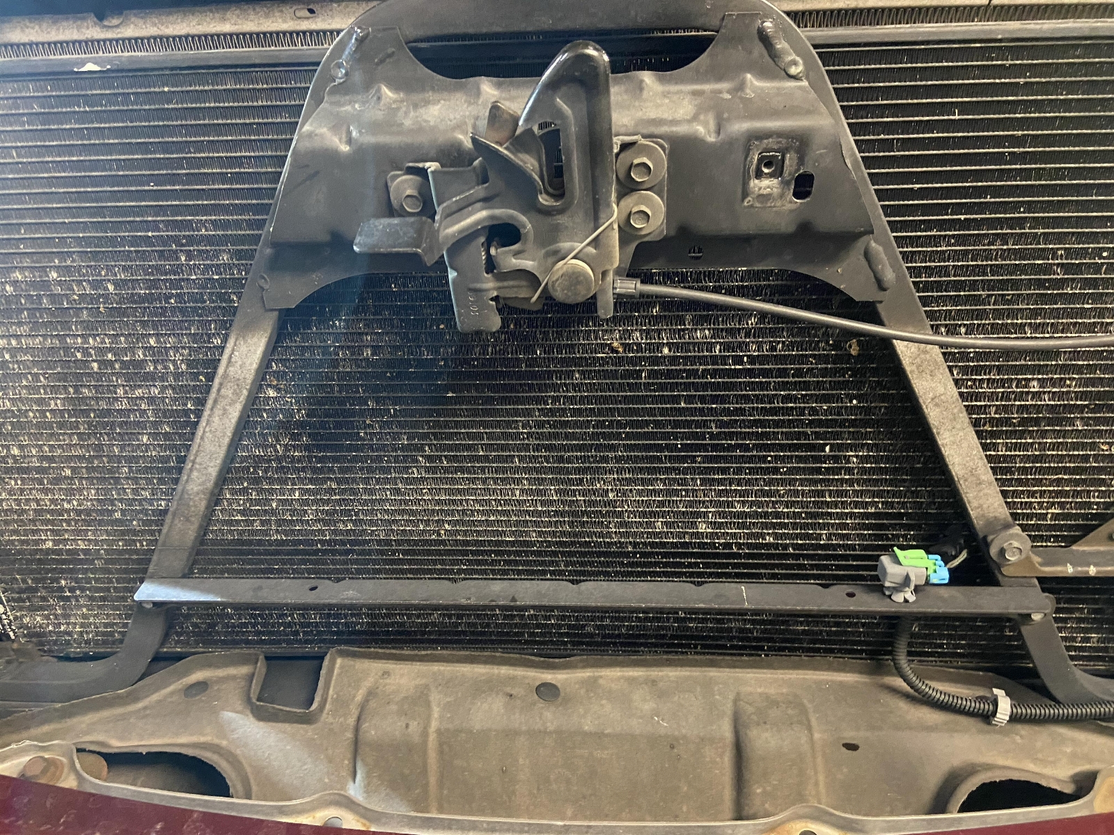

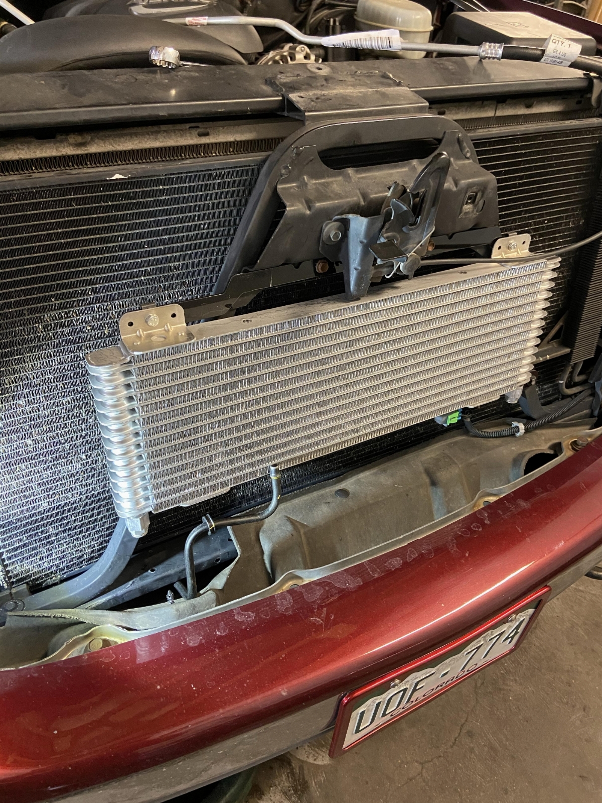

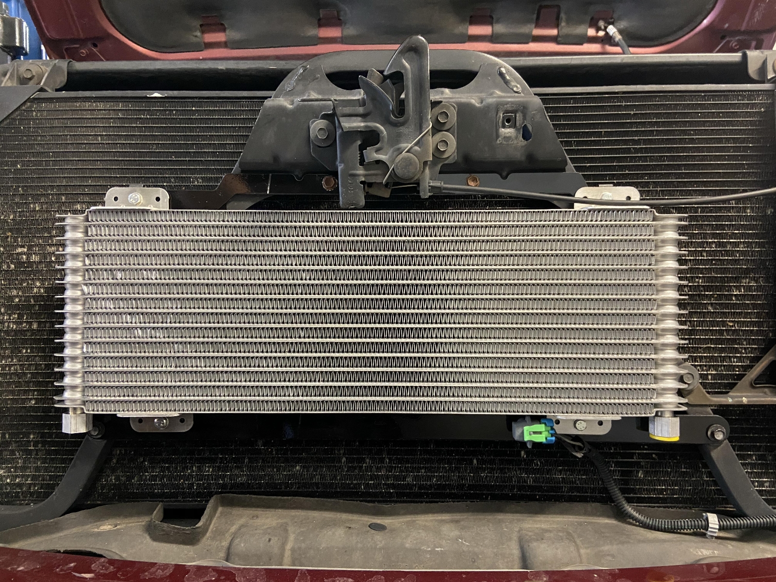

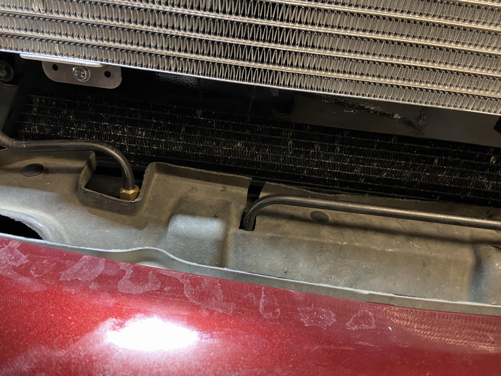

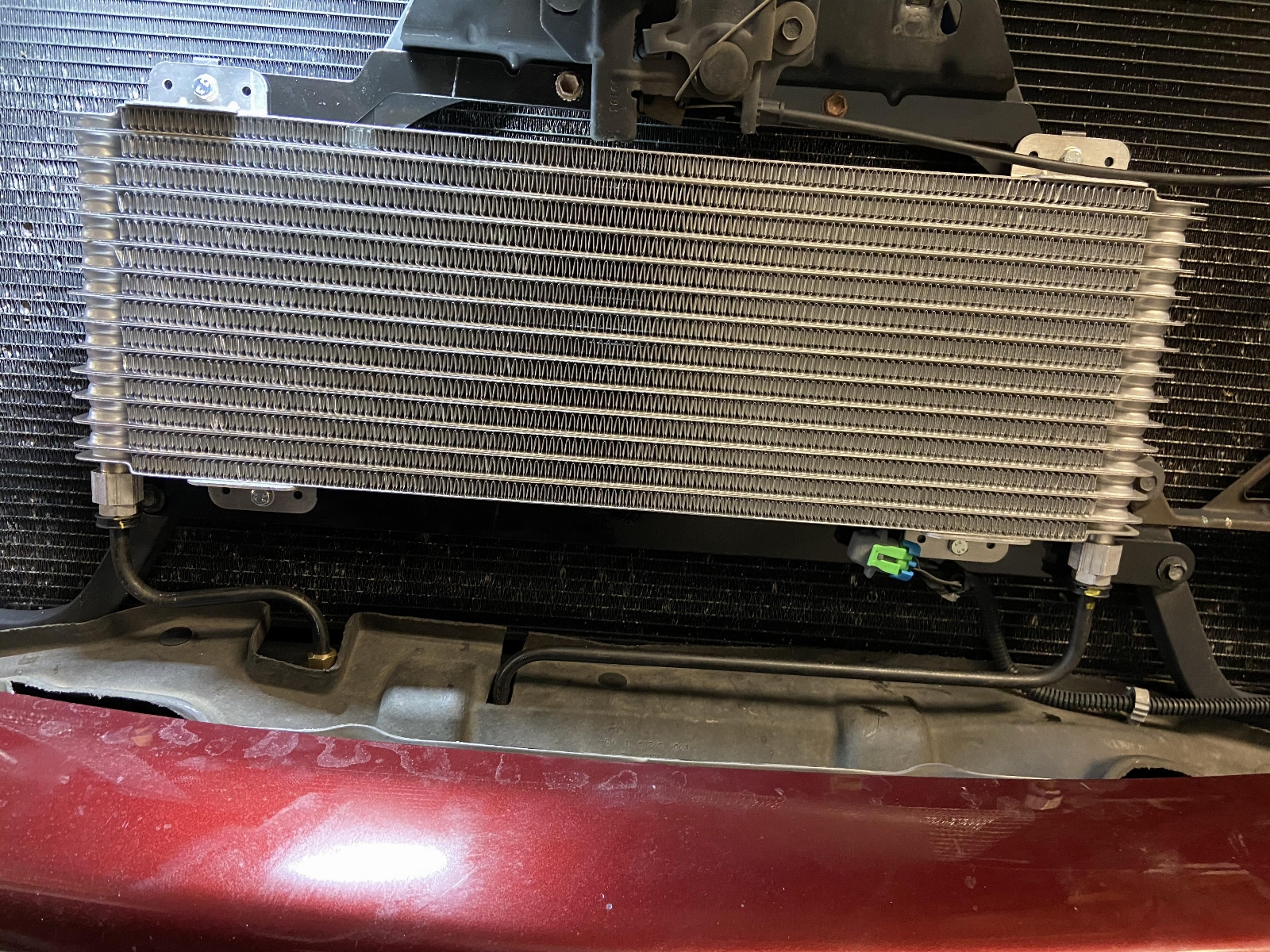

Trucool 40k install today! I was supposed to be doing the rear brakes as well, but I’m waiting on the powder coated calipers anyway, so a couple more weeks will be fine.
I bought the factory trans cooler lines, and we followed the instructions found here, and on another site I probably shouldn’t mention here. Worked like a charm! My temps were too high for cool weather and no load on the trans. After looking in more detail at the trans information on the Tech2, finding no slips recorded, and the shift times rather reasonable, with 212k on it.. I decided I’d rather try to keep this trans going longer, so cooling it off is key.
I also installed some heat shield I bought from Summit on the lines near the trans side, since they’re really close to the headers. This is probably most of the reason I had temps too high for my liking. And of course I forgot to snap a pic of that.. it’s this stuff: https://www.summitracing.com/parts/vpe-25832
After driving around for about 15 minutes, I couldn’t get the temp over about 110° [emoji1787] guess it’s working well!! Looking forward to seeing where it goes in the heat of the summer.

Nice work! Thought you had a factory cooler, but I guess not. That TruCool should be -- to use an old phrase -- the bomb!

you might want to relocate that ambient temperature sensor, when I did mine it would say it is was 111 deg in the dic when it was really only about 85-90
