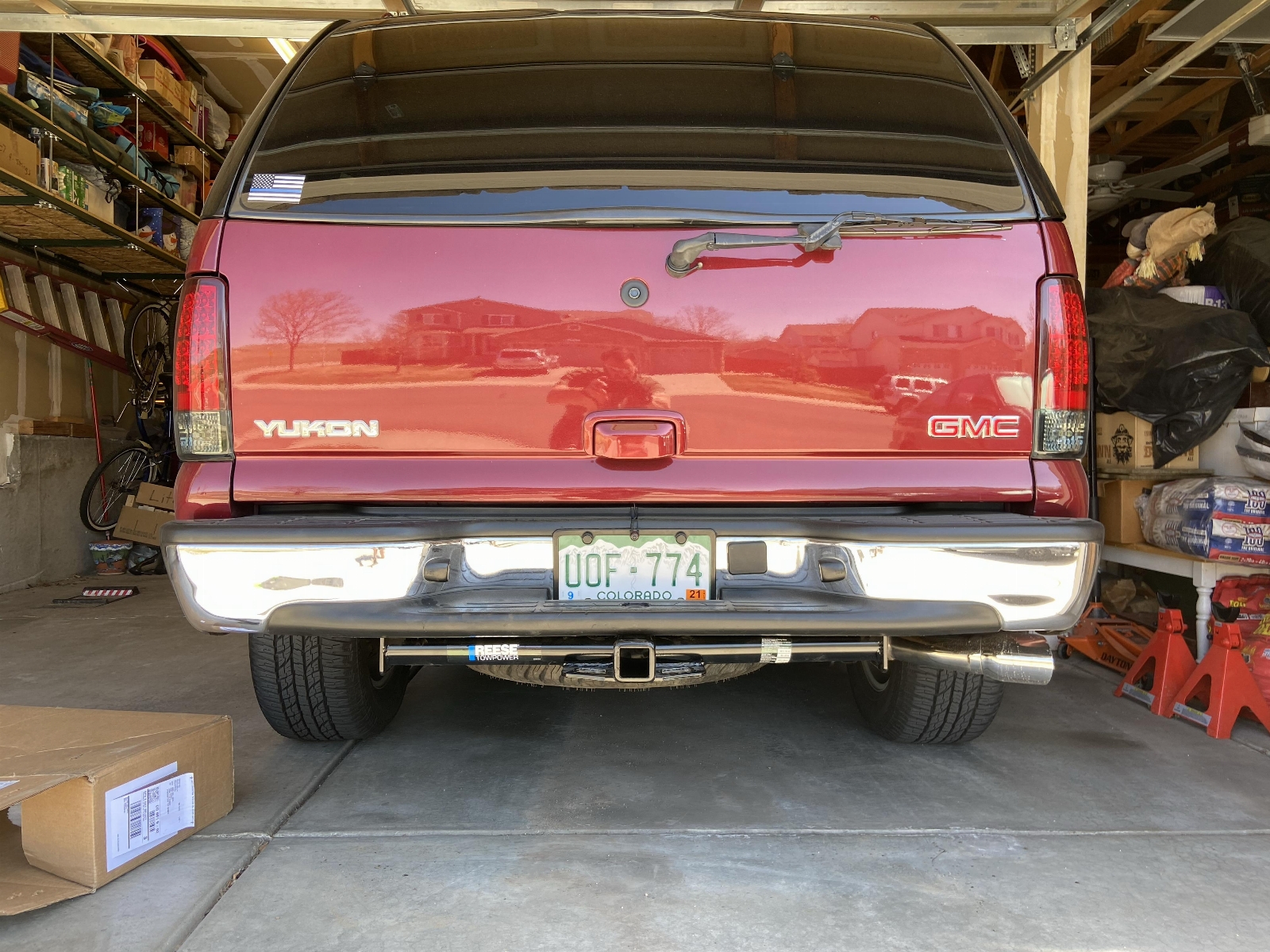

So, I couldn’t help myself, and even though I’m in excruciating pain from my POS back (can I get a new one please!?!!)... today I installed my trailer hitch. A few bucks over a bill, and hopefully a good amount of added protection from clowns not paying attention.
I’ve gotta admit, even though it’s super low profile, I’m still not happy with the look. Oh well, it serves a couple purposes.. i may try removing the stickers at least. That would help some. (After my back returns to “normal”)...

Are you gonna tow anything Sam?

Your truck didn’t already have a receiver?
Nope. And I liked it that way. Lol. But it’s good to have.
ETA: it does, however, have the 7-pin wiring harness all nicely tucked away in the frame rail, ready to plug in! So that’s a big plus. Don’t know the RPO code off hand, but I’m sure it’s on my build sheet.
Your trailer light circuits should work fine; those are usually already fused. But if you ever need to add a brake controller and/or a 12v feed to the trailer, there are wires near the underhood fusebox that will need to be connected, and large fuses installed. Doesn't sound like you'll need those at this point, though.
Thanks Steve. Yeah, I’ve looked at some brake controllers and figure if I end up towing anything heavier, (with brakes), I’ll add a Tekonsha most likely.

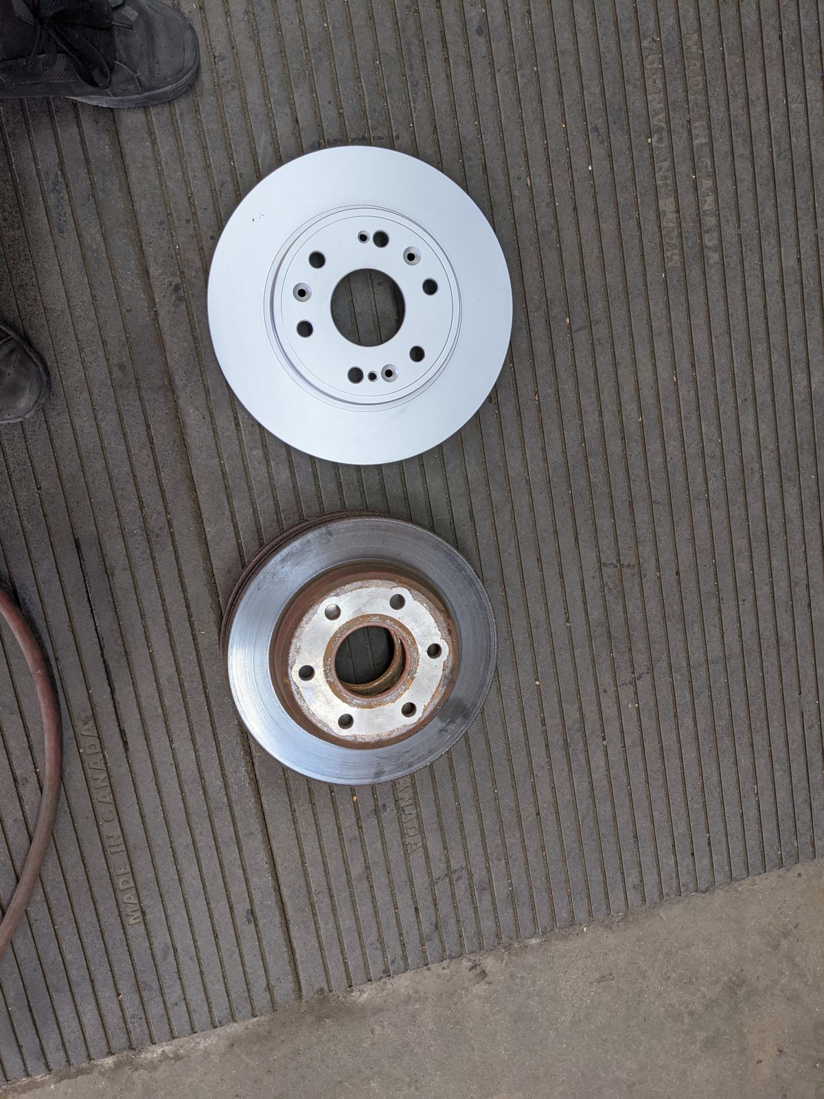

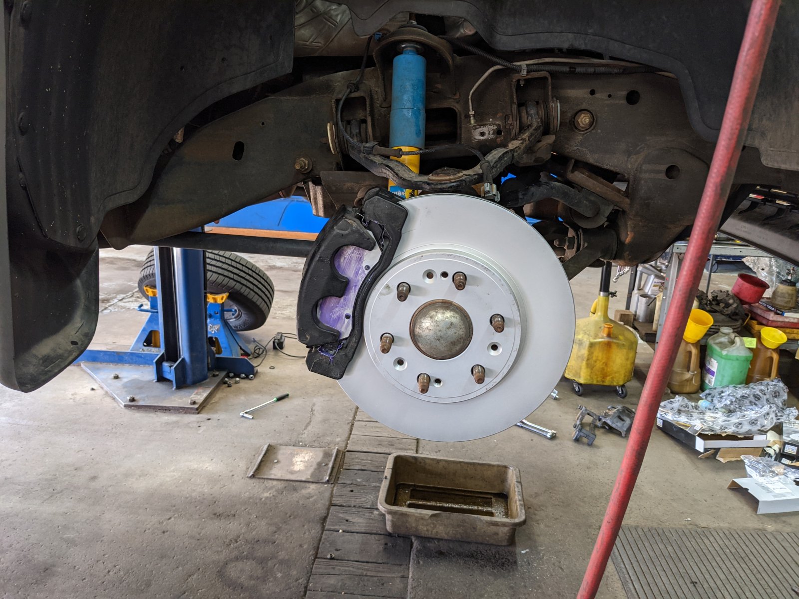

Hubby and I got tired of the 06 Sierra Denali's horrible brake performance compared to our 09 Tahoe... So we upgraded the front brakes to the GMT900 style, and now it stops so much better.
I didn't get many pictures because this upgrade has been done by so many of you guys, but I had to have the proof :)
