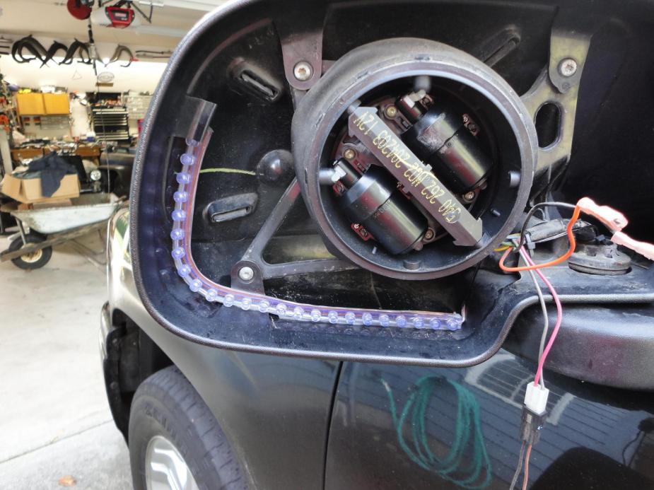

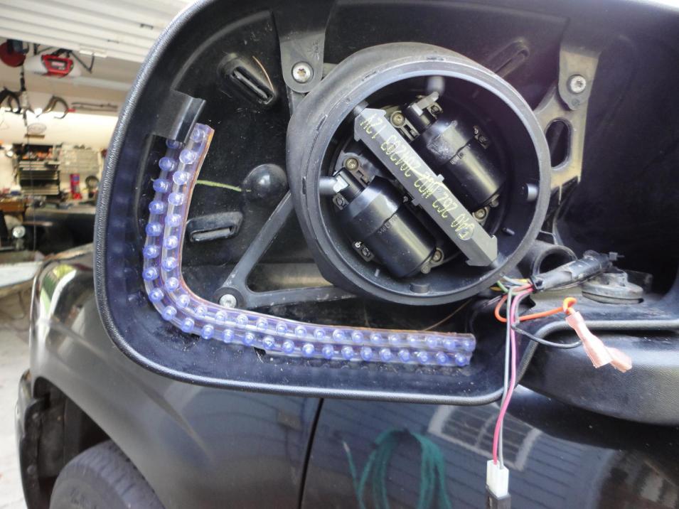

Just modded the mirror turn signal mod that I did a month ago....... and now I love it!! Added another strip of LED's on top of the first one in the mirror housing, now it is way brighter and now I have the LED look on the bottom and the side of the housing that I was after in the first place!!
If anyone is wanting to do this mod to their mirrors and install their LED's the way I did, I would highly recommend using 2 LED strips per mirror housing, this way when the blinkers are on, you will see LED's on both sides due to the angle of how the mirrors sit on the truck in comparison to looking at them from the rear of the truck!! Hard to explain on here but take my word for it, it is a way more uniform look!!
Video will be taken here in a hour or so when it is fully dark here and I will post up both the before and after so you guys can get an idea of what exactly what I'm talking about!

Yeah, it's hard to explain over the computer!! Basically, if you stand behind your truck and look at your side mirrors, you will notice that the mirror housing isn't exactly angled at a 90 angle compared to the truck, so since I mounted the LED strips directly on the interior of the housing but in from the edge of the housing at about an inch in, the side portion of the LED's in the housing actually aims at the rear door! By putting that extra strip of LED on top of the other, you can actually see individual LED's now on the side and bottom! Basically, you now see the second layer of LED's on the side of the mirror, while seeing the first layer of LED's on the bottom, because of the angle of the mirror housing from the rear of the truck!
So hard to explain what I mean but hope that kinda helps out! But trust me, after taking my videos tonight of how everything looks, I do highly recommend 2 strips per housing! No overkill at all and very uniform, bright but not obnoxious!!

Sorry guys, hard to explain unless you can see it in person!! As for the arrows, I don't have those built into the mirror but would still love to have those as well as the strips in the housing, both would look pretty cool together!
I love the mod, I was on the fence with how it looked with the single strip but I absolutely love how the double turned out!! Just wish I had a good camera that could take good night videos, the video makes it all look like crap but it looks pretty cool in person!

I have full range of the mirror lens because I figured out how thick the mirror lens was and also how far into the mirror it traveled and then stuck the LED's an 1/8" farther in there so that way the mirror will never hit them! The front of the LED's are 1 1/8" in from the outer edge of the mirror housing, that's just what i figured would work for mine! And yes, it's pretty easy to do!
