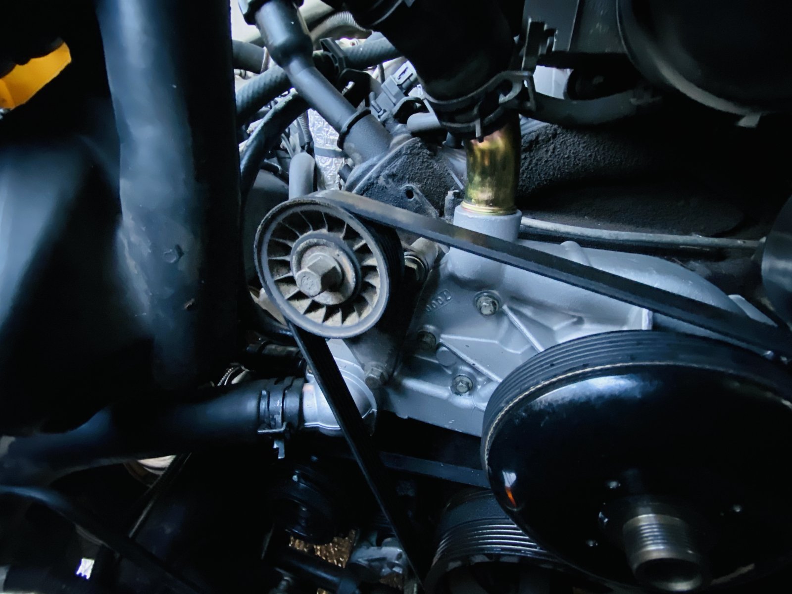

Installed the new water pump last night. Waiting on the e fan and harness to come in and lucked up finding a shop 1.5 miles from home for the pcm flash.

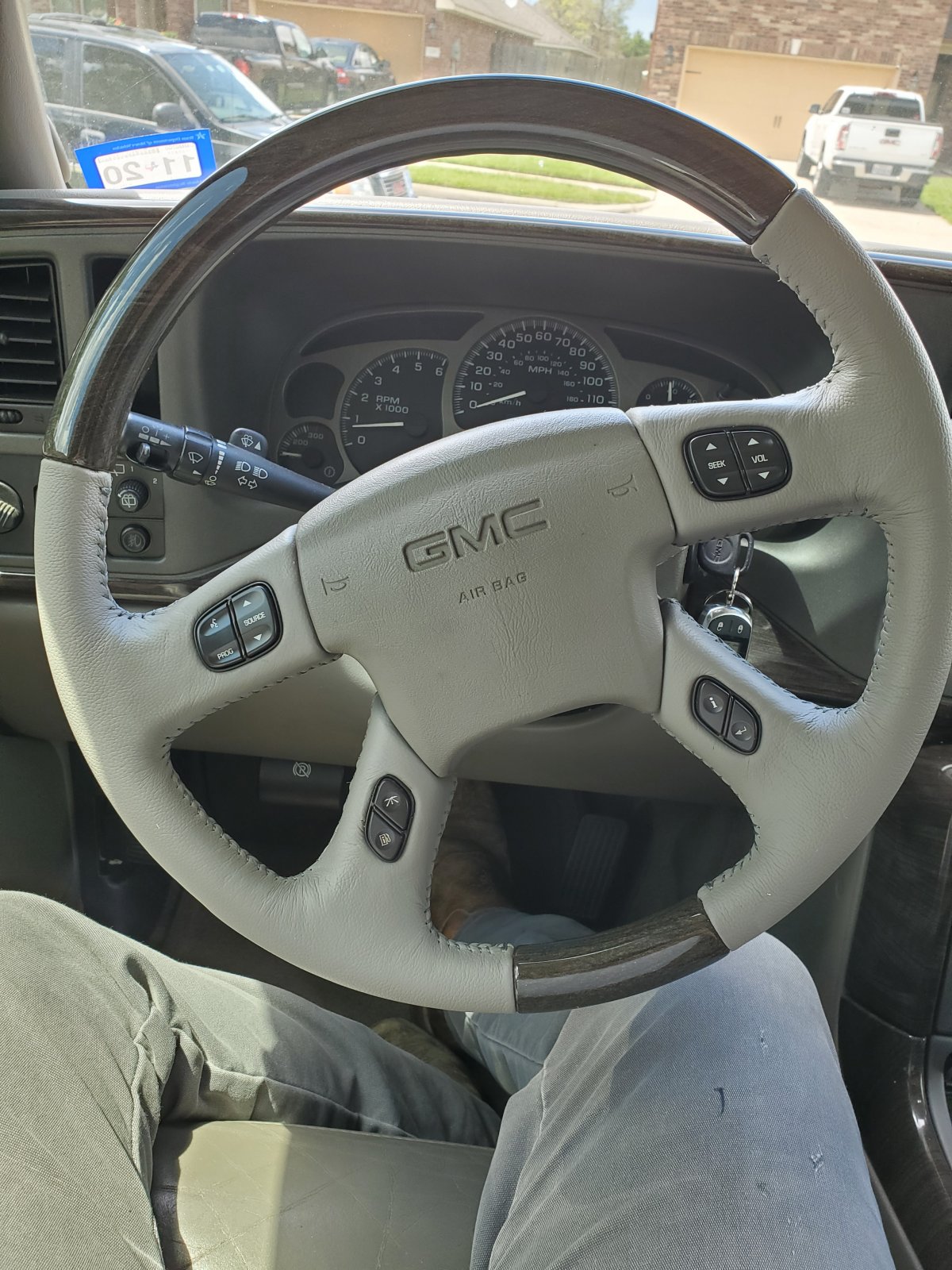

Thought it was a factory steering wheel! Still looks good!
