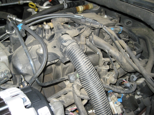

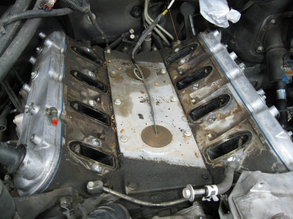

Very nice! How long did it take you?

Way too long. I ordered the valley cover gasket set through Amazon Prime and it arrived a week late due to bad weather. The knock sensors arrived late too. I also disassembled the intake manifold and took it down to the car wash for a good cleaning. I could probably do the job faster now that I know how to disconnect all of the different electrical connectors on the wiring harness without breaking them. :)
What way too long lol? 10 hours? A full weekend? Did you notice a difference in drivability after or performance or fuel economy? I want to do this simply just to clean all the grime and caked on gunk. Plus I noticed a lot of the plastic covering for the wiring is flaking off so it would be a good time to replace all that.
On my tahoe I pulled the fuel rails and injectors and cleaned them and the ports and noticed a difference in fuel efficiency by a couple mpgs
Do you have a link to the stuff you ordered? I assume it's the same for the 6.0 and it is for the 5.3?

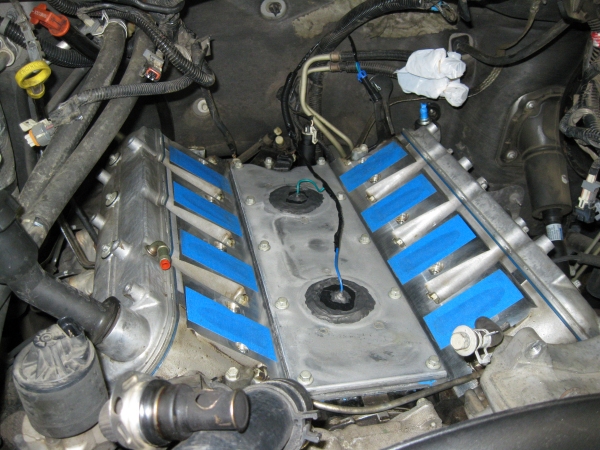

I worked on and off over a weeks’ time, so I would say 7 hours is about right. That’s way longer than a GM Tech would take, but when the OCD kicks in every nut and bolt gets cleaned, lol. I’ve lost some of the dexterity in my hands, so that doesn’t help either.
I had a stumble at idle issue with my 5.3L before replacing the gaskets. I sprayed B12 throttle body cleaner around the intake ports and it caused a momentary rough idle when spraying cylinder #3, so I knew the intake gasket was leaking. The stumble at idle is completely gone now and it made a noticeable improvement in drivability.
Two inch wide 3M painter’s masking tape works well to cover the intake ports, and it doesn’t seem to be affected by the B12 cleaner so you can spray away.
Here’s the parts list for my 2001 5.3L. I recommend checking the price and part compatibly with your engine on Amazon or Rock Auto.
Intake gasket set
https://www.amazon.com/gp/product/B000C2AKCY
Lifter valley cover gasket set
https://www.amazon.com/gp/product/B0060ZAUHM
Knock sensors
https://www.amazon.com/gp/product/B000K02EDG
Knock sensor harness
https://www.amazon.com/gp/product/B007H8DKJG
Oil pressure sensor
https://www.amazon.com/gp/product/B000C9Q2LA
Cam position sensor
https://www.amazon.com/gp/product/B000C9HZ3Y
PCV valve
https://www.amazon.com/gp/product/B00S0GLNO8
Throttle body gasket
https://www.amazon.com/gp/product/B000C2G7VM
Fuel injector O-Ring kit
https://www.amazon.com/gp/product/B000C9LBKM
Fuel rail O-ring kit
https://www.amazon.com/gp/product/B000C9IXZI
EGR O-ring, ugh…
https://www.amazon.com/gp/product/B000C2AEV6
Threadlocker medium strength for intake bolts
https://www.amazon.com/gp/product/B0002UEMZ2
I hope that helps you out, good luck with it.

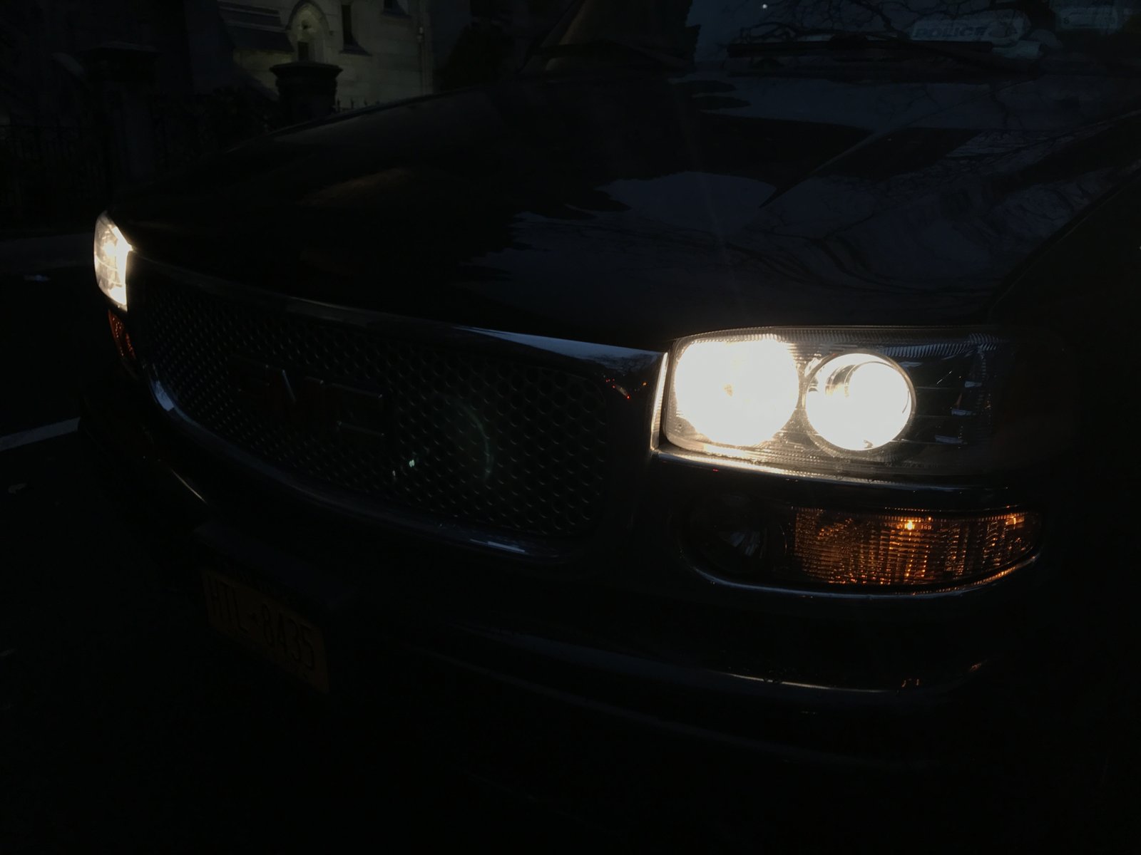

Had a spare headlight so I took the adjuster off it and put it on the lights my retrofit is in. Then I decided to try to bake these apart and get this permaseal apart. Holy shit what a ***** ended up breaking a lot of the housing but I feel that they could be sealed back up with some silicone or plastic job weld.
I'm gonna practice painting the housing and cleaning the lens before I attempt this on my housings I'm also gonna try a demon eye both passive and led

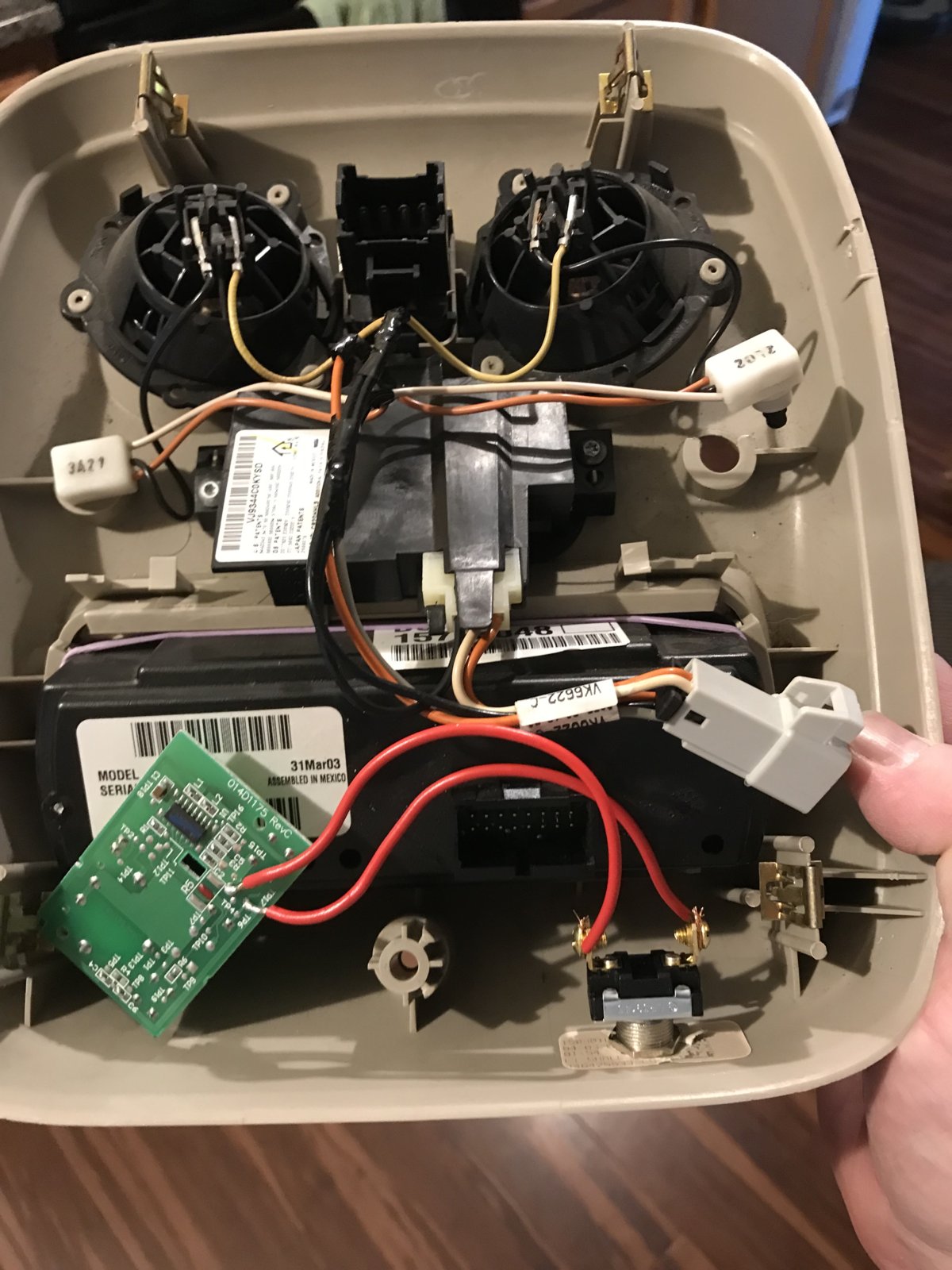

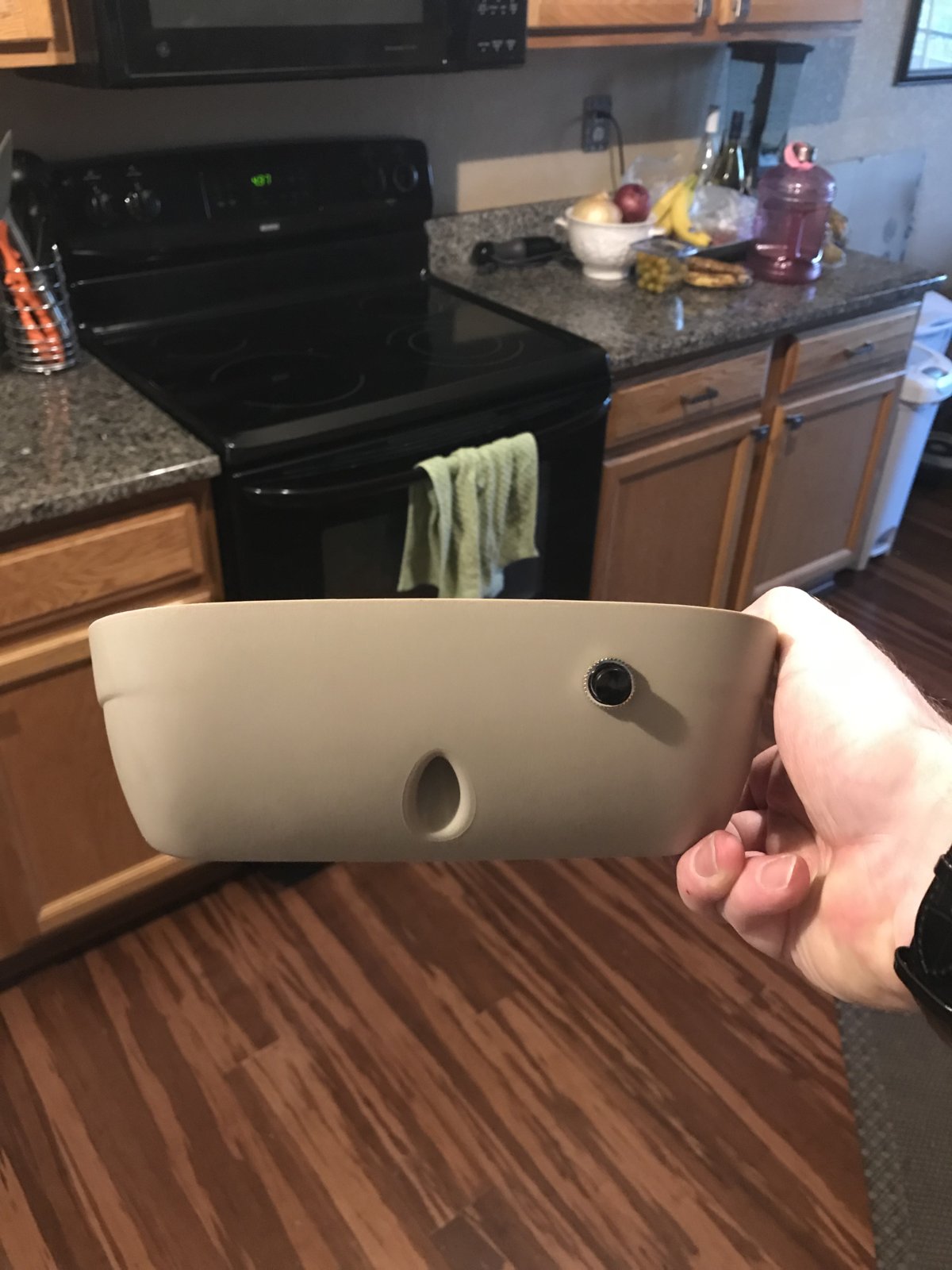

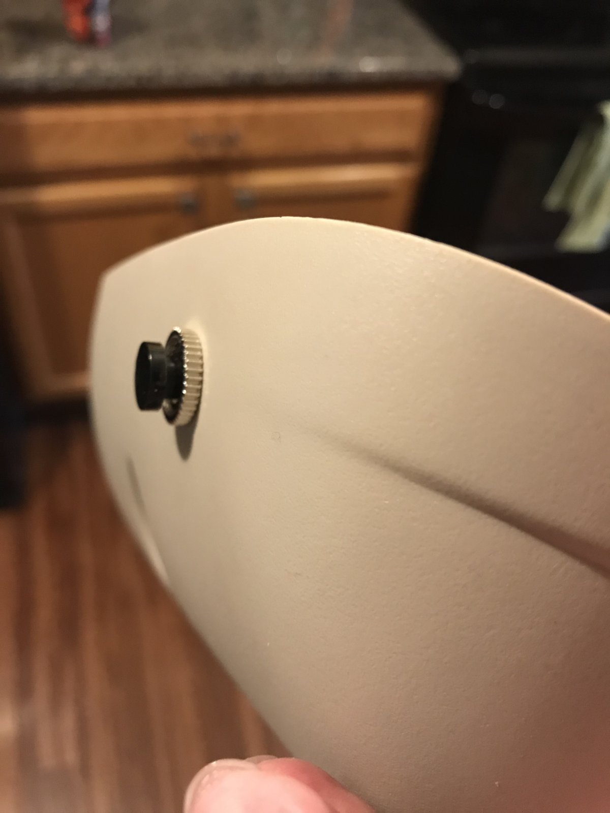

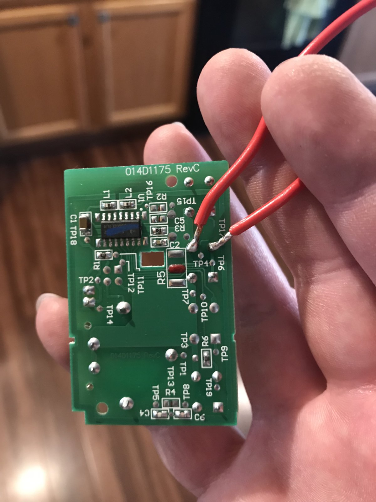

I wanted to program the Homelink transmitter to open my garage door, and found out the Yukon's version is too old to work with my door opener, circa 2015. After ordering the $40 "compatibility bridge" I decided that was a waste, and I wasn't going to pay for that, and cancelled the order. I copied another user's method found here, and added a momentary switch to the overhead console, somewhat hidden, to get the job done. This works great! The opener already had a pretty damn good range (over 1 block), but now it's probably a couple thousand feet! I haven't tested how far yet, but to give you an idea: View media item 27535 Not that I really want to open the door until I'm much closer, but wth.. that's a hellova range! IMG_3793.jpg IMG_3794.jpg IMG_3795.jpg IMG_3796.jpg
Not sure why my first image didn’t come through..
treehan77
TYF Fiend
Feb 1, 2015
1,446
1,216
Crestview, FL
I wanted to program the Homelink transmitter to open my garage door, and found out the Yukon's version is too old to work with my door opener, circa 2015. After ordering the $40 "compatibility bridge" I decided that was a waste, and I wasn't going to pay for that, and cancelled the order. I copied another user's method found here, and added a momentary switch to the overhead console, somewhat hidden, to get the job done. This works great! The opener already had a pretty damn good range (over 1 block), but now it's probably a couple thousand feet! I haven't tested how far yet, but to give you an idea: View media item 27535 Not that I really want to open the door until I'm much closer, but wth.. that's a hellova range! View attachment 213746 View attachment 213747 View attachment 213748 View attachment 213749
So you added a button instead of clipping the remote to the visor? Why?
