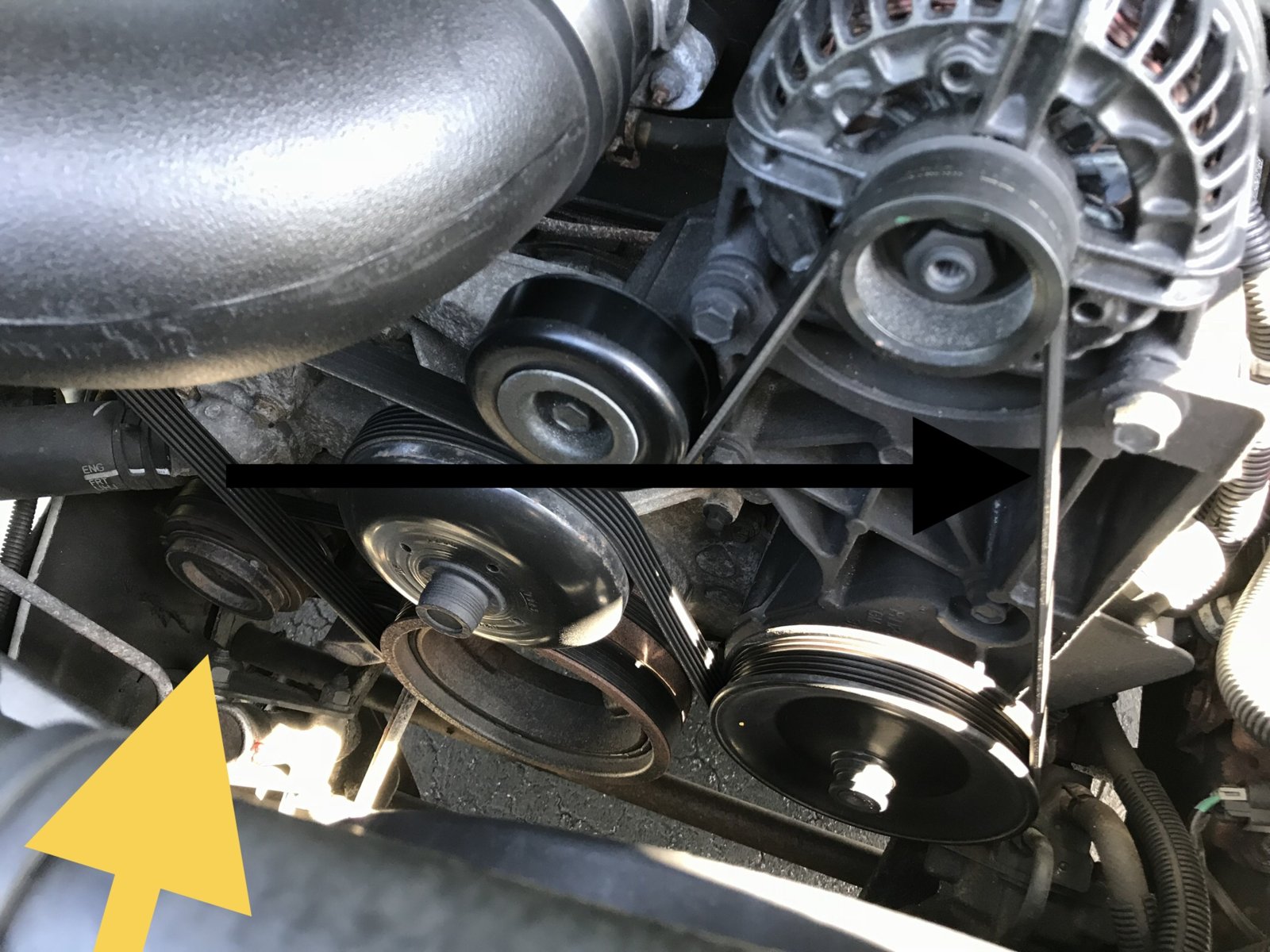

See photo below with yellow arrow for where I am hearing the noise.
AC clutch, idler puller, bearings, belt?
A/C on makes the noise.
A/C off some noise, but not as noticeable. Sometimes gets a bit quieter after more driving. Quite pronounced at start up. But always clicking.
A\C blows cold and strong.
Yellow arrow is where noise is most noticeable.
@Fosscore when was last a/c belt change? I’d slap a belt on but while its off spin all pulleys that you can by hand just to see if anything jumps out at you, then put new belt on... cheapest, easiest and you’re gonna end up doing it anyway. Idk..... just my .02. Good luck

@Fosscore when was last a/c belt change? I’d slap a belt on but while its off spin all pulleys that you can by hand just to see if anything jumps out at you, then put new belt on... cheapest, easiest and you’re gonna end up doing it anyway. Idk..... just my .02. Good luck[/QUOTE]
Ok. Serp and AC belt at same time or just AC belt?
Take a spray bottle with water and spray on certain parts. Like the AC belt and see if it changes the sound.
Might give that a go as well.
Thx input guys.
Would like to accomplish this one myself, but TBH I do not recall last belt change without digging through my binder.
I have not had to deal with a belt change myself, but wouldn’t mind giving it a go. I can YouTube it, but you guys have any tips? Thx.
Thx input guys.
Edit: watched YouTube video, but got sidetracked with this...
View attachment 207587[/QUOTE]
Do a/c first, To narrow it down
Will go that way first then. Thx.

Yes 4.8 and the AC never gets a break, even though the truck is not my DD. I just saw those fleet runner and more $$ parts and always like to use OEM if can, but wanted to see what you used. Thx for the info.
4 bolts to drop the plastic splash shield and you’ll have tons of room to work. Good luck

I figured a good old refresh was in order for mine up here in rust land. Agree with Pete. My noise was definitely the AC tensioner. Quieted right down when I shot it with aerokroil.
