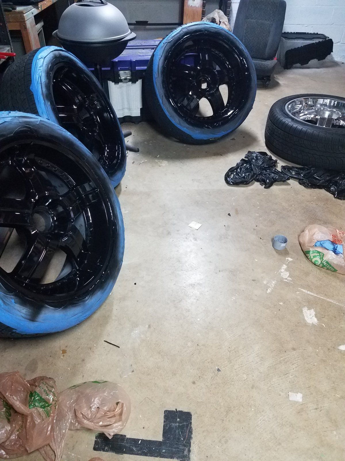

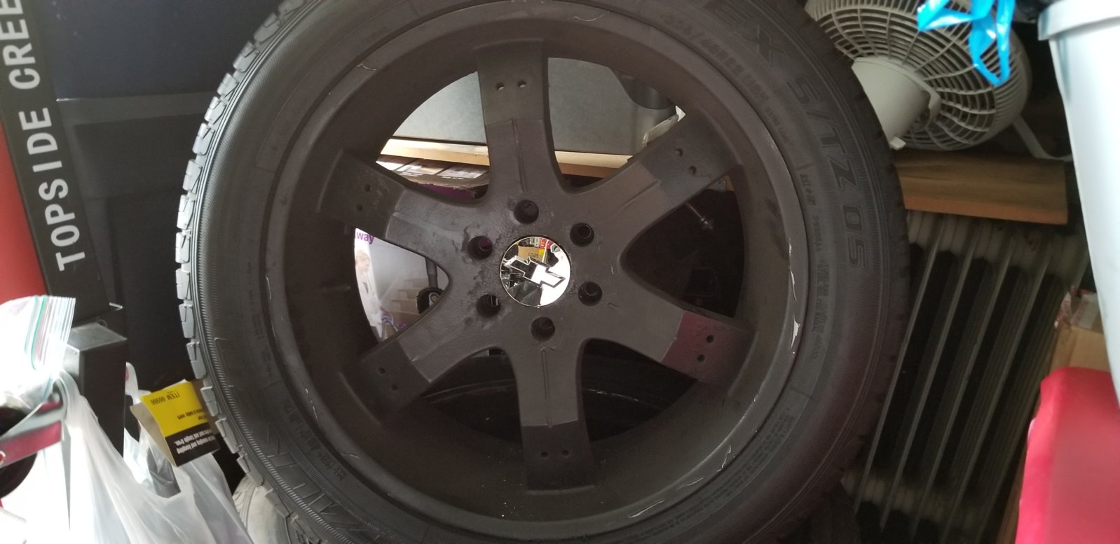

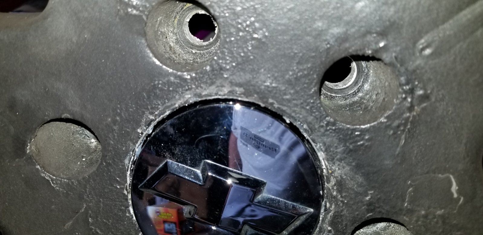

It feels like I'm at the same spot i was weeks ago but 3 wheels clear coated and waiting to cure 1 wheel untouched ugh..... looking at it makes me tired so much sanding to get chrome able to hold paint

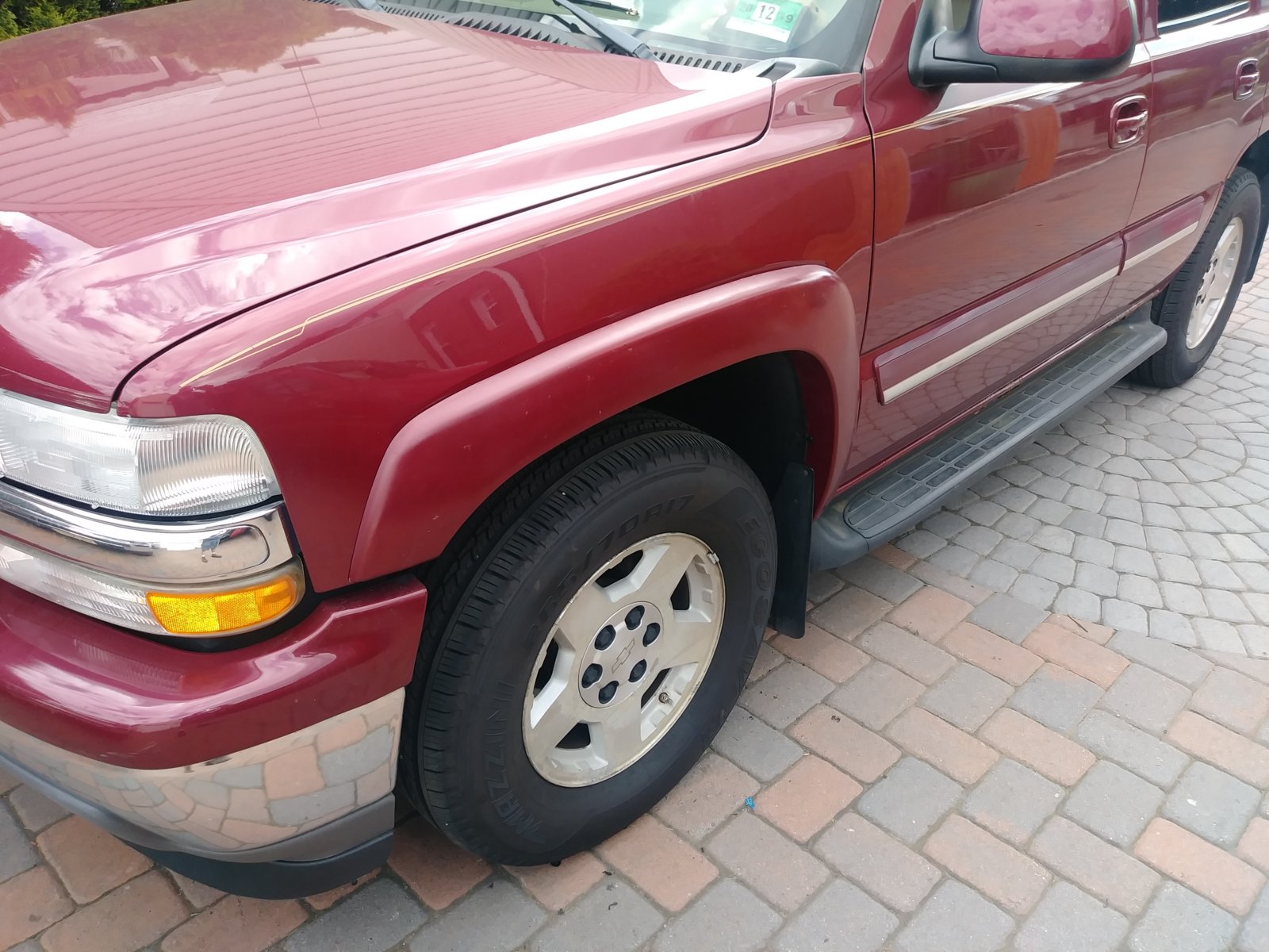

picked up push pin clips to mount the fender flares with, got one on after work. took bout a 1/2 hr being i had to drill the holes. lucky for me the 05 work truck has flares and i pulled one pin to figure how large the hole should be, then a bit of masking tape where the holes are, then marked and then drilled.
the rest will go faster. learning curve as always.
this is wet sanded. im mounting them to be able to buff em out better/easier.
and im going with nailed the color!!!!!!
im going out of my way to get the rest mounted now. im liking this look so much better. makes it not look like a 1500 lol

Def nailed the color- where'd you get the paint? Automotivetouchup?

went with this place. https://repaintsupply.com/ its by paint code, reviews were good. also they sell a larger can by like 5-6 oz's for the same price as many other brands. iirc it was 21 a can. bought 4 cans used 3 got 3 coats, then i got one can of clear, got two good coats out that. wish i got another can really.
i want to paint the chrome part of the grill red next, was hoping id have enough, but no way one cans gonna cut it. so ill order up anther can and one more of the clear and get on that over summer.
