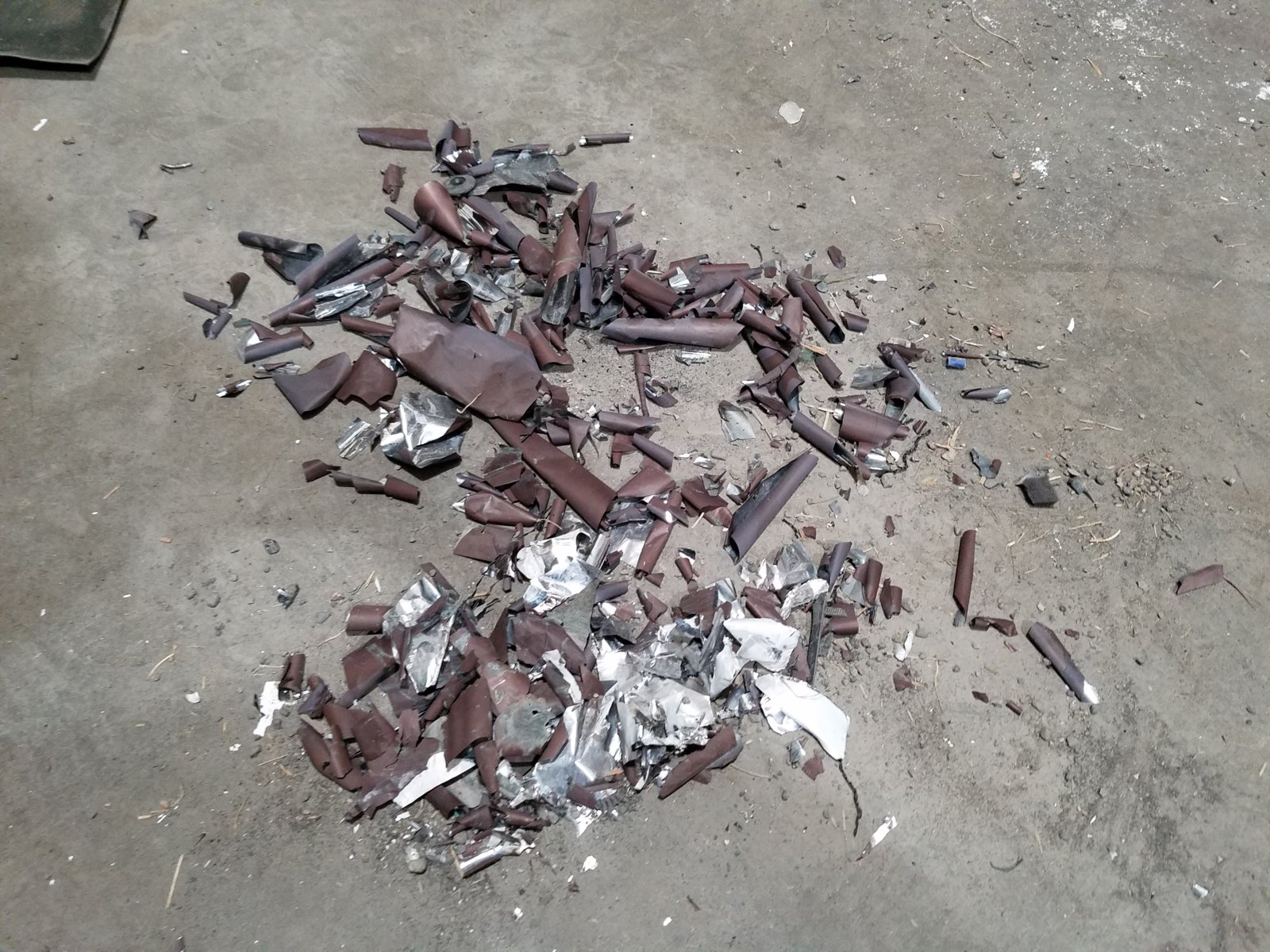

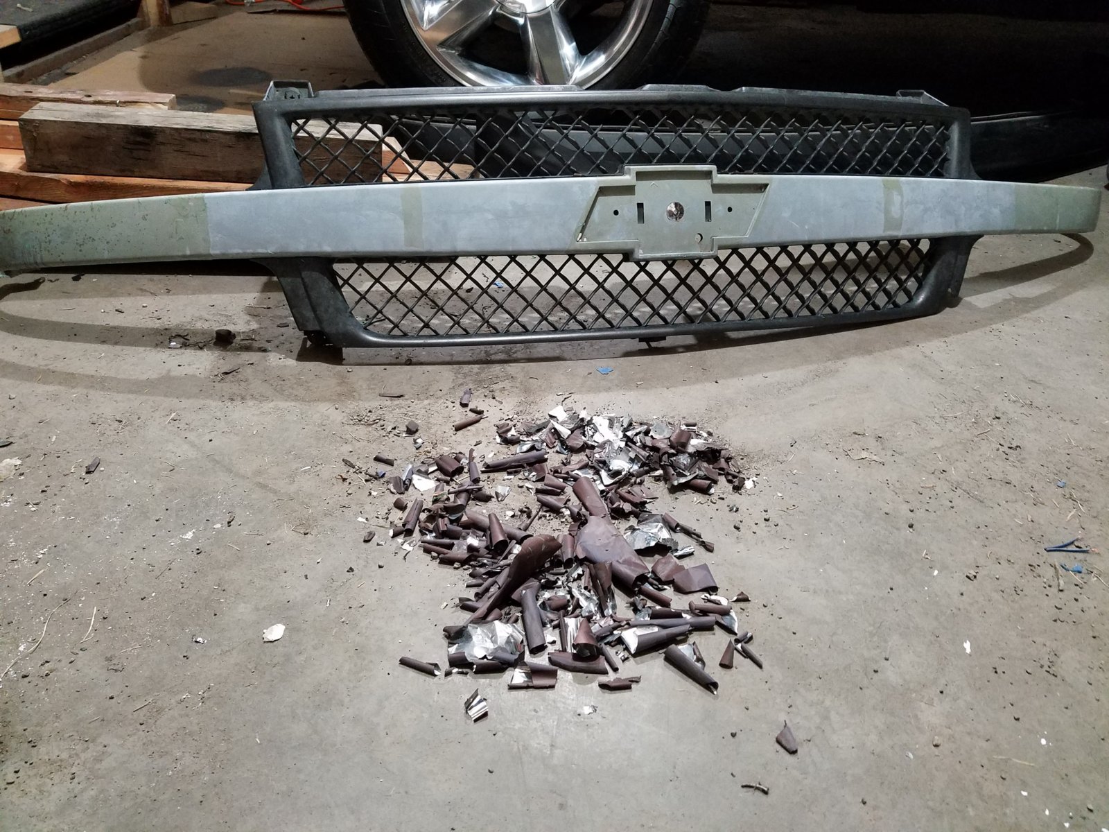

Is this what needs to be done to paint the chrome grill? I' thinking about painting mine body match after my wheels are done
I had a body shop sand the shit out of mine and use etching primer. 2 years so far and it's still good. I tried peeling the original and no bueno, it only partially came off with a razor and ruined it. I had to buy an aftermarket. I don't know how @05Single is getting that all off.
Well it's the best way if you can get away with it. My grille is flat and easy to use a blade. Plus it was already bubbling in some places so I had no choice. If it wasn't I would've just sanded like crazy like how @Rocket Man did his , which is still a correct way but if you ever get condensation or separation between the grille and the chrome later that could be an issue. But these nbs trucks are old, if there' no bubbling by now then you should be good lol .

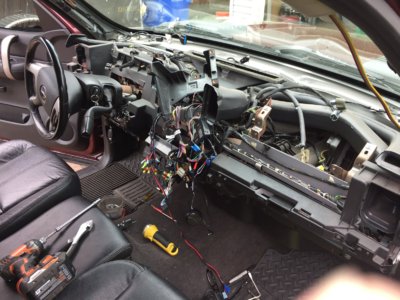

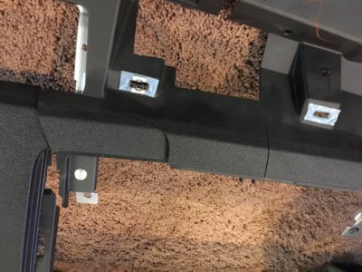

Well it's my CC but I thought you guys might enjoy what I'm doing today to my dash. This is one stupid ass GM design. It went from 2 small cracks to about 4-5 by the time I got this damn thing off. I WILL repair this POS and put it back in.
View attachment 199455 View attachment 199456
What kind of expoxy are you gonna use? Also, the guy in a video used some metal pieces to brace up the cracks. He epoxied over it.
