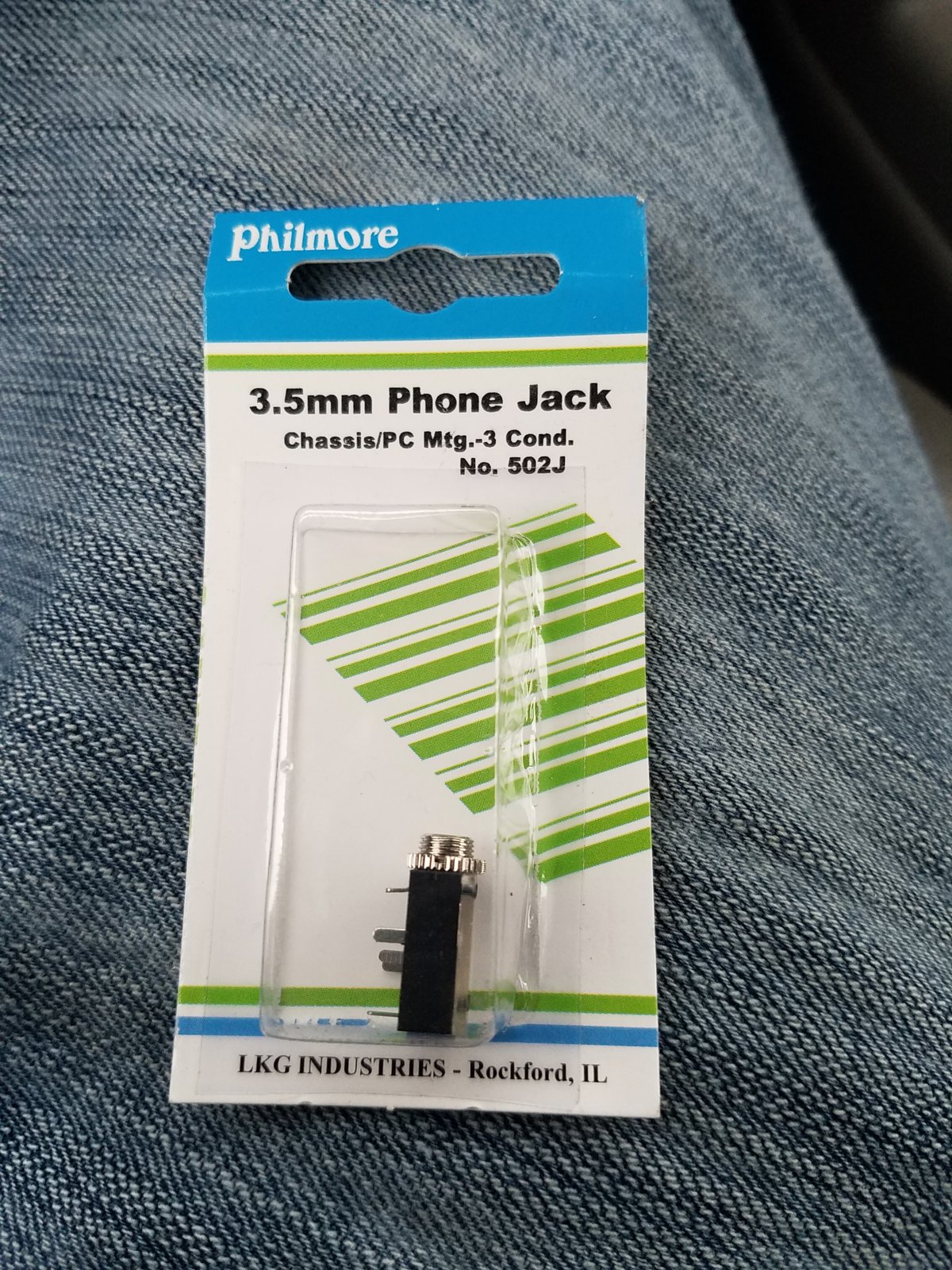

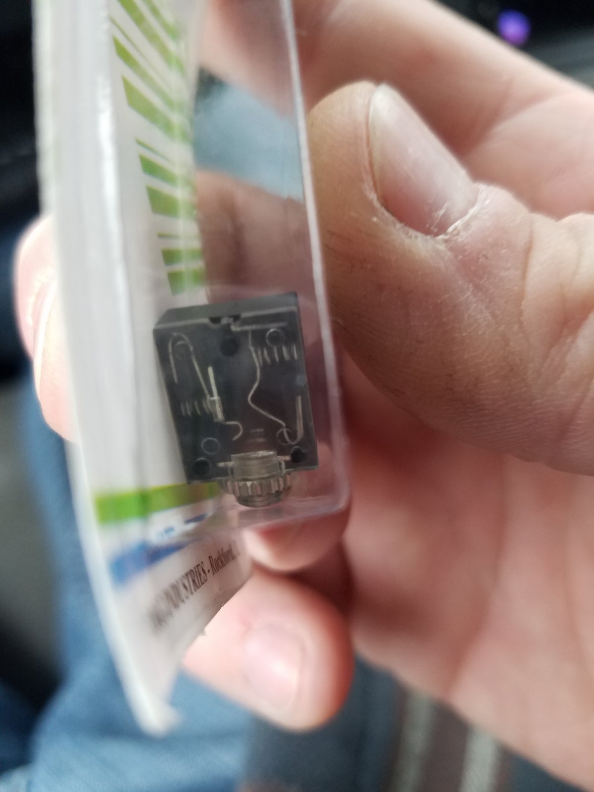

Here's the jack i used. It is "switching" so there is no bleed from the XM. The only trick is if I want the xm, i need to unplug.

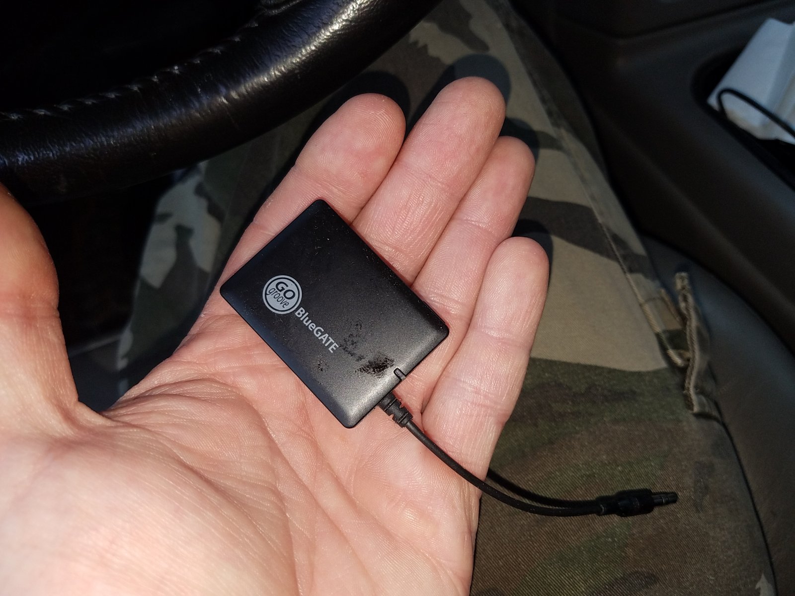

Here's the adapter. I bought it at frys.

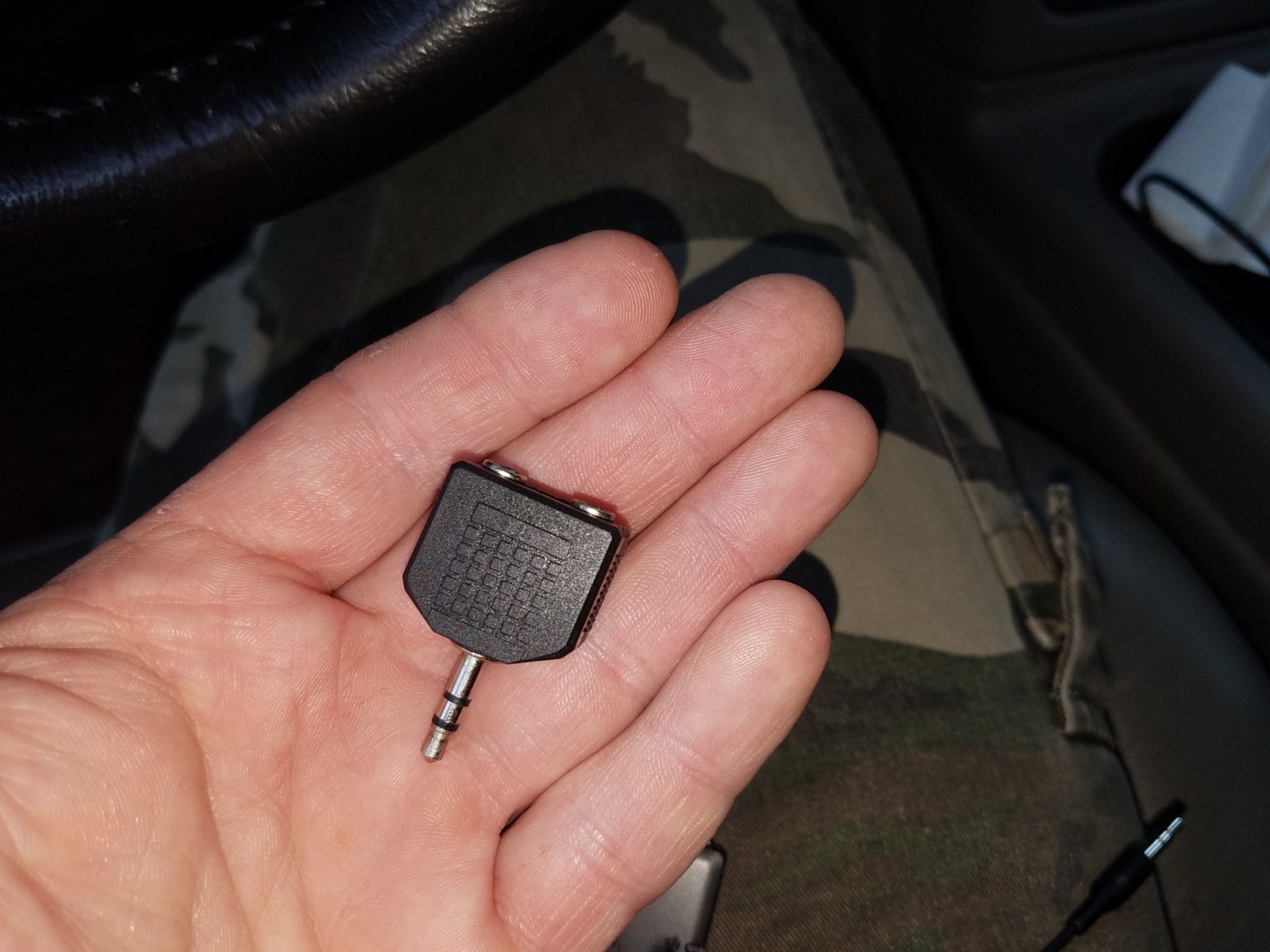

I got some ground loop noise, so I added this splitter. Fixed.

The one i used disconnects the "through" signal (xm) when you plug in. Yours will tap into the xm line, so you will need to tune to channel 0 for use. On the up side, you won't need to unplug like i do.
Oh i can do this and keep my xm?would be nice to have bluetooth... I always assumed this would remove xm functionality.
Yes you can. Just not at the same time.
I still done understand the plug in part and the thru part haha
You're sharing the line to the HU between xm x and aux. The switching jack only lets the HU see one at time. With yours, the Huh would see both all the time, so channel 0 is blank if you're using the aux.
