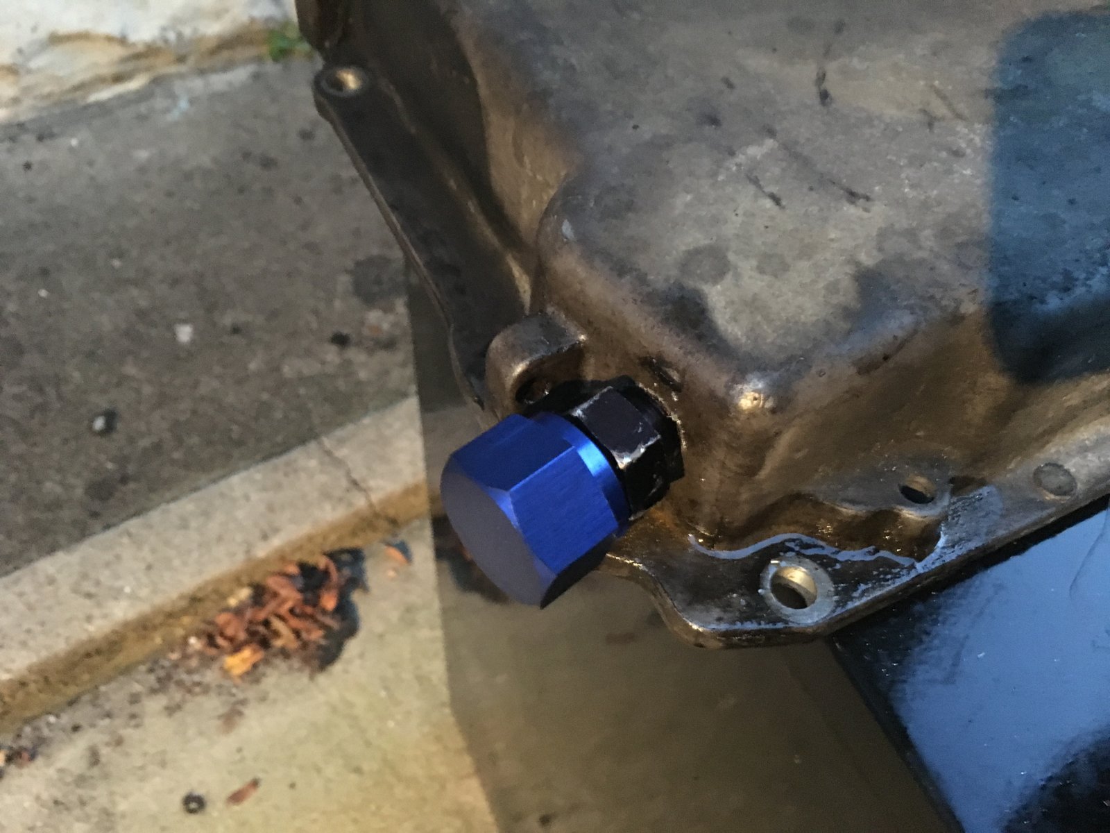

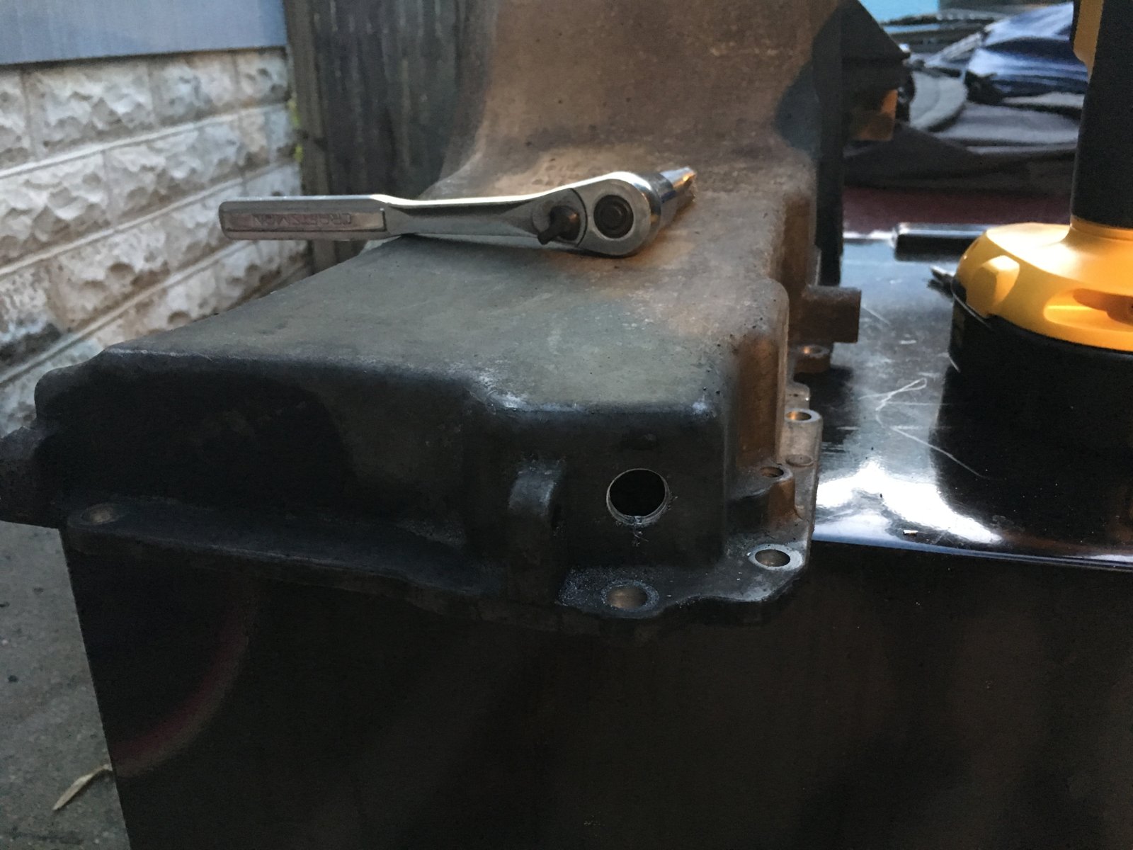

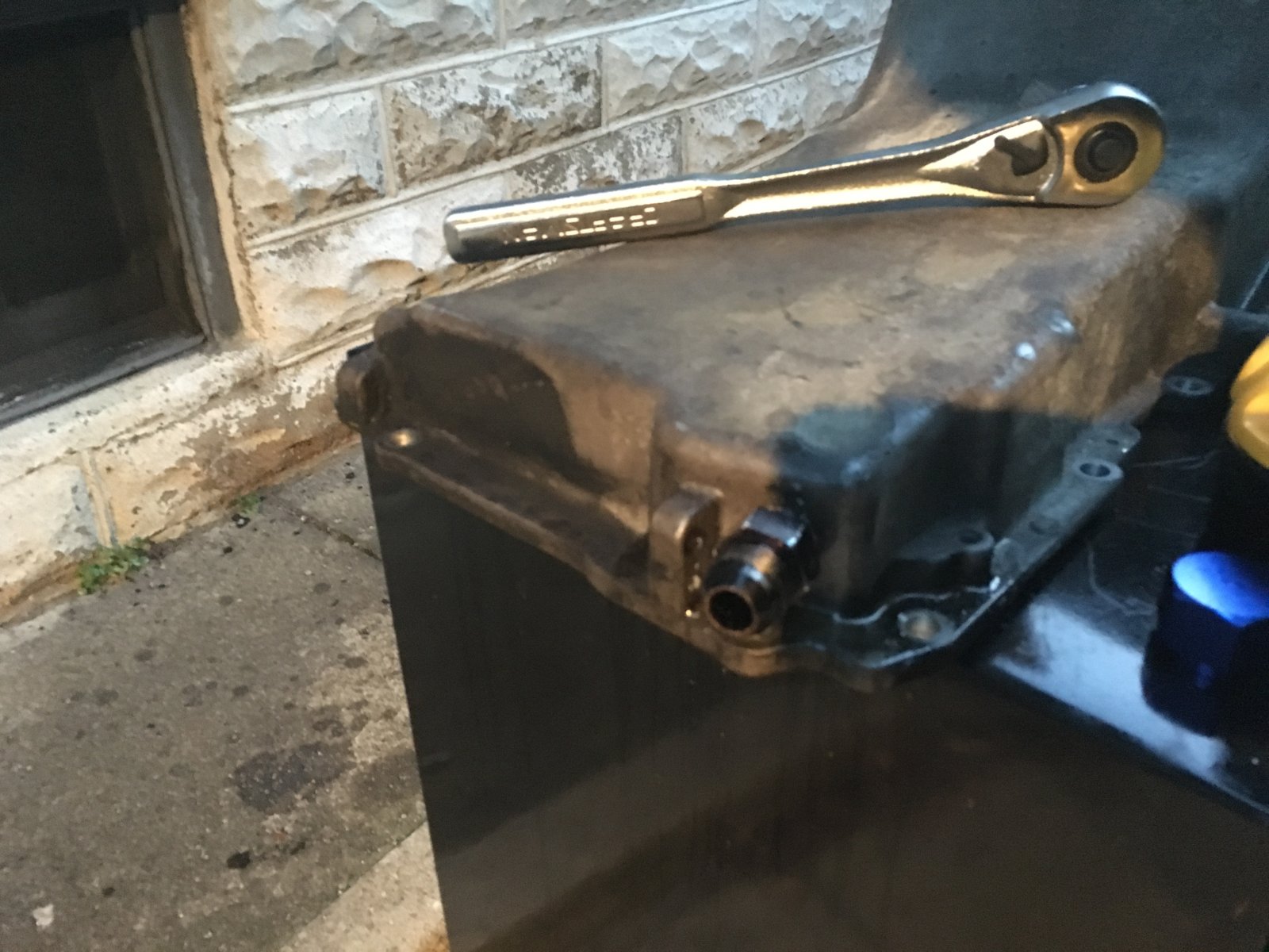

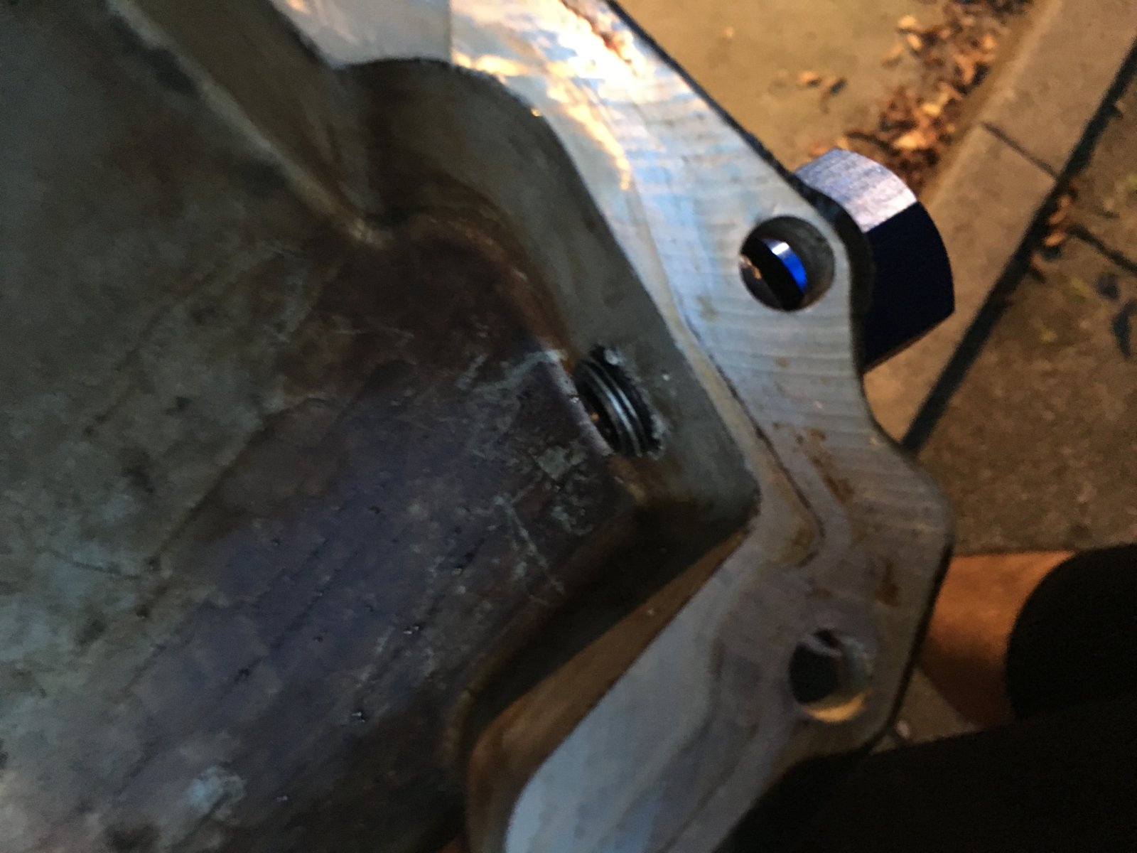

I’m a very long process of adding a turbo. The turbo needs an oil feed and a return line. That’s where it will return to the motor.
52,949
Why don't you just do it at the oil cooler lines on the driver side of the pan? If you don't have an oil cooler then there's a block-off plate there, so you could just get the parts from a rig that does have a oil cooler.

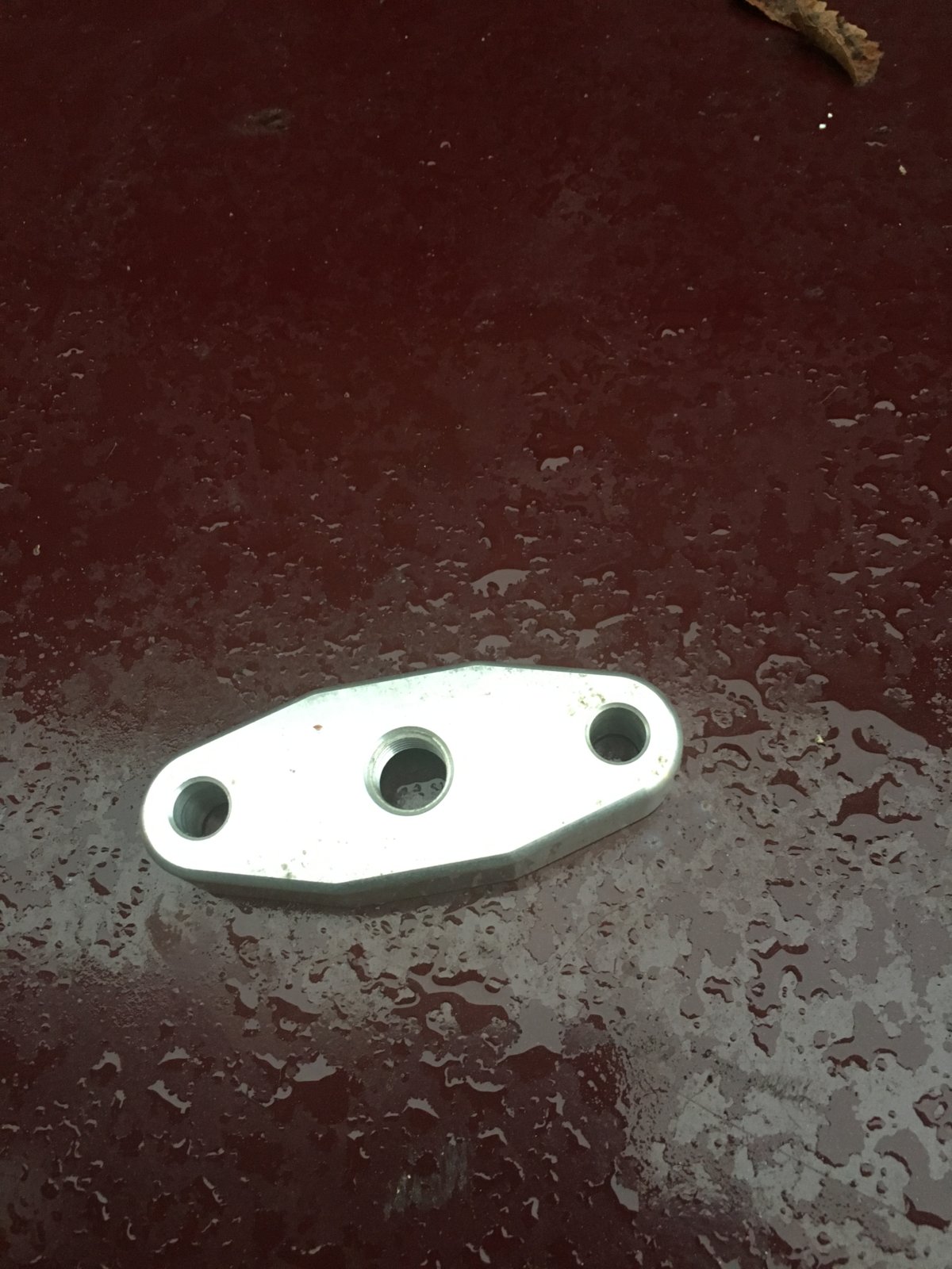

I don’t have the cooler on mine. But that’s pressurized and that’s going to be the oil feed to the turbo
thats the adapter that goes on the drivers side for the feed
52,949
I don’t have the cooler on mine. But that’s pressurized and that’s going to be the oil feed to the turboView attachment 185720thats the adapter that goes on the drivers side for the feed
It has a return also, thus the 2 holes on mine...the oil cooler has a feed and a return , just like the trans cooler. The turbo needs a feed and a return, right? Seems simple to me.

Gravity does the job of draining the oil from the turbo so it needs as much of a straight line as possible back to the motor. The turbo mounts on the front pass side of the motor. The feed is located towards the rear on the drivers side

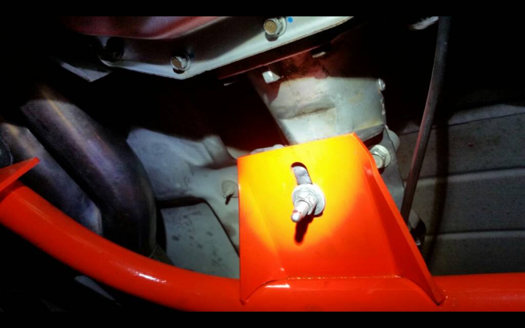

Did you make your crossmember?
What did you do for your exhaust? I am hoping to use my factory exhaust with minimal changes.

I will be piecing it together also.
I used a custom crossmember made by dirttrackracer..he's a member on Pt.net. it's a quality piece. I painted it chevy red/orange since it's unfinished metal and didn't want it to rust. I run longtube dynatech headers and their ypipe and the crossmember frees up a lot of space. I could run factory exhaust no problem..

I used a custom crossmember made by dirttrackracer..he's a member on Pt.net. it's a quality piece. I painted it check red/orange since it's unfinished metal and didn't want it to rust. I run long dynatech headers and their ypipe and the crossmember frees up a lot of space. I could run factory exhaust no problem..

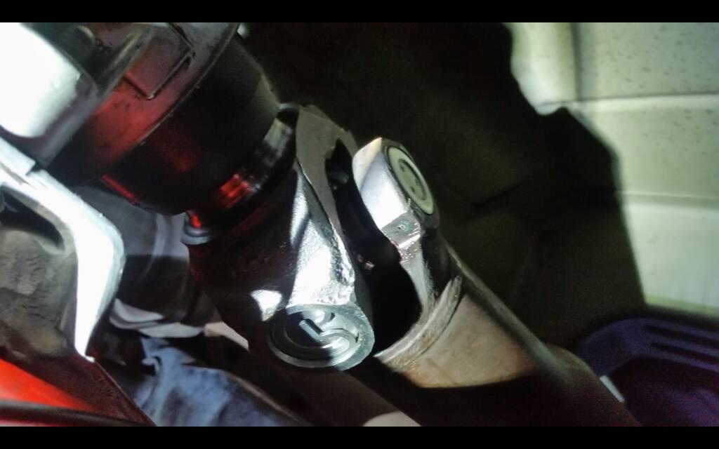

I'm 2wd so all I had to do was swap the front yoke on my drive shafts and use a hybrid ujoint.the 4l80 has a much larger output shaft rpthan the 4l60..this is the yoke installed on the ds with the truck on the ground. No vibrations or issues at this time..
