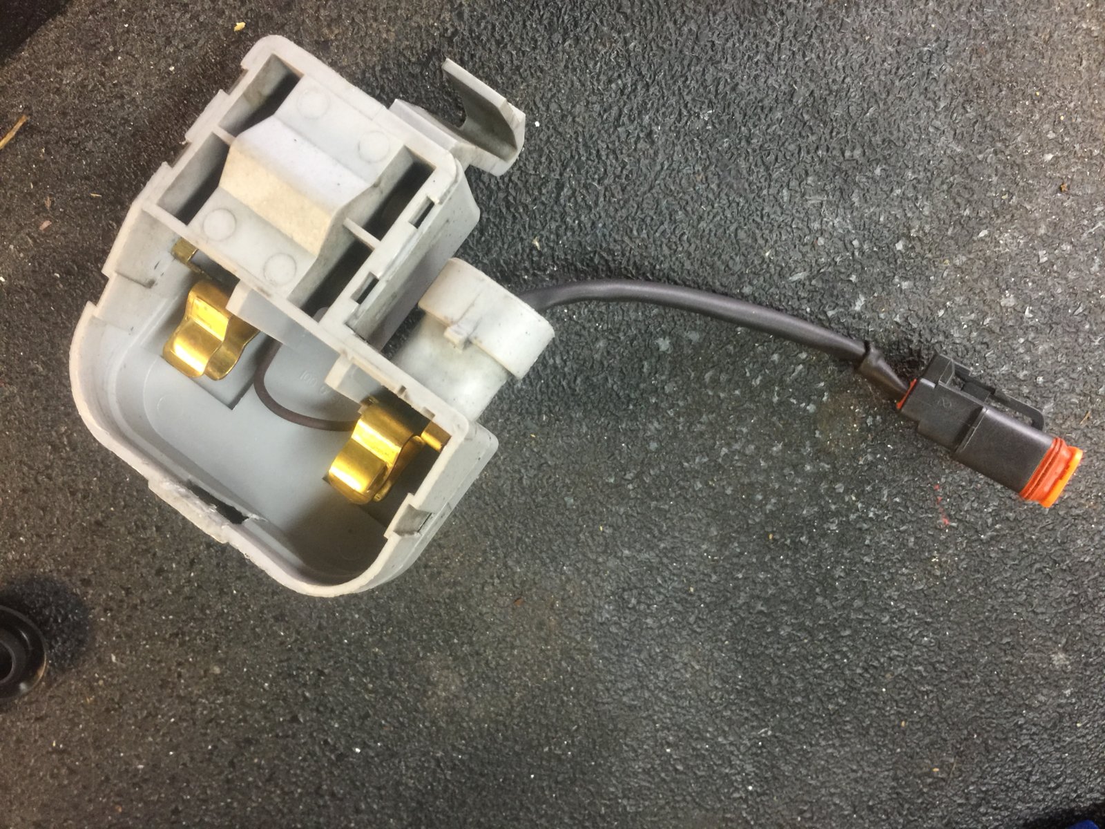

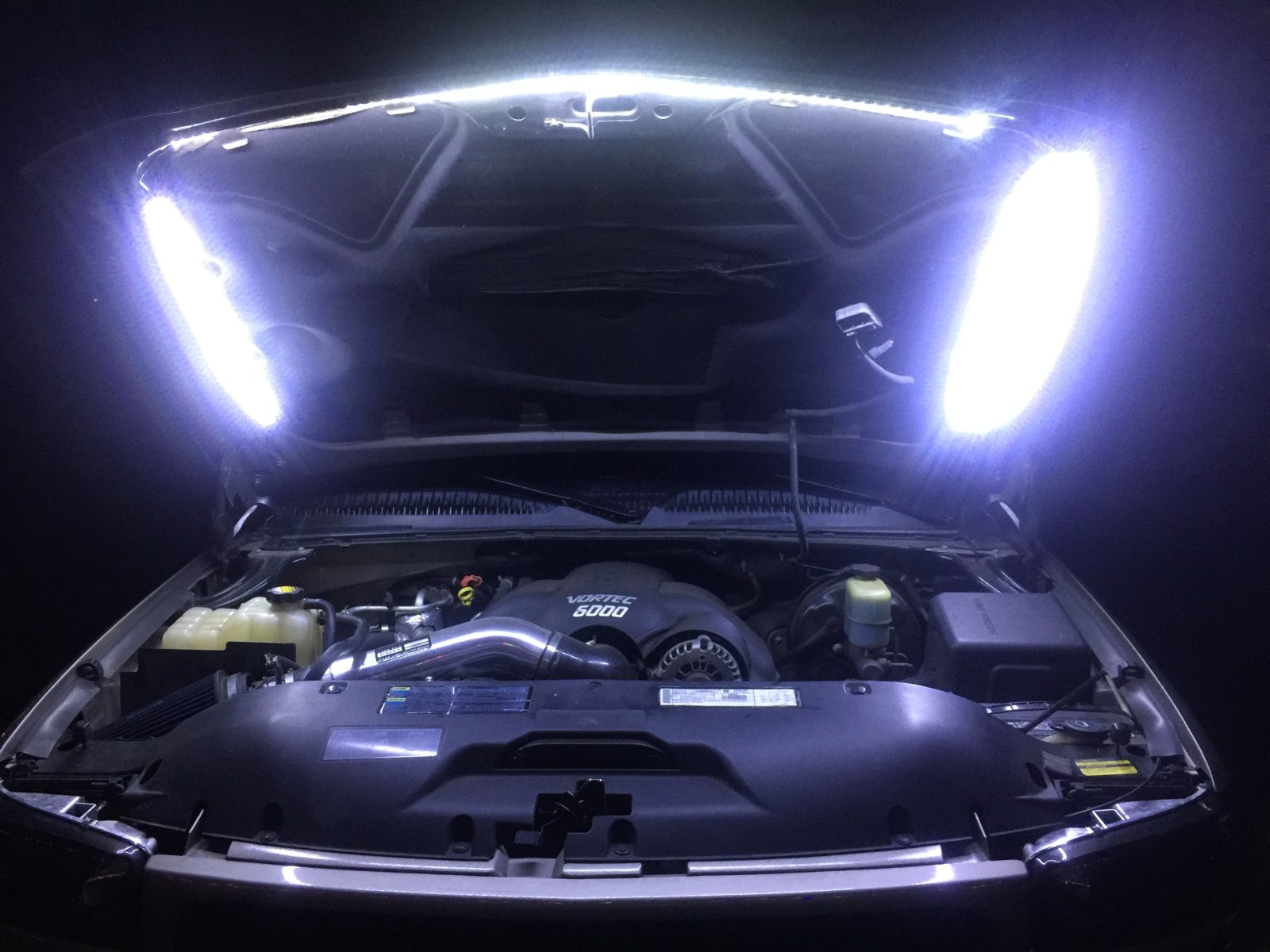

Over the last couple of weeks I’ve washed her down, removed faded door edge guard, new battery, new tray, washer pump and lines, leds inside, reverse pods, led tails.
Began wiring in come led cobs under the hood but they don’t turn off when I close the hood, any suggestions?
What are they wired to? I ran mine off my stock underhood light that has a built-in gravity switch. If you don't have one you can add it.
I used a negative cutoff switch. Works perfectly. Hood closed the negative separates from the body. Hood opens the spring pushed the negative against the body allowing the light to ground and turn on.
View attachment 184351 View attachment 184352
Yes I do have the underhood light from the factory and when I connected it to it, the light stayed on but I know see the gravity switch is after where I connected and I’m not sure how to connect to there.
The negative switch may be the way to go. Unless I can figure out how to connect to the factory switch
52,949
Just open up the switch and solder wires to the brass contacts at each end of the stock bulb. Right where the bulb connects. I thing you need to drill a hole for the wire to exit through.
I'm having the exact same issue, I just disconnected them for now.

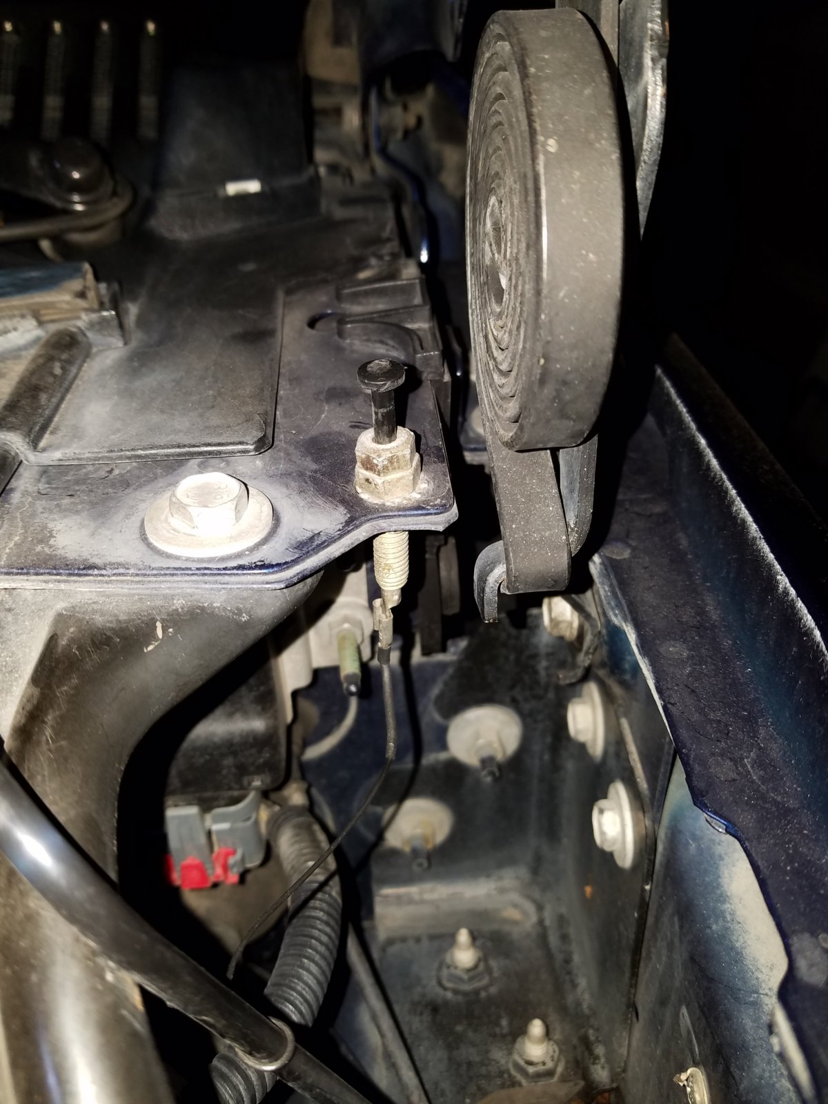

Here's a couple pics of mine. I just soldered to the brass clip things that the bulb snaps into. If you take the back cover off there's easy access on the back side.
Sounds like a plan, appreciate it. I’m doing one cob on the driverside now. And maybe one later on the pass towards the front.

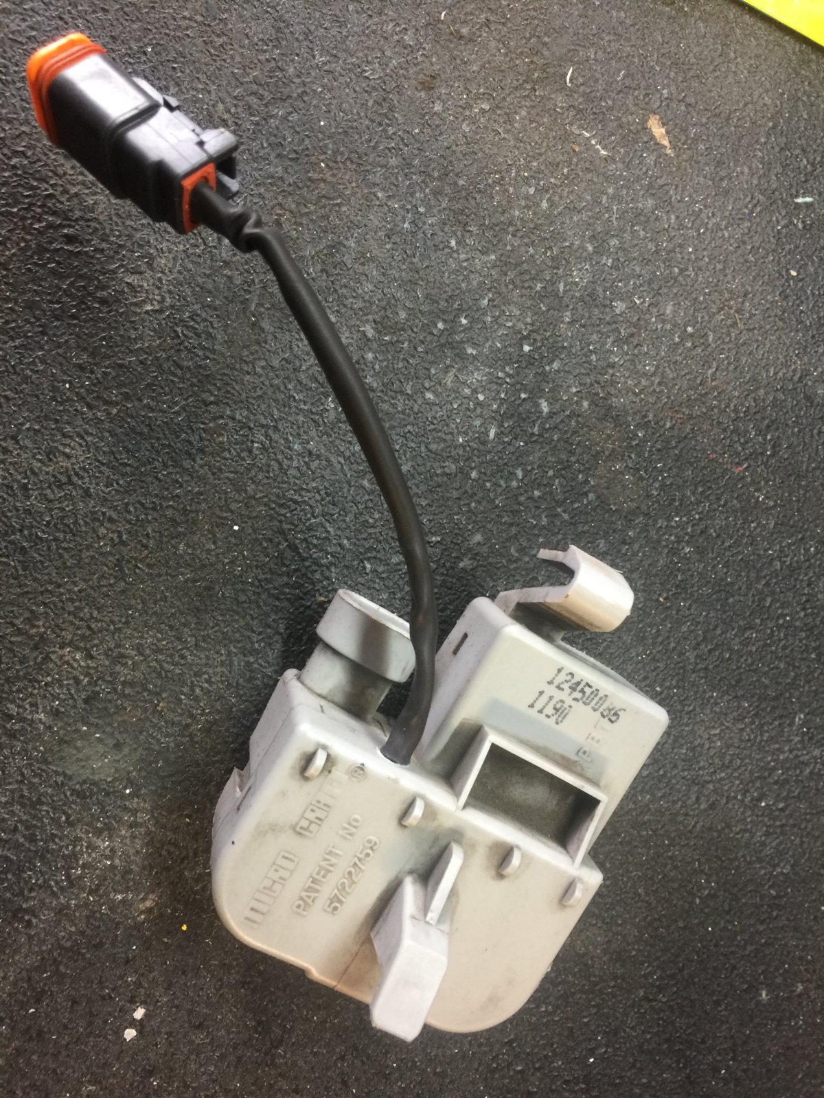

well, seems like I can't win this weekend. replaced Ignition housing and the ignition cylinder. The damn truck never goes into the relearn procedure and the security light blinks nonstop. No 10 minute, 20 minute, or 30 minute window works the light just never stops flashing to even allow me into the first step of the relearn procedure. So, from research online and talking to a few 12volt installers I used to work with, we believe that maybe the BCM is on permanent lock out.
Anyone here ever deal with this? I ordered a BCM should be here Tuesday.
