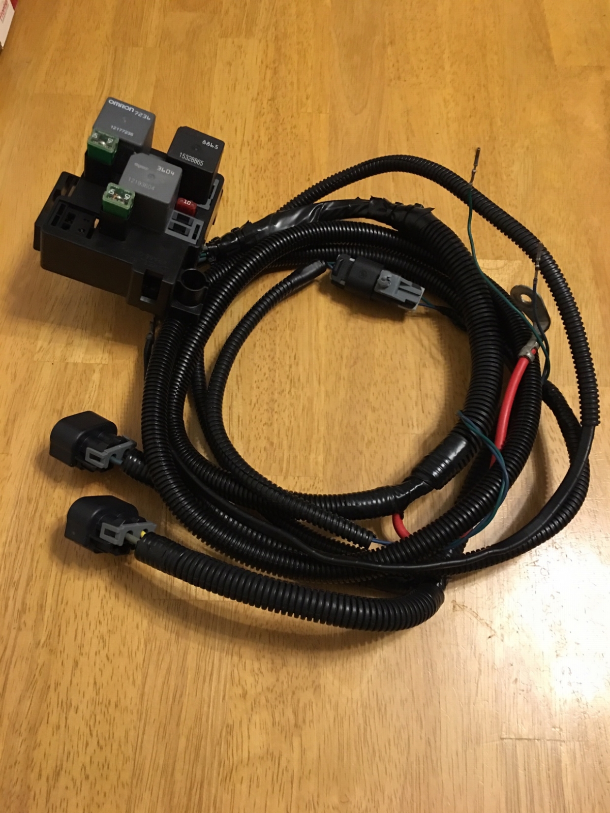

Mine is an LS1fans.com harness, bought it about 1 1/2 years ago. It first burned out 2 relays, then next time melted the relay block itself and the fuse holders too. Left me stranded in 105 degree temps because the engine overheated. I rebuilt it using 80 amp relays, mega fuse holders, bigger wire, etc but I still don't trust it so I ordered an OEM harness from @ScottyBoy. I no longer recommend anybody's aftermarket harness, there seems to be something missing in their design. I have no idea about Nelson's harness but they have a reputation for melting and I haven't heard anything about them fixing the design.

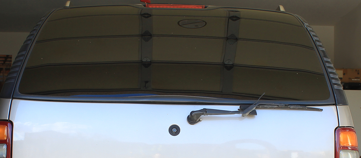

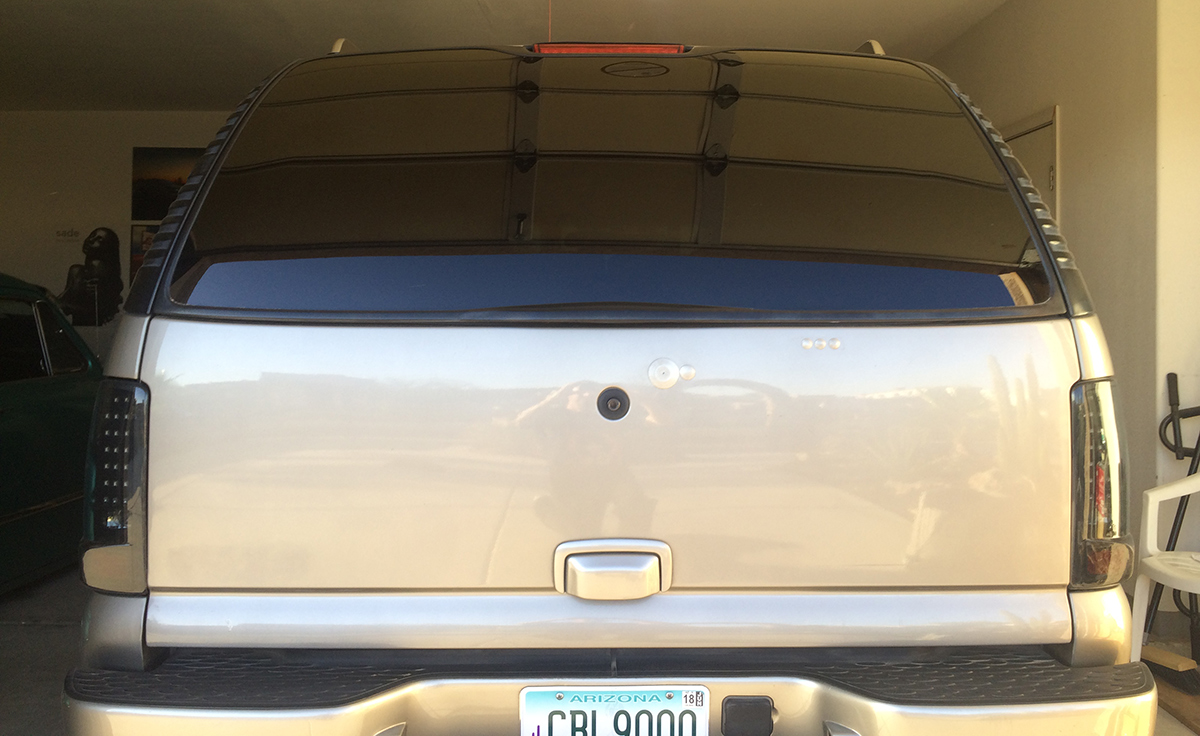

finally got rid of the ugly rear wiper (cheap way using plugs)
before
after

Your best bet is to get an OEM harness, the aftermarket ones have the issues with the relays, the OEM ones mount behind the under hood fuse box away from the heat for the most part the aftermarket ones mount a lot closer to the engine, if the wiring was longer you wouldn't have that issue, I've heard some that say the aftermarket wiring isn't as good as the OEM setup, here's the OEM harness I'll be using after I get the fans turned on in the PCM
Thanks for the input. That was my first choice but most yards around me won't let you pick n pull and eBay was about $30 more. I may just end up reworking the Nelson harness to wire tuck it and keep the relays away from the heat.

Out of curiosity, how long did it take you to pull the parts off?
maybe 30 minutes.
remove rubber boot on outside of arm. pull the arm off. pop the big plastic interior surround off, then the lower half plastic with the strap has a screw in it. (was easier to pull it off once you pop the window release to get the plastic off)
unbolt the wiper motor and black plastic rest for the arm. zip tied the plug and the tube so it doesnt rattle. then button it all back up. done deal
No problem, if the Nelson one doesn't work there's a member on here that sells the OEM ones that's where I got mine from
My understanding is that the heat problems on these is a matter of current overdraw, or underrated components, however you want to think of it. I don't think it's gonna matter how or where you put it. It's a mfging issue.

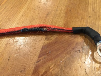

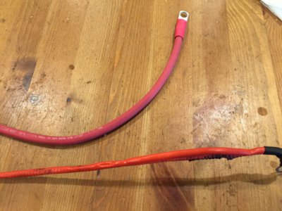

Mine definitely had nothing to do with location, it was either a bad design or undersized wiring and relay block. The first time it blew fuses and the fuse holders almost melted as well as the wire leading to them, and they were right next to the battery, nowhere near any heat. I replaced the fuses and holders and ran larger gauge wire to them. Next time the relays melted the relay block that they were mounted in, and that also was away from any heat source. It was obviously from drawing more current than the harness was designed for. Here's the original feed wire. I ran 2 larger gauge wires to 2 50-amp MegaFuse holders and used 80 amp relays and blocks.
