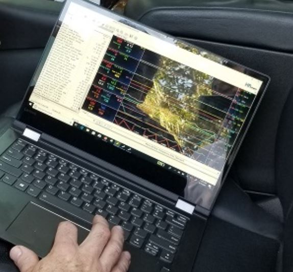

Today's Escalade update. Tune done and completed early this afternoon. I was able to get the work done and completed on short notice. What a difference! The crew cab is on the "to do" list on my next trip back home.

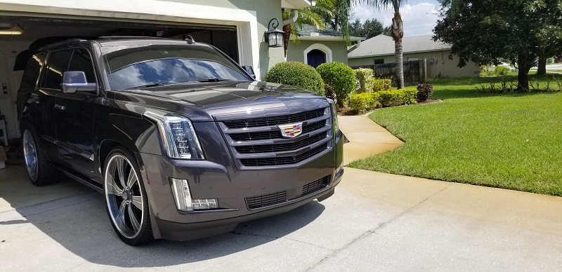

Last weekend here. Headed back out to Louisiana this week. Made good progress overall. Very productive weekend. My buddy and I worked on cosmetics for a good part of the day today.
I was able to put a small dent on the list of mods for the Escalade but ran out of time to work on the rest of the toys.

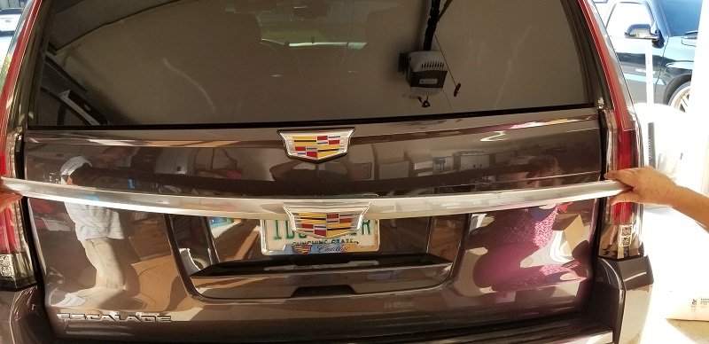

Not yesterday or today but I see I forgot to post the pic of the rear badge trim. That was part of Sunday's effort as well. Had to take the lower half of the rear panel off then loosen the upper half. Once complete, 8 fasteners 2 clips to swap out the rear badge and replace.
Had the badge assembly completely taken apart in order to prep and paint.
Reassembled then installed. Pics attached.

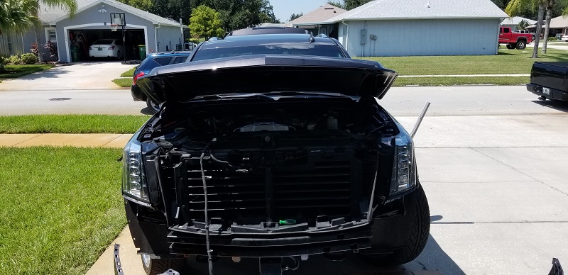

View attachment 230227 View attachment 230229 View attachment 230230 View attachment 230231 View attachment 230232

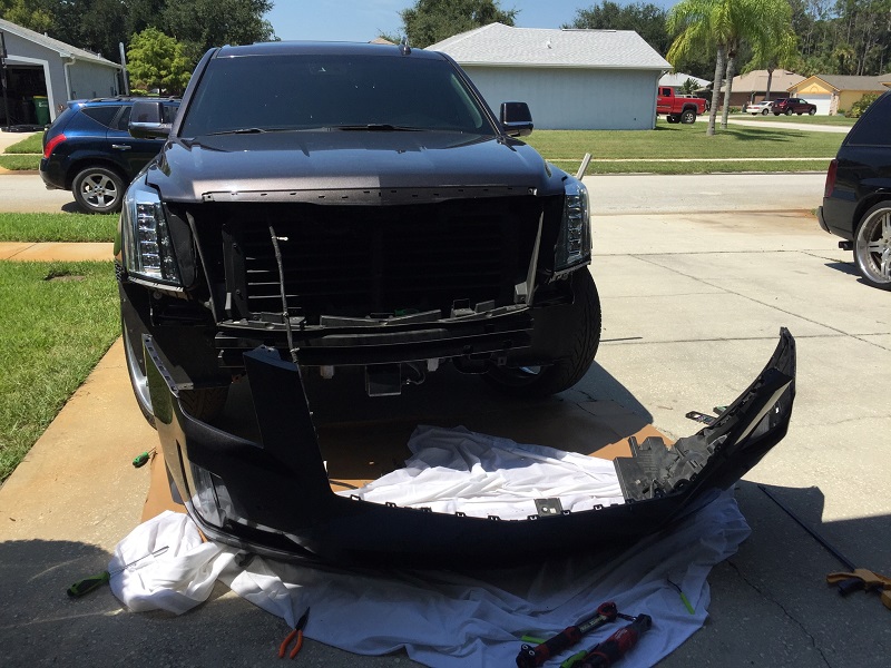

Hey staggered, that looks great! I how did you prep the pieces for paint? I only asked because I was told the the pieces couldn’t be wet sanded or buffed for prep because the chrome pieces are to small and would burn through. [emoji2369]
Staggered 02
Jul 5, 2019
672
1,556
Hi Alex. No sir, not that thin. The grille and moldings are hard plastic with an aluminized finish. All parts were sanded prepared, surfaces cleaned then sprayed with an etchant promoter, primered, painted, then cleared.

Hello staggered, did you have to remove the bumper to remove the grill? Also is there a link or video that shows how to remove the grill?
Staggered 02
Jul 5, 2019
672
1,556
Hi Alex,
Yes sir, the entire bumper has to come off in order to remove and replace the grill. In addition to that the grill a piece behind it that needs to be pulled apart and small aluminum tabs removed in order to take the grill apart. No link or video that I am aware of. My buddy and I did it a week ago Sunday. It is a bit more involved than when I removed and color matched he grill on the 2005 Escalade or the 2002 Silverado for that matter.

Oh boy! That is a lot just to remove a grill. Thanks man I will try to paint it without removing the grill and see how that works out.
Staggered 02
Jul 5, 2019
672
1,556
The upper piece attached to the hood is easy to remove and install. Painting in place is likely to be a challenge as you might end up with tape lines or paint runs. I typically buy replacement parts and get them color matched. This way all I have to do is remove and replace all at the same time. In the case of the grill and the degree of effort, it made the best sense.
Were you thinking about color matching the part of the grill between the Al finished frames as well? Good luck and have fun with the mod effort(s).
