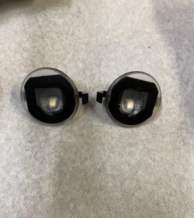

I purchased two front Lloyd’s top of the line ultra front floor mats for $60 new and the 2021+ mirror puddle OEM projector lights for $50 new on OfferUp. In the manual it says they also have the puddle light for GMC and Chevy.
Saturday I am picking up a Range AFM for $60 and OEM front sunshade for $20.
My next mod is the MagicBox that makes my iPhone wireless CarPlay, Miracast, HDMI,, USB drive, Android 11, PlayStore and comes with remote. This plugs into the USB port for the screens in the truck. I can use it on any car with CarPlay or Android Auto.
