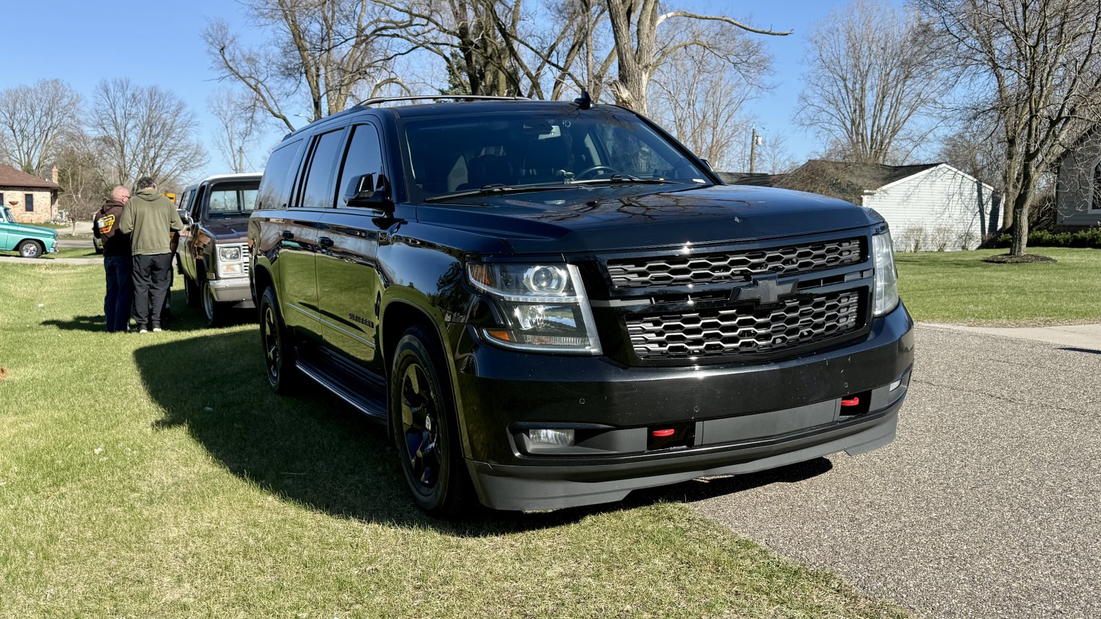

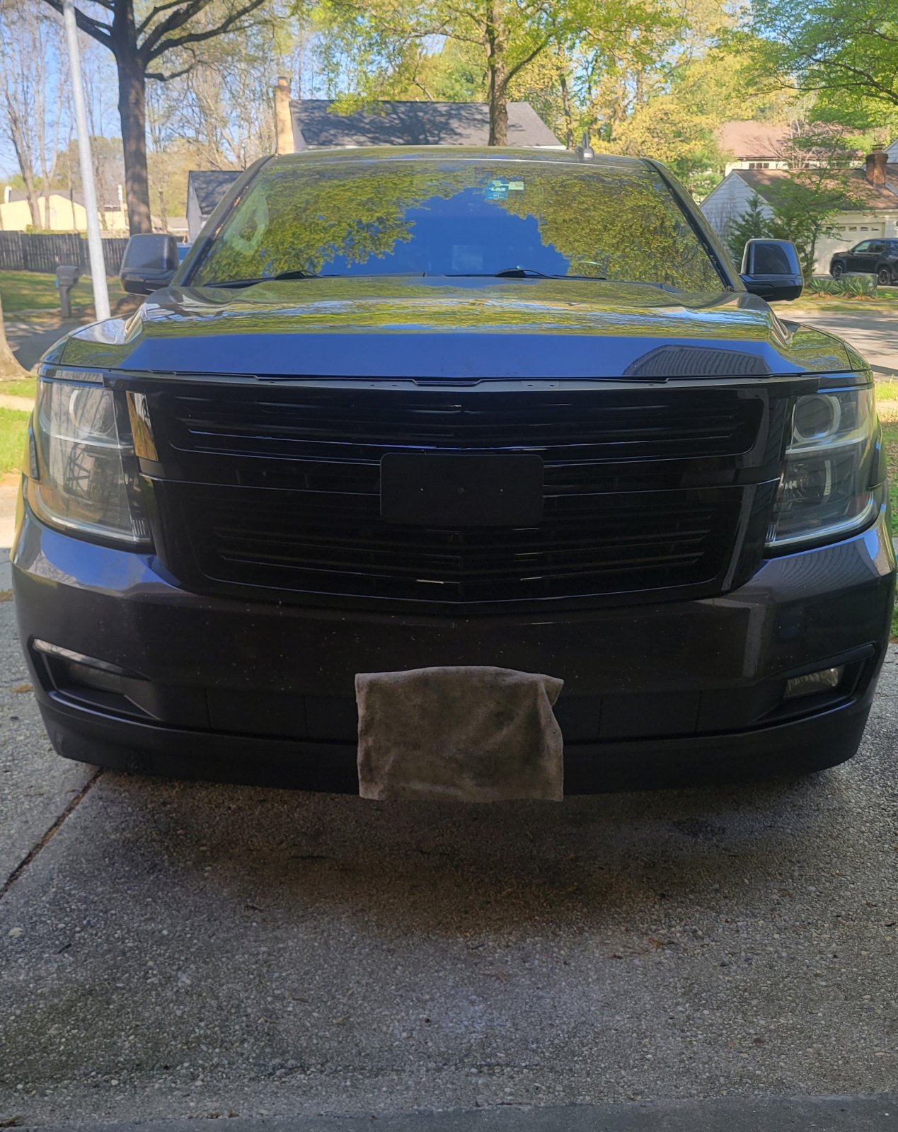

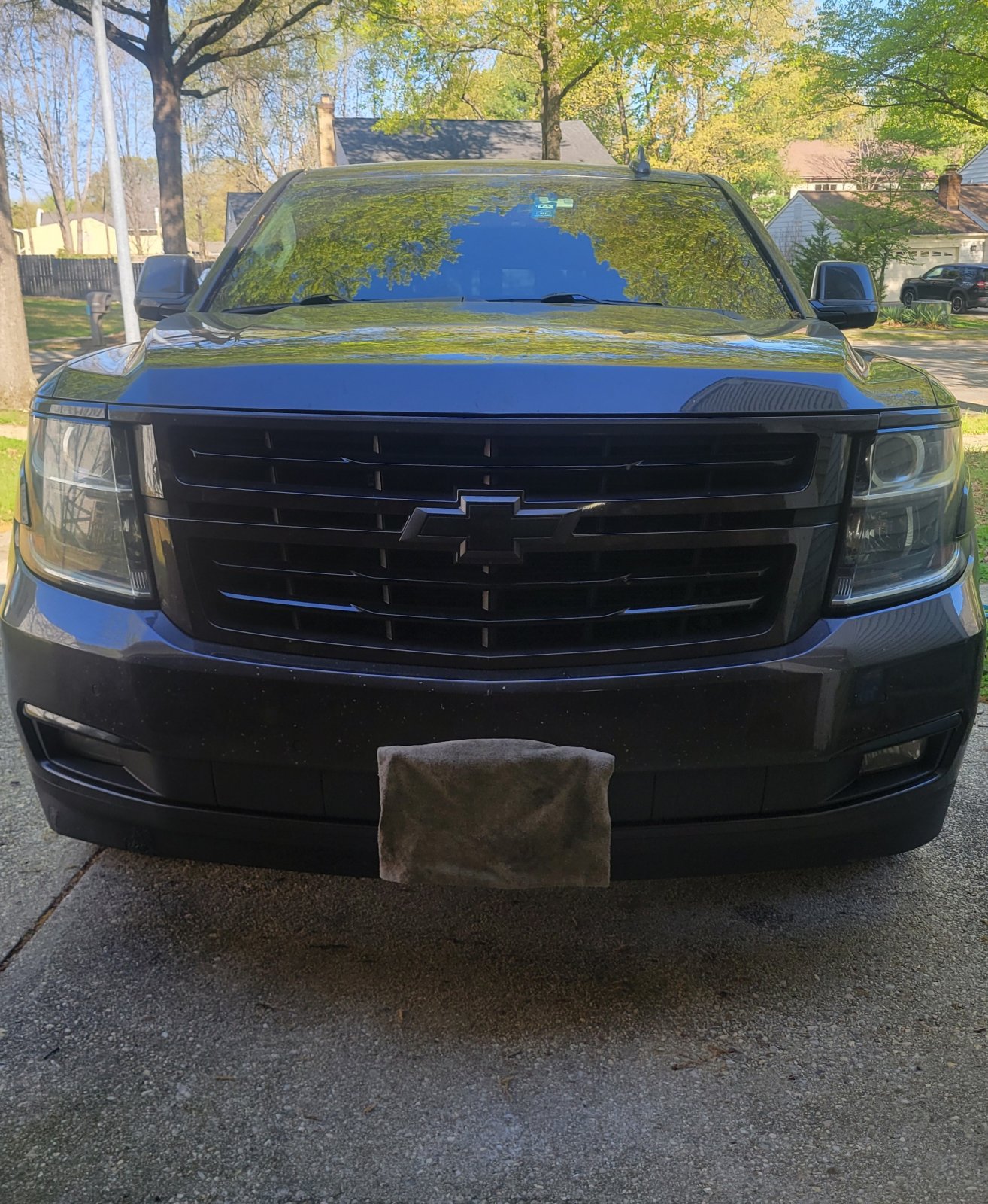

I've been debating doing this too. The one I picked up is black and I was deciding; go painted to match my gray or just send it. But this looks great, I might just send it!
Swapped my grille for honeycomb. I like the oem RST unit but mine is damaged due to bird strike and it needs to be welded professionally. It may go back on it some day but for now I’m liking this new one a lot.

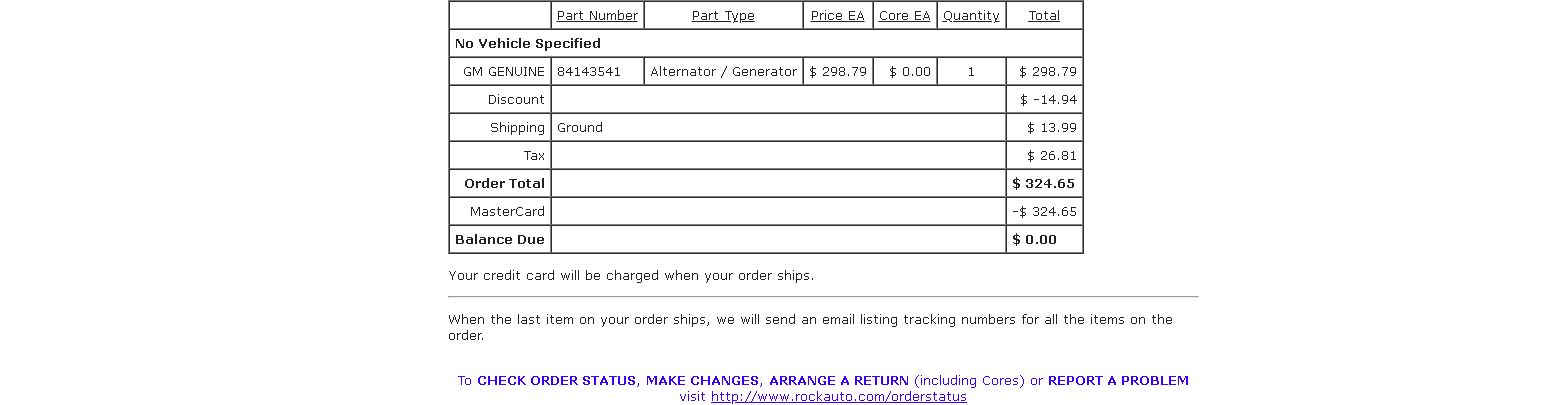

installed a new oem 220amp alternator p/n 84143541
the large case alternators always "look" bigger but they bolt right in the same (the mount is the exact same size)
if you ever go to install a new alternator you may find they are snug and will not just come out nor will the new one just slide on
never pound on it with a hammer, the casing is cast aluminum and it can crack, use a dead blow or a piece of wood as the contact medium
this little pry tool (shaped like a mini haligan tool) is super handy for prying it out and for lining up the bolt holes.

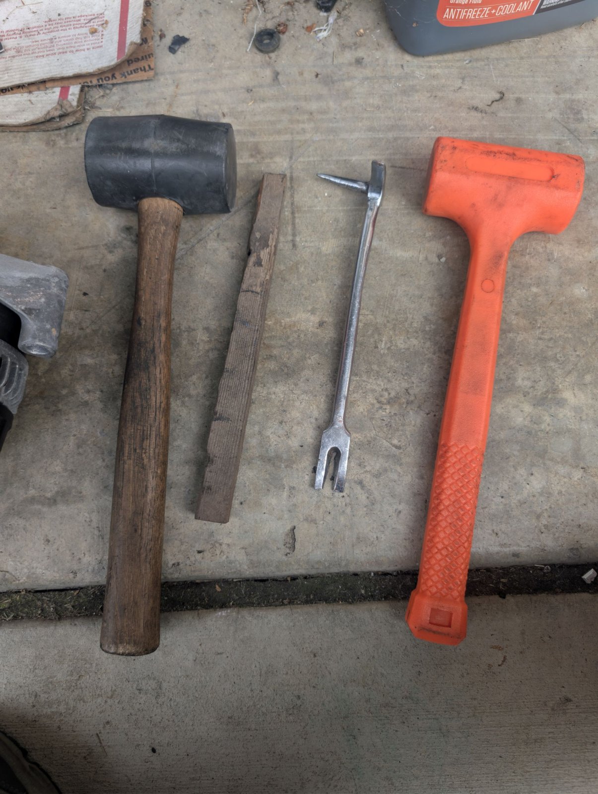

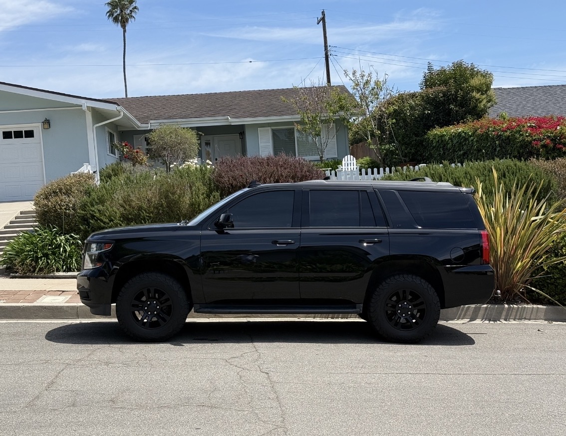

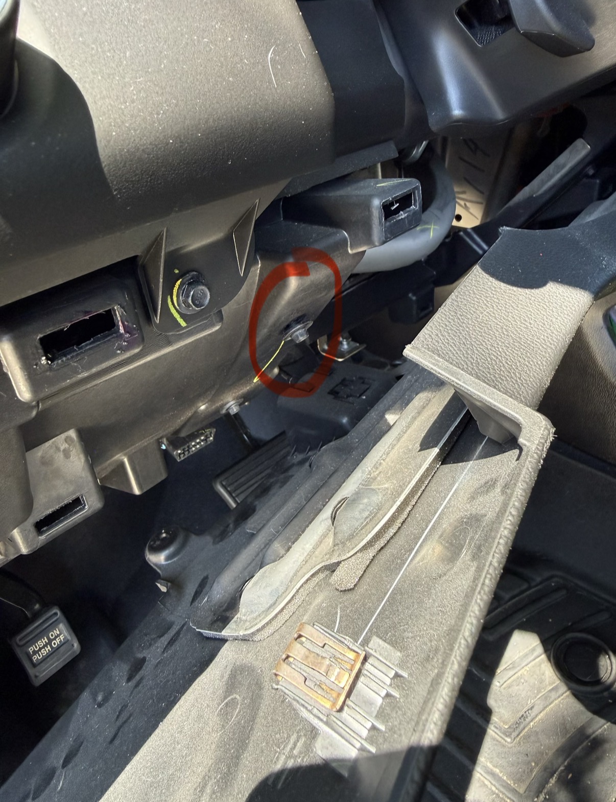

Did some good maintenance this weekend.
Changed motor oil (Driven DI30)
Changed rear diff fluid.
Flipped “the pill” (thermostat) on the new trans.
Changed the main drive belt.
Finally took apart the area under the steering wheel and got rid of a rattle that was driving me insane.. Turned out to be a random bolt that vibrated loose.
And then gave her a good hand wash for good measure.

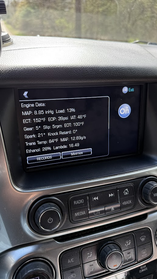

I am truly enjoying the AUTO SYNC G2.
I was able to disable the BOW so now I have LED bulbs in all halogen spots without any hyperflash.
I extended the remote start run time from 15min to 20min seems to be the perfect amount for my needs.
This access to all this vehicle info is quite nice especially if you ever go towing something you can keep tabs on all the key parameters with real data not just a dummy gauge that says temp is normal.

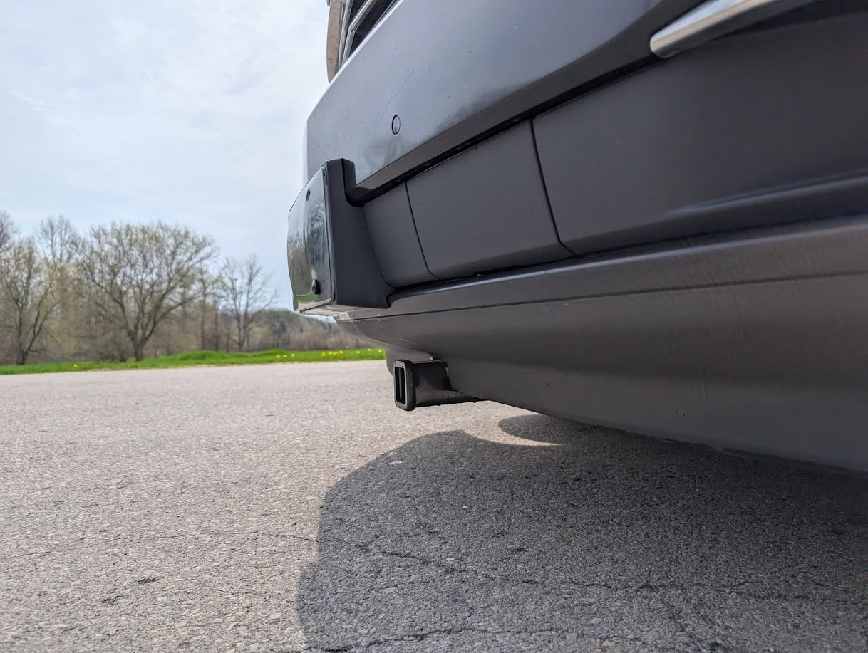

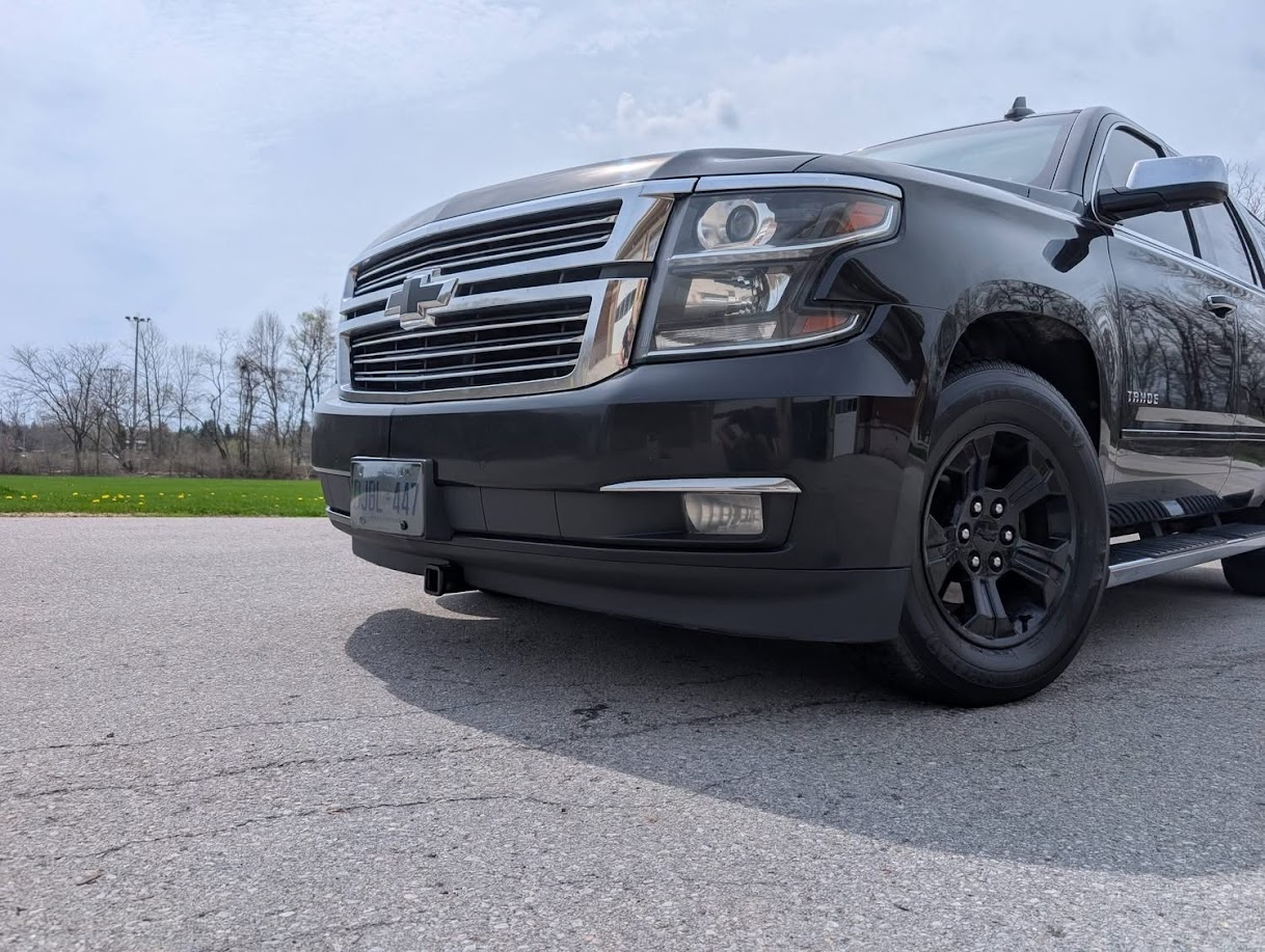

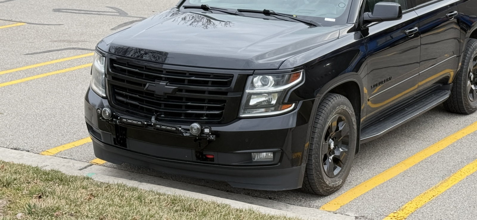

Anyone else rock a front hitch?
Apparently CURT 31073 makes them for our trucks.
I may get one since I wanna be able to install a winch.
30,563
48,043

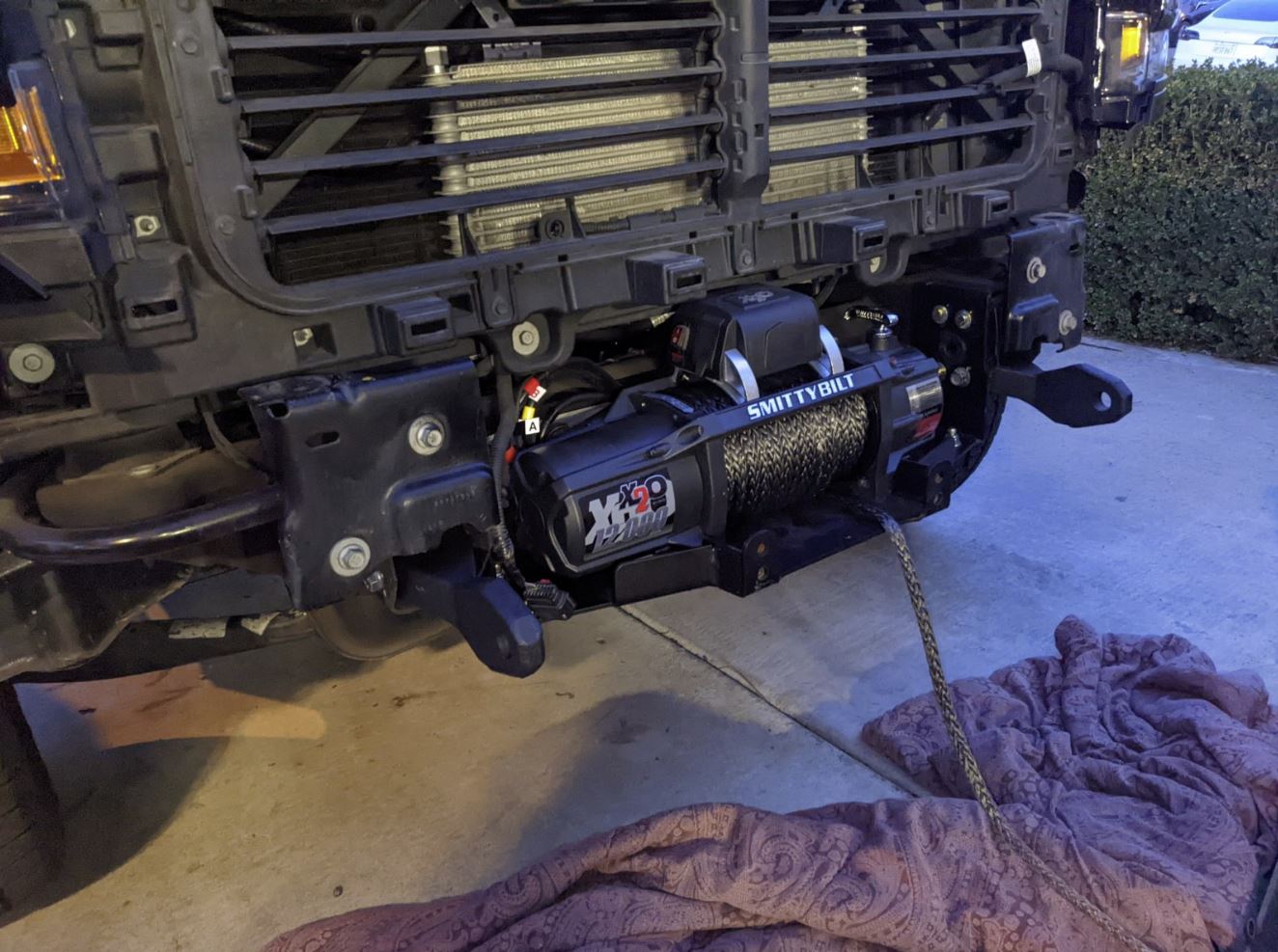

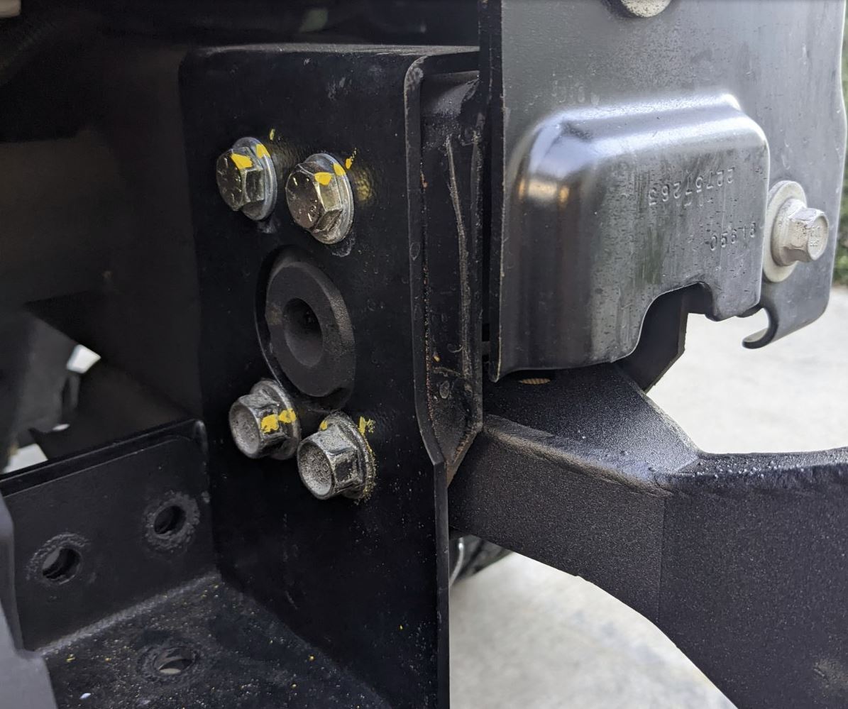

a couple people have installed them and I know at least 1 has modified the rough country hidden mount that they sell like this one I put on the silverado, the frames are not that much different, it would just take a little modification as far as I know

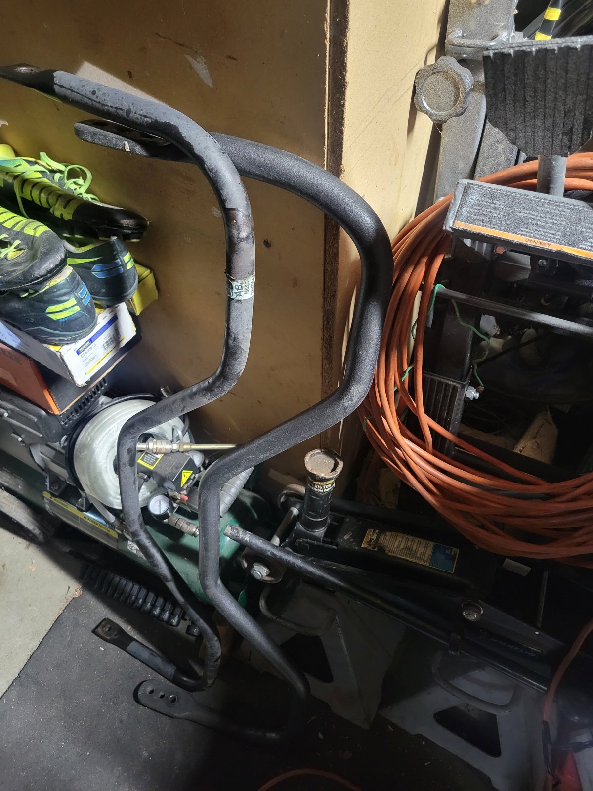

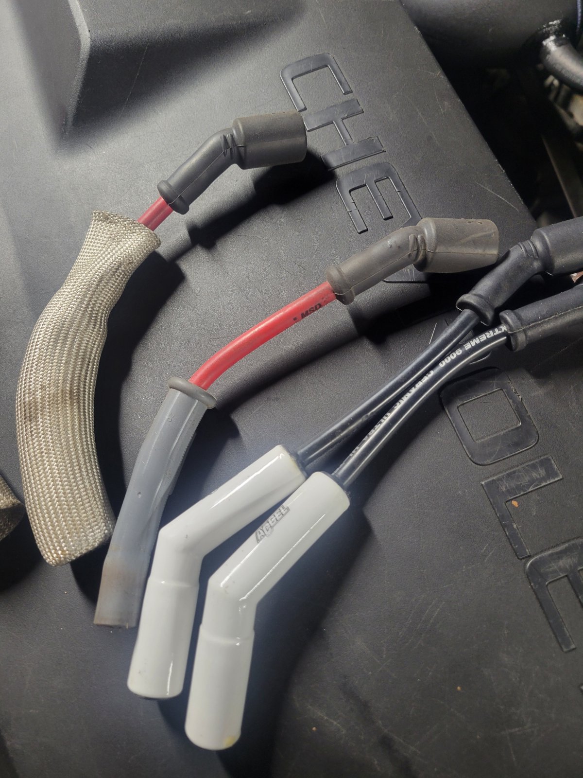

Productive weekend:
Picked up and installed a Hellwig rear sway bar on Saturday
Picked up and installed Accel ceramic booted plug wires on Sunday
Continued to tweak the tune, but it's running pretty strong at 196k miles and counting
