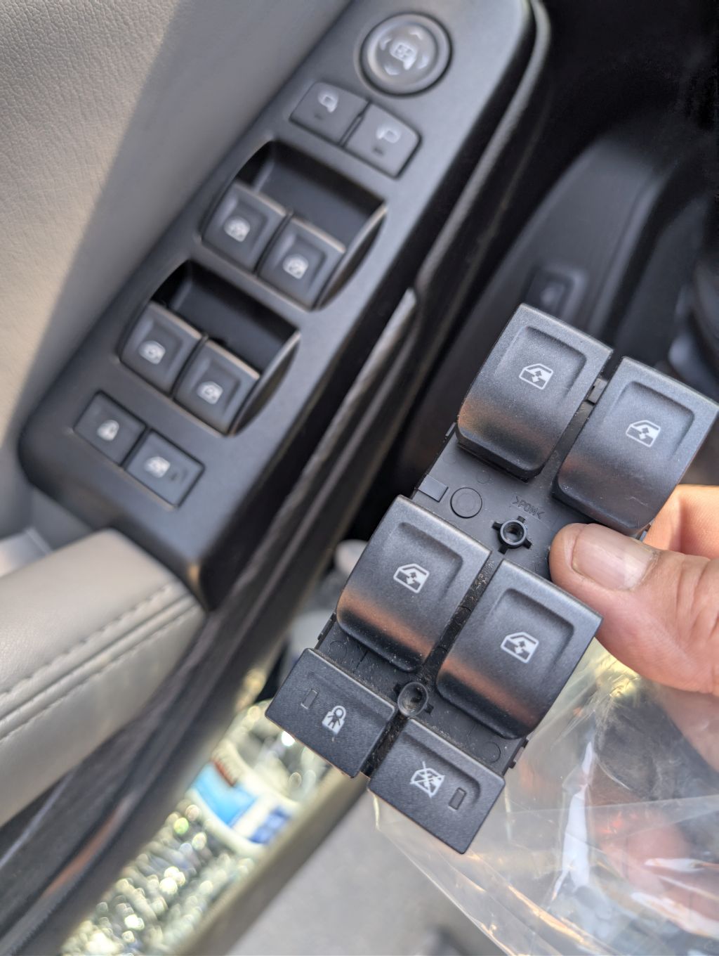

also ordered a new master window switch for the wifes 2016, I have already replaced 2 of the oem one's the same front window buttons keep getting stuck, they work for a while then just stick in place, the k2 quality is not as good as previous gen's. going to try a repop this time, might be here today

no yelling and no spilt coffee, not sure what the issue is the buttons just get stuck either way in the up position or the down position.
took one apart and even tried to see what the heck was going on, tried to smooth any parts that might be catching, put it back together works a couple times and stuck again

Installed the new master switch, pretty easy on these it has clips no bolts or screws to remove
plug n play works like new again

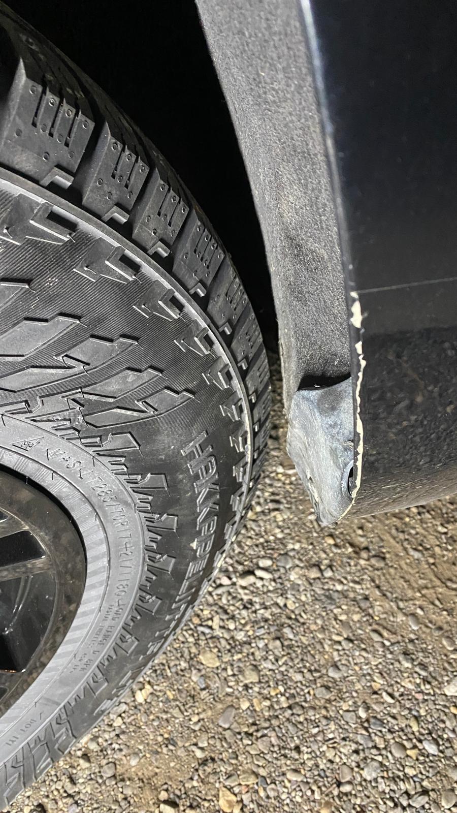

Installed a new winter tire setup, 33" Nokian Hakka LT3 with some replica trd wheels. I had to do the norcal mod since I'm stock height, but now I have about an inch of clearance at the closest point. Overall, I'm stoked with how it turned out

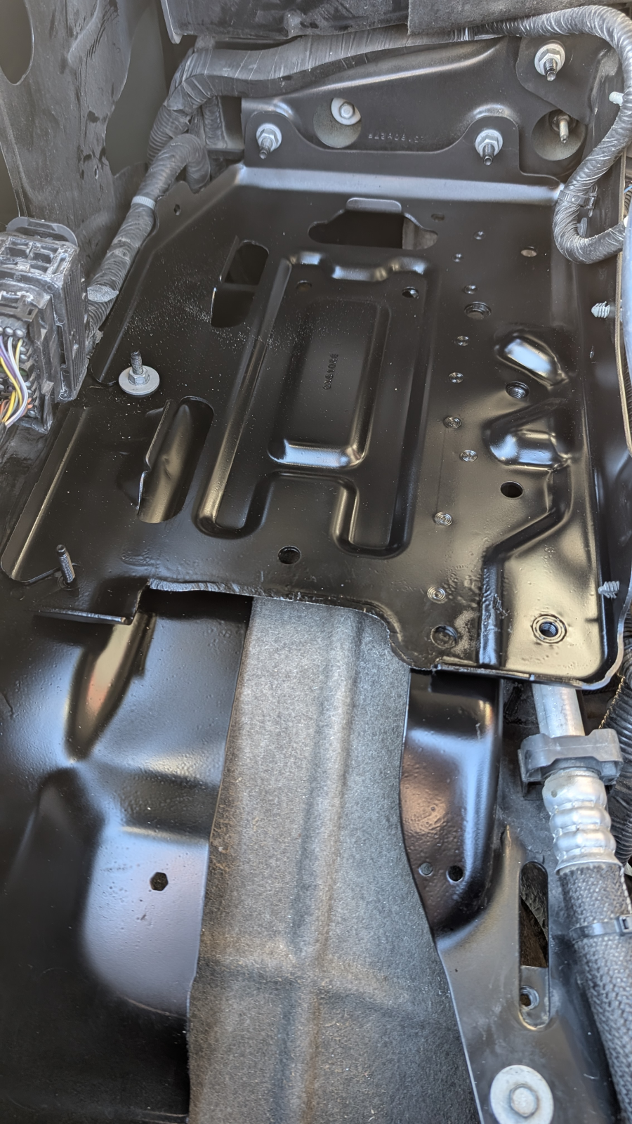

The one I ended up with has a 9/25 sticker on it. I'm going to trim the tray, paint it, then install it all tomorrow.

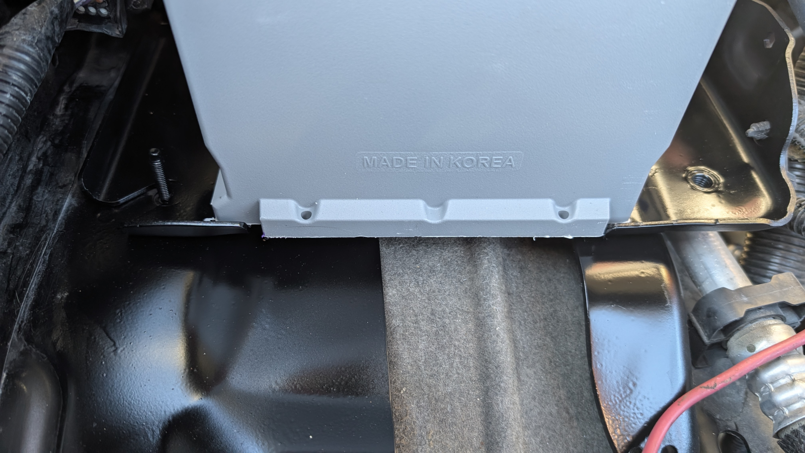

I can say the H8 does not fit. It's the coolant reservoir being so flose. There is nothing I could do short of drilled elognated holes in the tank, and I'd rather not do that. I trimmed the plate and that fits fine, but it's just too long.

I think mine was a 94R/H7? This is in a 2019.

Coolant reservoir isn't even in frame for the first couple pictures, so it was probably moved out of the way in order to get it to fit. The H7 BARELY fits, I just did mine a month ago.

Oh I had everything cleared out, airbox and all:
The H8 fit in the bracket, but that was about it:
No worries though, the H7 fit fine and I was able to relocate the megafuse to a better spot, and top off the coolant:
