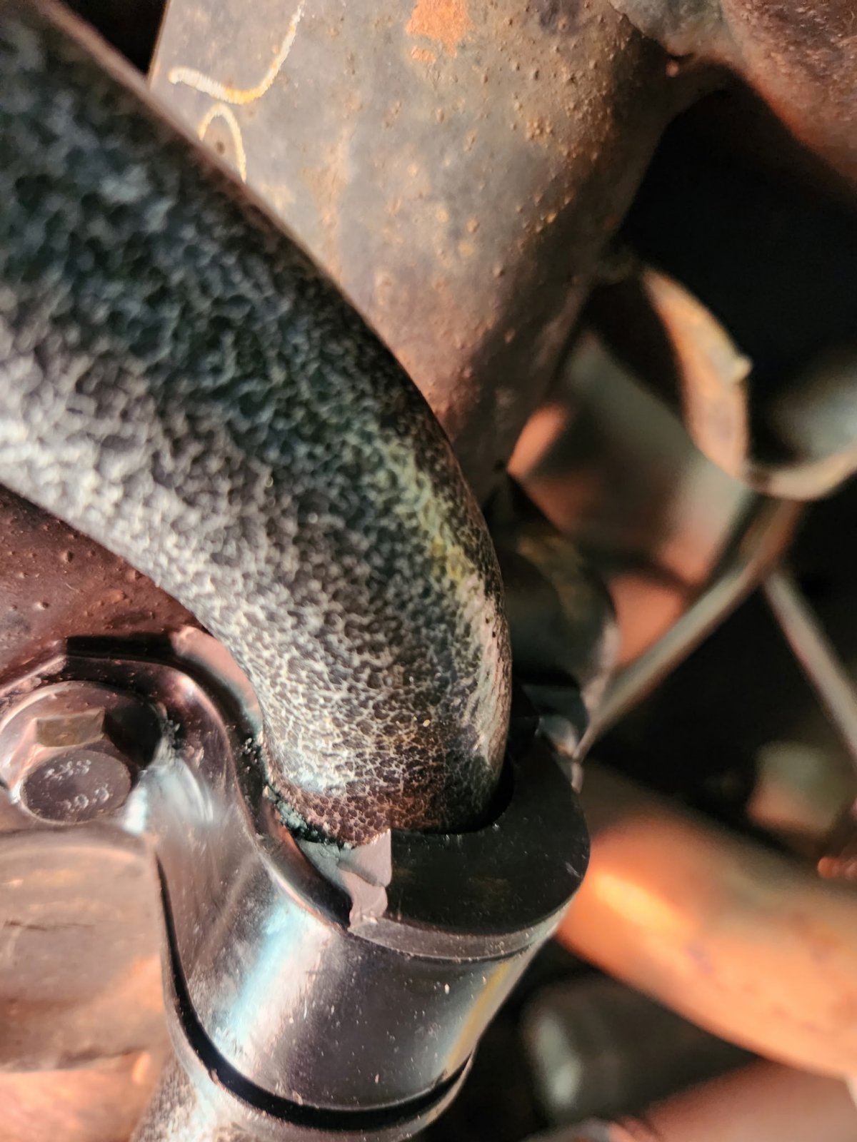

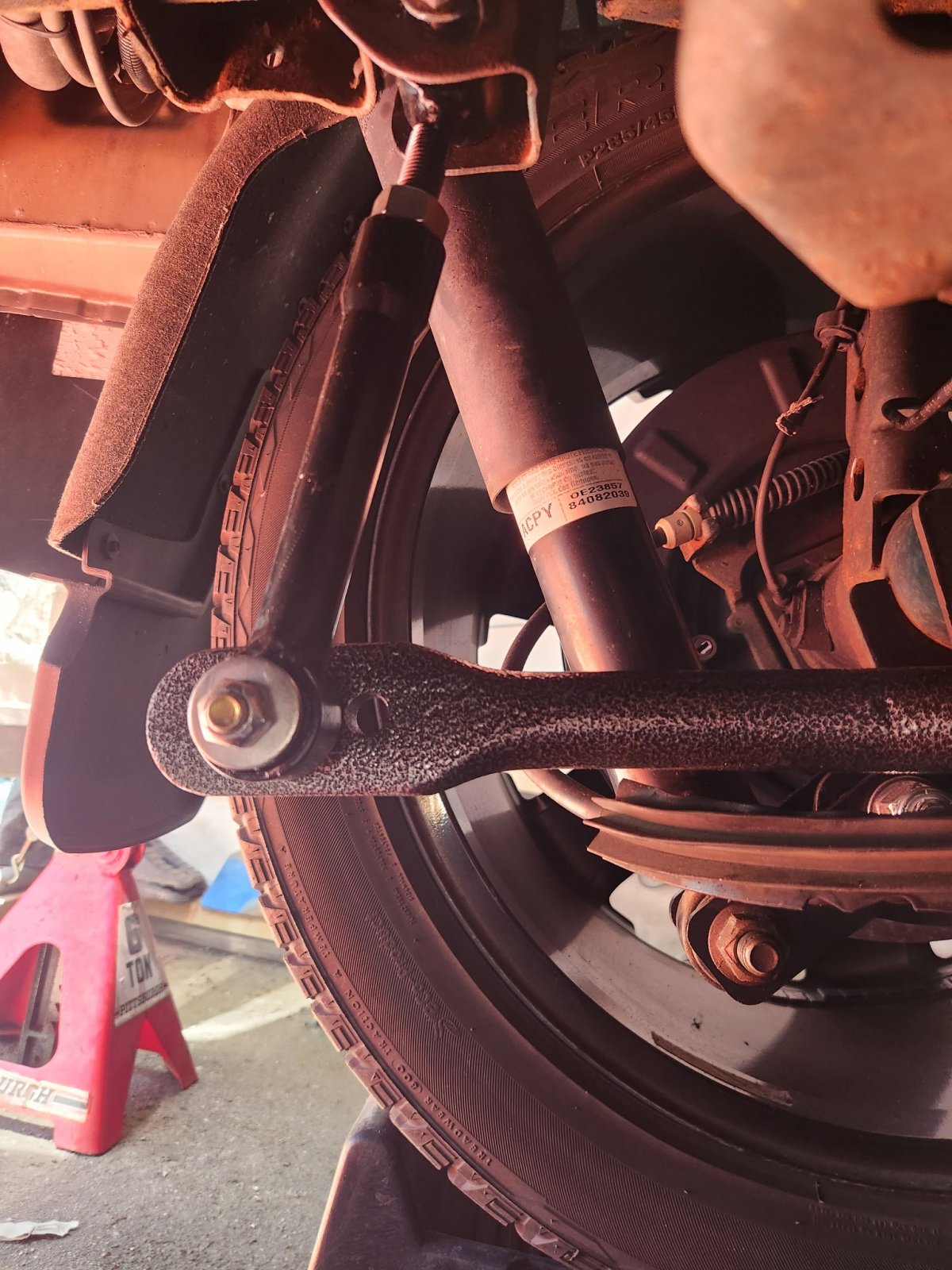

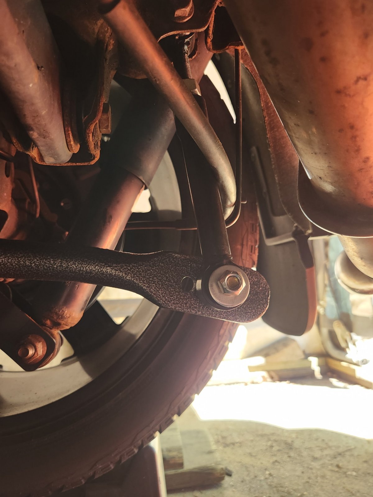

Did I get a defective sway bar ? One side looks bent and both bushings cracked while I was torqueing them down. The one side that looks bent needed endlink 5 extra full rotations to be straight.
What gives ?!
What gives ?!
View attachment 456625View attachment 456626View attachment 456627
call hellwig and tell the lady that answers you have some technical issues, she will transfer over to there main guy and he may have you text or email the pictures. they will get you straightened out. They should still be open till about 5 pacific time they are not far from me.
Ended up emailing them they responded within the hour and offered to send me an entire replacement no fee. So their customer service is top notch guess i gotta do this all over again lol found a leaky shock in the back so time to do those as well , any recommendations for some slightly stiffer shocks in the rear ?( non magnaride and no auto level
