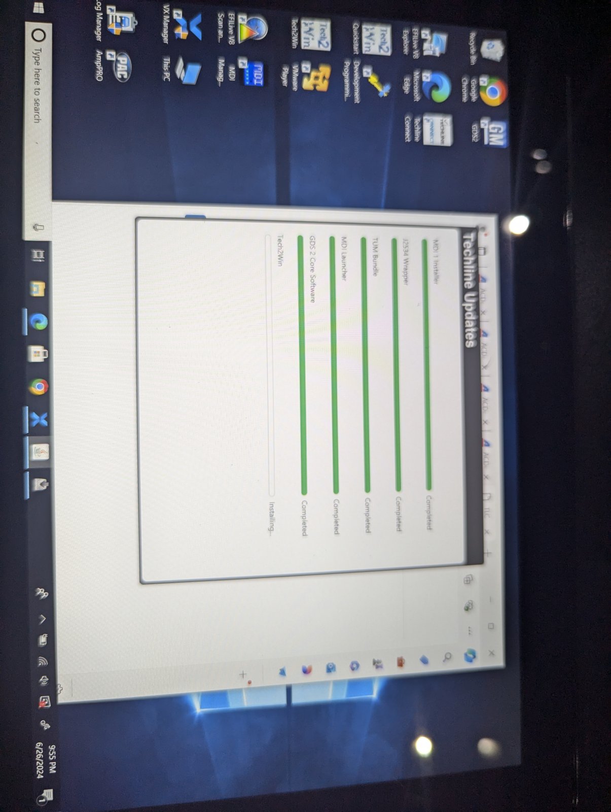

Geez this software is a pita....

discovered that you can't flash a HMI with techline (sps2) that has built in nav to a vehicle that does not have nav, it just writes the HMI as no nav :mad: :mad: :mad: :mad:
in my case I have on star nav only and ya so it didn't work.....
I guess the best you will get is to unlock the vin (not with sps2) with one that came from a same model vehicle or pay these business's hundreds of dollars that write them with custom files
***In my case you need a VCI number from techline to make it work

after a little web crawling I guess I need a VCI number from techline, which enables the functionality of the HMI as intended

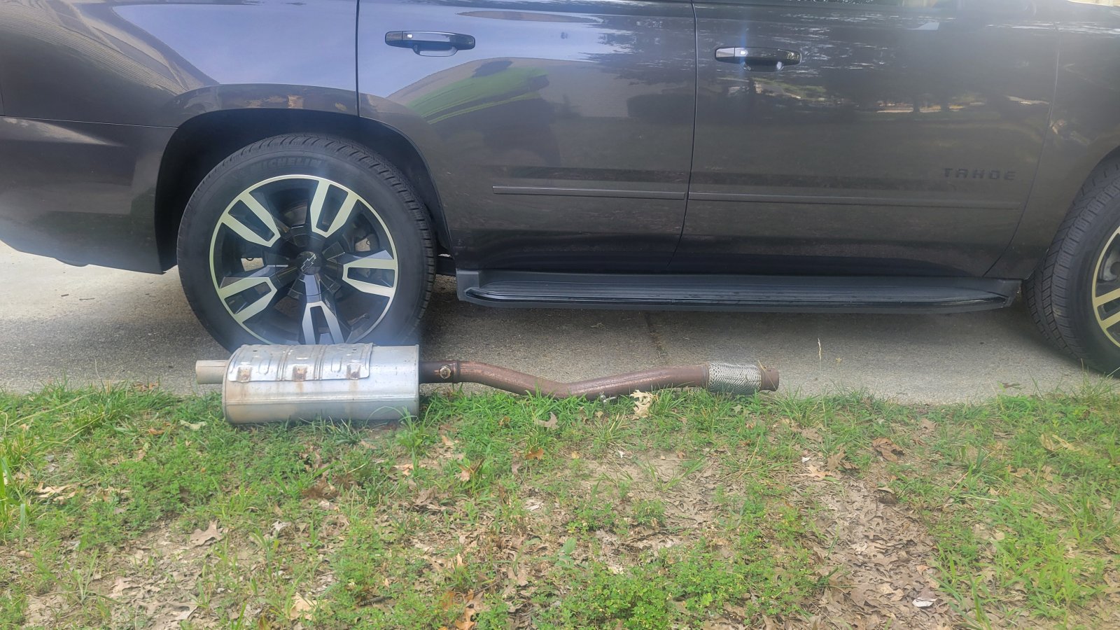

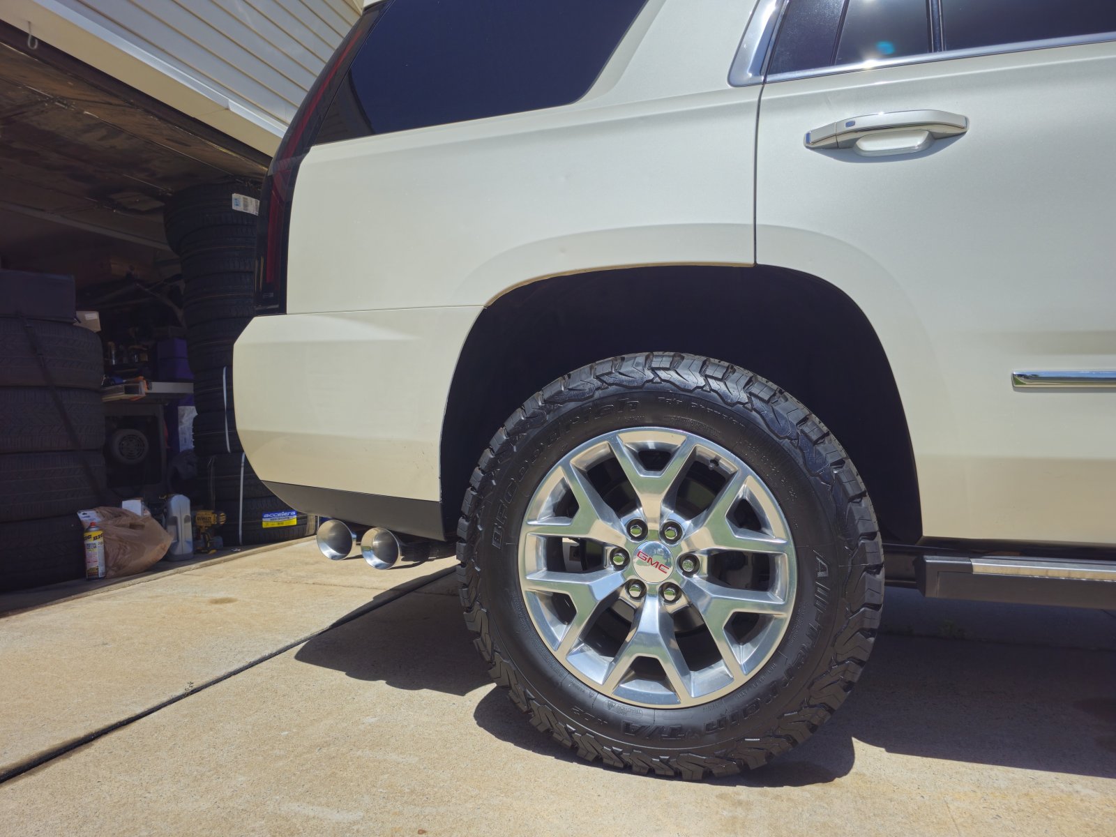

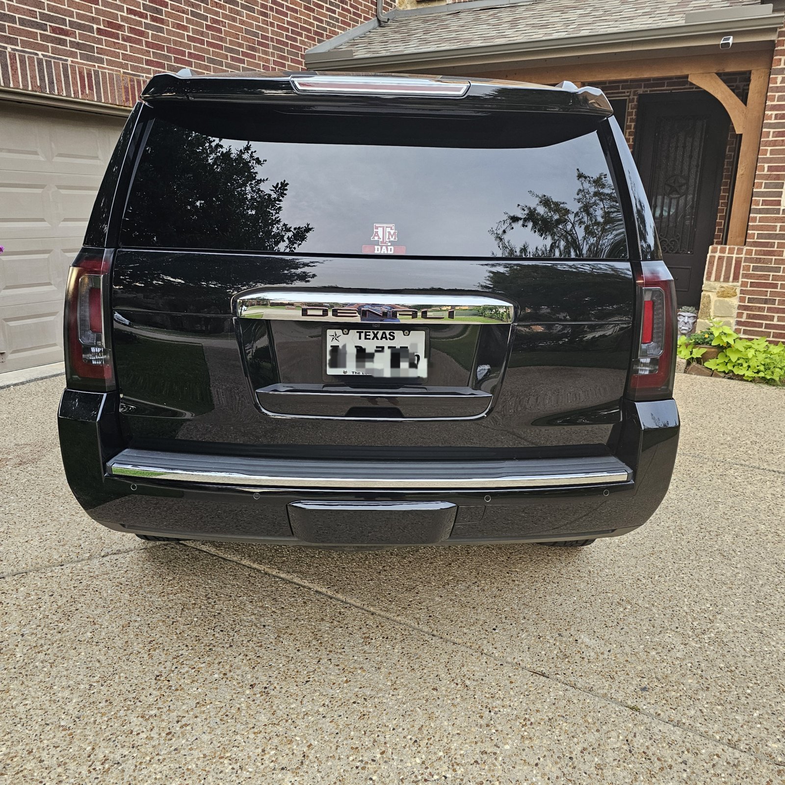

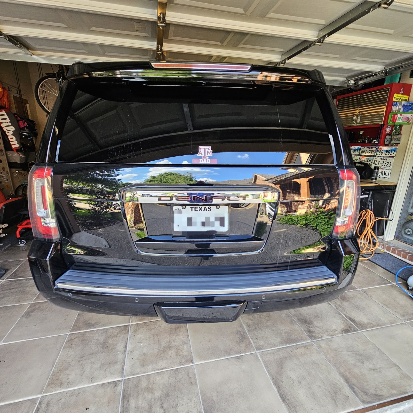

I decided to wait until it was 1pm and 101 degrees before I ventured outside to put my new Corsa exhaust on. I decided to be efficient and just sliced the stock exhaust in a couple of places to slide it out and it was the easiest exhaust I've ever removed or installed. The factory spherical clamp bolt snapped on me during disassembly so that added $44 bucks to the cost of the exhaust but luckily AutoZone had it in stock. I recommend removing the heat shield for the spare tire but I definitely wouldn't have gained anything from removing the tire like their instructions state.

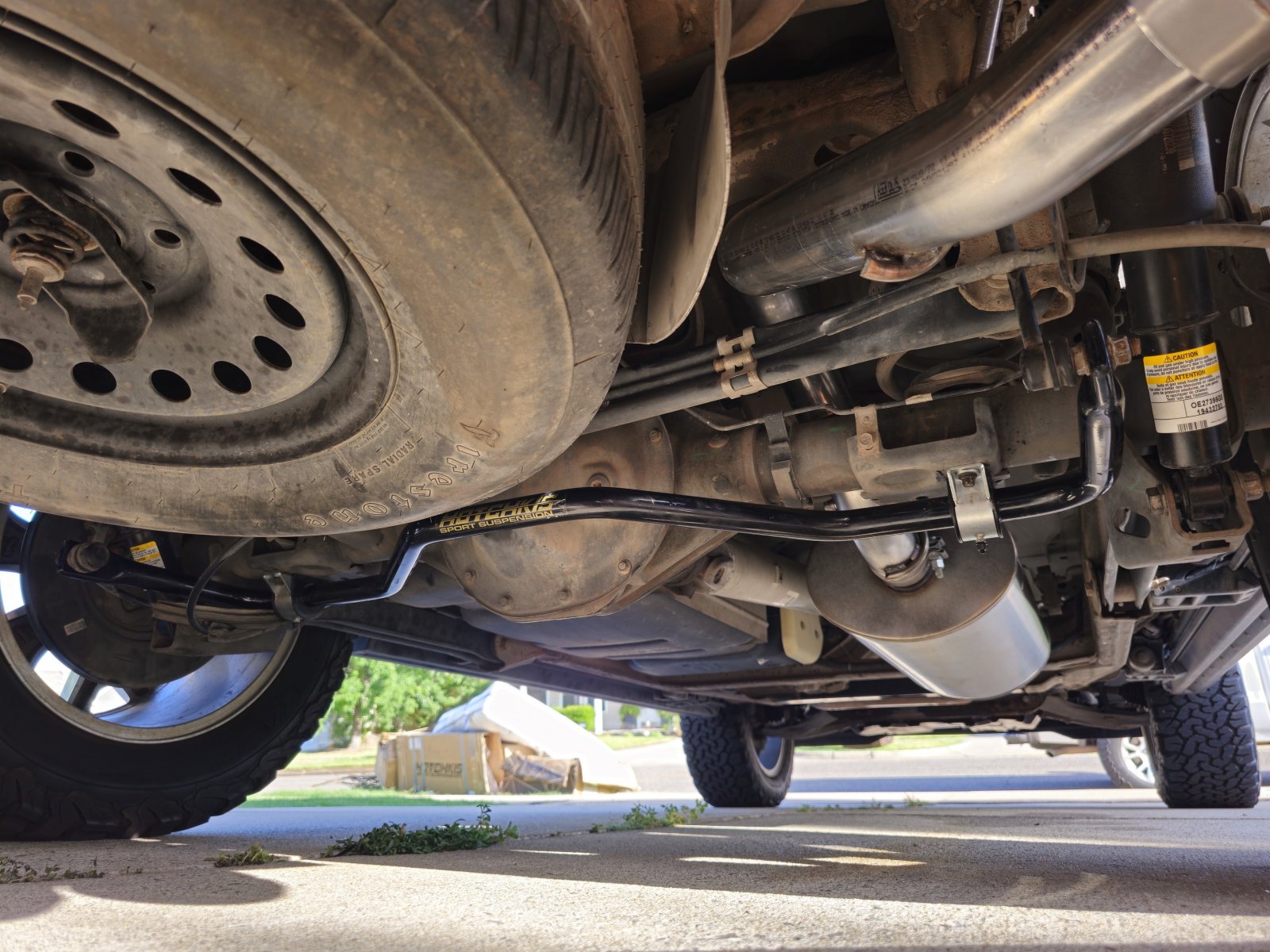

After the chugging 4 bottles of water I decided to slap on the Hotchkis sway bar set. I left them both on the lighter setting and so far it drives how I imagined. I still really miss my old lowered Tahoe but it is that much closer now.
I am happy enough with the Hotchkis sway bars but I think they updated their hardware for cost savings without checking if it would actually work. The hex head bolts provided couldn't physically fit and be turned and the bushing brackets were not deburred well and all 4 required some file work to accept the bolts you can't even use. The instructions provided showed socket cap bolts which would not suffer from that problem and I was able to reuse my old sway bar bolts. As for the exhaust, Corsa 14826, I am pleased but it feels very quiet to me. My old Tahoe was lowered with TSP long tubes and Y pipe and it was aggressive as hell but wonderful and I guess I'm missing that. Perhaps more exhaust components will find their way onto the Denali this summer.

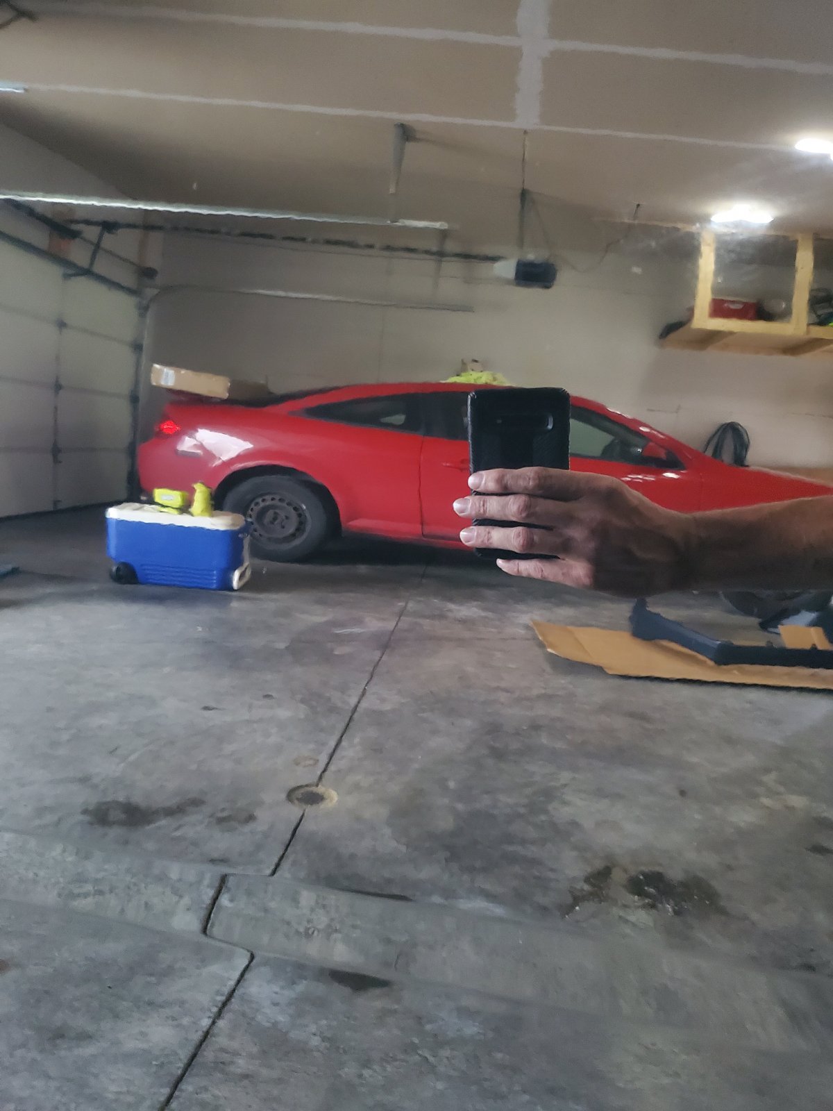

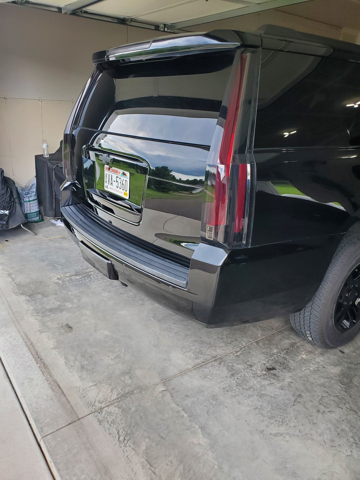

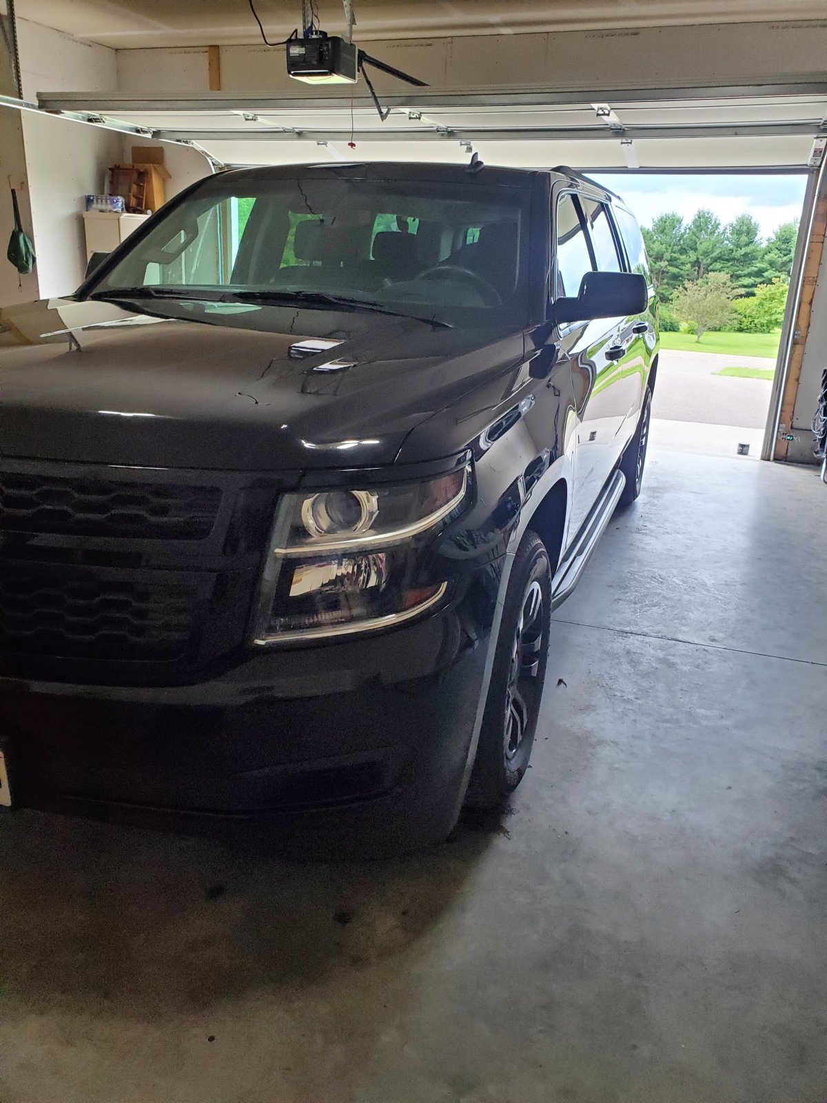

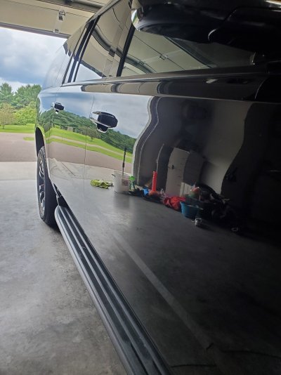

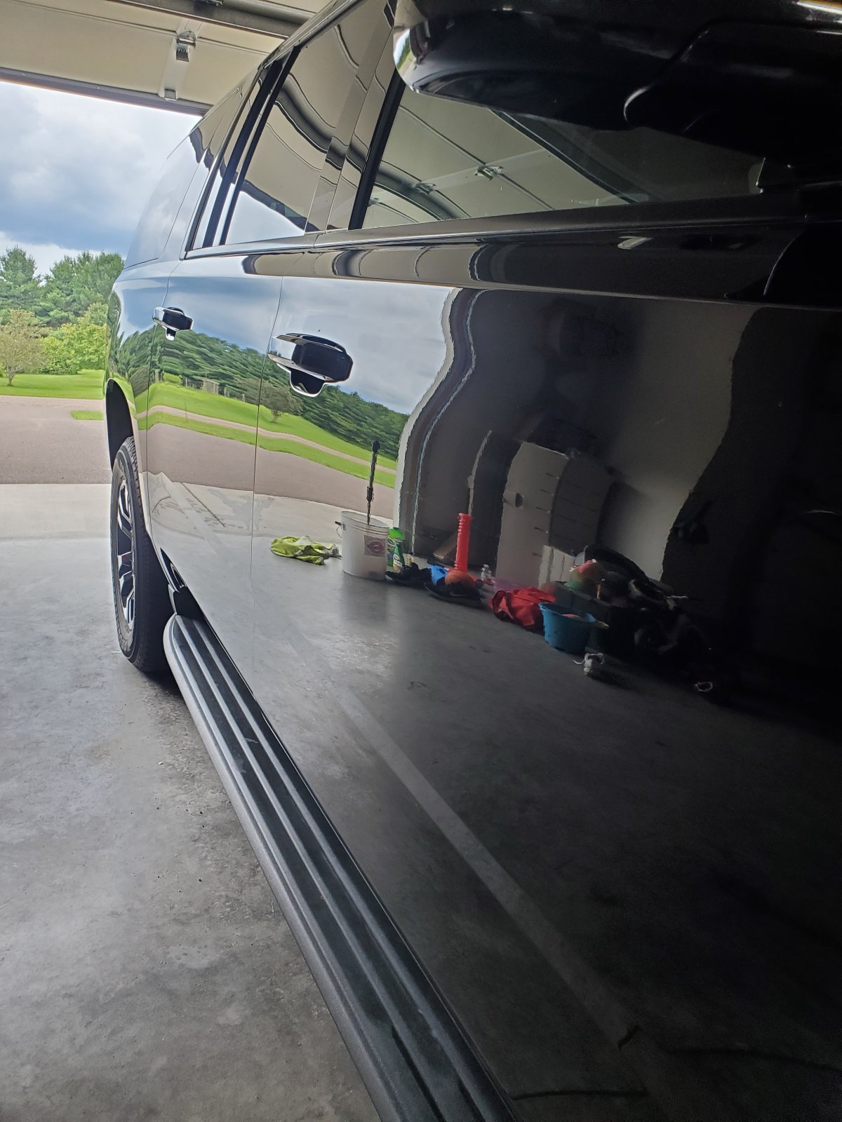

Washed, clay barred, and waxed for the first time. I wanted to do it when we got it last fall and right away this spring, but never could find the time. Of course before I was even done claying it the wife was asking when I'd be done so she could go somewhere. Get done and it starts raining and off she goes with it. At least it looked good for 5 minutes. I hate black vehicles but they do look amazing for those 5 clean minutes.
Even got a picture of the work beater from the reflection off the passenger door.

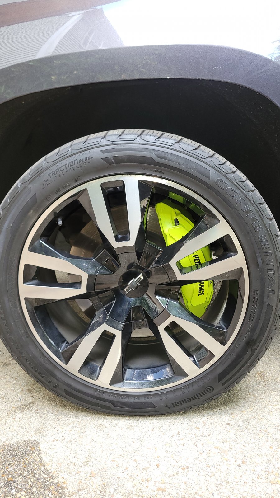

Those brakes look great. If I wasn't already being lazy about a brake swap on my drift car I would probably be on eBay and rockauto figuring out what to buy for the 6 piston upgrade already.

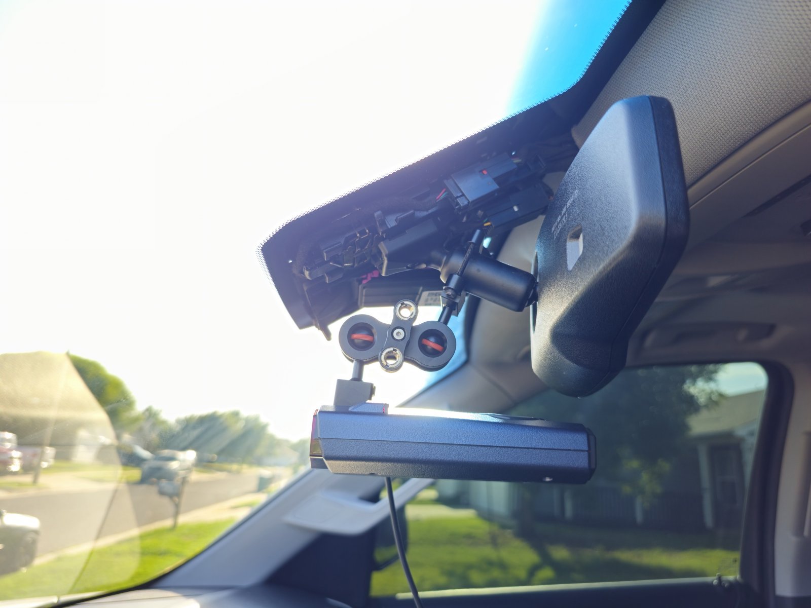

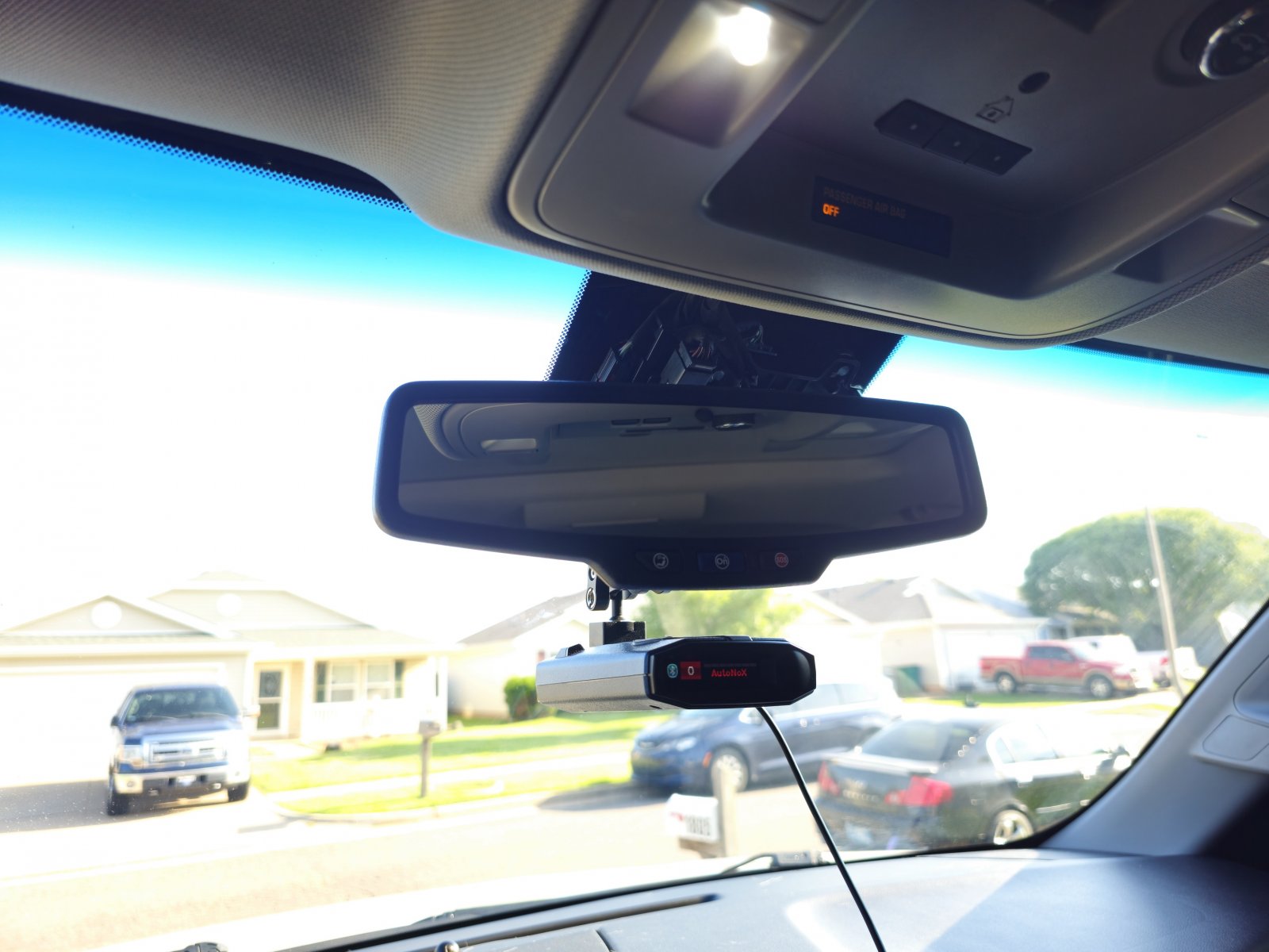

As for me, I got a deal on a new-to-me radar detector upgrade and "installed" a new mount. I have bought many variations on this mount but I have never felt like any of them were a really complete product but this one is. The o-ring style rubber inlaid into the pivot balls REALLY hold tight and don't slip at all and the aluminum in general has great fit/finish so if you are in the market for one then definitely consider them.
I don't really feel like I needed the upgrade but I wanted to pass my ****** Max II on to my dad and my Max 360 can trade between drift car and Duramax. I've got to decide how to wire this in. Normally I would just run an RJ11 from the mirror up under the headliner and down the A pillar to the fuse panel but I'm betting most people just tap switched 12v and ground from behind the mirror or the overhead console so I'll have to think about it. I like the plug and play kit from Gen5DIY but it just doesn't seem worth a hundred bucks even if most of that cost is genuine connectors. Any thoughts?

on my 18 silverado the mirror power was only 10v and my valentine will not operate at 10v so I tapped into the airbag light, the light only has power with key on so win/win

I've always used BlendMounts with success and the mirror-tap connectors. For the Yukon, I stayed with BlendMount but didn't like the mirror-tap for this application as they didn't work well with the tight connectors. I did use the GenVDIY adapter and it's pricey, but in my mind, the best option for this application. It was just a much cleaner and secure install.

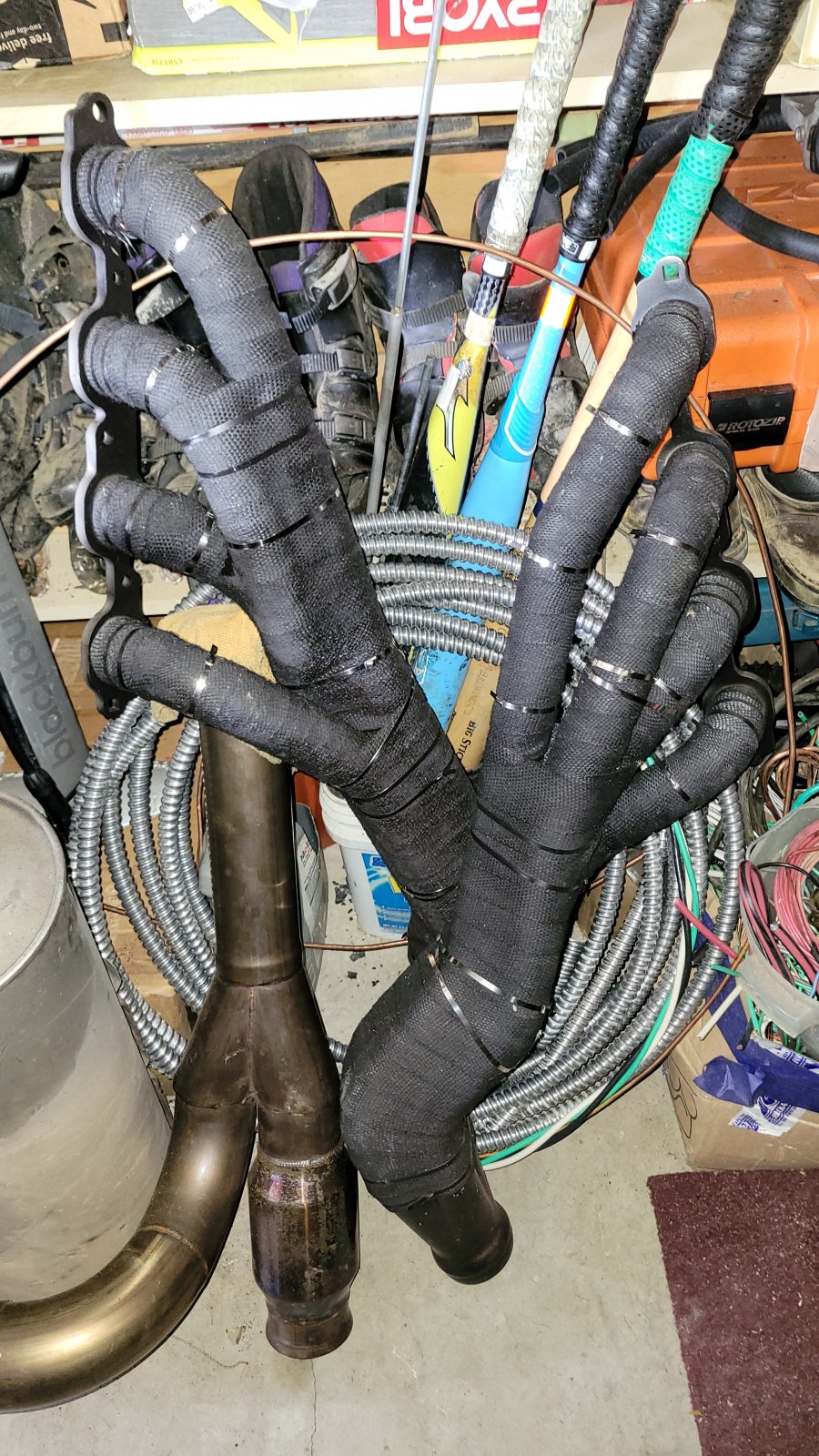

I threw these TSP long tubes and catted y pipe on over the weekend. Surprisingly civilized sounding with an oem muffler(which was harvested from a silverado). No good pics because my hands were dirty the whole time. As soon as I trace and address the tail pipe hitting the frame under throttle, I'll make a video.
